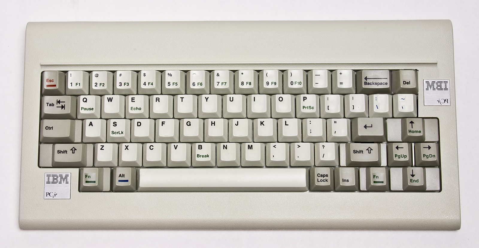

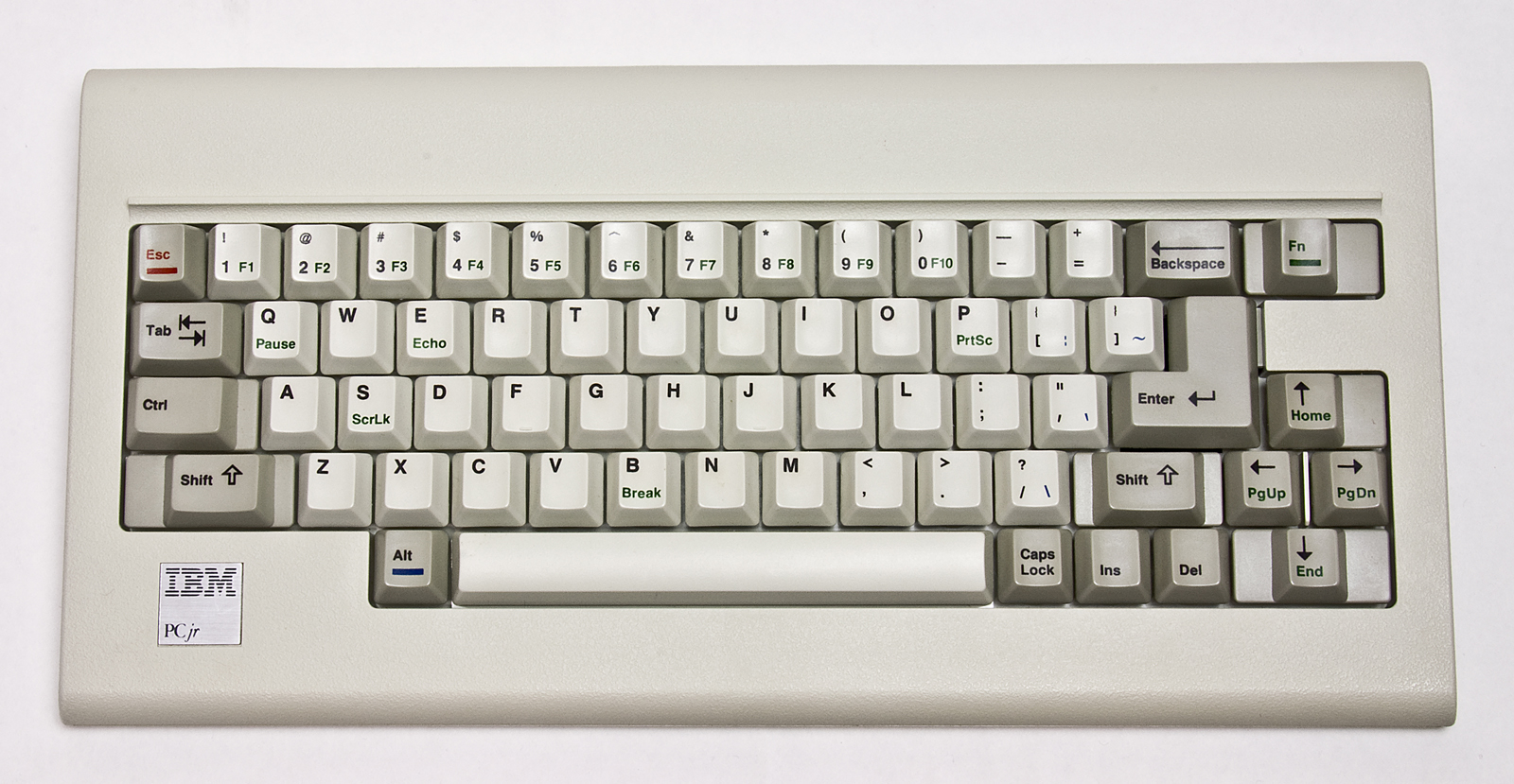

Let's see a nice picture of the (decidedly not nice) PCJr keyboard, taken from this article from The Register.
IBM PCJr keyboard - as originally designed.
The keyboard's physical layout is indeed quite poor, even when limiting ourselves to the accumulated knowledge of late 1983, back when the "top" layout was the one in the Model F AT keyboard, and quite a while before the Enhanced Layout was released. This is what we'd now call now a 65% form factor; sports a single, poorly placed Fn key; despite its diminutive size, wastes a lot of space with some inexcusable quirks (the right side of the second row is the worst offender); places important typographical symbols in the Alt layer for no good reason; the 7U space bar is unnaturally shifted to the right, again for no reason. Also, the keyboard has weird stepping on some keys, and although this isn't necessarily bad... it's handled inconsistently.

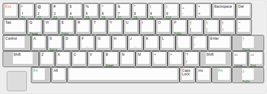

I first replicated the layout in Keyboard Layout Editor:
KLE diagram for the IBM PCJr, as originally designed.

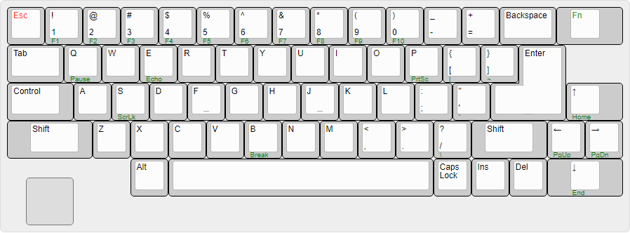

Then, I started moving things around, and came to this:
KLE diagram for the IBM PCJr, as I think it could have been.
Main features of note in this adjusted layout:
  • The symbols \, |, ` and ~ have been moved off the Alt layer, where they should have never been in the first place.
  • The MAE-like Enter key has been replaced by a simpler key without the binding issues the original had and with a size that's more acquiescent to a 65% form factor; yes, I'd have preferred to enlarge it by 0.25U or 0.5U, but that wasn't feasible.
  • The key stepping is more consistent; the arrow cluster has a better separation from the rest of the keys; both up and down arrow keys have the same stepping flaps (which avoids the weirdness of the original layout's differing shapes).
  • Del is in a much more natural placement.
  • The Fn key has been moved to the left side of the bottom row, freeing the user from the unnatural chords the top-right Fn key called for, specially when dealing with the arrow cluster. That said, I couldn't help myself and added a second Fn key on the right side, as should always be done with all mods — after all, there are Fn combinations on the left side of the keyboard as well.
  • The assigned Fn-arrow chords should be swapped, as they contradict what is usual nowadays, but we'll let that pass.
Note how there's less wasted space in the bottom left corner. The same thing happens in the top right area, where the wasted space goes down from 3.5U to 1.5U; the new 0.75×2U expanse looks quite less dumb than the former "case protrusion". That said, it does sprout the temptation of widening the keyboard by 0.25U, to allow adding two 1U keys there (and, in cascade, allow enlarging the Enter key to 1.75U). However... it won't be the case when we see it in action: based on the KLE design I did, I made a mock-up (with good ol' Paint™, as master graphic editors are wont to do) of how the keyboard would now look.
