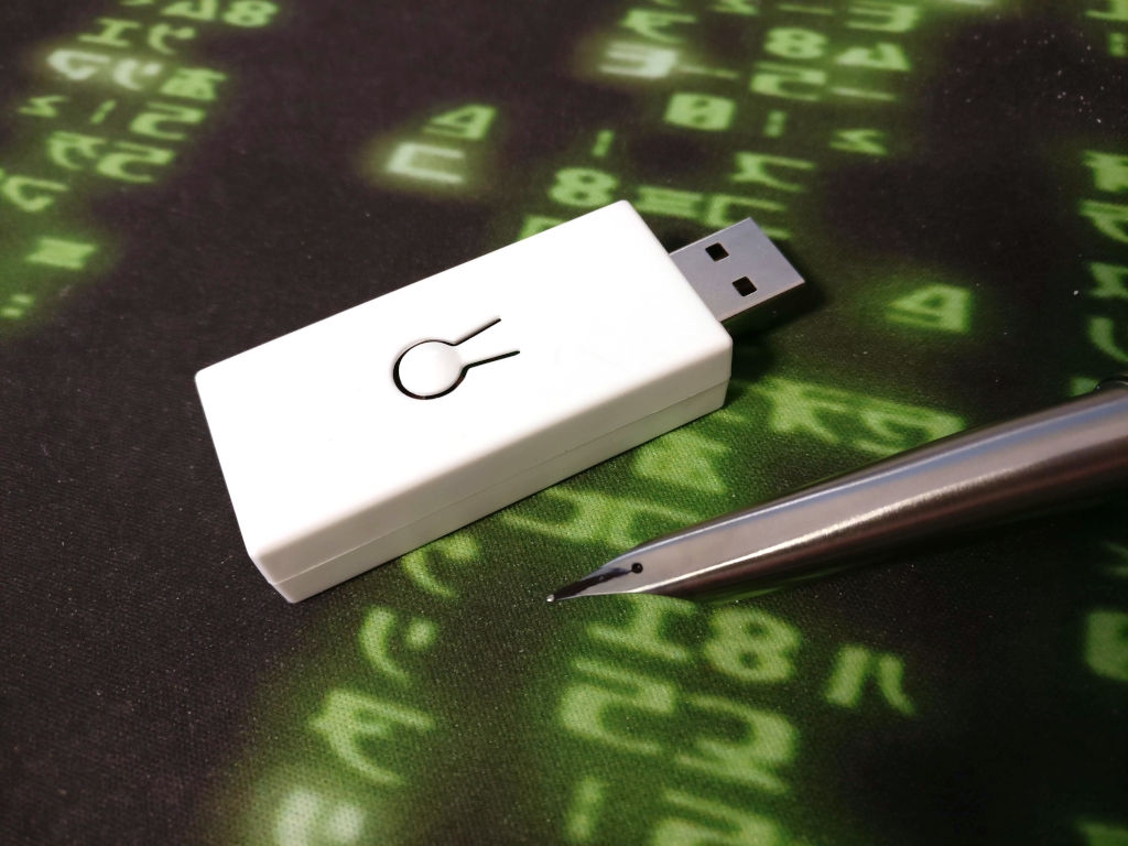

Few weeks ago I was contacted by Alan from Handheld Scientific who asked if I was interested in reviewing their Bluetooth Adapter. I eyed the little wireless dongle a while back when it still came with a battery and always thought I could make good use of it, so I accepted without hesitation. From what I read around this is not a special treatment reserved to me because I'm a robot but it seems Handheld Scientific is willing to give your money back in exchange for reviews on social medias (at least at the time of this writing).
So. Bluetooth Adapter BT-500, won't pass into history for the originality of its name but the premises are appealing: to convert any wired keyboard (or mouse) into a bluetooth cord-less device. What a treat.
The previous version came with a battery, the new one is smaller and sleeker but doesn't provide any kind of power. Meaning you have to provide the required juice, being that a USB charger, a standard USB port from your PC or a power bank (so fashionable nowadays).
Of course they can't foresee what device will be hooked to the dongle so they left the power issue to the user. Say you want to use a fully backlit keyboard, no problem, connect a beefy battery and you can go on for hours.
I feel the perfect scenario for the BT-500 is hooked to a USB charger near your desktop, paired to a tablet or smartphone that will be easily accessed through your precious mechanical keyboard. While it can be surely hacked into a wireless companion, I don't feel you can call it "portable" considering you have to add a battery pack and also it's not certainly tiny dongle (66x25x14mm).
Let's try it out
I put the dongle in my desktop PC just for the power and connect it to the most vanilla keyboard I have around, a Cooler Master Masterkeys pro. The idea is to try it on an iPad, I knew that that had the most chances to work. Indeed the 5-6yo tablet sees the dongle without a glitch but -alas- the keyboard doesn't seem to be working.
Check the cable. Recheck the connection. Try the keyboard without the dongle. Everything's fine but simply the BT-500 is not compatible with that specific Cooler Master. If that were my only keyboard it would have been a disaster, but as anyone in this forum I have plenty of fancy typing devices around. As soon as I connect a WhiteFox everything works right away and all the frustration forgotten...
