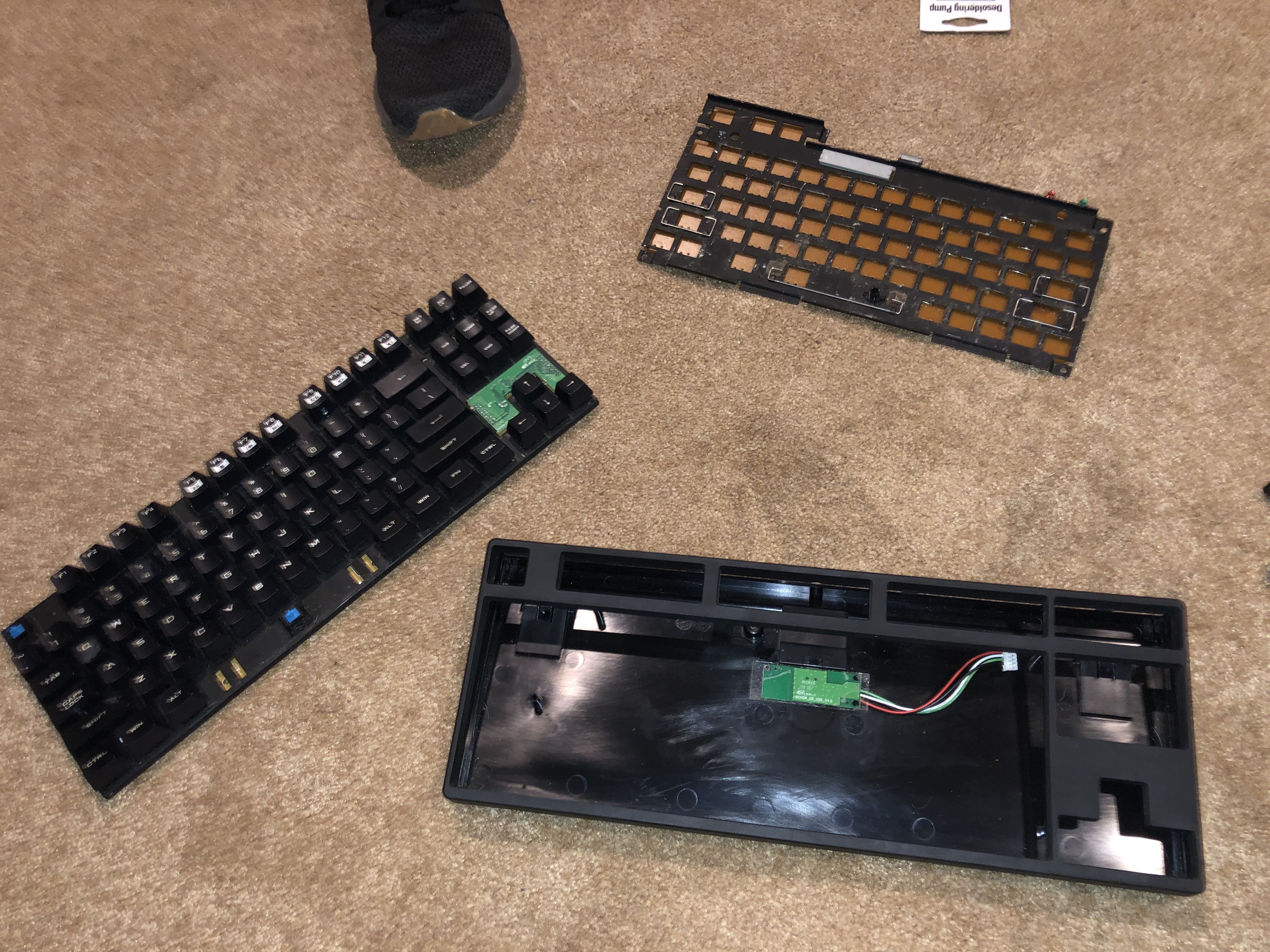

Alright here’s is a picture with all the keycaps off and uncleaned. I am getting a solder sucker and the mail tomorrow and will begin working on it. Also, I’m not sure what I’ll end up doing with the rest of the //c but if I decide to let it go I will be in touch. Tonight I will take apart as many switches as I can and begin cleaning everything before I desolder.
Hopefully the picture attaches properly.

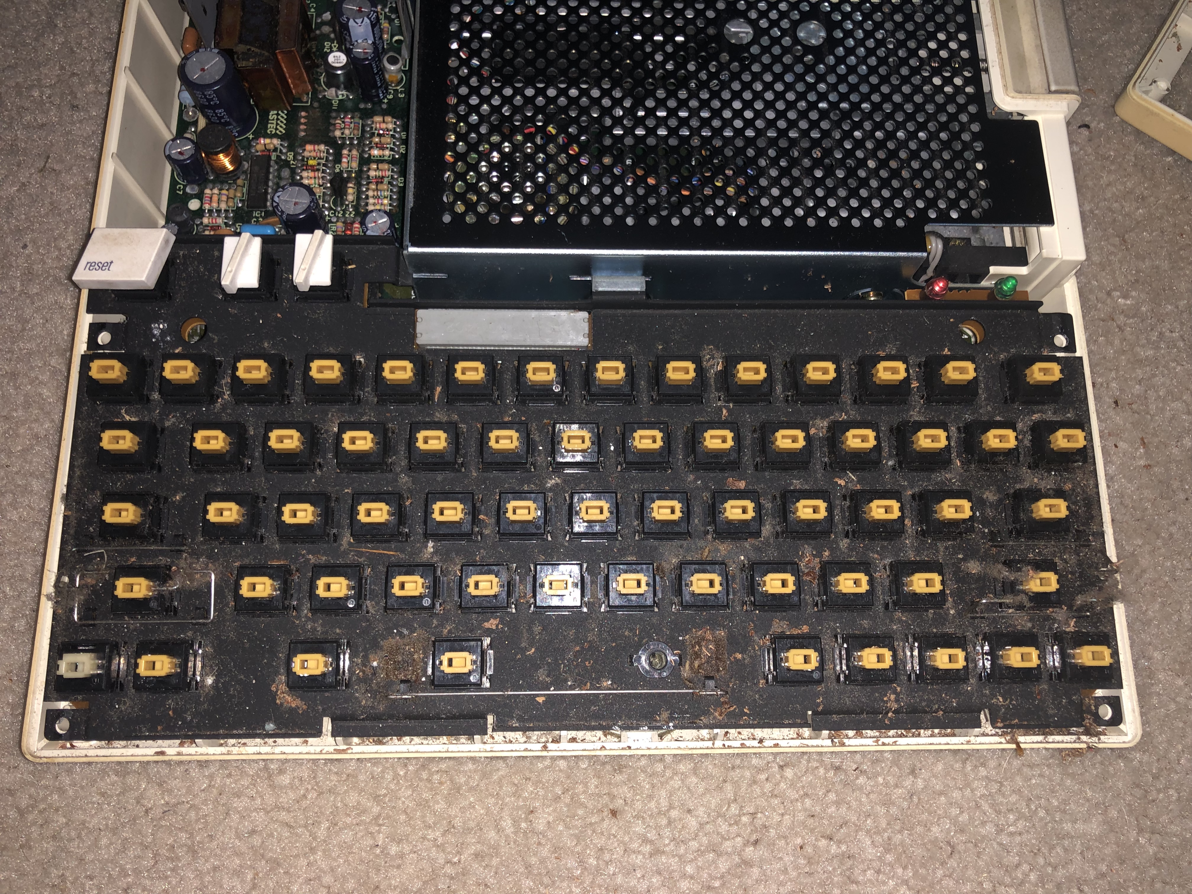

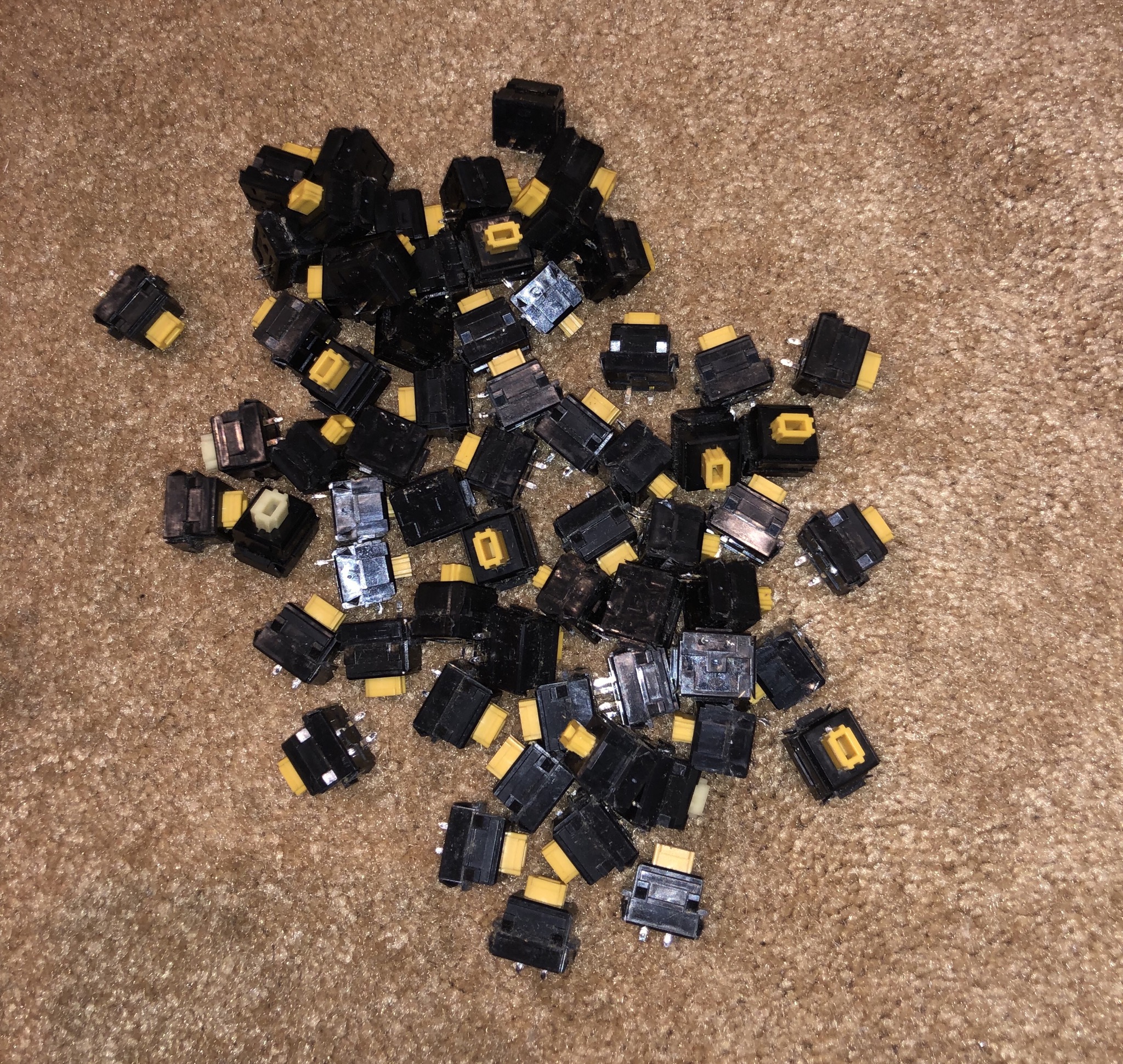

After some very tedious work, I was able to get all of the switches removed and cleaned. I chose not to lubricate the switches and just used compressed air to get any dust out and they feel plenty smooth. I don’t think they were used a whole lot to begin with. Here are some pictures of the switches, and the cooler master case that they will be going into eventually. I plan on painting it a semi-gloss gunmetal grey color. Most of the components with the exception of the PCB will be arriving on Tuesday. Hopefully the PCB doesn’t take too long, I’m very anxious to complete the build.

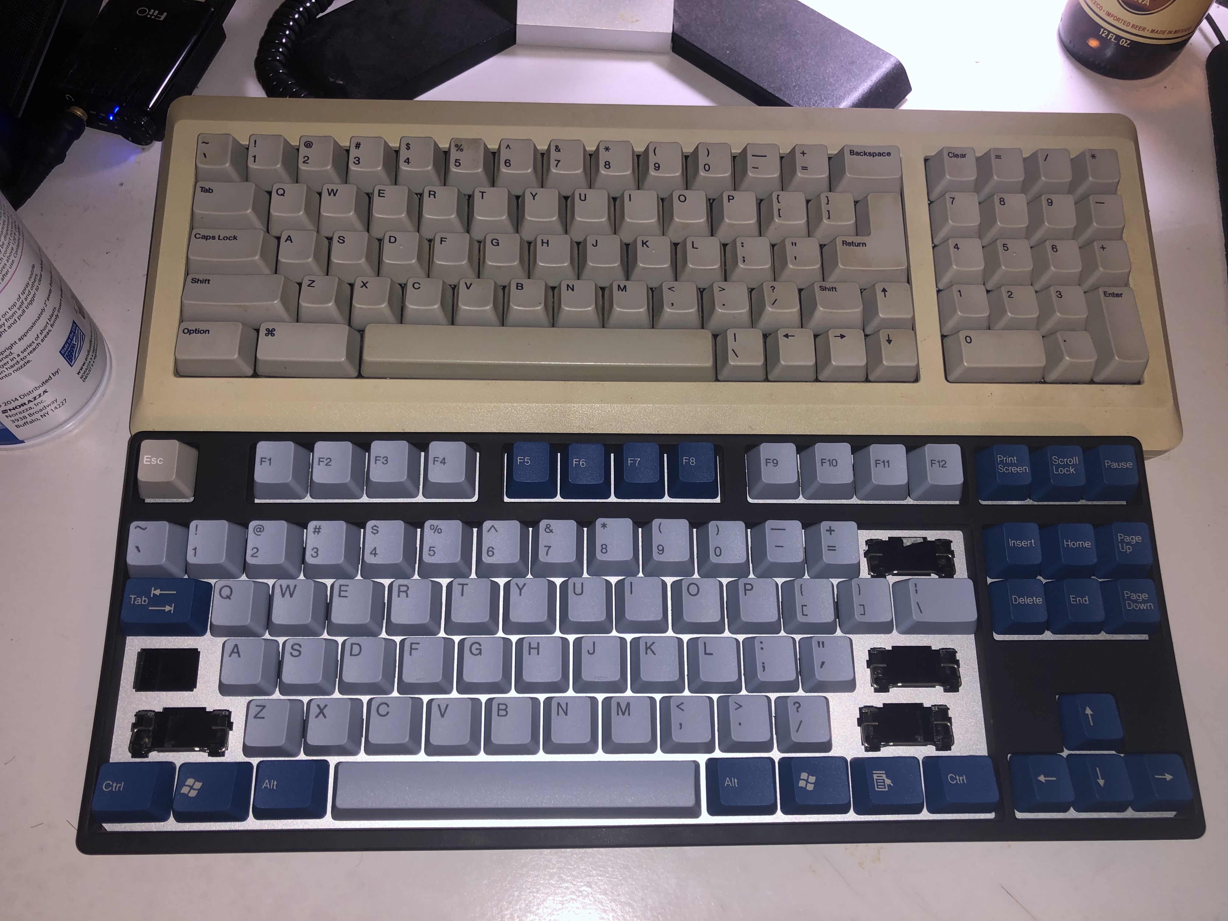

Ok here is an update, I got the plate and key caps in the mail. The phantom plate holds alps switches in the 1u spots perfectly but they do not lock in in other places. I think that this will be okay because I’m just going to solder the switches directly to the pcb and then everything should fit okay. Another problem with the phantom plate is the lack of a lip at the bottom where the plate rests on the case. I found some zip ties that are the perfect size and I will be epoxying two zip ties back to back to add some rigidity, then epoxying that assmebly to the case where the plate will rest. If anyone has a better solution for this please let me know. BTW I’m willing to sell one locking alps. I haven’t actually tested any of these switches but I’m willing to bet that they one. I’m using one and keeping another as a spare, but the third one I’ll sell. The //c is currently back at my home and I’m at college right now and do not have access to it.

Try getting a Matias stabilizer kit and cut everything off the existing stabilizer clips except for the part that holds the wire. Then you should be able to use the longer Matias wires and hooks without them hitting the stabilizer clips.
