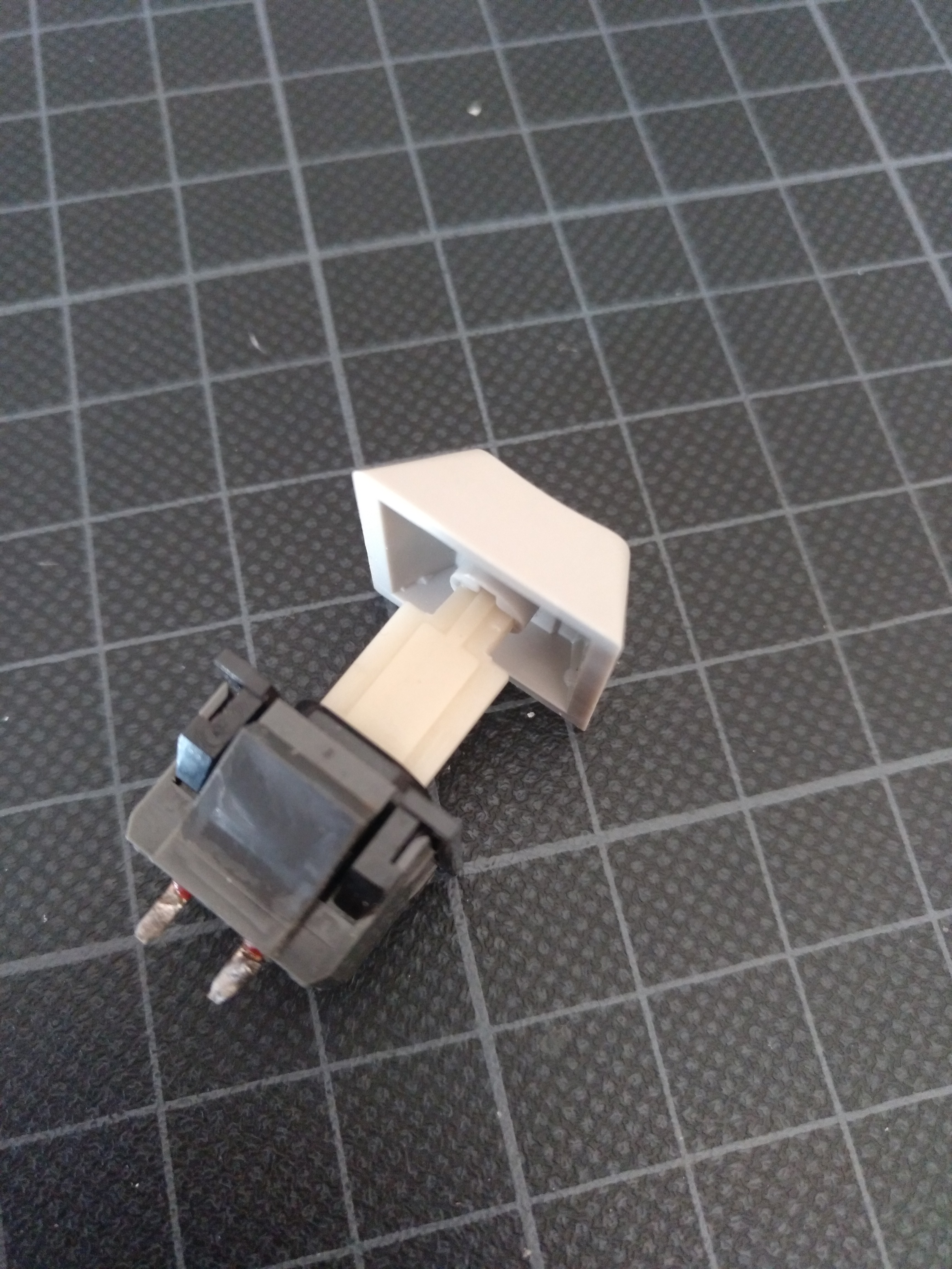

The Alps SKCC cross mount is actually kinda close to the Cherry MX mount. The thickness of the cross arms is almost on point, all you would need to do is shorten the arms a bit. I tried this once with an SA profile keycap and it worked quite good.
So if you are ready to modify your switches this might be a solution, just try it on a spare switch and keycap first!

Do you have a picture of what it looks like after you did it?
Nuum
20 Mar 2019, 09:05
Here is a crappy smartphone pic. You'd actually need to shave the arms down a bit more and the fit is quite tight, so be careful if you attempt this!

Thanks for taking the picture!
