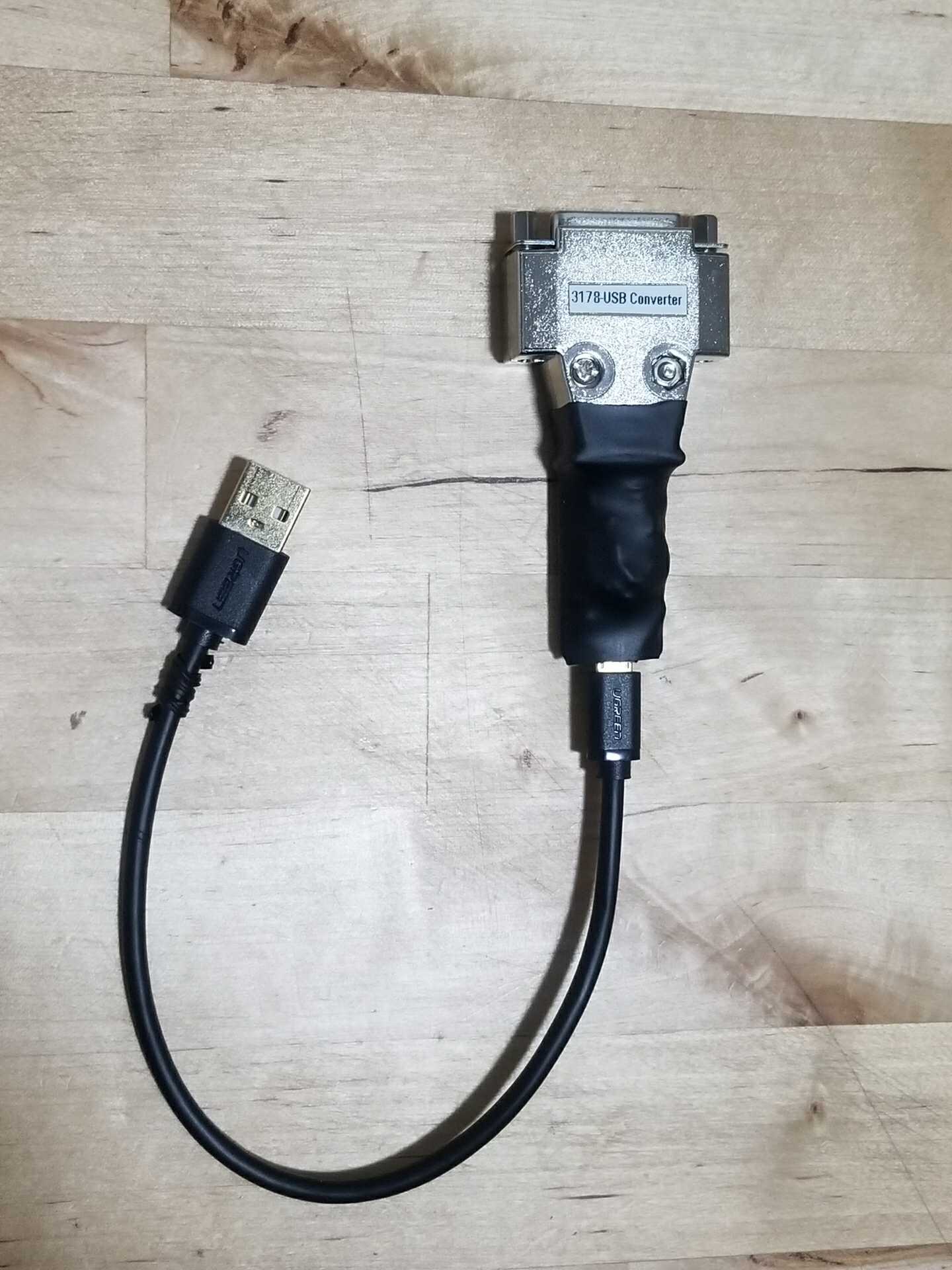

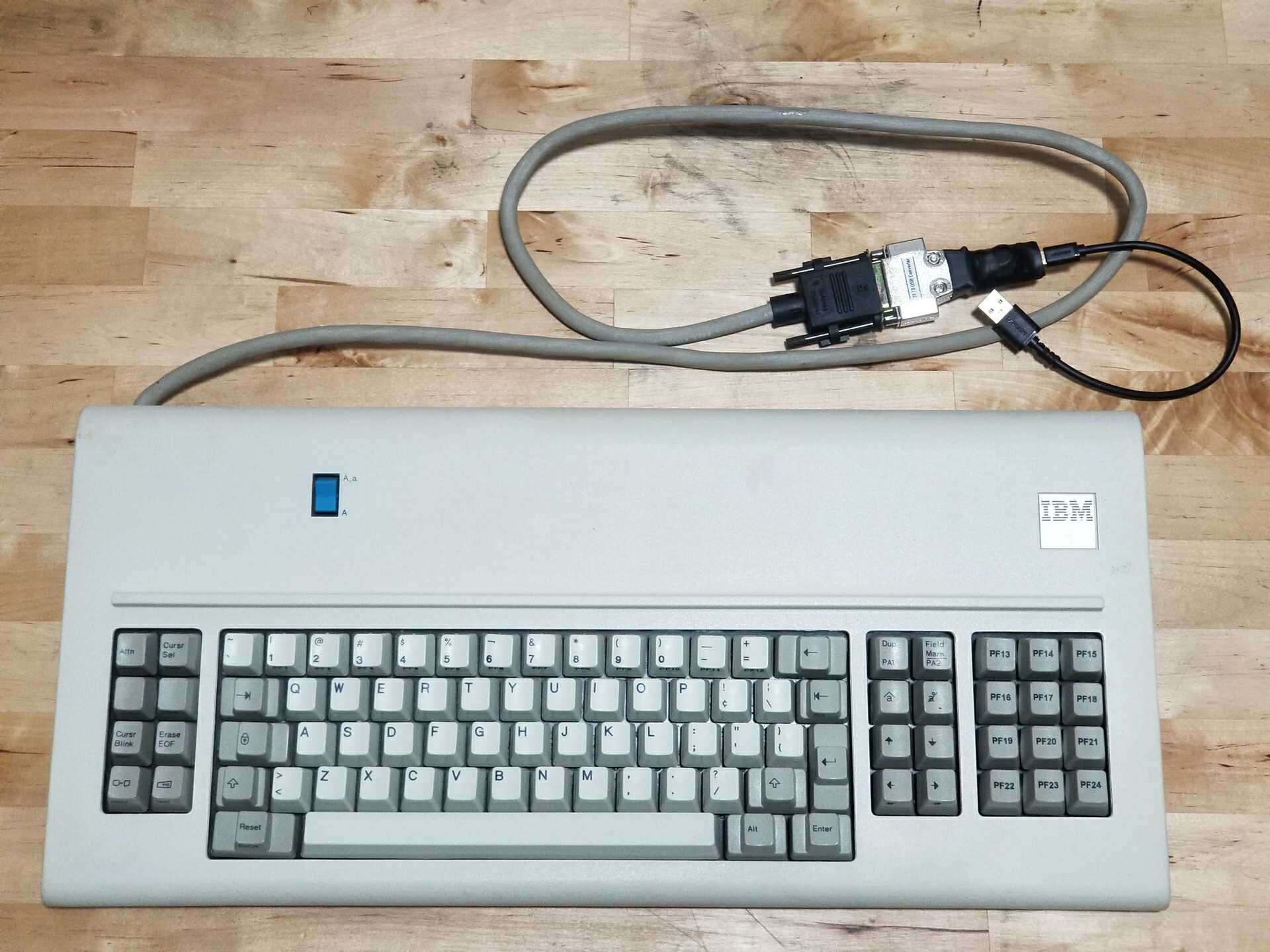

Did you managed to convert your 3178 with this method???
kmnov2017
15 Nov 2019, 18:07
Documentation for this is available on Github...
kmnov2017
15 Nov 2019, 18:13
Here's one link https://github.com/MMcM/ibm-5251-kbd
and here's another link
https://github.com/tmk/kbdbabel
Lookup 3104 - its electrically the same as 3178.
