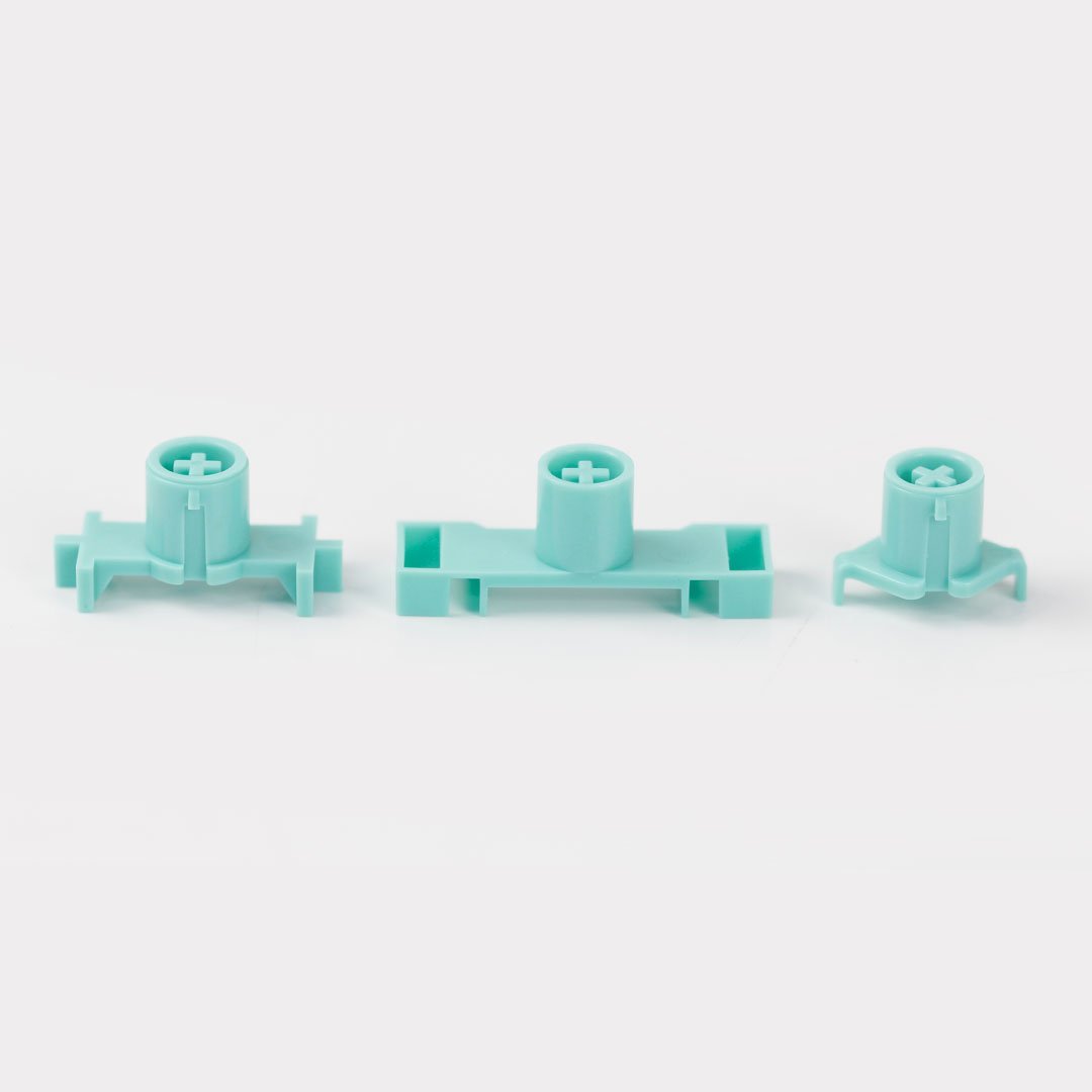

@Hypersphere I found these adapters on the KBDfans website you guys mentioned:
"Topre keycaps to Mx keycaps Adapter-X"
Anyone has any experience with these? People in the comments say the keycaps didn't fit very well and looked tilted?!

28 Mar 2019, 11:28
They are quite loose and indeed the keycaps look a bit rotated. They are also, probably, the "best" you can get *without* sacrificing a Novatouch keyboard (or a Realforce Topre RGB, except that you can't use the stabilizers for the larger keycaps, since they look different). Also this thread may be useful to you: viewtopic.php?f=2&t=19096
