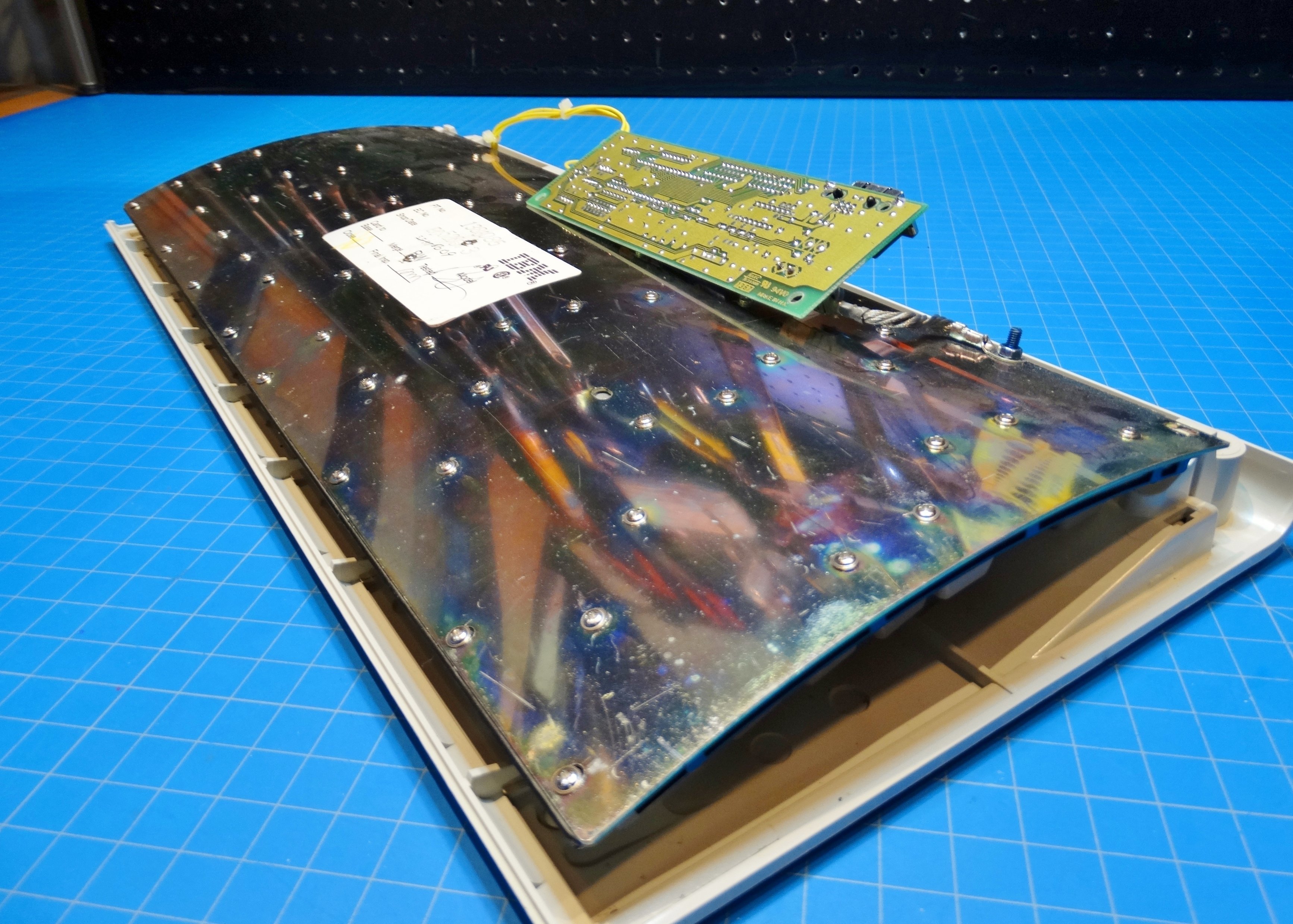

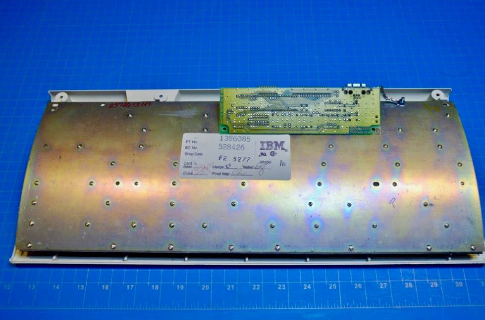

I've got a 1986 Model M that is chattering on the E key. It's a very early version and the barrel plate was badly cracked so I replaced it with a new part from Unicomp. Tried replacing the spring on the E key and if anything that made it worse.
I did notice that the membrane seems to be glued to the back plate. I've never seen that before. It's one of the very early zinc coated thick plates, don't think I can get the membrane off without destroying it. Anyone else seen these chatter? At this point the membrane is the only part left to replace ....

The thought had crossed my mind as well but it's so evenly stuck down it really looks intentional. This is November 86 Model M according to the case stamp and the internal assembly doesn't have a date on it, but it looks to be a very early one. It had plastic/rubber tubes along the inside edge of the old barrel frame as well, something else I hadn't seen before.

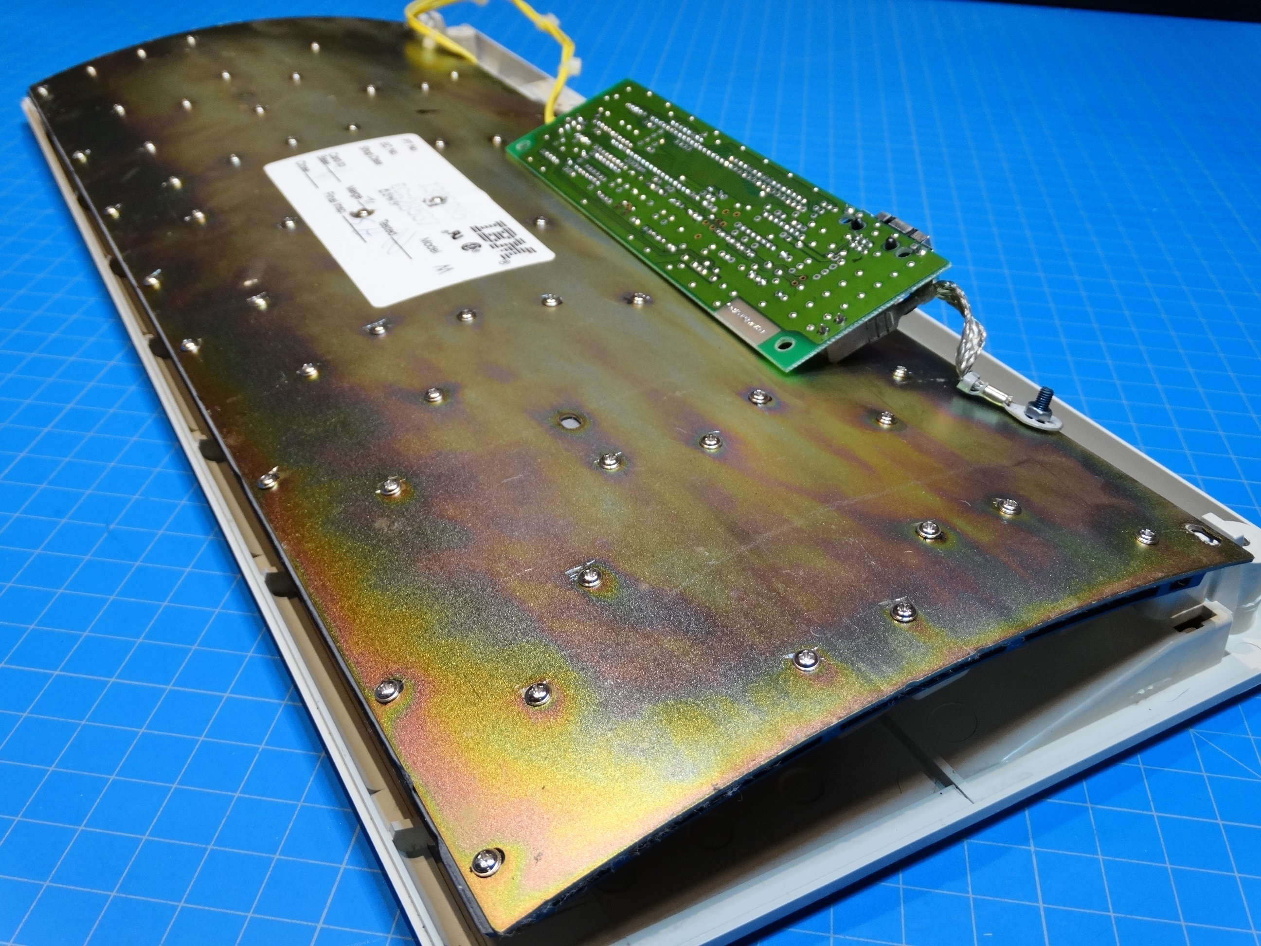

a) curved metal plates that are relatively thicker and have the shiny coating

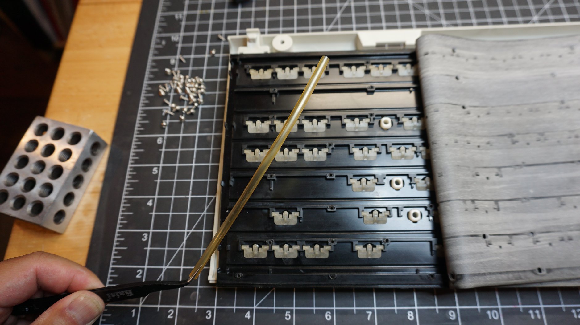

b) 3 rubber tubes underneath the barrel plate
c) I have also seen a number of instances (~30-40 model M keyboards out of 3000) where the 2 conductive membrane layers and separation layer are not free-floating but appear to be adhesively attached to the underside of the curved metal plate. At first I thought that the plastic in the membrane layers had chemically-broken down after 30 years and fused to the metal surface, but after seeing it happen more than a few times now over 15 years, it appears that IBM used adhesive in the process of building model M keyboards. I think I also saw this on an IBM wheelwriter keyboard from the same time frame. After 1987, it is more common to find the conductive mylar layers to be free-floating and not adhesively attached to the underside of the metal plate.

Yeah, I just figured these things were due to it being an earlier Model M. I've seen the thicker zinc (I think) coated plates in a couple with an 87 or 88 date in one the back of the case. But those could have and their assemblies swapped before I got them so who knows. Glad to know I wasn't going crazy with the glued down membrane. I'm guessing there's no way to safely get them apart for cleaning? I've got a new membrane that can go it in the assembly if not.
