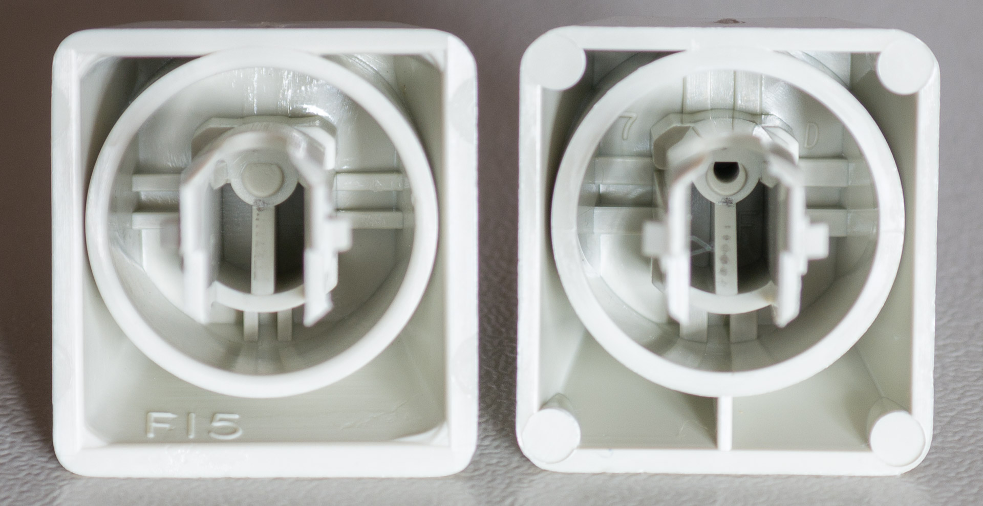

I can't post pictures on here to show this, but I've just noticed the keycaps on this 1984 UK Model F XT are thinner than all the others I've encountered - and I've owned about 8 now. The walls are slightly thinner and they lack the little "posts" in the corners. They sound less dense when handling them. Interestingly, this XT sounds noticeably deeper than my pristine US one. Doesn't sound as crisp or entertaining though, but this is probably due to the condition of the foam - the centre row sounds dead. All three UK Model F XTs I've owned had bad foam (the type with the white skin on one side), whereas the US ones have always had intact foam.

While there are quite a few differences to tell an UK and US made XT keyboard apart - including the shape of the keycaps (US made ones usually having slightly rounder corners than UK made ones), the thickness is not such a clear indication and seems to vary quite a bit.
I would say my experience leans actually more to the opposite - concerning thickness.
for example: left: UK / right: US

I'd definitely agree with you with the US keycaps feeling "rounder". My UK model has quite sharp keycaps. The legends are also razor sharp, they're the best dyesub legends I've ever seen, for sure. What's the reason for these differences?AJM wrote: 04 Apr 2019, 22:01 While there are quite a few differences to tell an UK and US made XT keyboard apart - including the shape of the keycaps (US made ones usually having slightly rounder corners than UK made ones), the thickness is not such a clear indication and seems to vary quite a bit.
