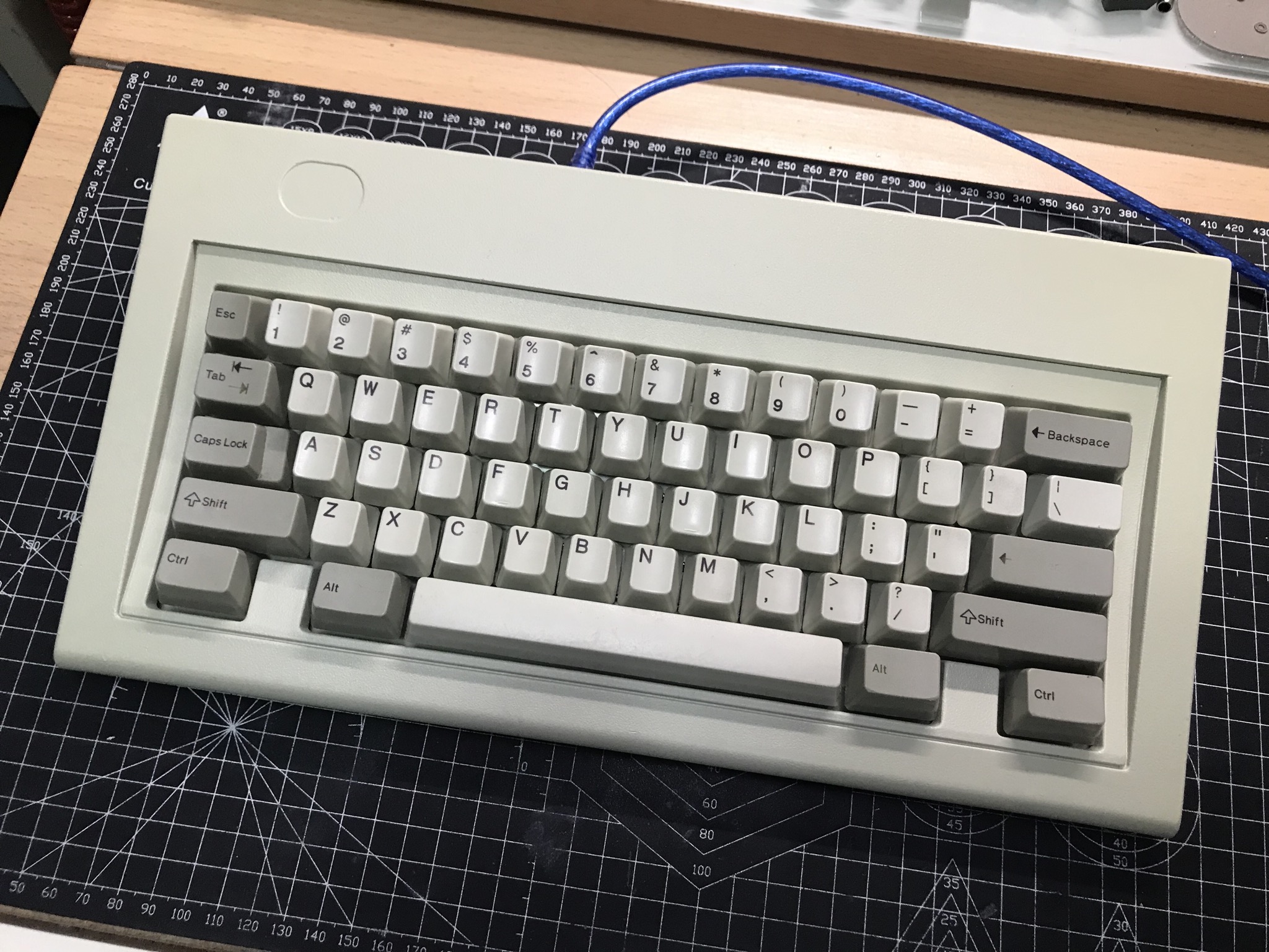

finally the kishsaver (or 60%) has been completed
- anthonymak
- Location: Hong Kong
- Main keyboard: IBM Model F101
- Main mouse: Microsoft arc
check out the photos and they speak for themselves.

the final outlook. need a batch tho
- the final outlook. need a batch tho

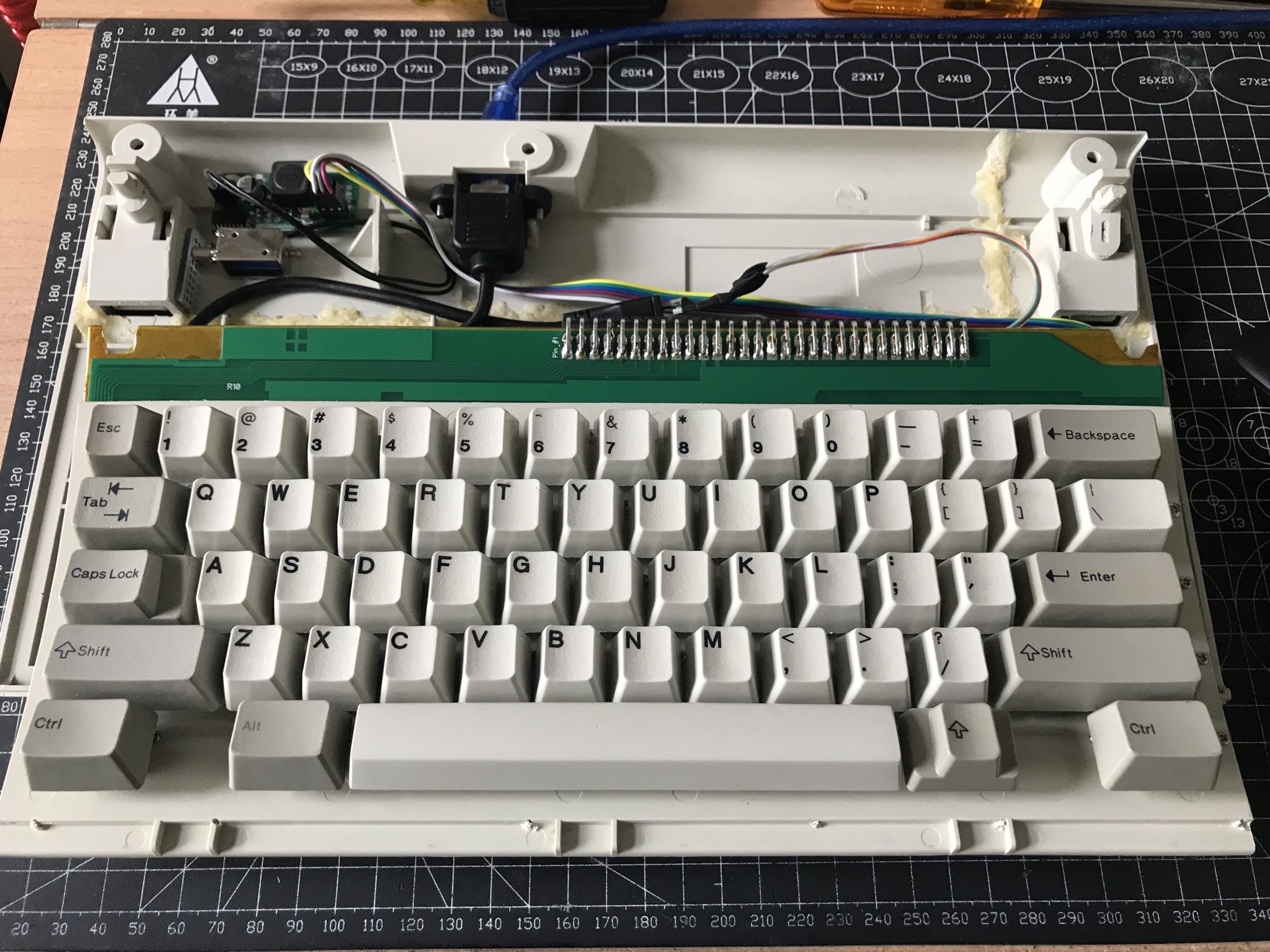

Turned out beautifully! How did you cut the plate?
- anthonymak
I used dremel to cut the steel plate. I used simple hand saw to cut all the plastic. Except the rotor, I dont have any machine tool to do this.

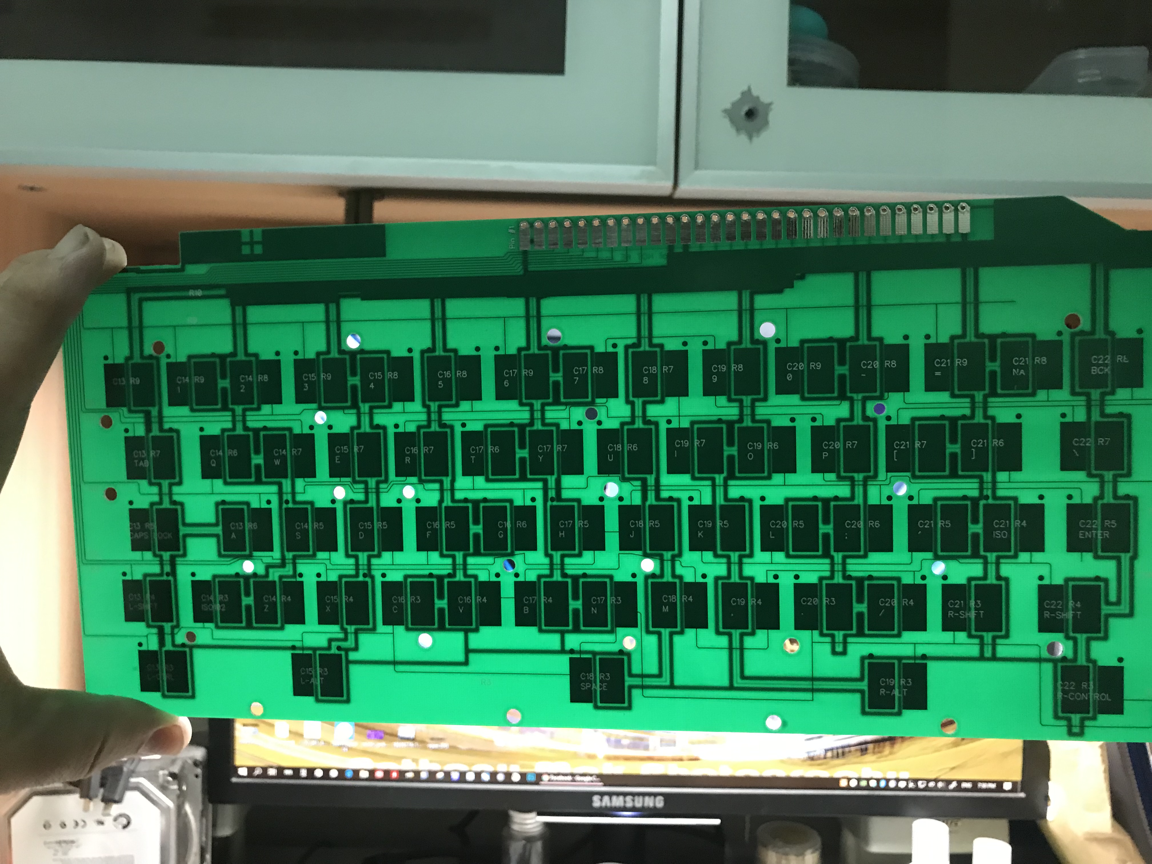

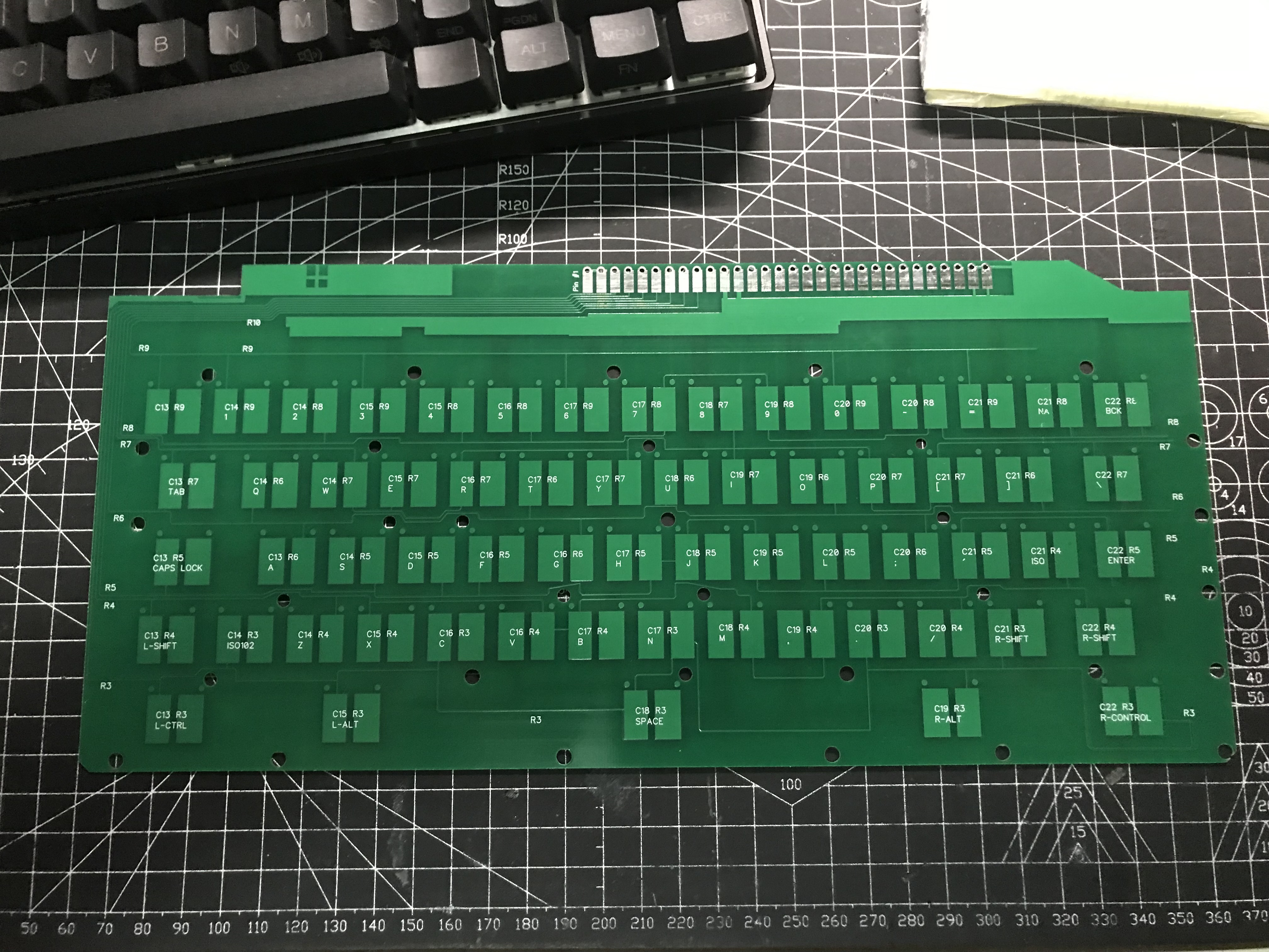

my f60 keeps revolving. have just turned it into capacitive buckling spring with customed pcb and xwhatsit. many thinks to iDollar letting me to modify his fssk pcb design.

your measurement for the cut is very important. give a bit more room for your first cut and use rough sand paper to sand down the plastic to fit. use static model cement to hide the seam, use fine sand paper such as #800 or higher to smooth the surface. spray and file until you cannot see the seam. good luckpumasocks wrote: 26 May 2019, 06:55 I plan on cutting my AEK case down to 60%. Can you explain your process further for hiding the cut marks?

This is brilliant - I have several projects where I would like to repair cracks or holes, and I can only dream to get a result half as clean as yours, but this will be very helpful. Could you elaborate on the model cement you’re referring to - and perhaps the exact paint/color? Google wasn’t very helpful.pumasocks wrote: 27 May 2019, 03:41You're the best, thank you so much!anthonymak wrote: 26 May 2019, 10:32your measurement for the cut is very important. give a bit more room for your first cut and use rough sand paper to sand down the plastic to fit. use static model cement to hide the seam, use fine sand paper such as #800 or higher to smooth the surface. spray and file until you cannot see the seam. good luckpumasocks wrote: 26 May 2019, 06:55 I plan on cutting my AEK case down to 60%. Can you explain your process further for hiding the cut marks?

Hi, I used static model cement from China but it is not too good for this purpose. I plan to use cement from Tamiya which shall give good result.Scarpia wrote: 27 May 2019, 10:16This is brilliant - I have several projects where I would like to repair cracks or holes, and I can only dream to get a result half as clean as yours, but this will be very helpful. Could you elaborate on the model cement you’re referring to - and perhaps the exact paint/color? Google wasn’t very helpful.pumasocks wrote: 27 May 2019, 03:41You're the best, thank you so much!anthonymak wrote: 26 May 2019, 10:32
https://www.tamiya.com/english/products/87187/index.htm

There is no need to thank for anything. All my work is public. You have created a wonderful version of the PCB and a better keyboard. Congratulations.anthonymak wrote: 21 May 2019, 09:26 my f60 keeps revolving. have just turned it into capacitive buckling spring with customed pcb and xwhatsit. many thinks to iDollar letting me to modify his fssk pcb design.
Are you using it regularly ?
Cheers

Amazing job!anthonymak wrote: 21 May 2019, 09:26 my f60 keeps revolving. have just turned it into capacitive buckling spring with customed pcb and xwhatsit. many thinks to iDollar letting me to modify his fssk pcb design.
Can you share the gerbers of this PCB? I have the remains of a faulty '2001 Unicomp laying around: scratched case, cracked barrelplate, etc.

I have extra pcb laying around. please pm me if you want one. Cheers,Quartz64 wrote: 03 Sep 2019, 16:14Amazing job!anthonymak wrote: 21 May 2019, 09:26 my f60 keeps revolving. have just turned it into capacitive buckling spring with customed pcb and xwhatsit. many thinks to iDollar letting me to modify his fssk pcb design.
