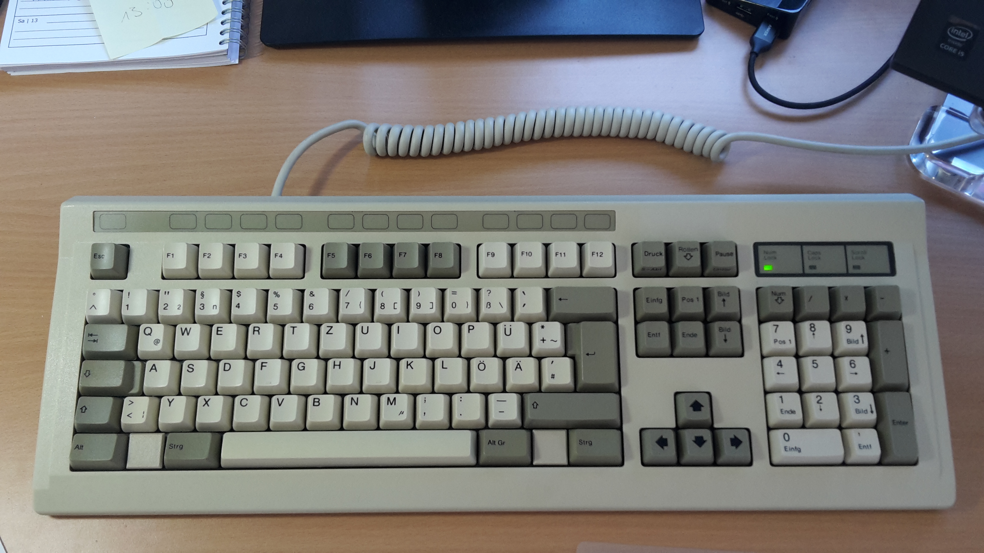

Moisture damage after cleaning?
ghostdawg187
12 Apr 2019, 13:19
I have cleaned my Datacomp DFK 192 on Wednesday and let everything dry over night. I have put everything together yesterday and plugged my keyboard into the computer. Everything went fine and I could use the keyboard the whole day. Today I have worked for 2 hours and then suddenly it stopped working. When plugging it in all 3 LEDS power up, but no key press is recognized. I thought there is some moisture still inside the board, used some spray duster, have put it on the heater for some hours with all keycaps and case removed, used isopropanyl to clean the pcb but it stil does not work.
Do I have damaged the keyboard? What else can I do? I have cleaned some keyboards before, never had an issue with drying it over night and using a spray duster. Those SMK switches have been so nice. I think the keyboard is dead.
PS: I do not possess any skills concerning repairing electronic objects, so basically I think I am running out of any alternatives, is there still some basic stuff I can do?

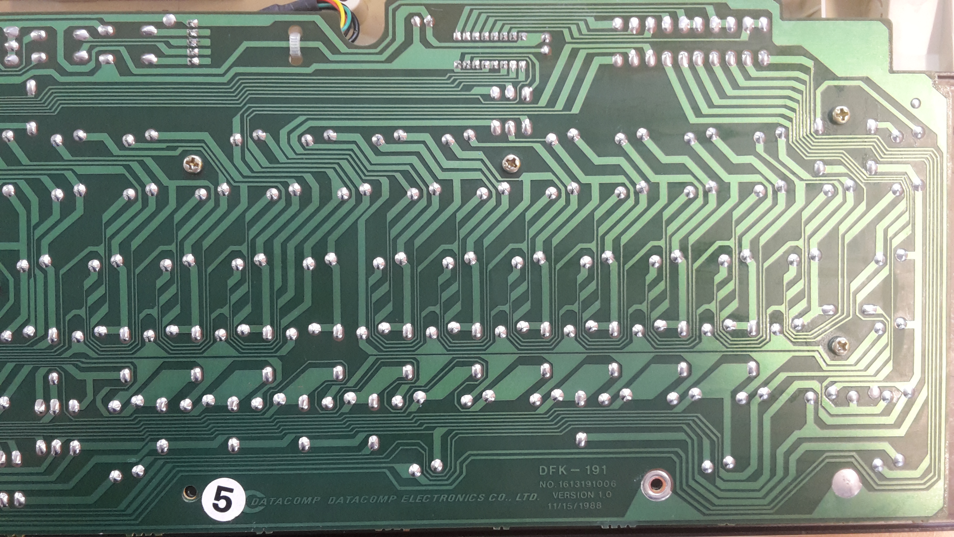

Can you open the keyboard up? I think you should check to see if there are any signs of damage to the PCB.

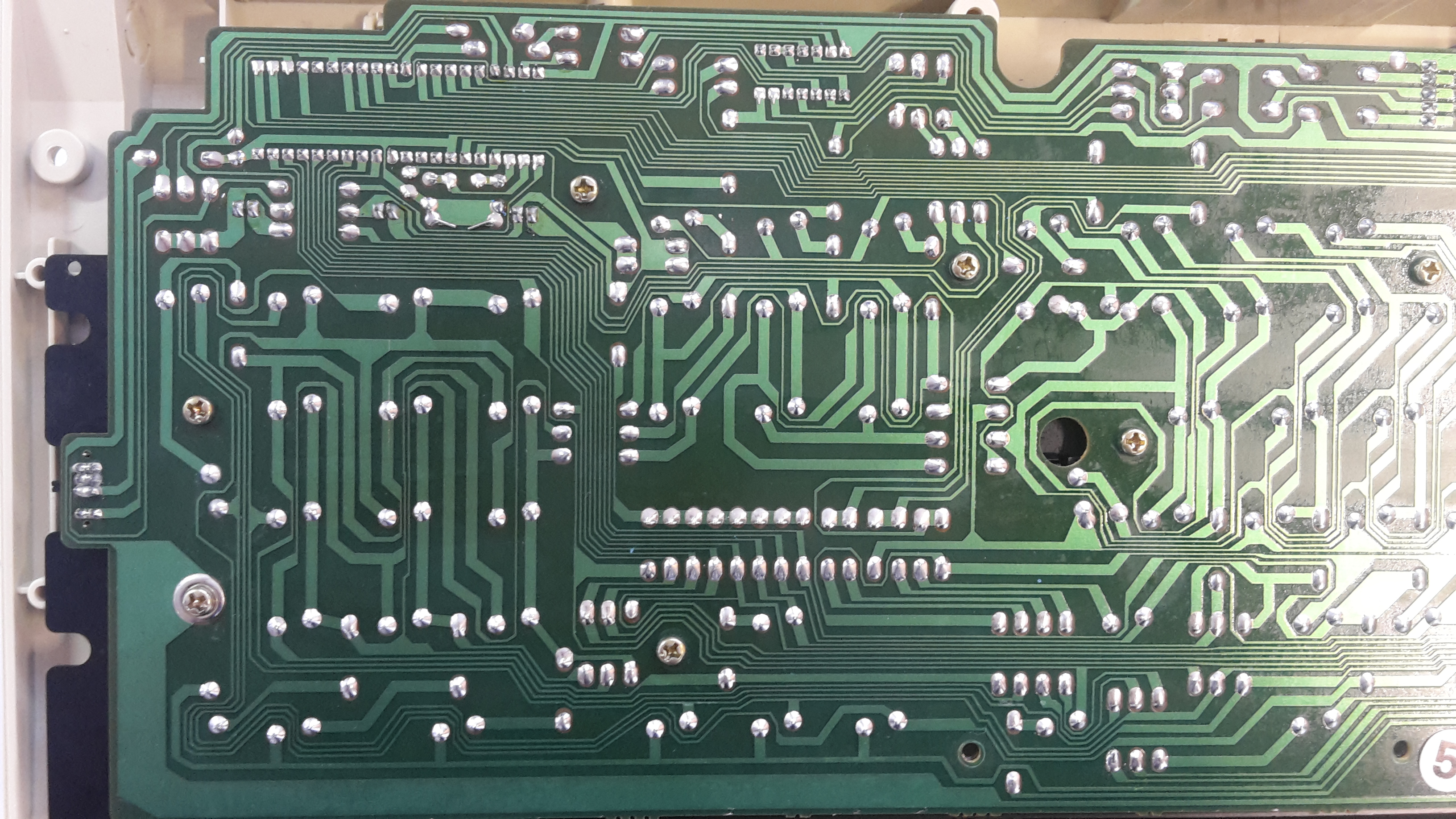

That is what I can see:
I should look for corrosion or some "rusty" spots, right? But I doubt that there exist any, but I do not have any knowledge.
