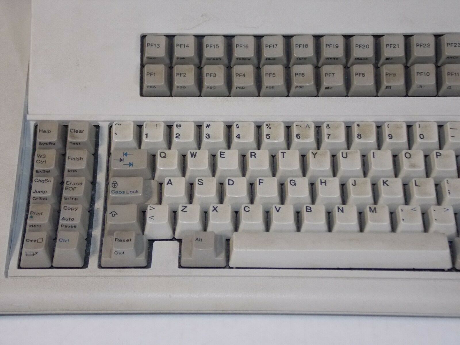

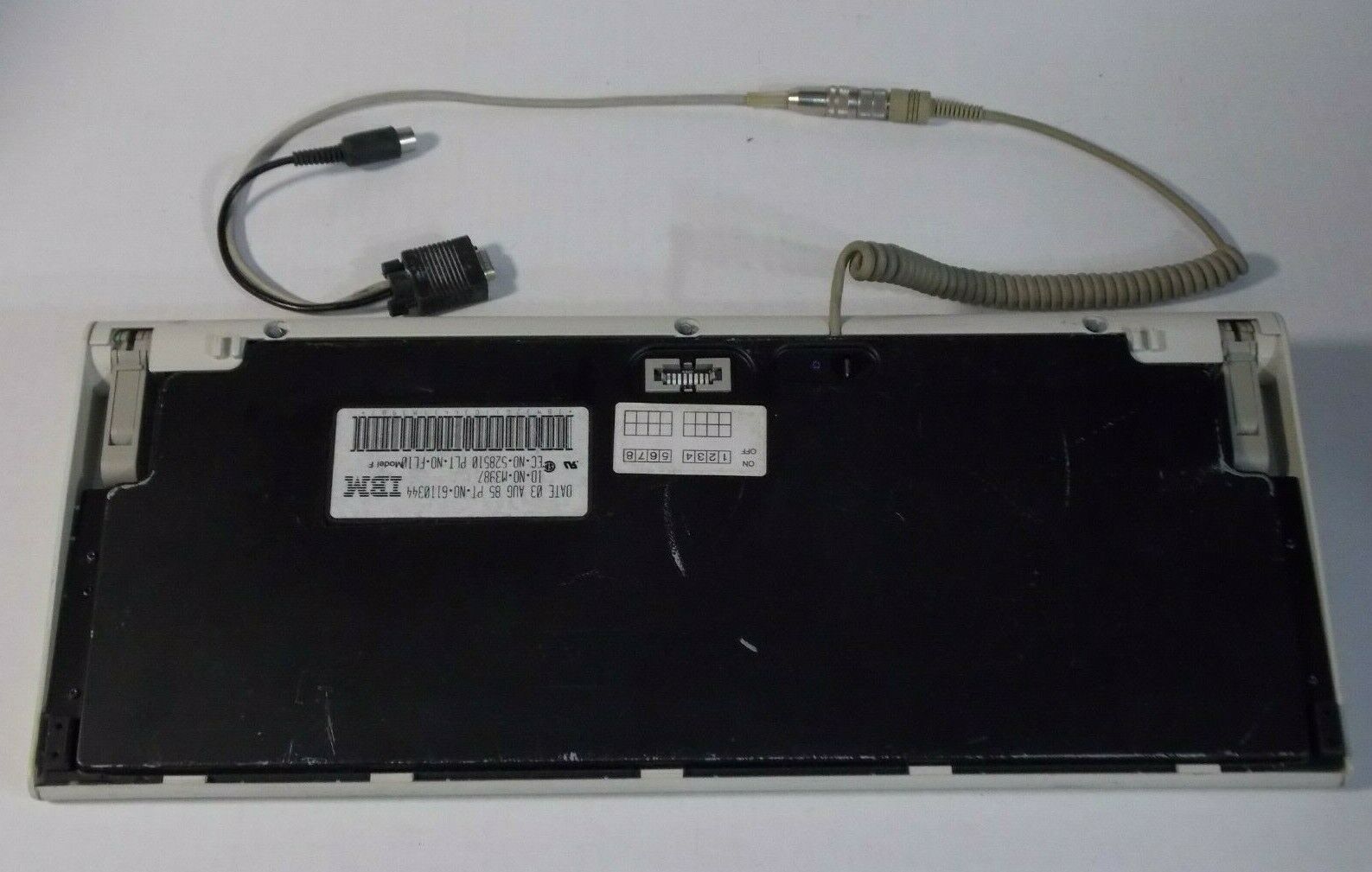

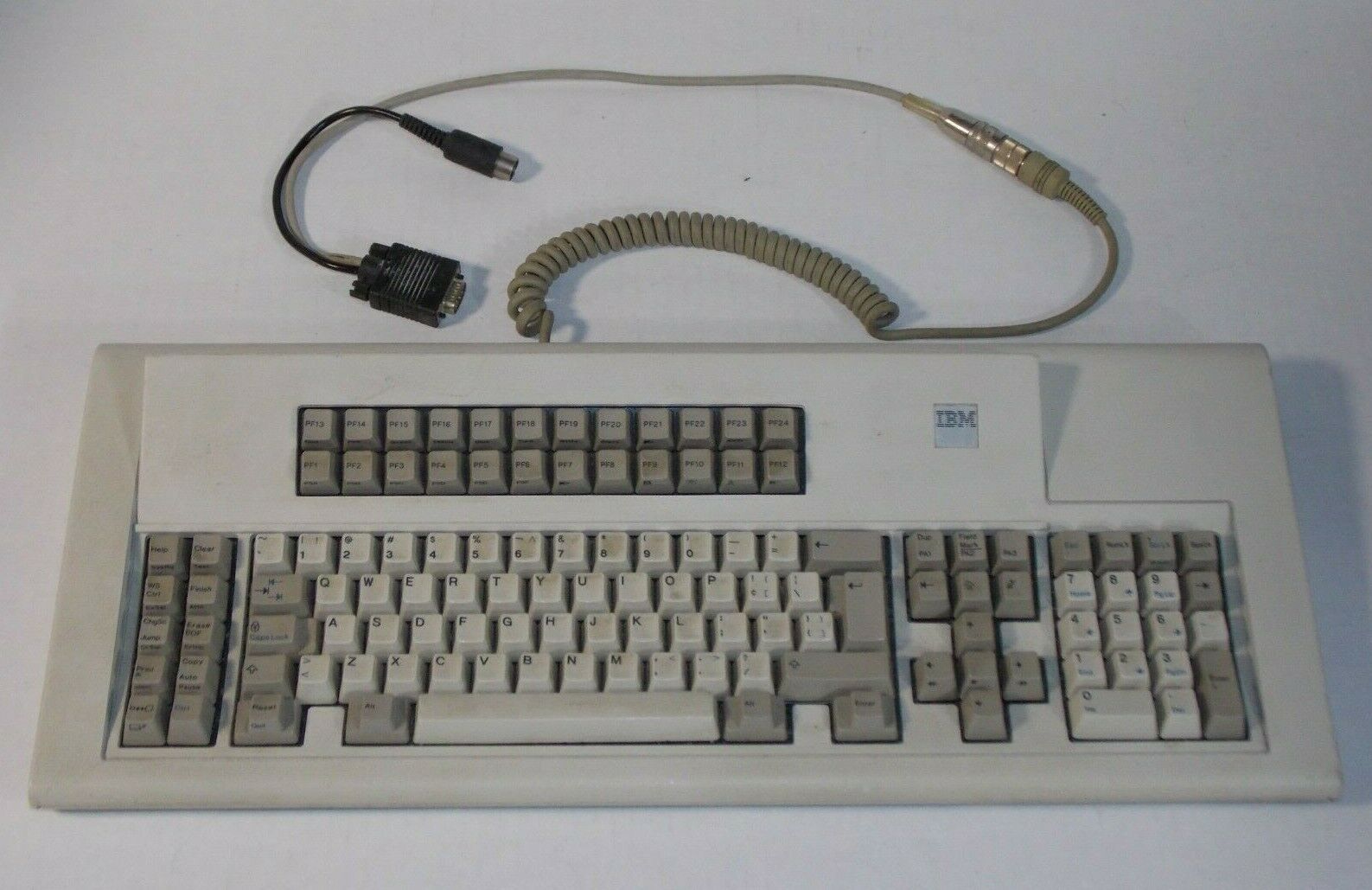

Hello again guys. I just wanted to show some pictures about my borderline stealed IBM model F 122.
This is what I got first:
And this is how is looking right now:

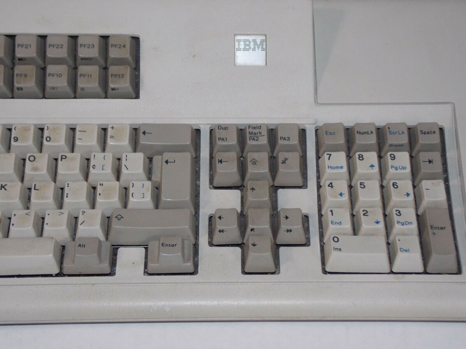

Customized numpad
Luckily I have spares of the model M spanish version of this keyboard, so it has not the originals, but pretty accurate keycaps.
Ufortunately isn't working (still). When I plug it with the Soarer's converter is plain dead, maybe is because of the modded cable I used. I really can't complain of this keyboard if I got it for that price.

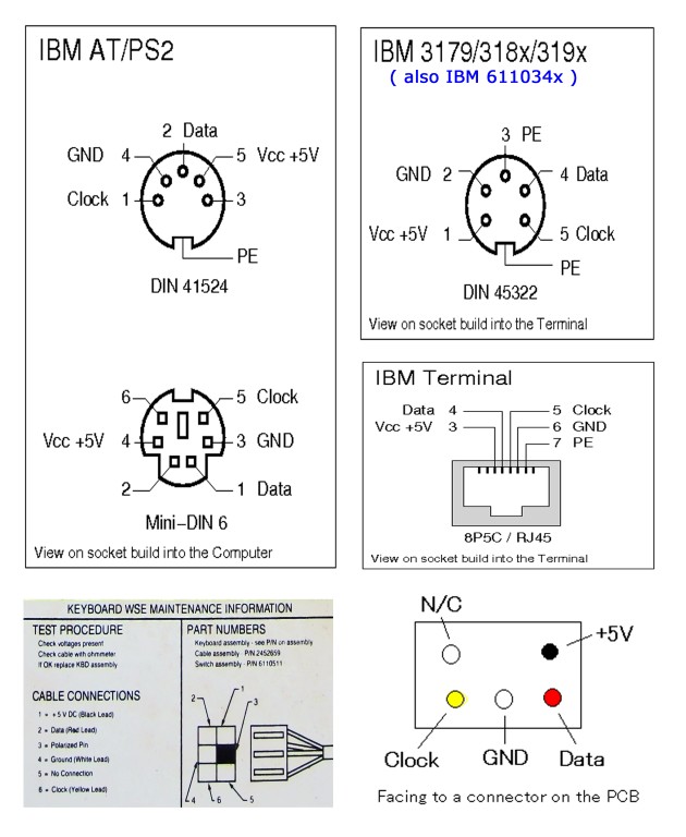

20 Apr 2019, 22:01
Don't trust the colors if you don't have the original cable, and remember that the diagrams show the socket, not the plug.
PlacaFromHell
20 Apr 2019, 22:07
Yeah, I worked with various converters already. What I did is measure the the continuity of the pins inside the plugs to the cables themselves and weld the original PCB connector to my IBM XT cable, like simulating a normal AT connector. I will check if I messed the connections in somewhere or just put something wrong.
Edit: it's working :lol: I swapped GND and DATA. Don't work more than 3 hours in the same keyboard without a break.

PlacaFromHell wrote: 20 Apr 2019, 21:05 Hello again guys. I just wanted to show some pictures about my borderline stealed IBM model F 122.
Lookin' good!
PlacaFromHell wrote: 20 Apr 2019, 21:05 Image
Customized numpad
I like that bottom row. ;-)

I'm using a homemade converter, but should be the same as the ones from Orihalcon. Because I don't have any DIN 45322 port I just joint the cable from my broken XT to the connector that goes directly inside the keyboard (they are not the same). At the end you will have something like this:
