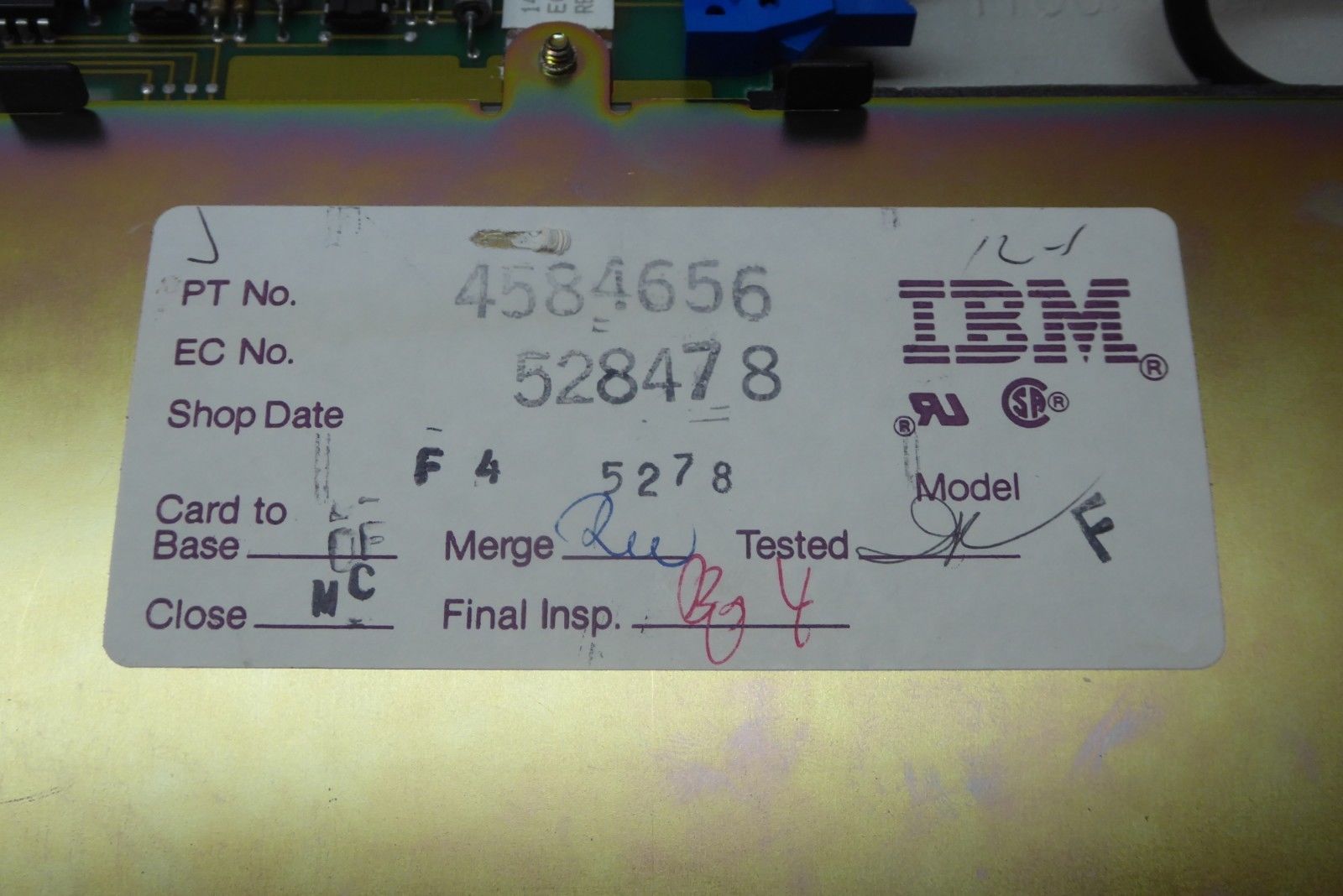

That's an interesting subject.
I have mostly UK-made Model Fs, where the stickers are a lot clearer in that respect.
With US-made ones it seems to be very difficult. Even the big stickers - shown in the youtube video - don't show the correct shop date, I think. Most of them show "dates" in the 90s, but some are quite impossible - like this one:
