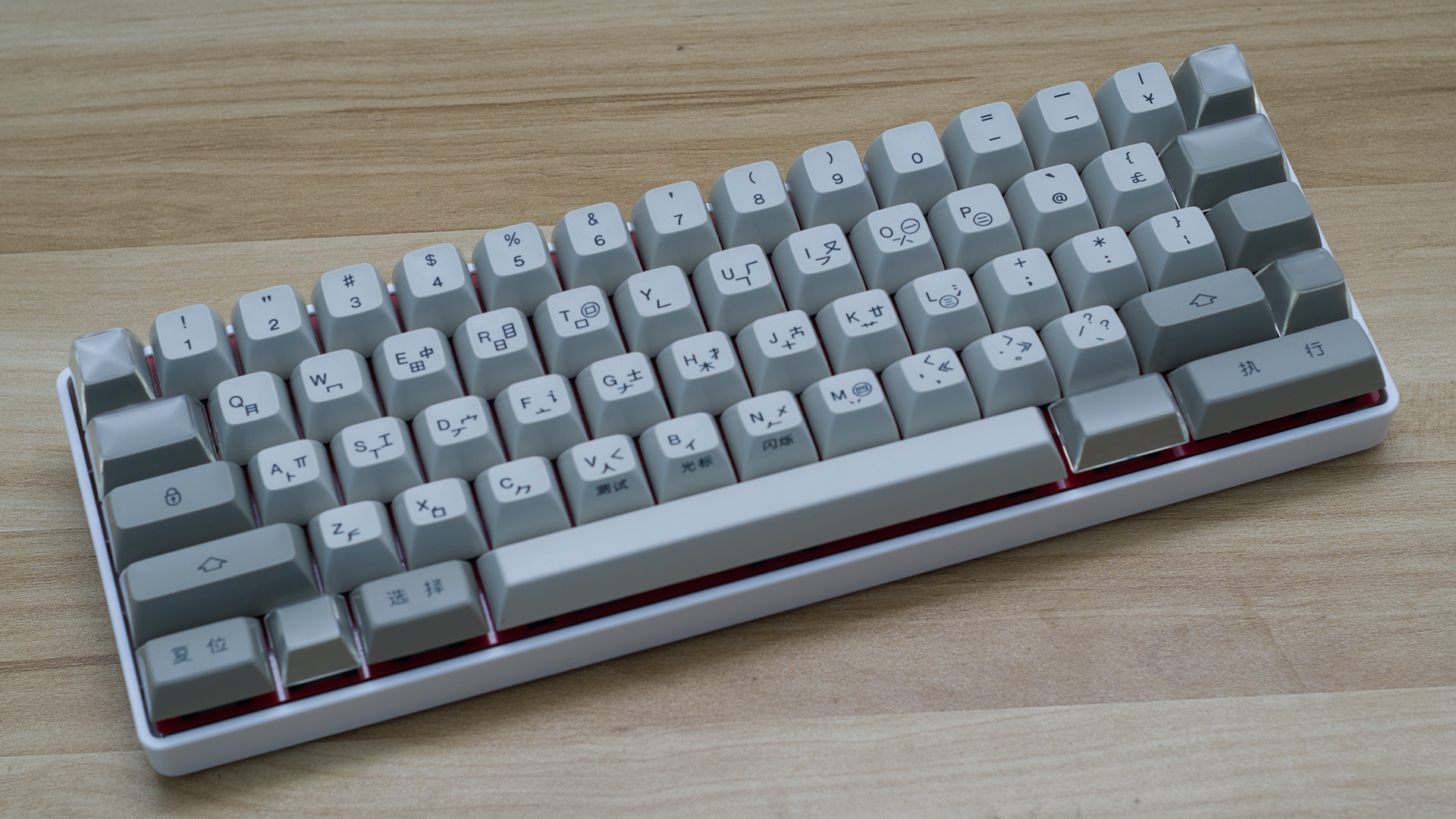

Hello guys. Some people are very interested in my new PingJunior build, so I decided to start a new topic here.
I have a Pingmaster keyboard that I get from eBay, this keyboard is really awesome, smooth switches and thick doubleshot caps. But it's too big for me so I made a custom pcb to turn it into a 60% case.
I used FR-4 plate so it's pingless, not sure what will happen if you use other metal plates.
My final HHKB layout build:

And answer some questions here:
scottc wrote: 27 Apr 2019, 18:50 Do you plan to run a GB or open-source the schematics or something? :)
I don't want to run a GB because price of pcb+plate is about $20, but shipping fee will be more than $30 from China. That's really weird.
So I will put them on TaoBao, maybe find a proxy can save your money.
And this PCB not only support SKCC, but also SKCM/L and Omron B3G-S. Too many holes there and I designed the PCB in a rough way, schematics looks like shit. I will share some footprints and plate files.
zrrion wrote: 27 Apr 2019, 21:19 Support 1.5, 1, 1.5 on the right of the spacebar would be cool too.
1.5, 1, 1.5 and 1.5, 2.5 can use the same plate.
the_ambyguous wrote: 28 Apr 2019, 06:39 also, do you notice much of a difference between NOS from tao vs the NOS switches in the pingmaster?
They are pretty much the same. But 1/10 of NOS switches are a little bit sandy, might need lube.
Another thing is I rotate the switches by 90 degrees (like Apple m0110), they could be a bit smoother.

abrahamstechnology wrote: 29 Apr 2019, 18:19 Wow, great work!
Do the Alps stabilizers have enough clearance from the B3G-S switches?
They are running smoothly, my few keys are overly thick for B3G-S (F, J, Spacebars). Most of alps caps should be fine.
clickityClackity wrote: 30 Apr 2019, 00:17 Hell yes, very cool! Would def pick a PCB/plate up if you link them. Standard 60% case compatible?
Cases are compatible but SKCC is taller than MX

Drclick wrote: 02 May 2019, 21:50
Good, Tai-Hao caps would fit (except for the spacebar which could use a Cherry plate mount stab)
