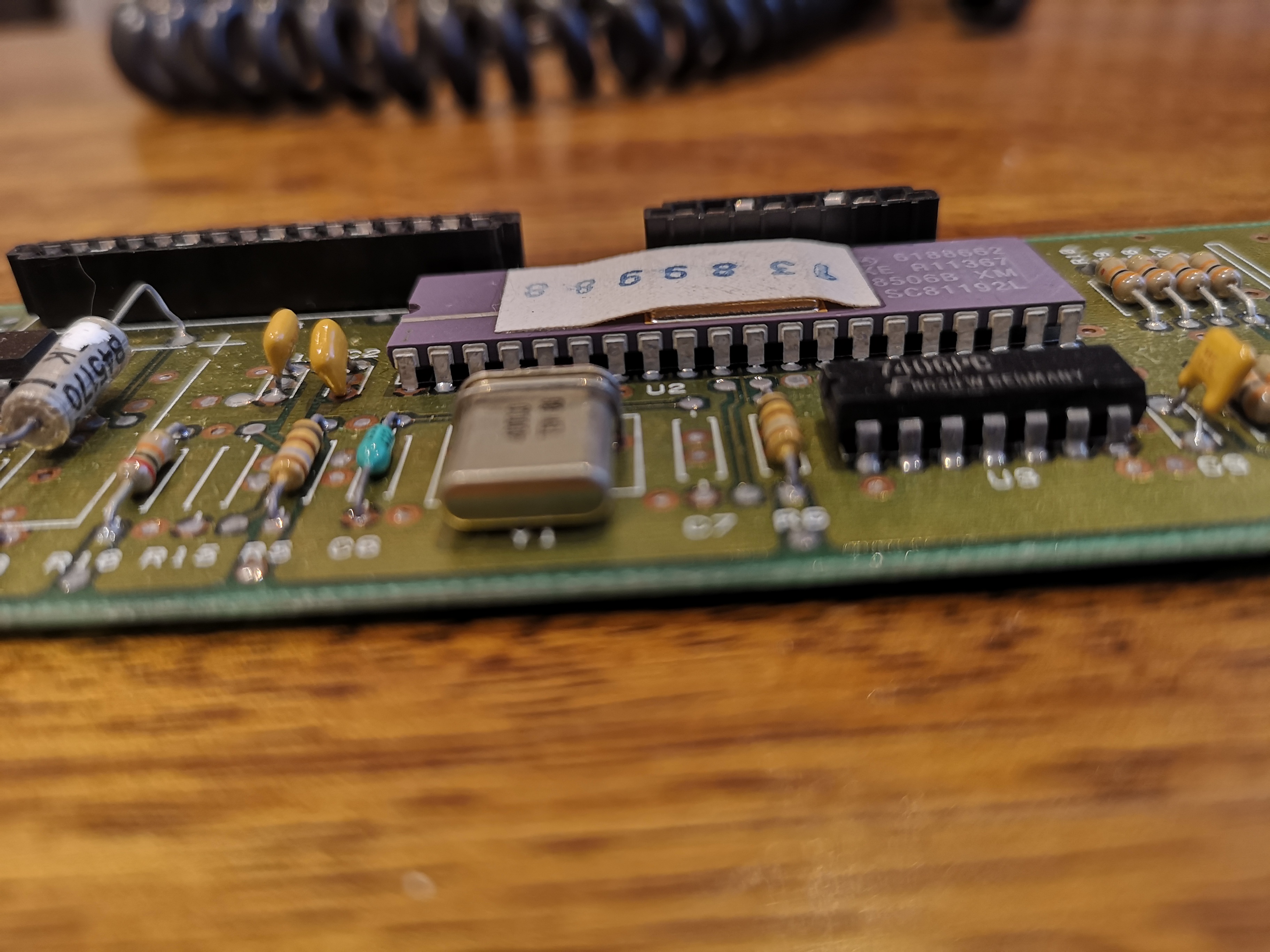

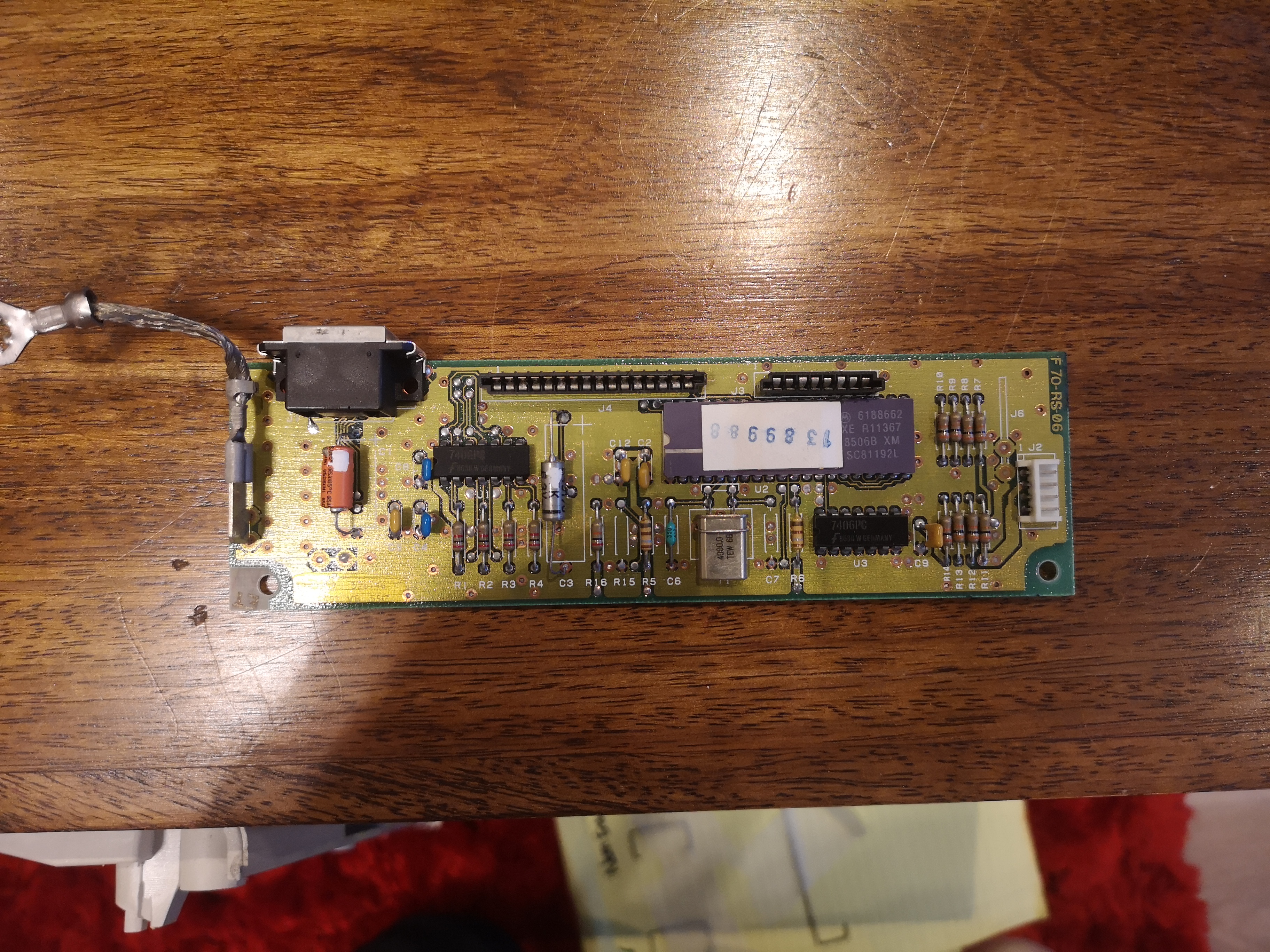

So today I opened one of my really old IBM Model M's and it has a controller unlike any I have seems before on my other Model M's please help me identify please see image.
It seems to have a metallic thing on the main chip with a sticker over it should I pull the sticker off and take a picture of what's below?

- Polecat
The sticker is there to prevent the contents of the controller's internal EPROM from being erased (by exposure to UV light). If you remove the sticker you risk losing the contents of the EPROM. Later/cheaper/mass produced controllers used one-time PROM instead of EPROM (Erasable Programmable Read Only Memory) so those aren't reusable and don't have a window.Fkazim wrote: 04 May 2019, 19:37 So today I opened one of my really old IBM Model M's and it has a controller unlike any I have seems before on my other Model M's please help me identify please see image.

But when you say Later/cheaper/mass produced controllers would that mean that the Model M keyboard this controller came out of is a pre production/prototype model?

Well you don't even have a pic of the label or list the part number in this thread but it sounds like you have an early production model and not a prototype. The controller looks fairly standard to me. The earliest production Model M's were made in 1985 and prototypes I believe date to later in 1984.

part number is 1389969 and the keyboard has a square silver metal IBM badge with no lock lights hope that helps.

I believe your board is essentially the ISO / UK version of the IBM 1386303 which is pretty much the first of the Model M keyboard's which were not intended for PC's.

The very first Ms had a repurposed, depopulated terminal controller from 1984 and the famous Mandolin crystal; this one lacks both.Still, a 1986 M is always a great find, so congrats!
