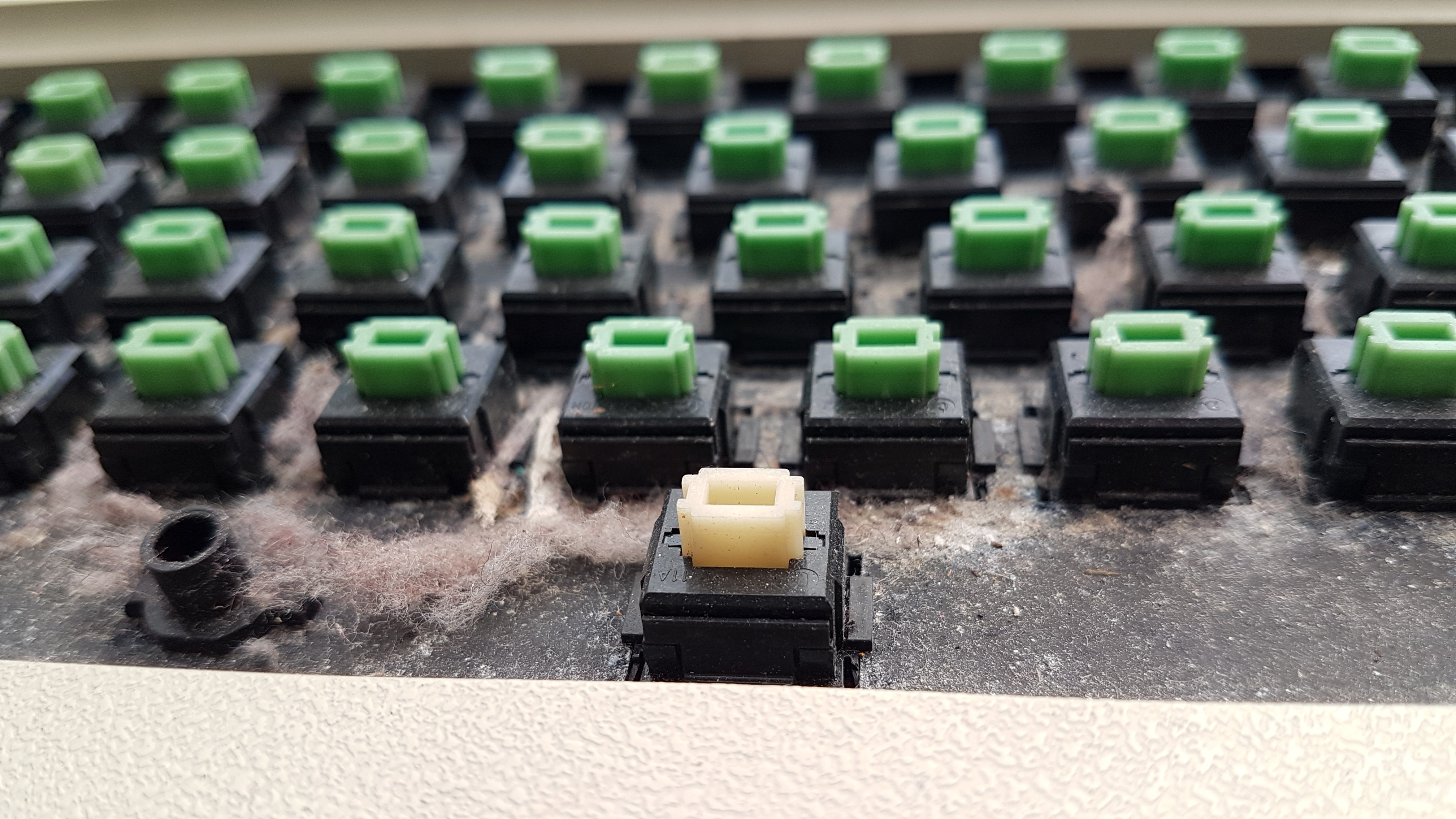

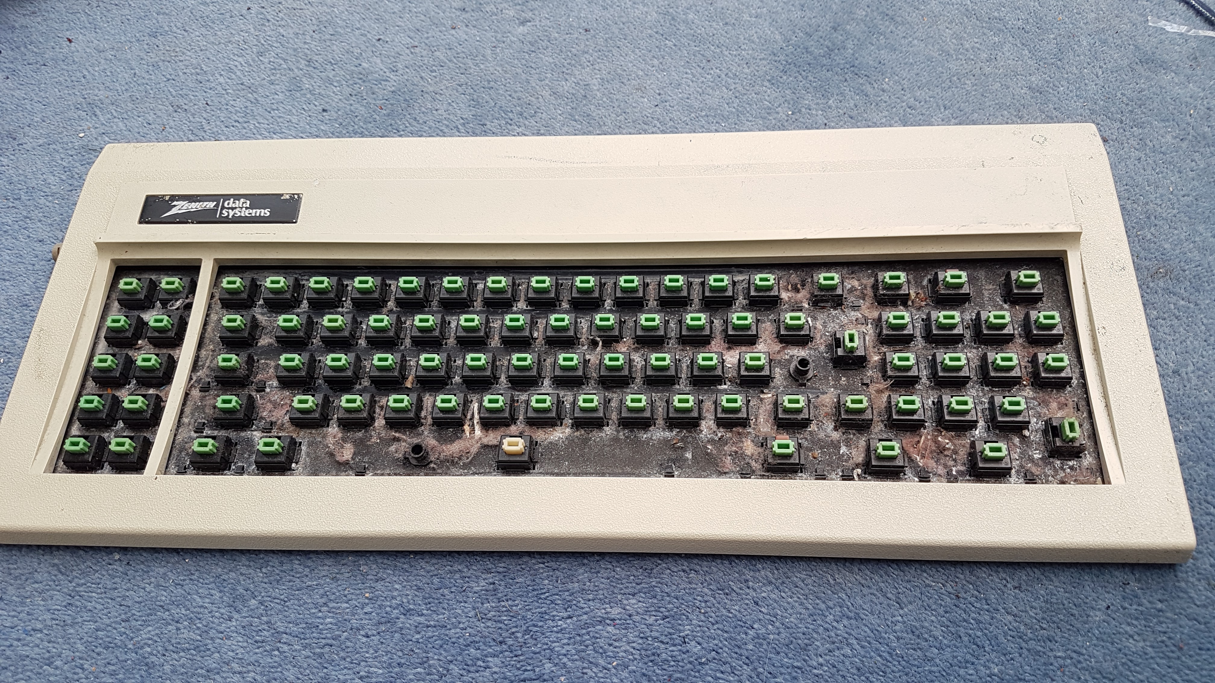

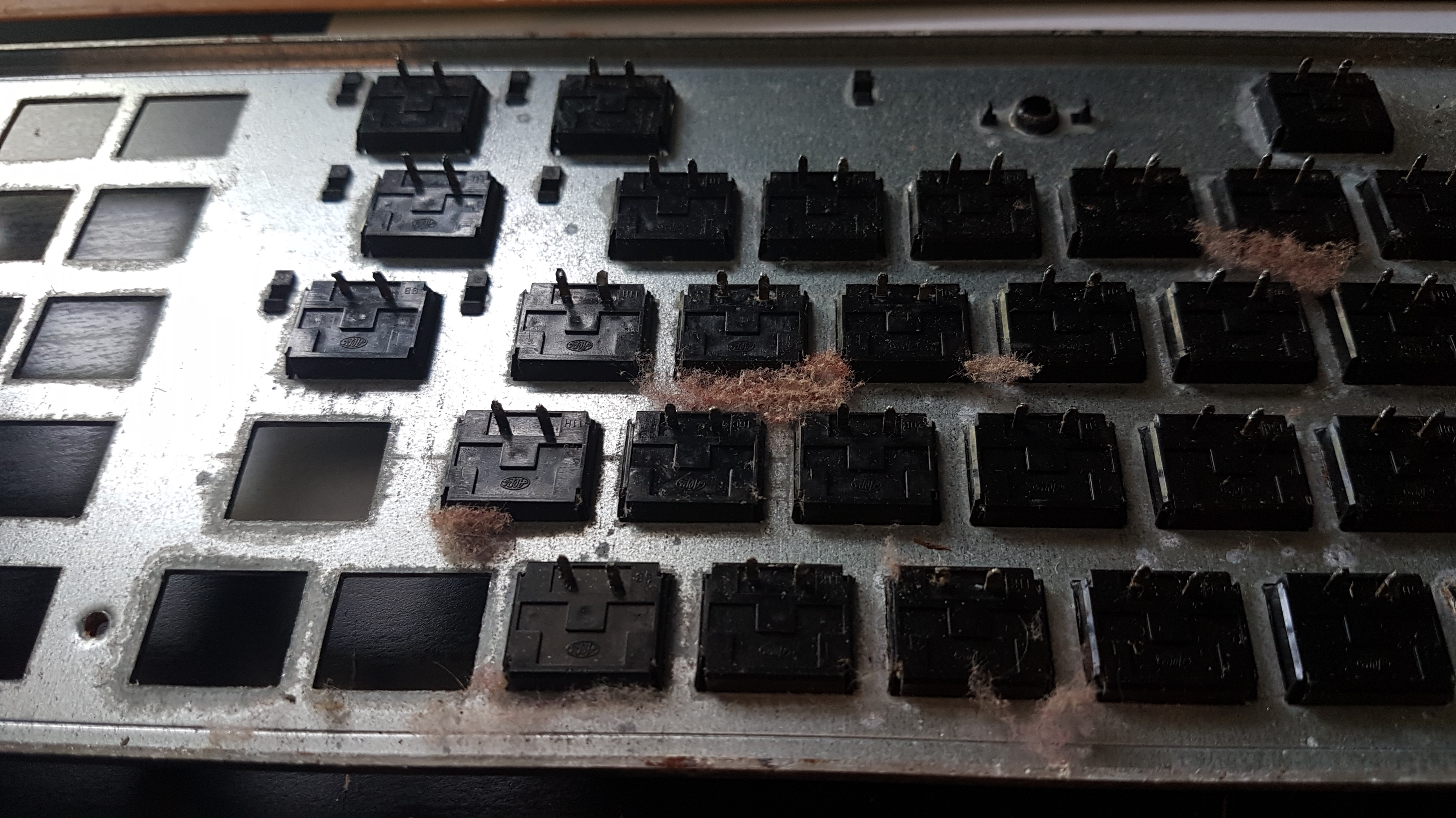

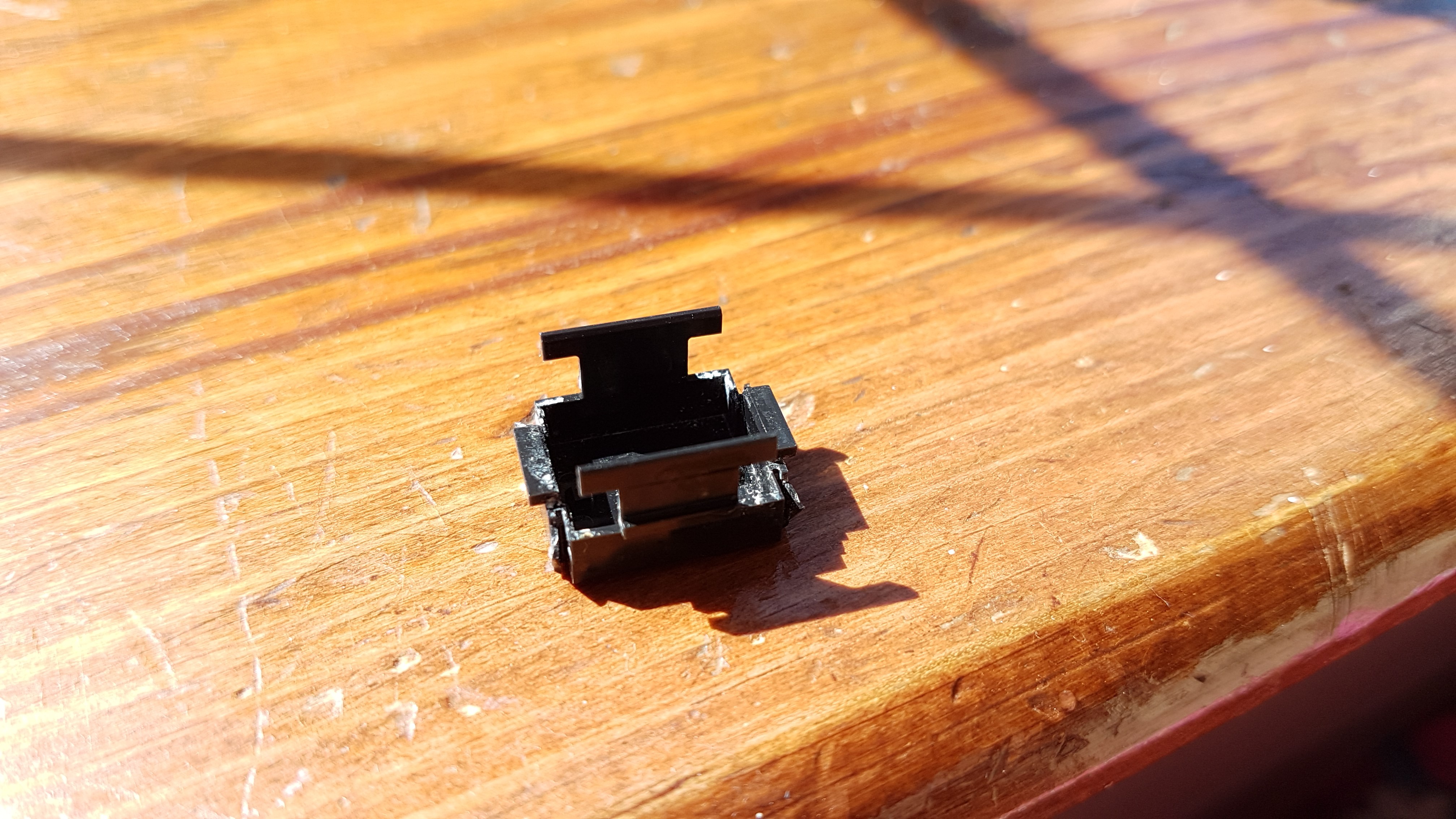

Day 1: The keyboard has arrived! There were only 2 photos of it on the listing so I could not see exactly how bad it was but to be honest it is much worse than I expected. The bottom is rusty and bent, the cable is cut (might not even work?), the plate is loose, the entire plate is covered in what looks like the fluff from a tumble dryer and it has LOTS of dirt in it (I'm pretty sure this was stored outside at some point, uh oh). Some switches feel like complete shit while others feel perfectly fine but I can't complain about green alps.
close switch.jpg (1.64 MiB) Viewed 8119 times
I've built a Teensy converter using the remaining original cable/connector and it works! Some keys don't register but after checking with a DMM, this is purely a hardware issue (I will be disassembling the switches to try and fix this)

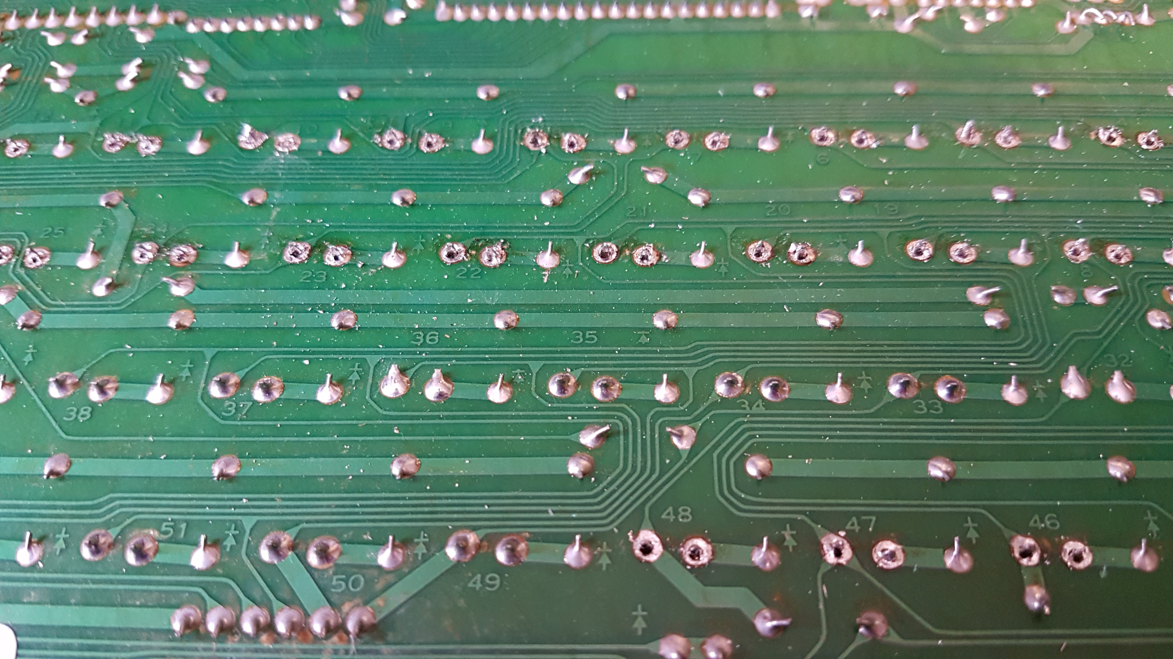

I have started desoldering the board. My iron is on its last legs and the sucker is practically dead which made this really painful and difficult. This is admittedly the worst desolder job I've done but I can't afford a new iron at this time. In a few instances, the pads have been torn from the PCB (poor heat control + 30 year old PCB don't go well together) so I will need to jumper those. I can't decide if I use the original PCB or handwire it when it comes to assembly.
Aran.E99
12 May 2019, 18:07
Finally got the PCB desoldered - what a pain. Some legs decided to randomly snap of while desoldering which was probably due to the liquid damage visible on the plate and PCB however there is enough material for me to solder to when handwiring.

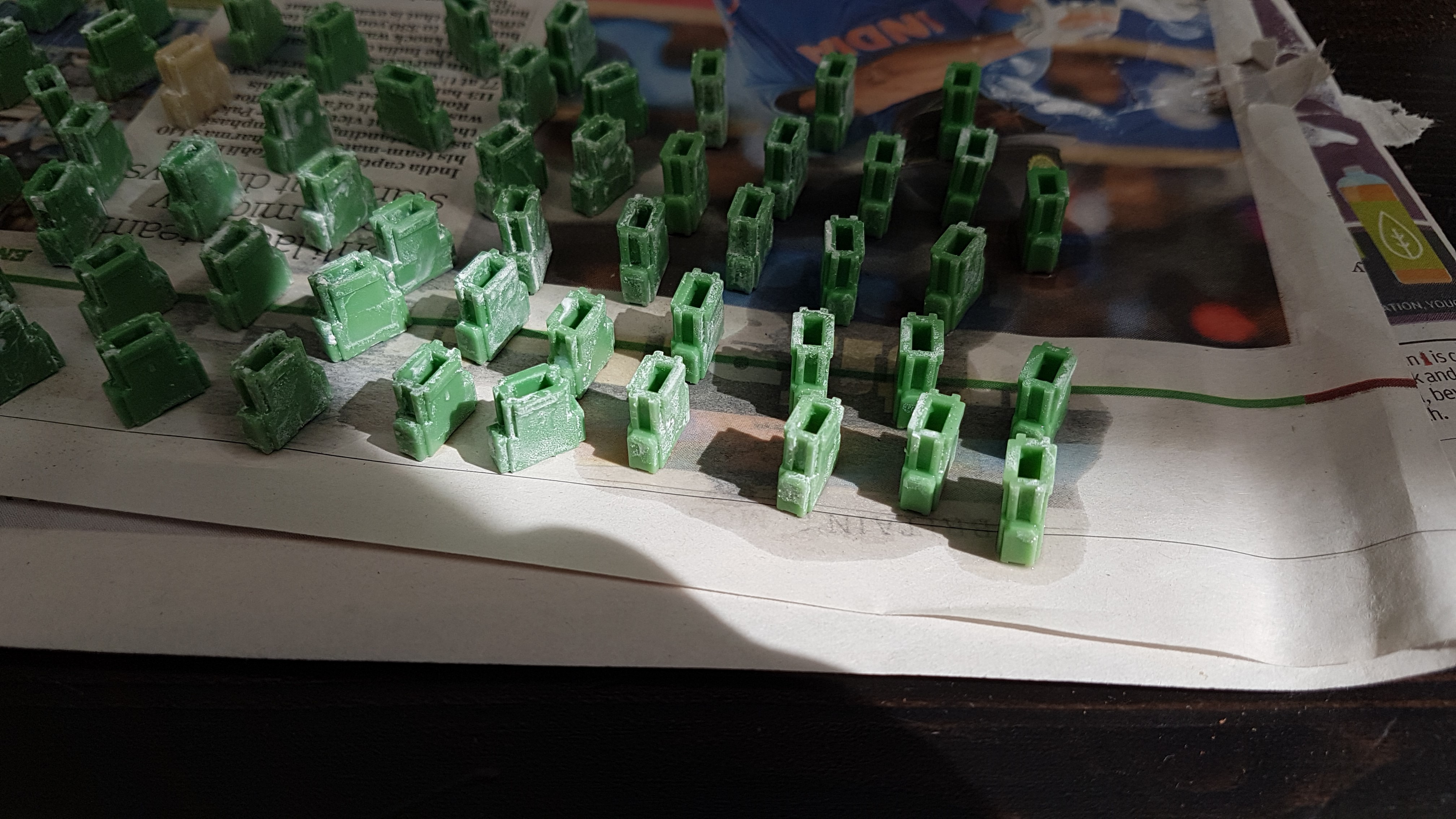

The Isopropyl alcohol arrived today so I decided to start cleaning/lubing the switches. I first poured some IPA onto the switch housings which were all covered in that same milky substance in hopes of removing it. I mixed up some IPA and PTFE powder and put the sliders into the solution to evenly lubricate them (I used Delirious' method; thanks!) then set them aside to dry.

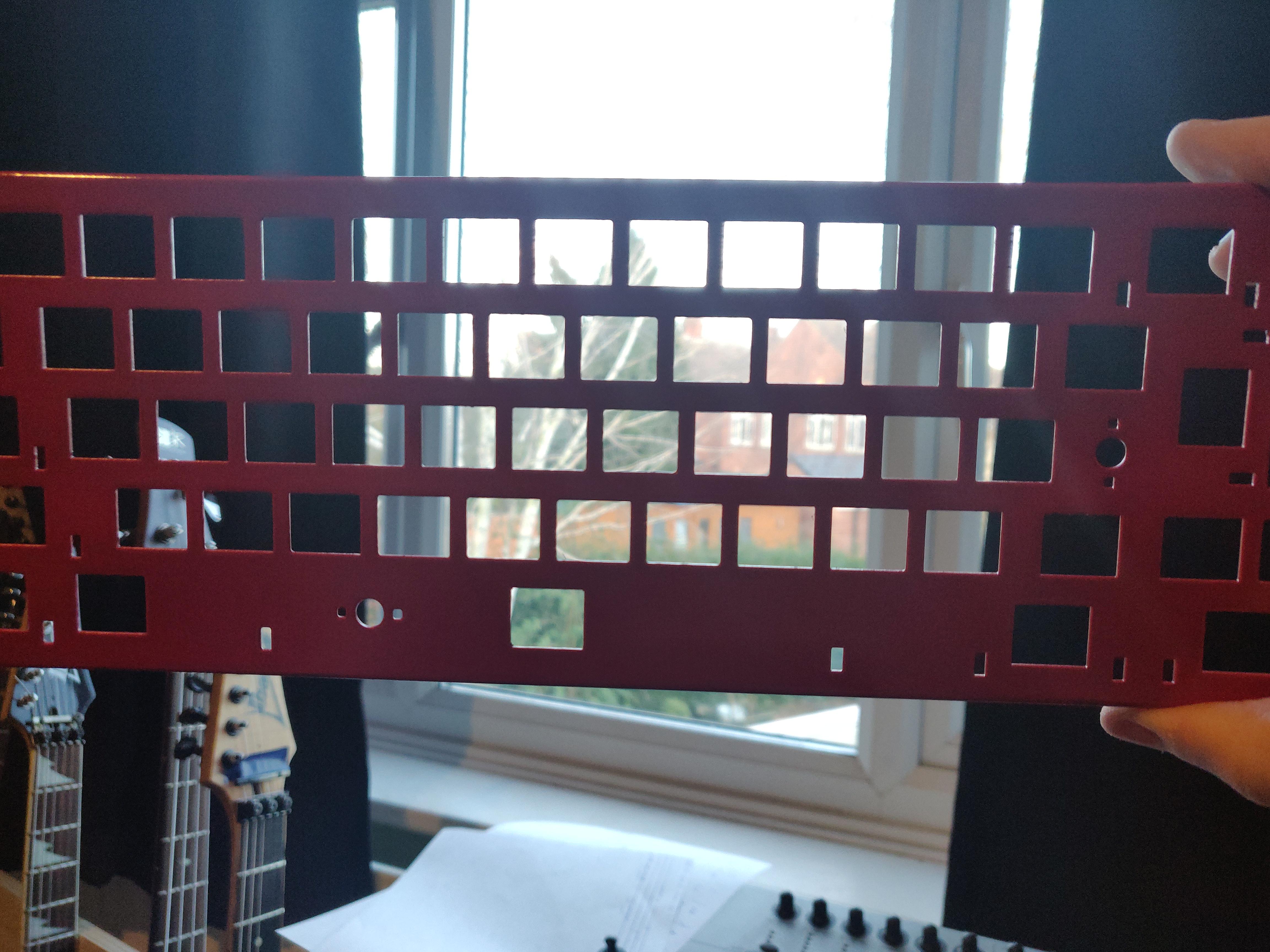

Since the plate had the same white residue, I tried scrubbing it with a sponge dipped in IPA so that I didn't have to waste time sanding the paint and repainting it. Sadly, the IPA did nothing at all so I'm going to try some 1000 grit sandpaper in hopes that it will preserve the paint.
I'll update later once the switches are assembled.

There's not a huge amount of progress to report since the last post however I've finished painting the back plate and recently got the switchplate painted. Here's a teaser:
Painted Plate.jpg (1.52 MiB) Viewed 7202 times
Once the enamel paint has fully cured, I will install the switches and show it off in its current form. After that, all I need to do is hand-wire it and finally program a controller. My main concern is the rushed job of lubing the switches. I feel like I put way too much PTFE powder in and as a result the switches don't feel as smooth as they could. I don't know if I can be bothered to disassemble them and start over so hopefully they feel better inside a keyboard.

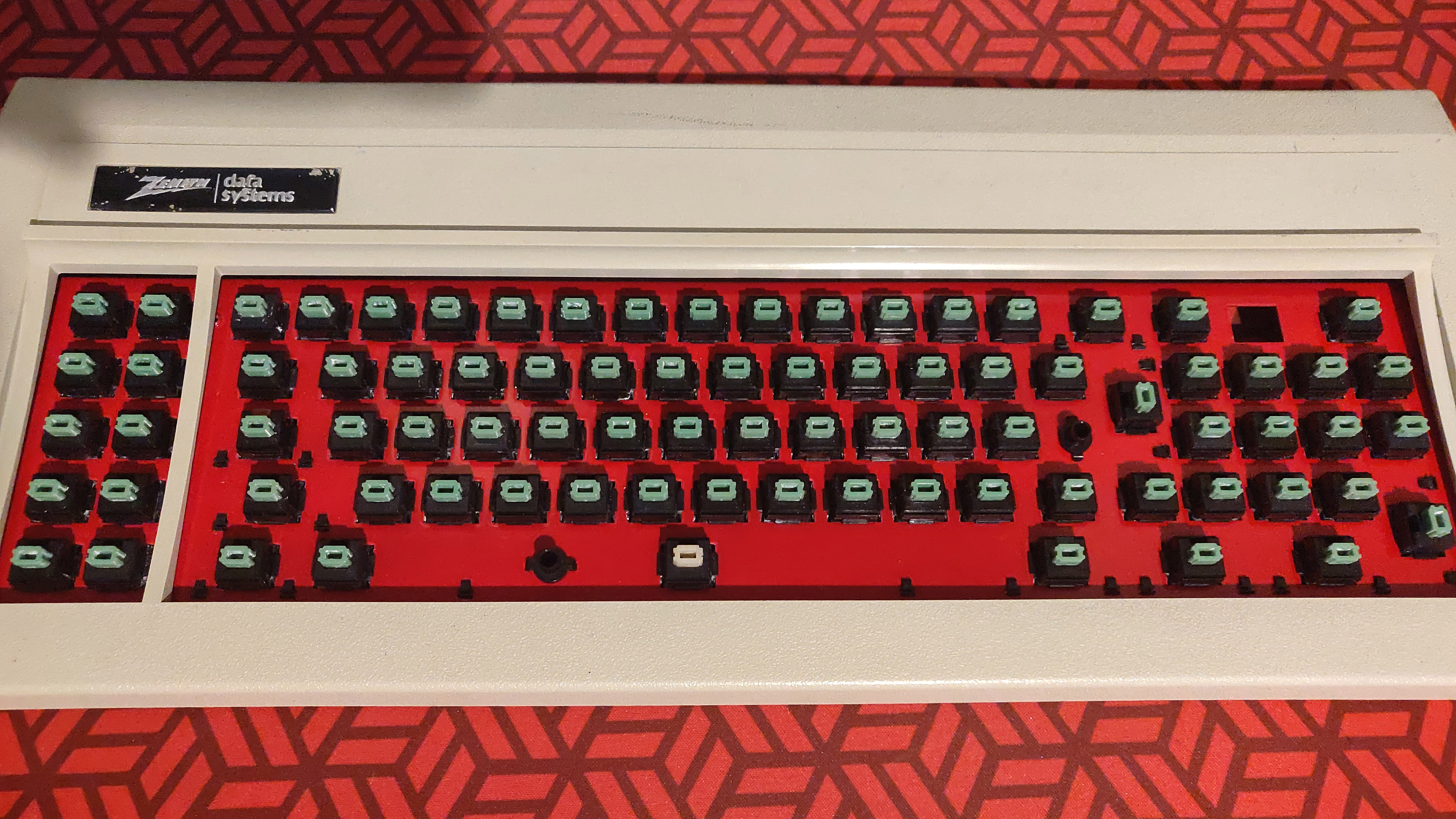

Finally got the switches back in the plate! now I need to decide if I handwire it or use the PCB + a converter. My issue with handwiring is that pulling the keycaps will result in the switches coming out. On the other hand, half of the traces are gone on the PCB so I may end up using the PCB but partially handwiring it...
test fit.jpg (2.03 MiB) Viewed 7103 times

Half of the switches are soldered in but I'm having issues with 2 or 3 terminals being too short as they snapped during desoldering so I might have to bore out a few PCB holes. Sorry for the constant teasers but I've at least gotta show this off before I finish soldering (I know, seems a bit silly to put the caps on before soldering but how could I resist?).
I've done an out-of-case typing test and it is honestly one of the nicest feeling boards I've typed on even considering that the switches were dirty and might have been over-lubed. Hopefully I can finish this project soon and finally have something that feels incredible to type on after all this time!

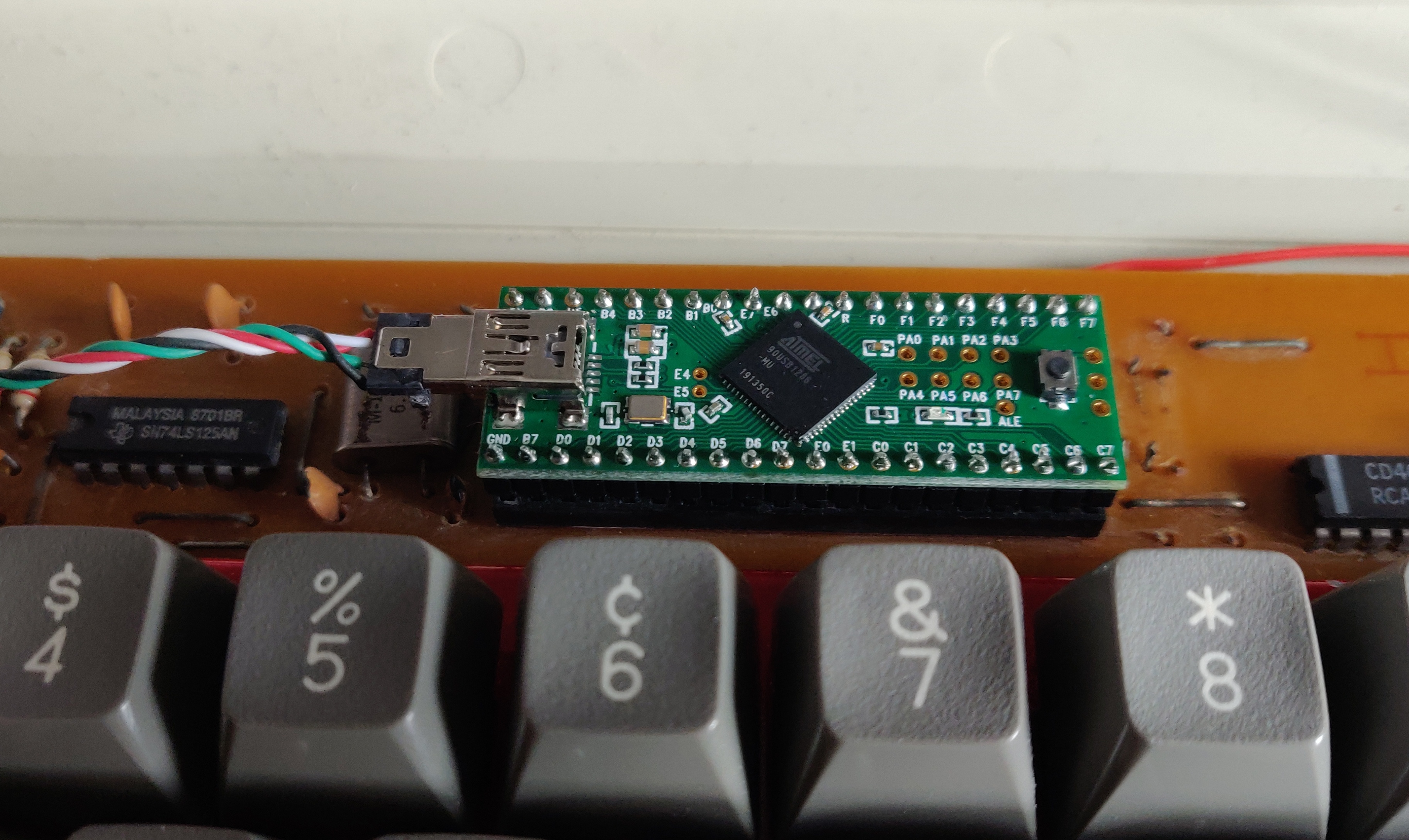

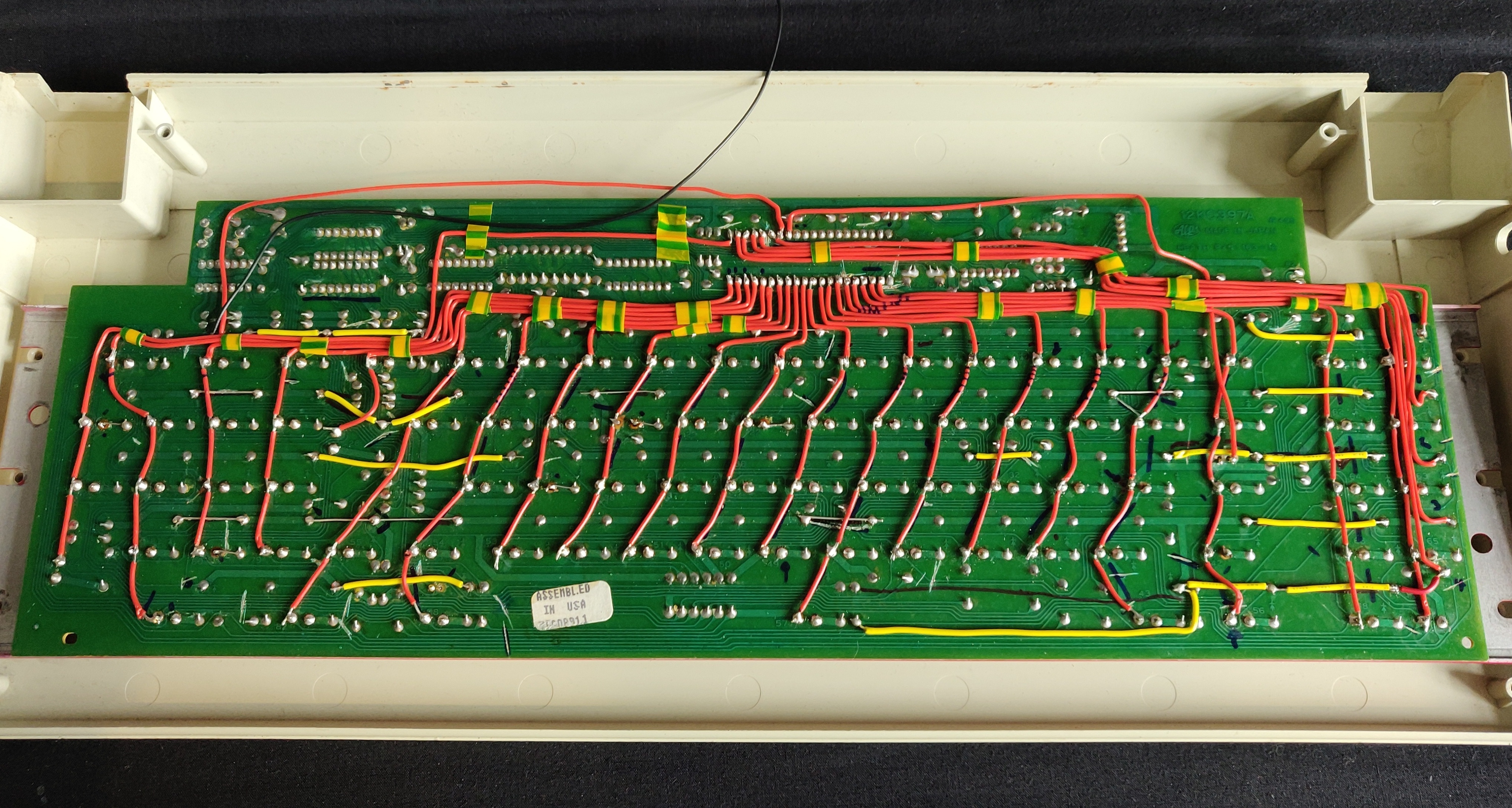

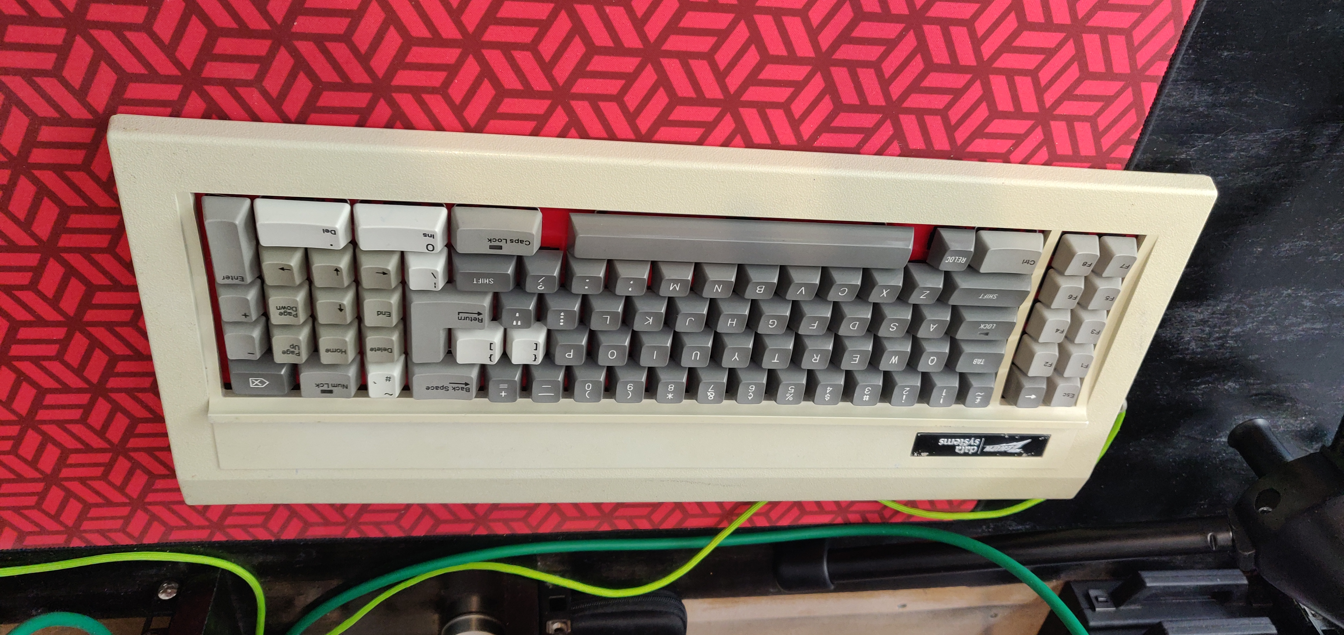

Hey everyone, I apologise for the blueballs but some stuff came up as per usual so I've not had much time to work on this. From where I left the project: I originally intended to trace the matrix and wire it with a Teensy 2.0 but I soon decided that I wanted to handwire the matrix and use the PCB as a structural support for the switches so I sliced the traces and wired it all by hand. This meant that I had to order a Teensy 2.0++ but I couldn't find a good source at the time so it spent 2 months or so stuck in China mail. In hindsight, I should have used an internal converter but there's no telling in how long it would take for the original controller or something else to die on the crusty PCB. Anyways, I got the matrix wired up and decided to use the old controller's slot to mount the Teensy.
Onto the firmware: I wanted the layout to have some specific features, including a function key so that I could use all F keys and access * and / on the numpad. I'm still using TMK and WinAVR ( :oops: ) but every single time I've compiled for a project in the past, I've had errors not relating to the keyboard files, rather the compiler itself. To my surprise I had no issues this time around. As of right now, the keyboard is 'working' and its first message was: qqqqqqqquj 5tgb5tgbttrt tgb ggb ou5tgb gbbfb bb tgbbgb wetatgbgb tg 5tgbob 5tg5tgbmtgbggg ggg5tgbkettttb oqqqqqqqs. I've had a look in Aqua and it seems like some colums are shorting and some switches repeatedly fire when held down. I'll upload some pics of my sloppy, somewhat depressing wiring later/tomorrow and I'll follow up with pictures of the finished board once I get it properly diagnosed.

99% of the issues have been fixed by adding a longer debounce time and bit shifting the columns which I forgot to do in the first place. Sadly a few switches are bad so I'm gonna have to desolder and clean them. about 6 switches intermittently send multiple characters so I might have to increase debounce more or desolder and clean those too.
This could've been a lot cleaner but I'm happy with the outcome. Next time I'll just trace the matrix so I can preserve the PCB.

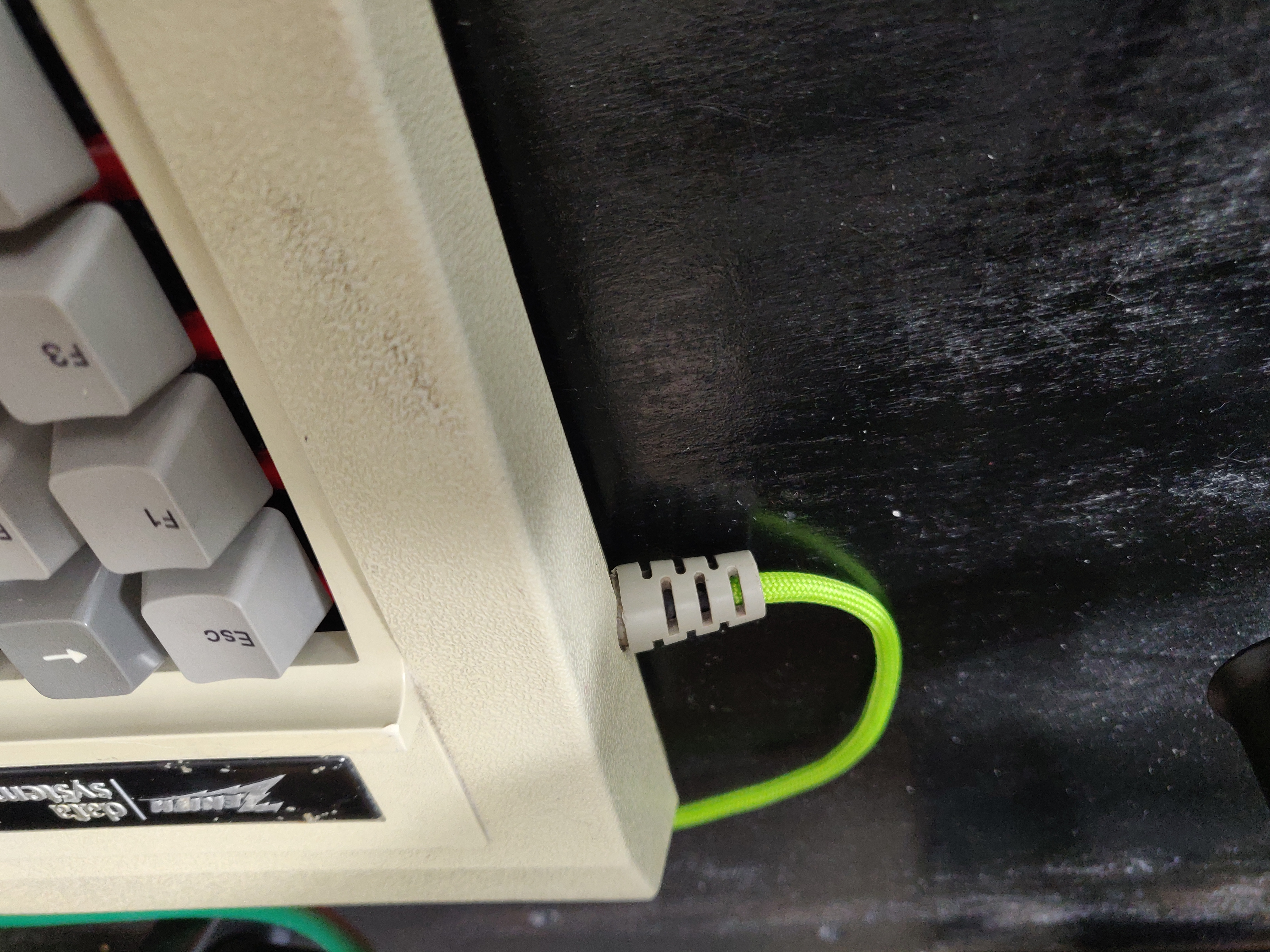

All I have left now is repairing a few switches, soldering lock LEDs & soldering the cable and then I should be done. Speaking of the cable, I had to go with neon green paracord as I've lost my black paracord somehow. The green doesn't look too bad but it doesn't really match the aesthetic of the board.
Aran.E99
20 Jul 2020, 13:09
Finally finished....
