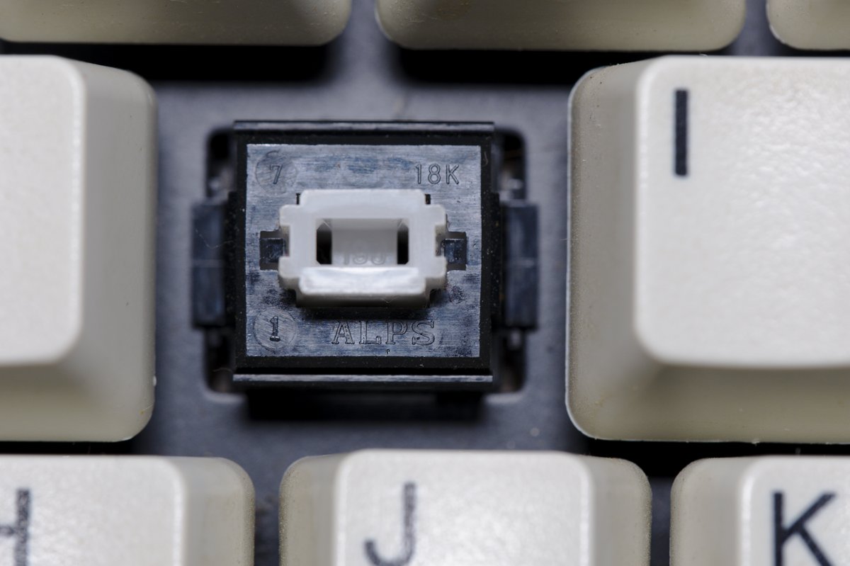

I recently picked up a Focus 5001 with white Alps. Even the calculator works! Looks like they may even been older complicated Alps with the slits and mould numbering too. I'll have to get some macro shots for the Alps experts here to let me know what I have but for now I've got a simpler question: what sort of USB adapter do I need for this thing?

Edit: here's the photo of the switches, looks like what the wiki calls Pine Alps? Really more familiar with IBM equipment myself.
08 May 2019, 07:05
Yup, pine white Alps, nice! Looks very clean, too!
I used my 5001s over USB just via a Soarer's, as I recall.
