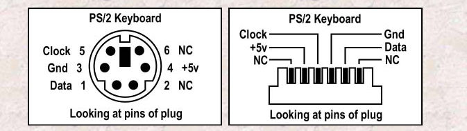

Hello, I want to ask what the 6-pin line order is, I also want to rewire, thank you
Compgeke
16 Jun 2019, 15:02
It's not quite as straight forward as a 1-6, but here's what I made as a personal note when doing it:
The left column is the only one you'll need, the right was just my reference for cables I was I was using as replacement.

Look at it, which color is the corresponding number?

DGmc wrote: 16 Jun 2019, 15:21 Look at it, which color is the corresponding number?
Mouse:
Green: PS/2 Pin 1
Black: PS/2 Pin 3
Red: PS/2 Pin 4
Yellow: PS/2 Pin 5
Keyboard:
White: PS/2 Pin 1
Black: PS/2 Pin 3
Red: PS/2 Pin 4
Brown: PS/2 Pin 5
