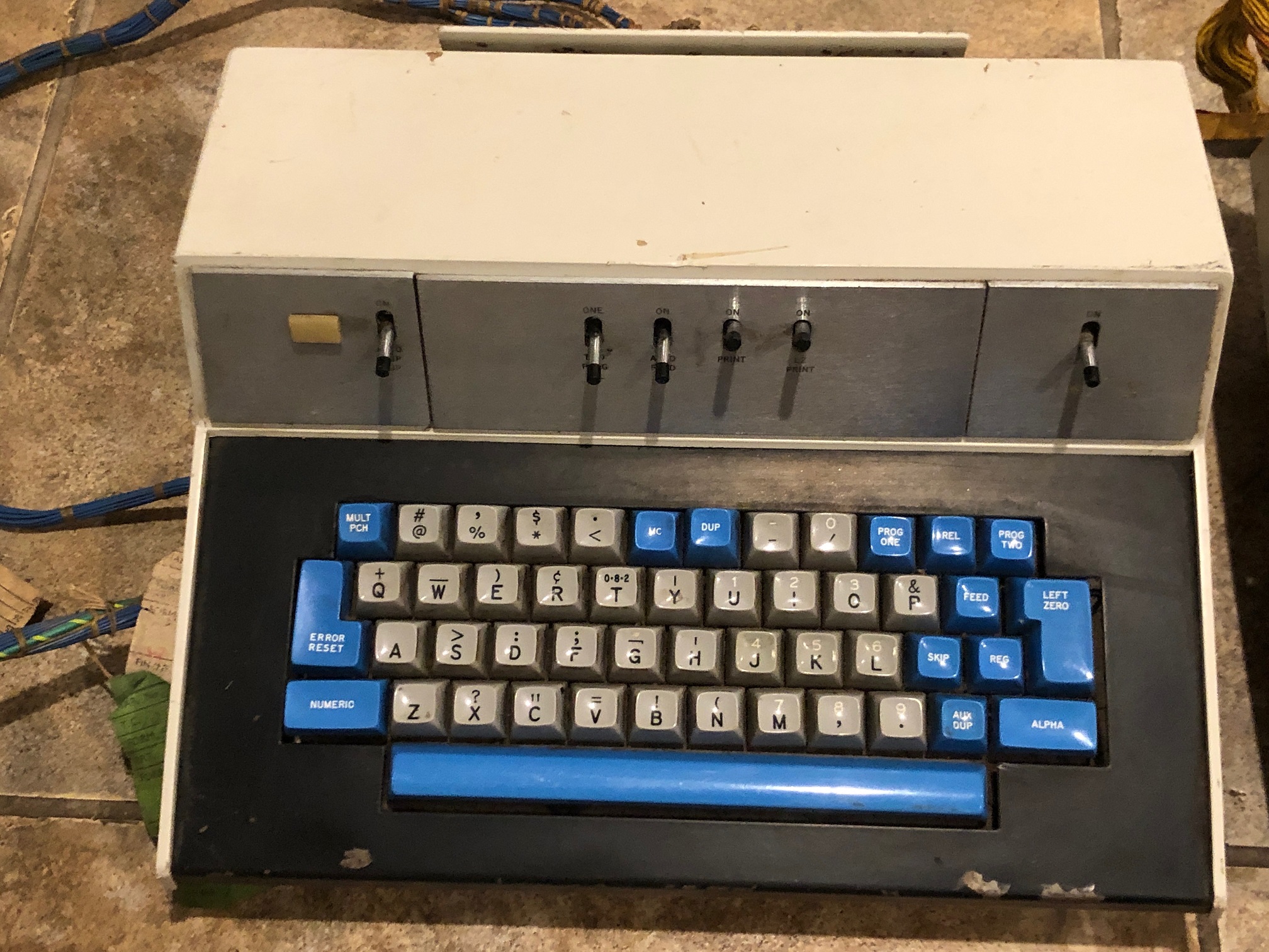

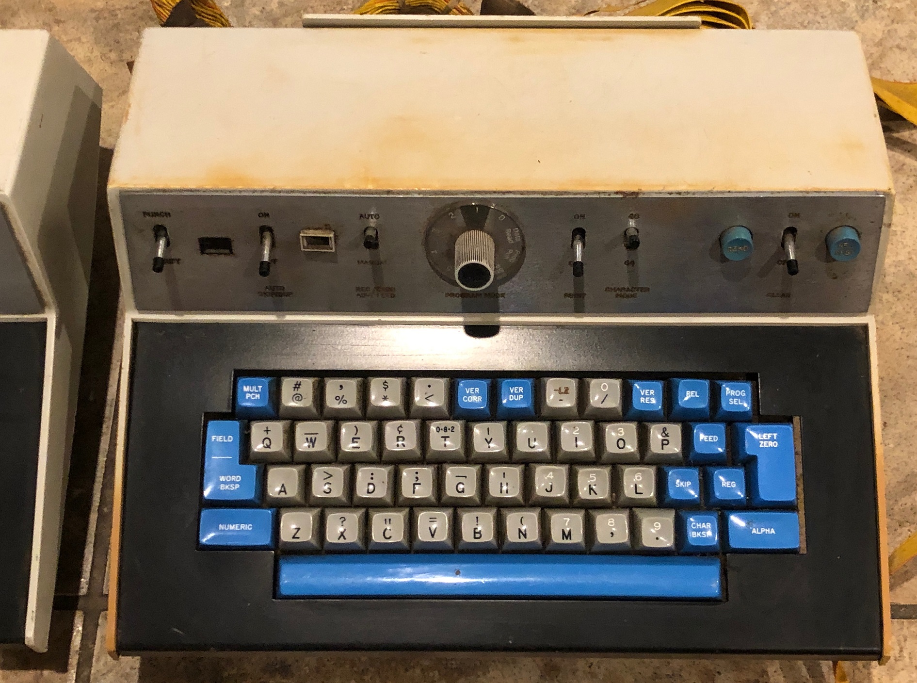

sorry to bump and old thread, but ive almost got the converter built, just need the time to finish it, and program it. in other news i know have a IBM 129! here's some images from the ebay listing!
i have to admit the buttons and dials and toggle switches look pretty hot on this board
the mechanism looks really really similar to that of the 029, so this should be a "quick" restoration
yup older than me by only 18 years! perspective! thats buddy cop movies to layne staley!
the connectors are very very different, its gonna be super hard it seems to find a block like the one i found for the 029

18 Jan 2020, 06:30
I'm joining the club as well. :) Hopefully I can begin to understand how these work :o
I can already smell the cigarette smoke from here.
John Doe
18 Jan 2020, 08:23
JP! wrote: 18 Jan 2020, 06:30 I'm joining the club as well. :) Hopefully I can begin to understand how these work :o
Nice find, JP!
Is that another one at the left of the pic?
