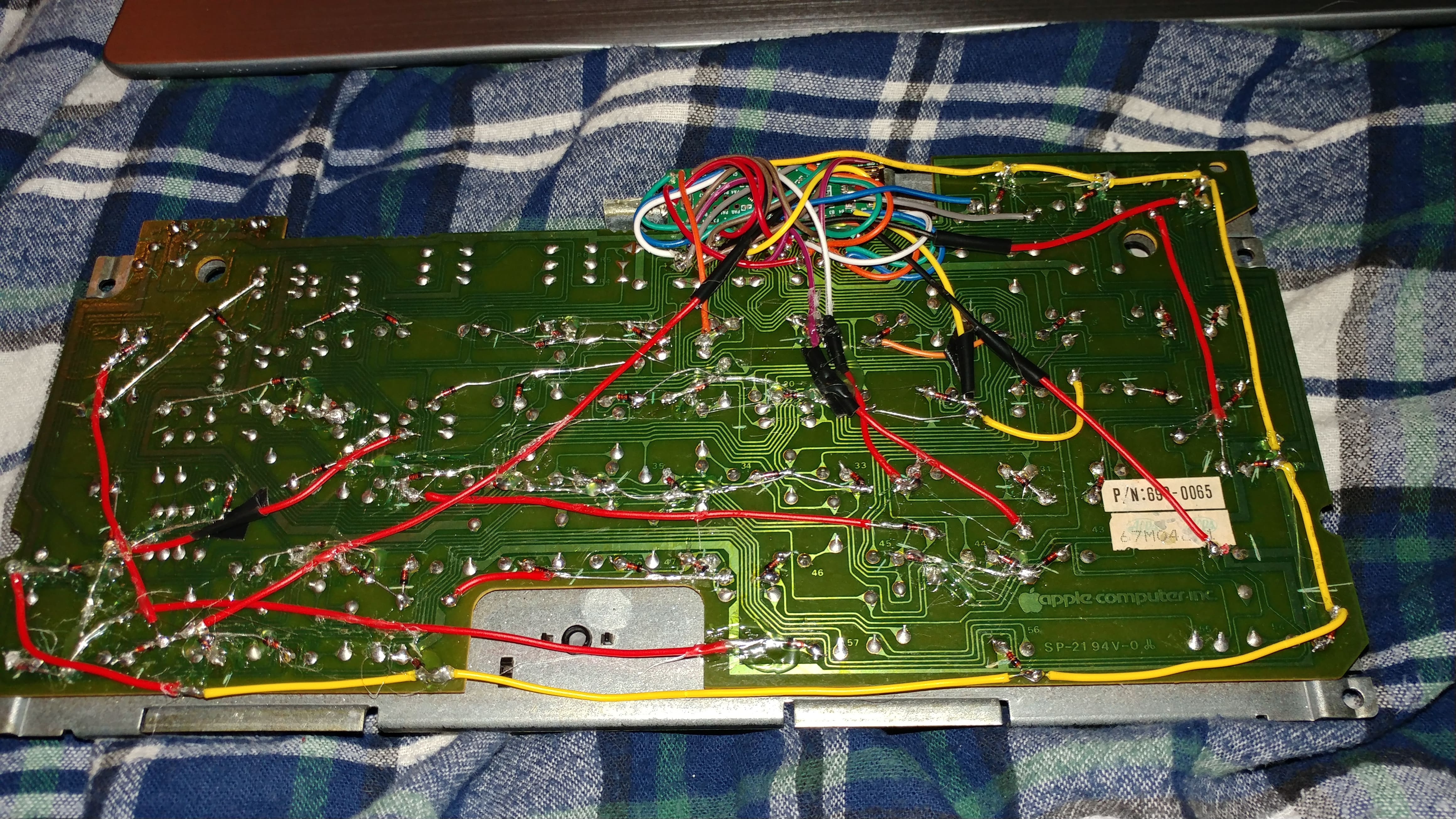

Just yesterday I finally got to rewiring the original matrix with diodes, with some minor changes.
I also created a firmware for it, or, rather, I tried to. You see, the matrix is somewhat odd, and the wirings and pin -mappings with the teensy2++ are a bit unique. With QMK configurator, I can't seem to find a way to import the keyboard layout editor files for it, nor to edit the matrix and pin mappings. With kbfirmware, I was able to get everything to my liking, pin mapping and all, but, unfortunately, they no longer have compilation on their own website, and I can't figure out how to compile the firmware without that.
This is where I ask for help. Here I will provide the .json file kbfirmware.com provided me for my configuration. What I am looking for is for someone to successfully edit this to be importable and compilable with qmk configurator, or to compile this into a flashable .hex file and teach me how to do so, or to otherwise recreate it so it can be compiled. To see more information from the .json file, import it into kbfirmware.com for a visual kinda view of it.

Here's a picture of the handwire. I honestly don't recommend it but dammit I have a plan and I want to see it through.
As for the case, I will pm you with files. It doesn't exist physically yet.
I will release the files publicly when I can confirm they actually work.

Update: This is closed, I have made the firmware successfully, however, I am having issues likely related to my wiring.
ZedTheMan
24 Jun 2019, 04:32
Double update, firmware working correctly after a little bit of rewiring.
