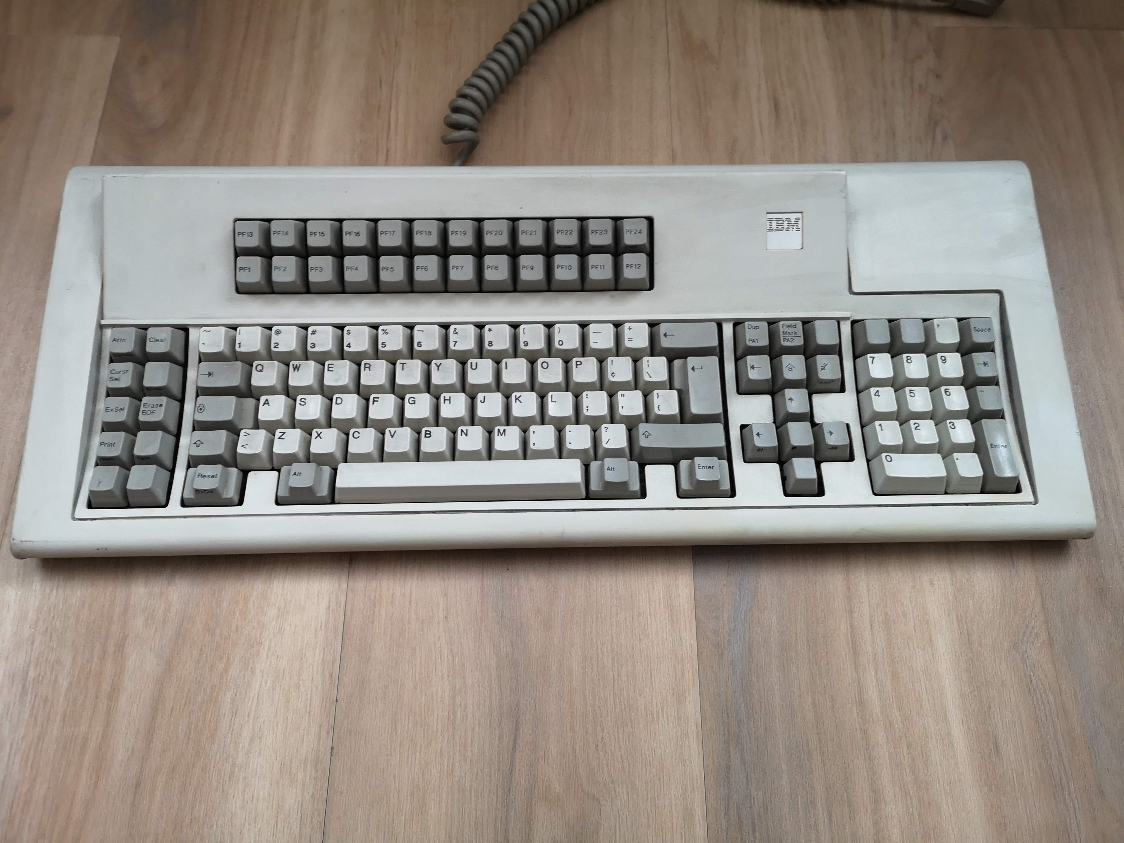

How the keyboard looked when I first got it.

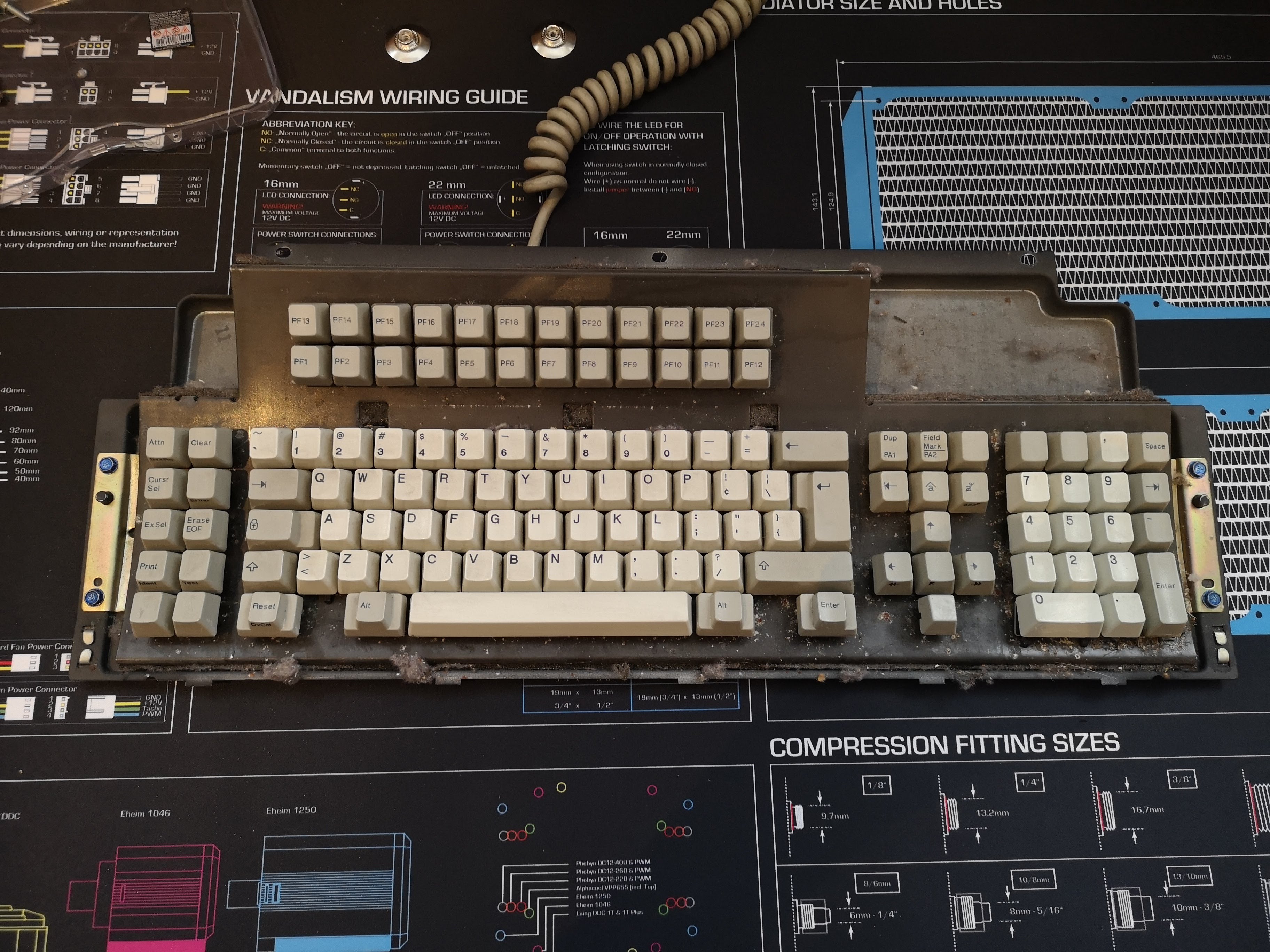

Removed top case.

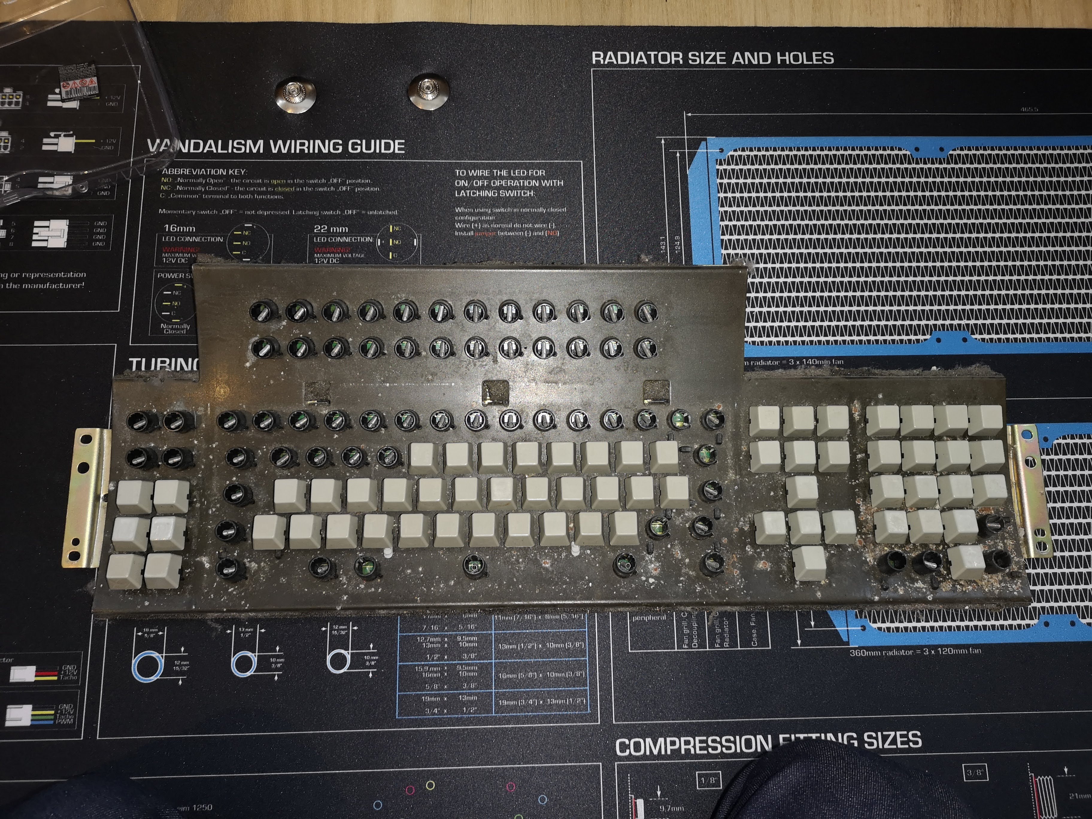

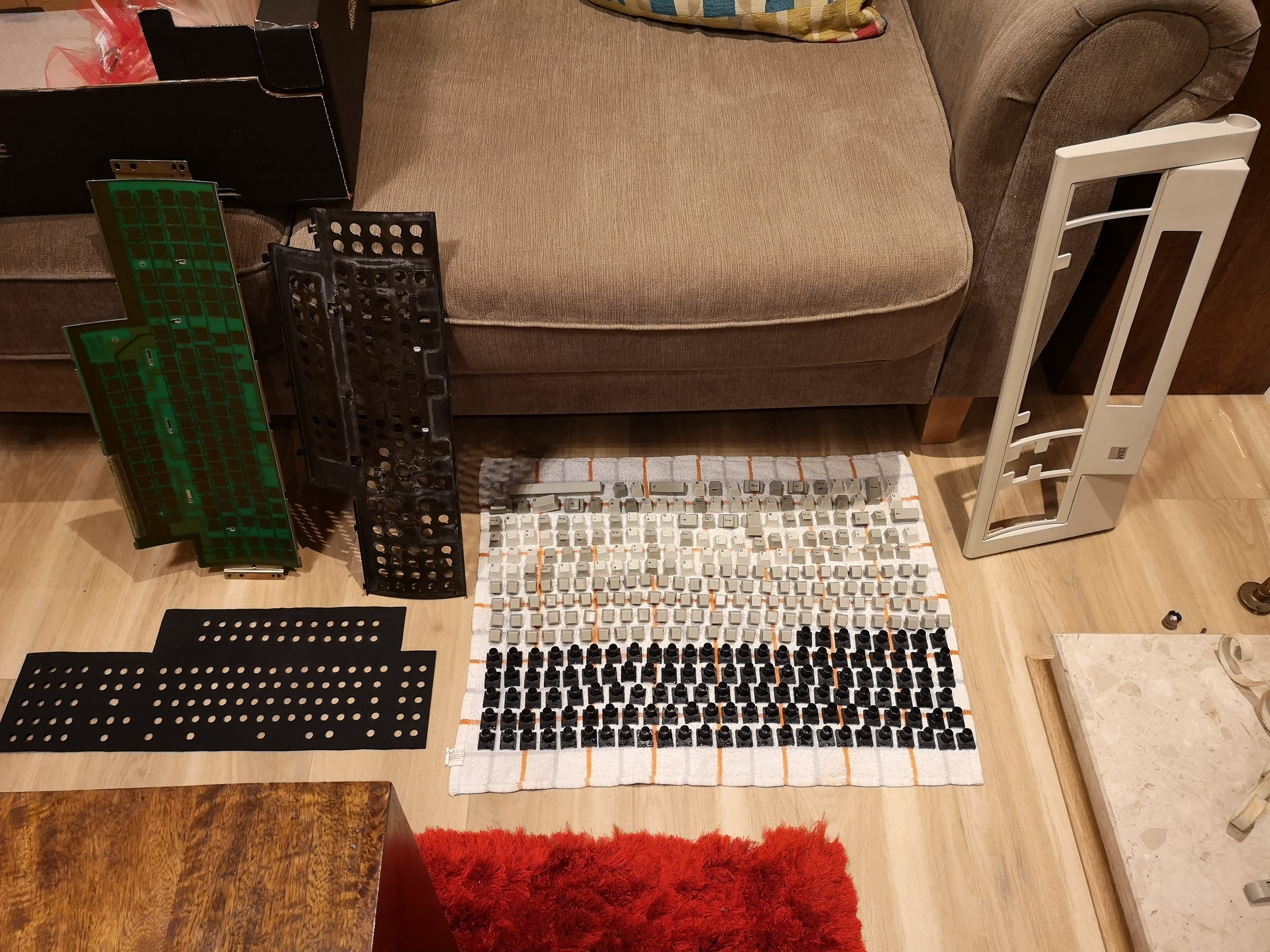

Removing all keycaps and keystems.
Backplate removed.

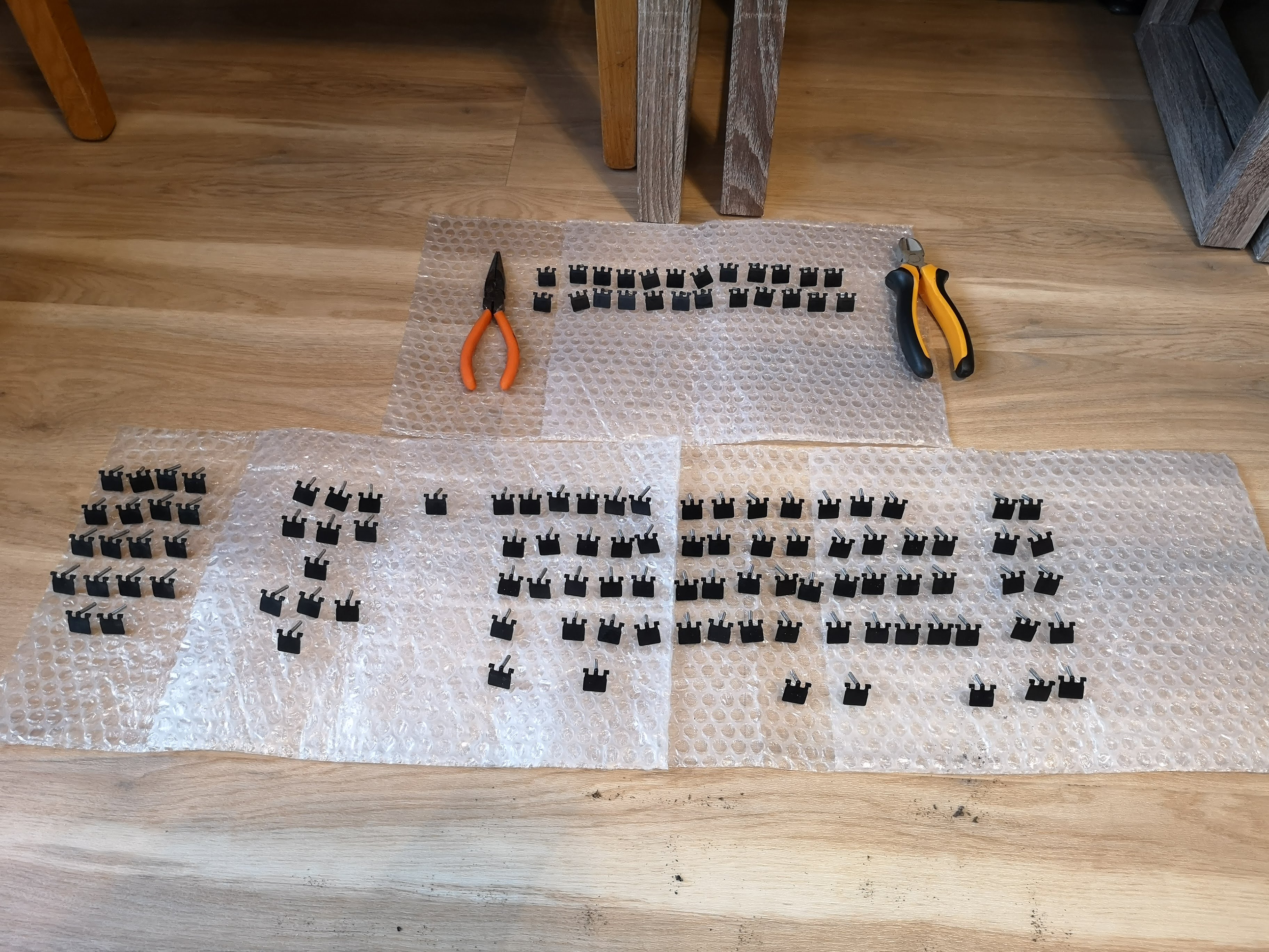

Key barrels and flippers very dirty.
Starting to remove all key barrels and flippers.
All flippers and key barrels removed.

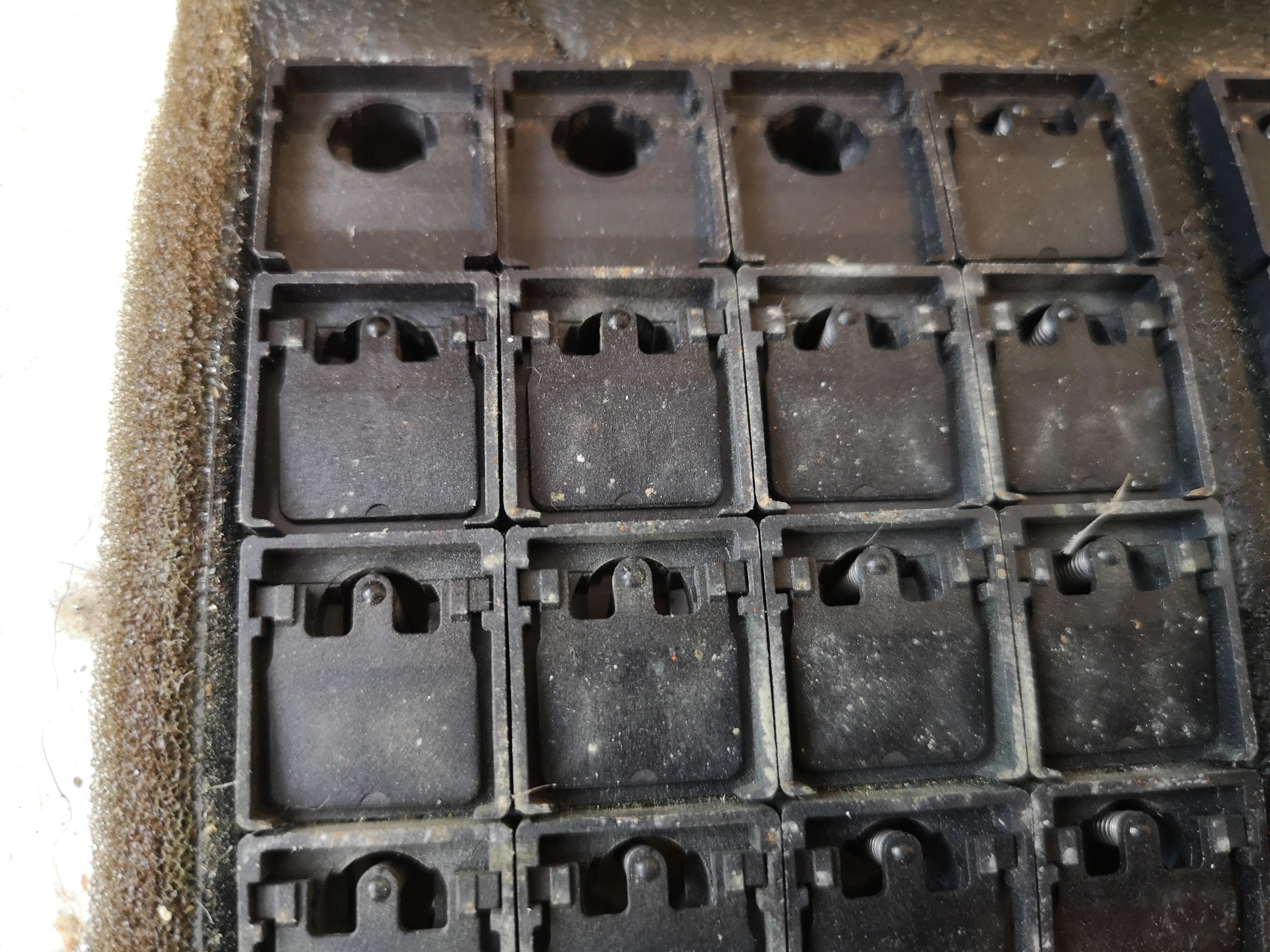

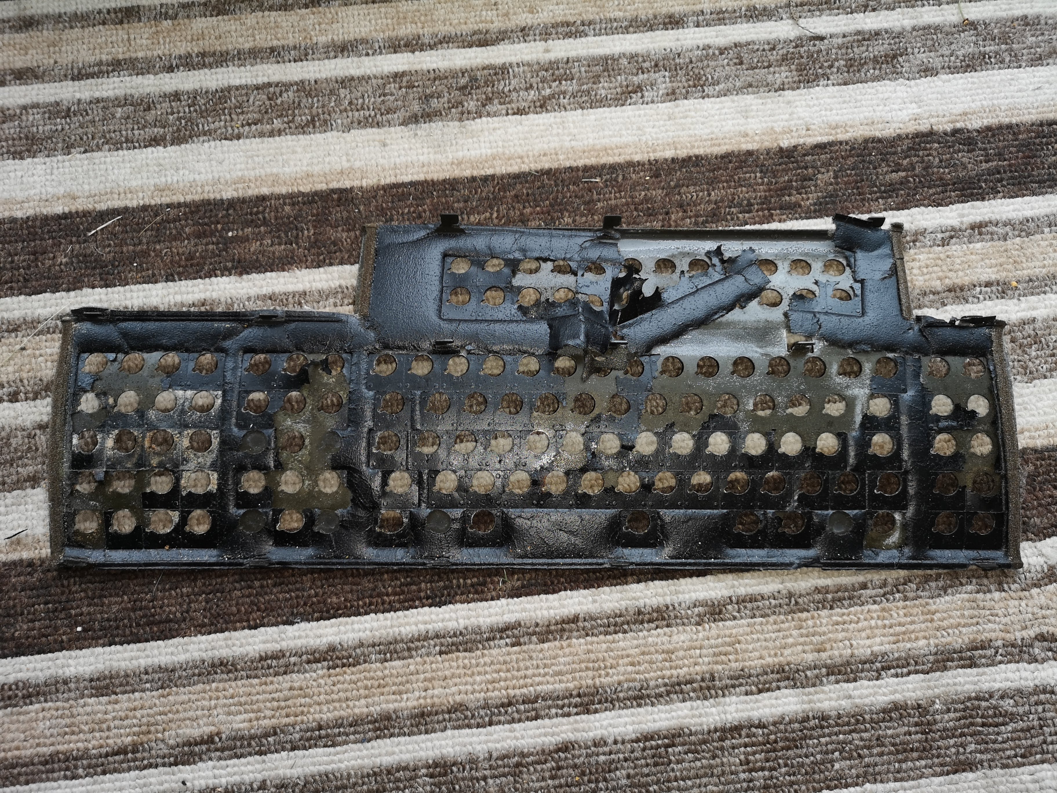

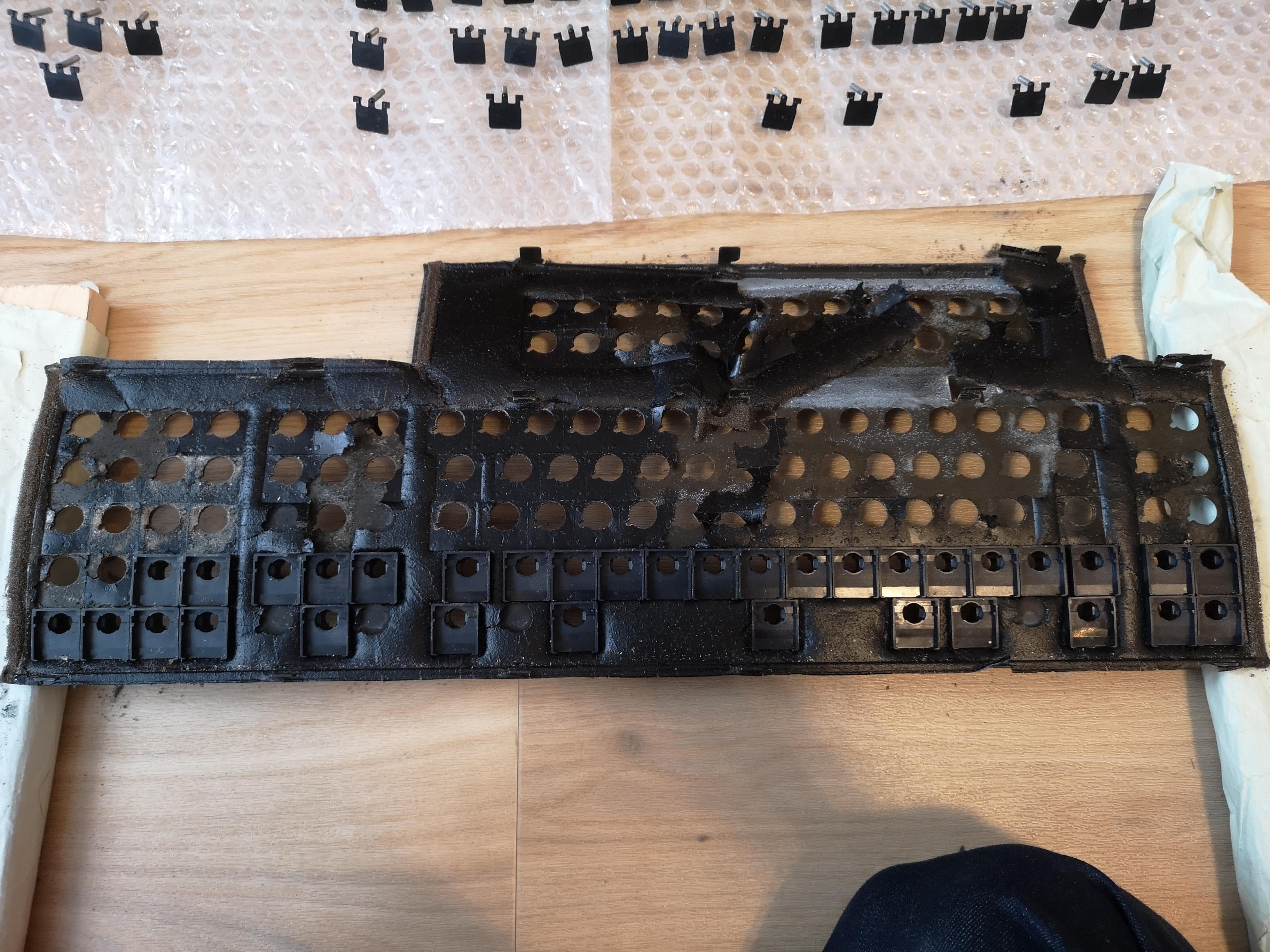

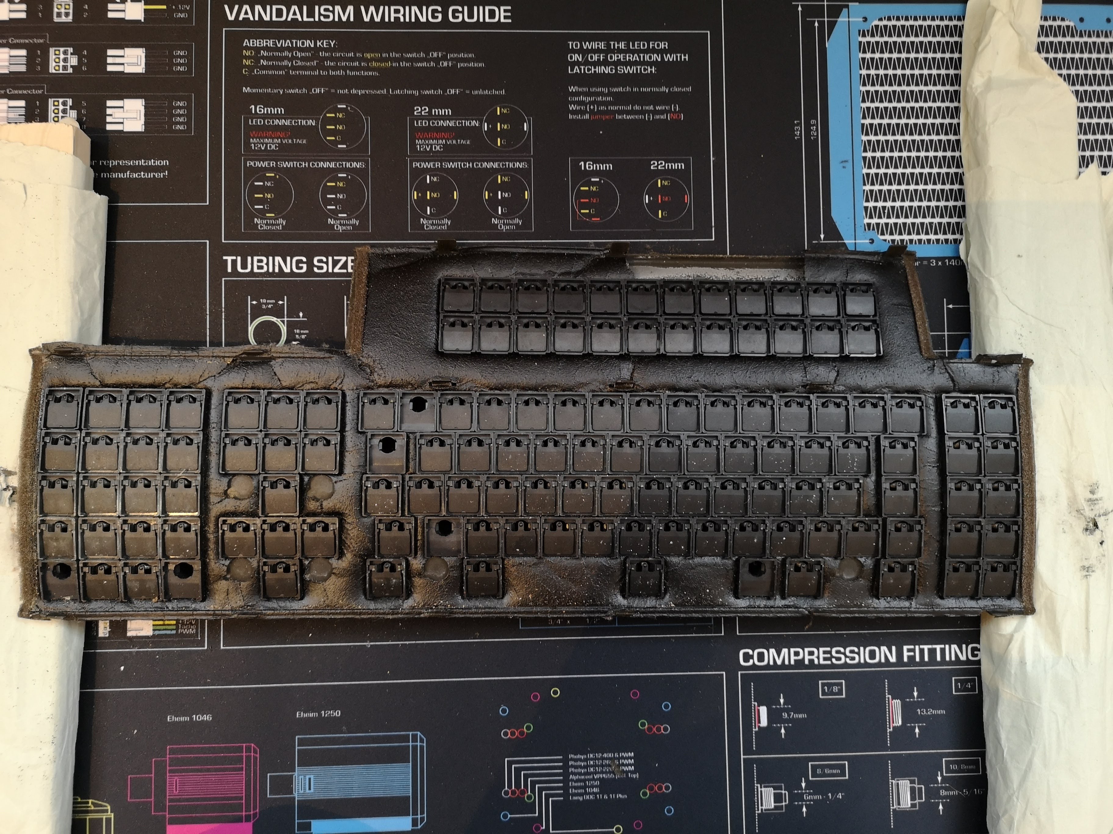

Foam in terrible condition.

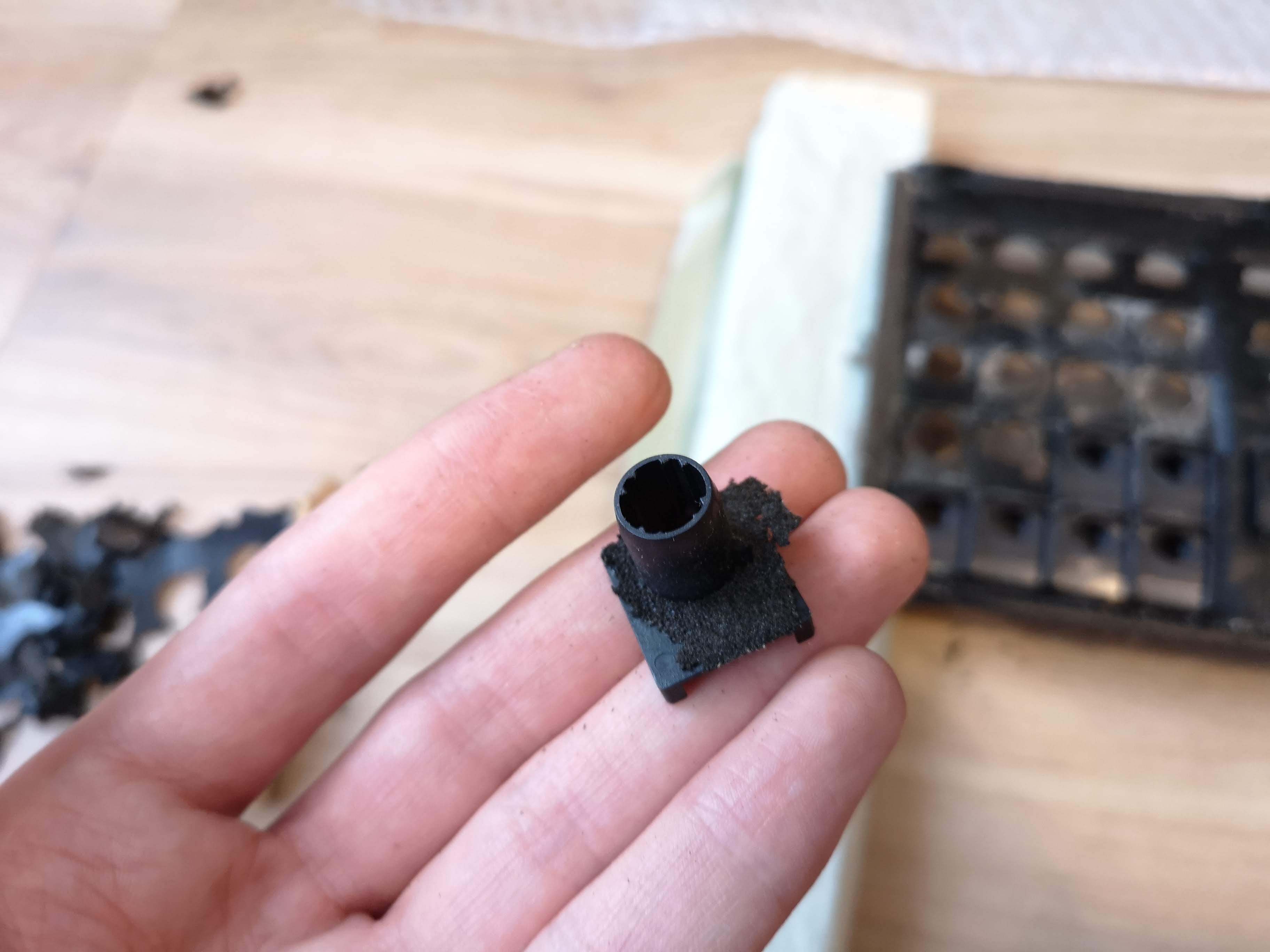

Close up of foam stuck on one of the key barrels

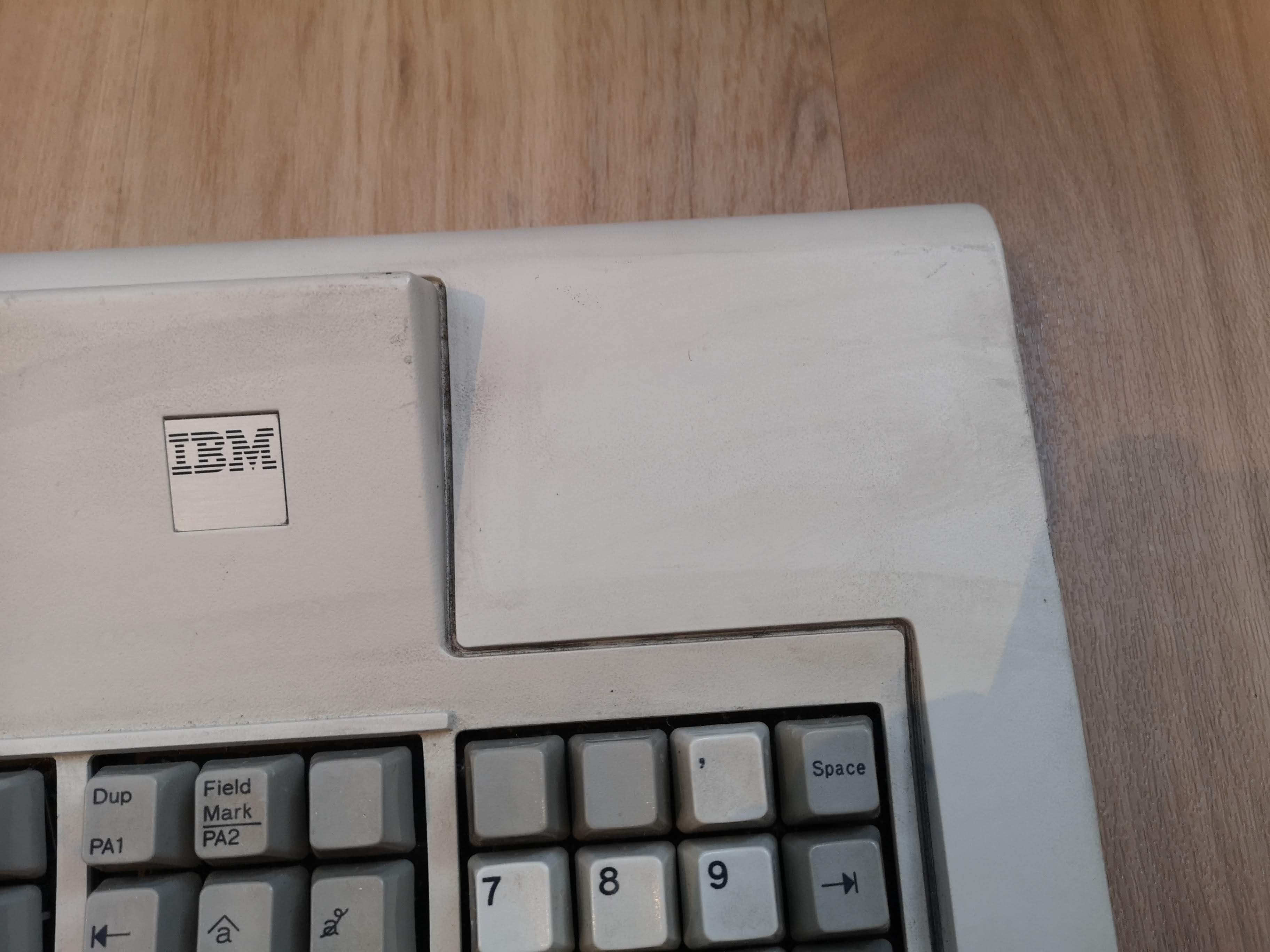

Few close up's of dirt on the top case.
Getting ready to clean the top case.
Key barrels, key stems and keycaps soaking in warm water with dish soap.
Everything nice and clean drying also new 3mm neoprene foam cut to shape.

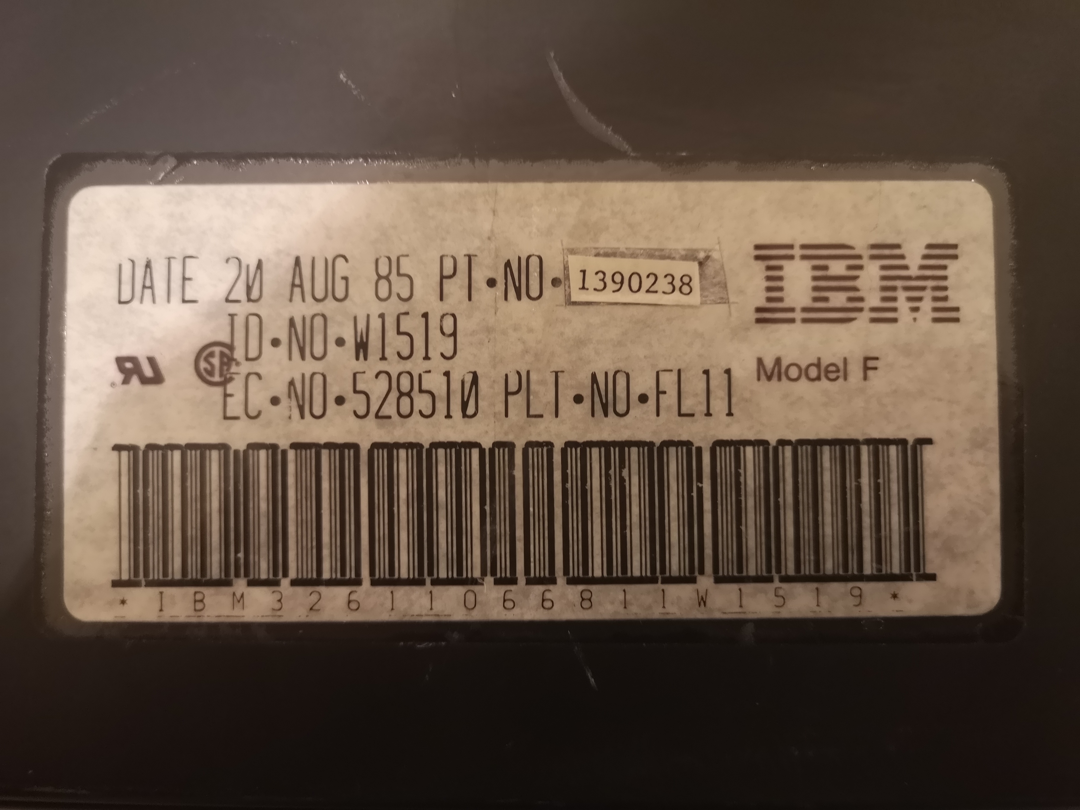

Close up of back label.

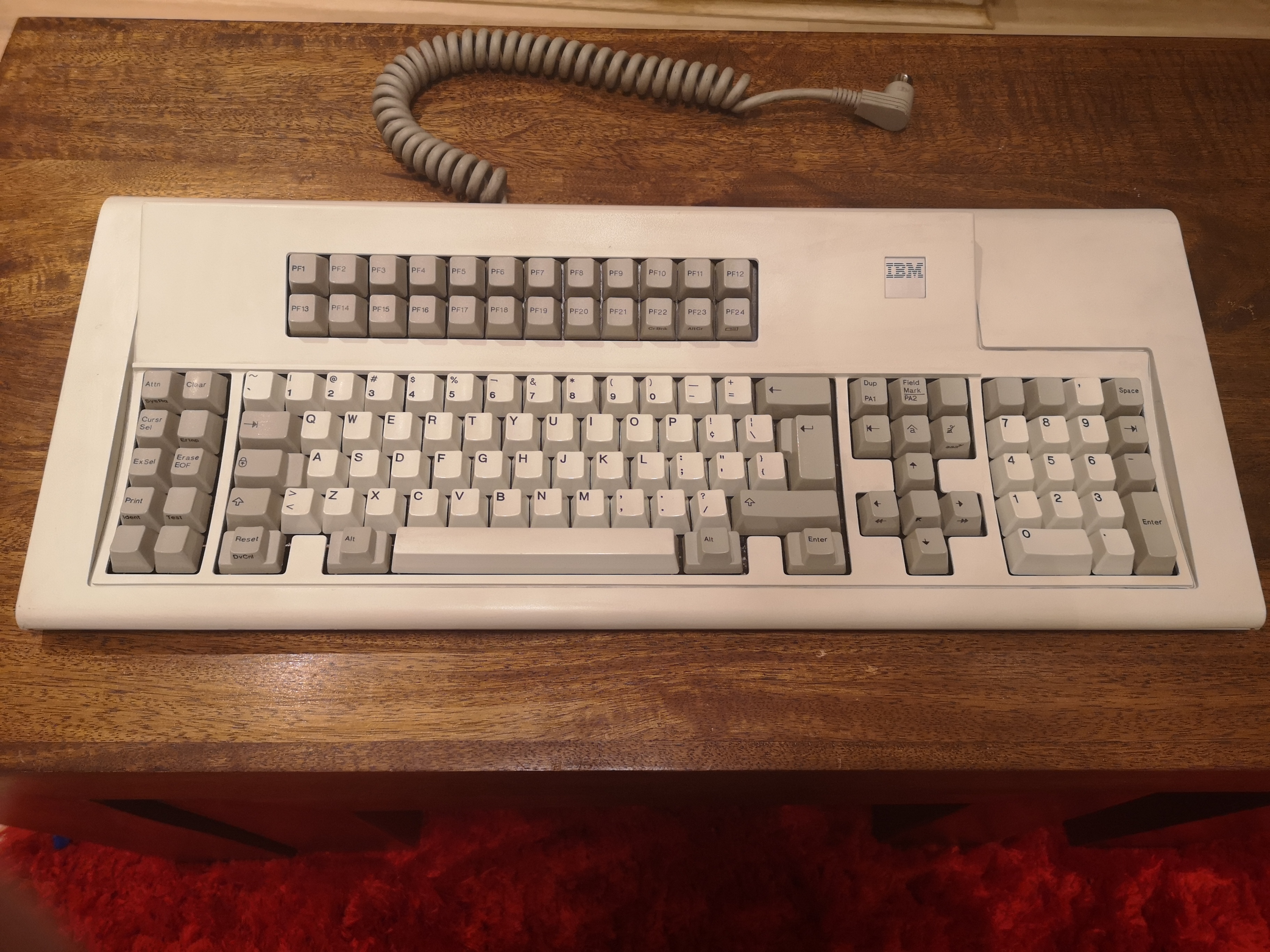

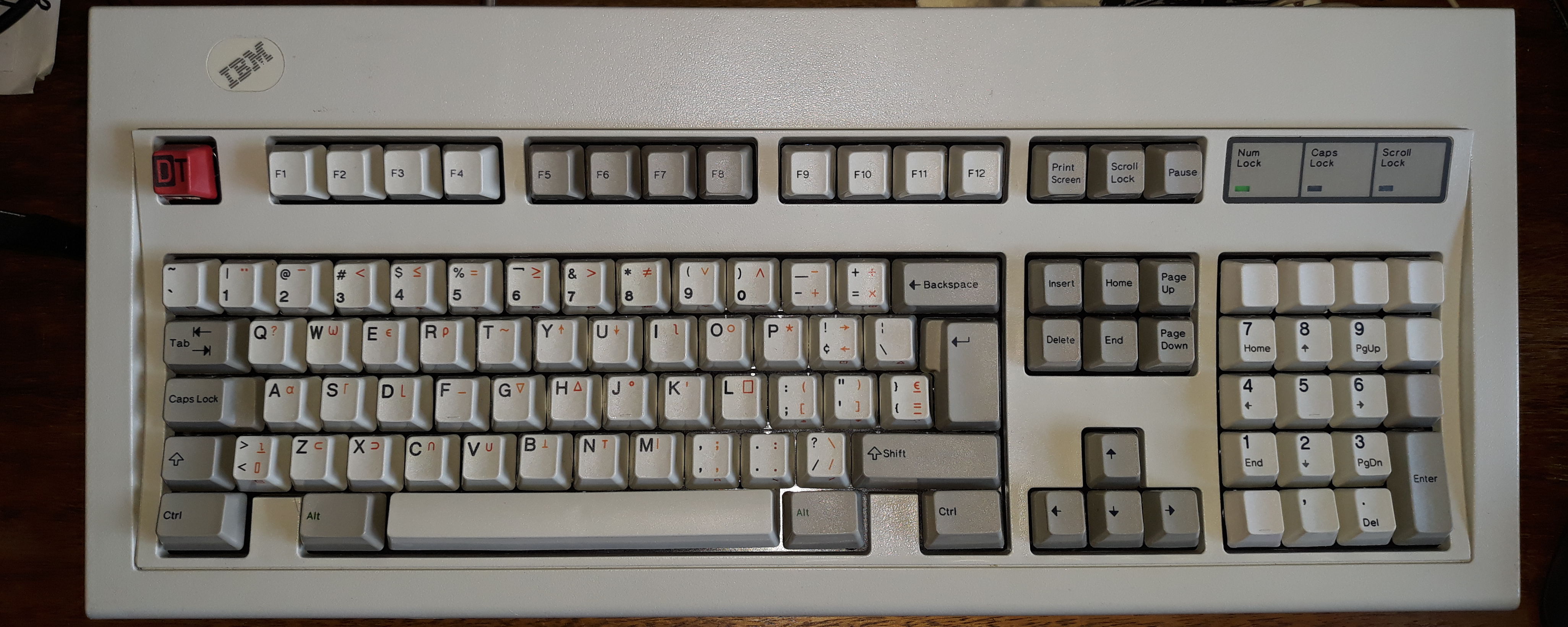

The keyboard fully restored.
Here is a quick sound test and general look around the keyboard please let me know your thoughts on the restoration Thanks.

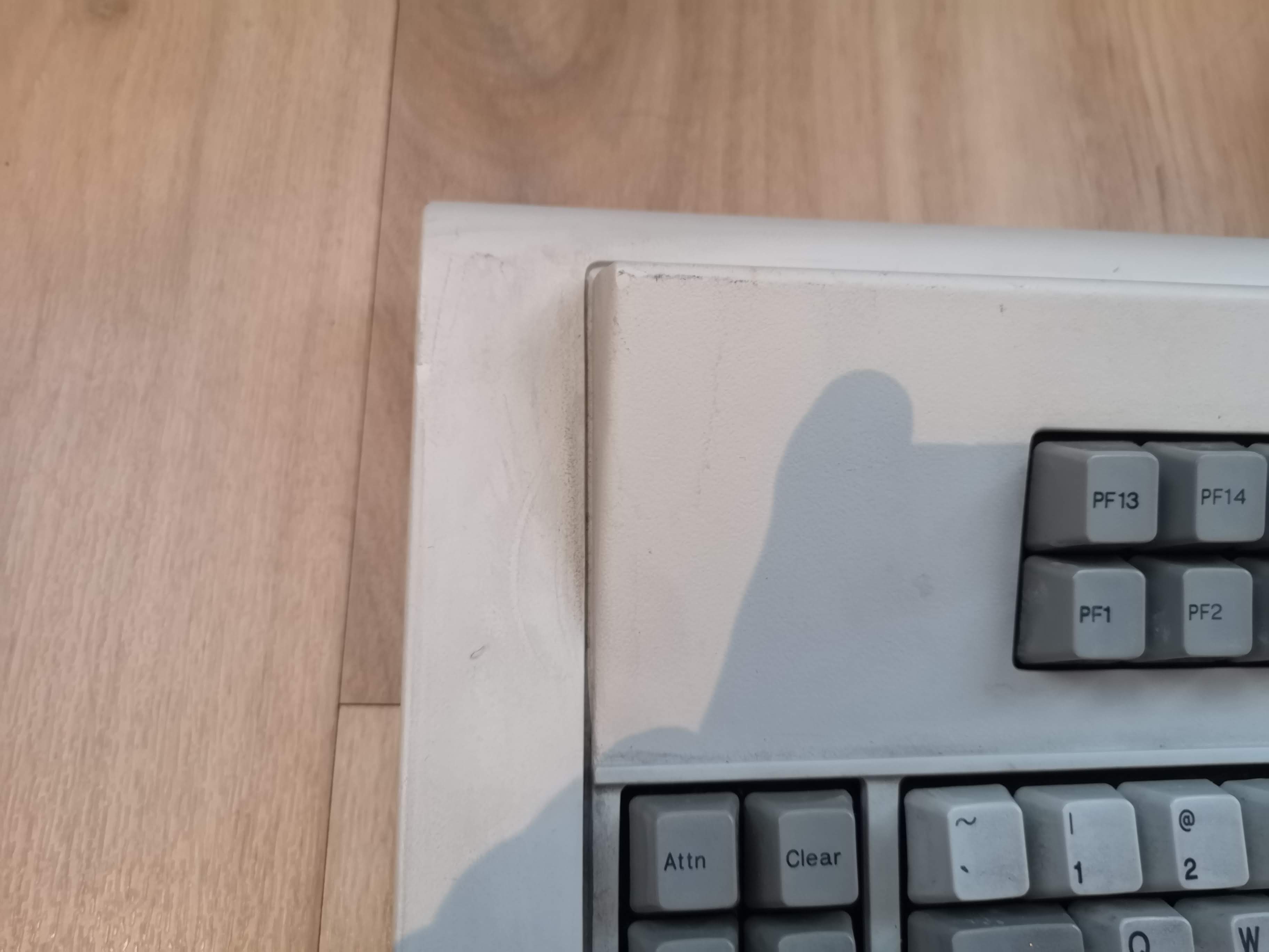

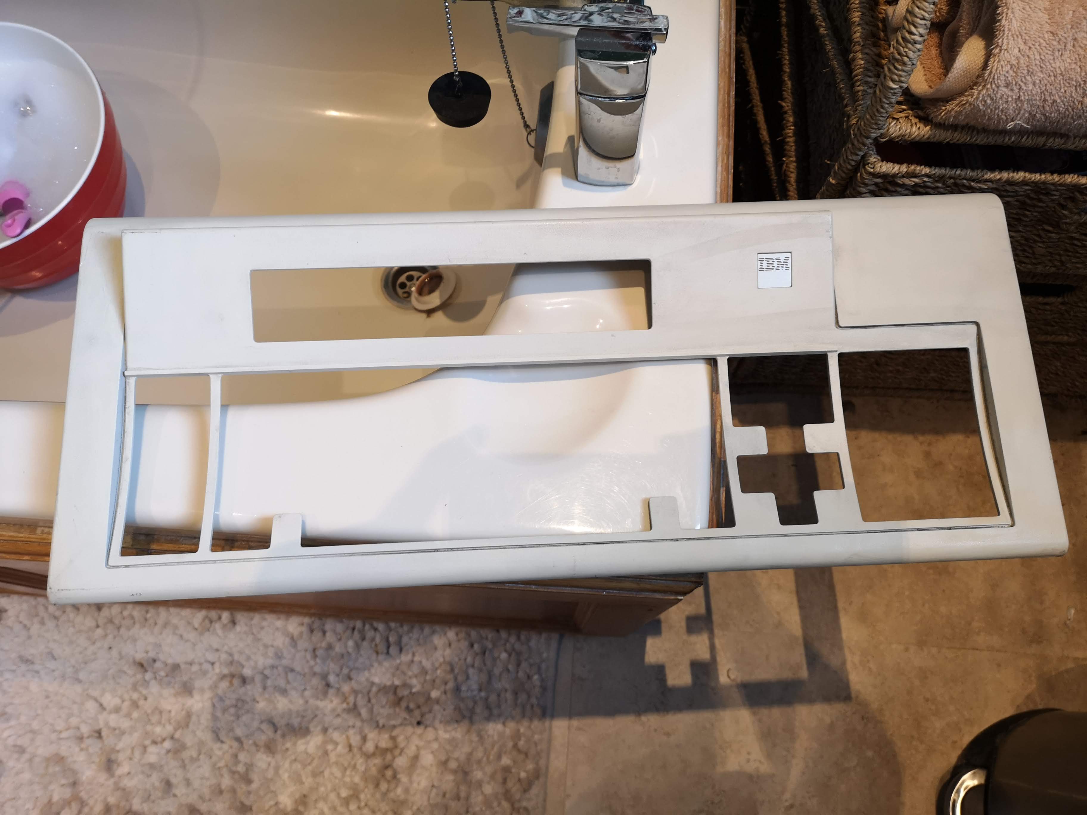

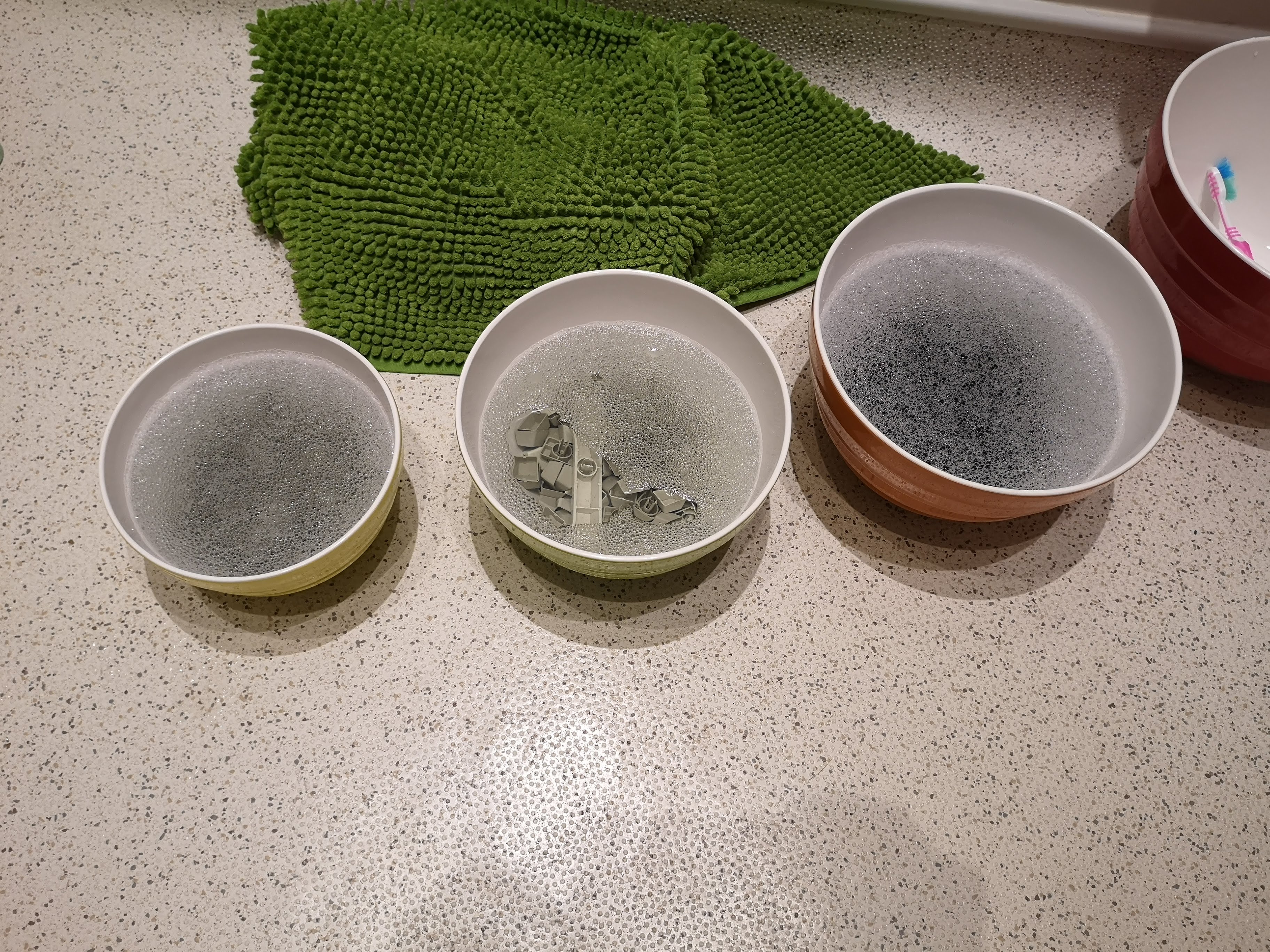

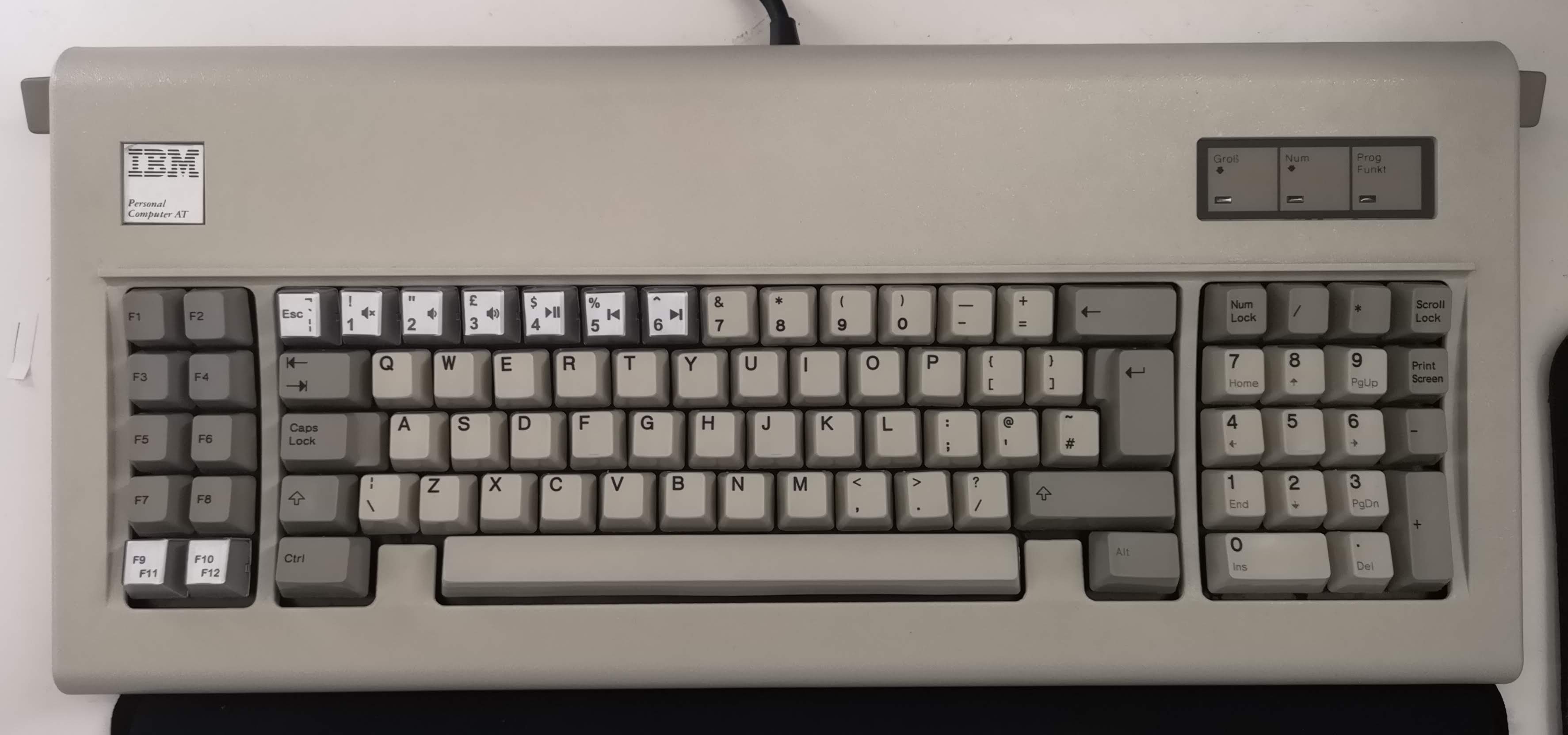

I also use an IBM Model F but not the F122 I use an IBM Model F AT with a modernised layout as my daily driver. Here is a picture of my daily driver not sure if I will switch to the F122 as my daily driver just because of the sheer size.Redmaus wrote: 23 Jun 2019, 23:21Thank you, I try my best to get good finds and share them with everyone at DT. If I found NIB F122's I'd be insanely happy and worried(storage yikes)Fkazim wrote: 23 Jun 2019, 23:17 Thanks really appreciate it
You have some really nice keyboards yourself damn NIB Model F XT's amazing!
But an F122 will never let you down, mine has served me well(my first model F and mech keyboard) and will continue being one of my favorite boards, its super hard to beat.
- modernised AT.jpg (188.99 KiB) Viewed 19798 times

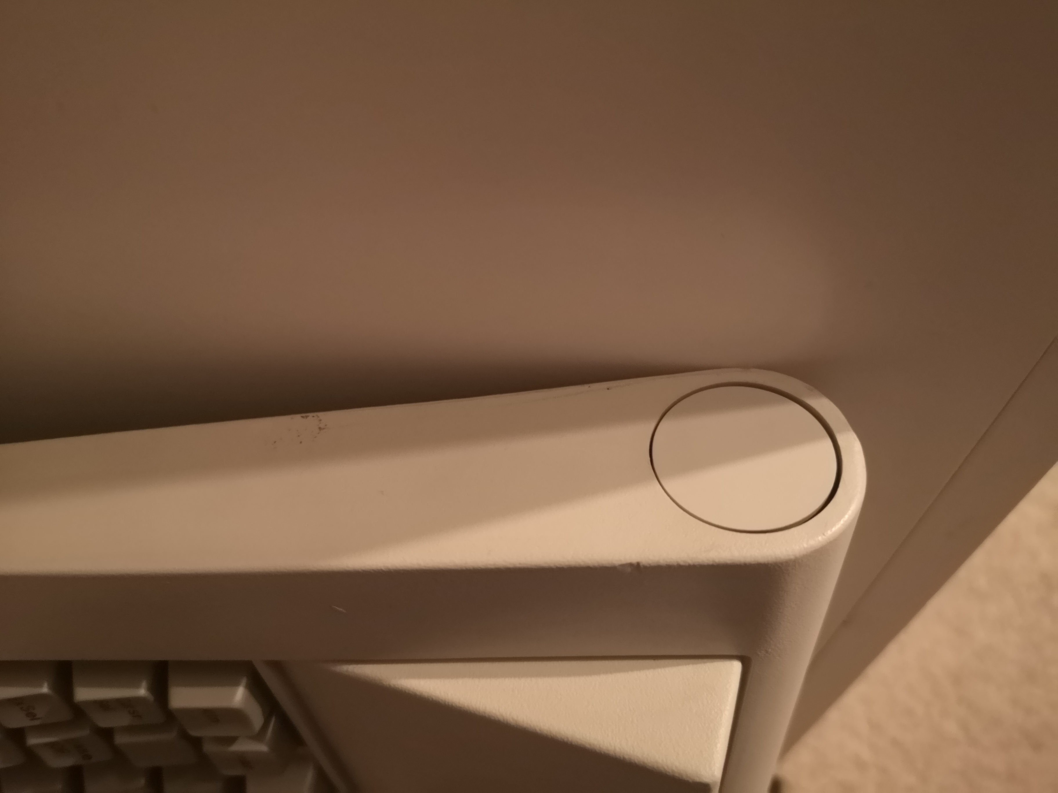

Also side note not sure if this is unique but the flip out feet buttons on my keyboard are white like the rest of the case whereas all the other F122's I have seen online have grey buttons just thought it would be worth pointing out below is an image showing this.

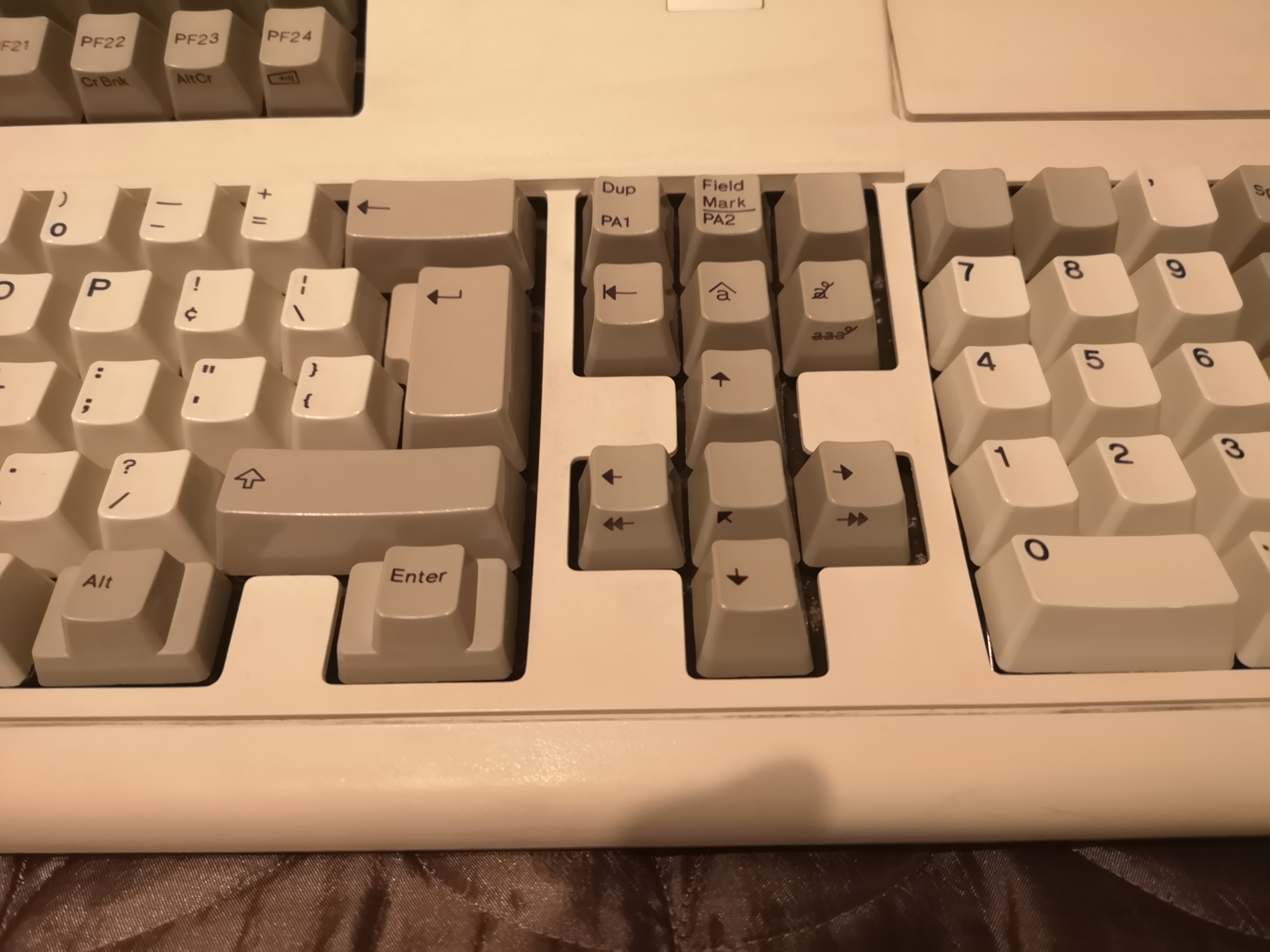

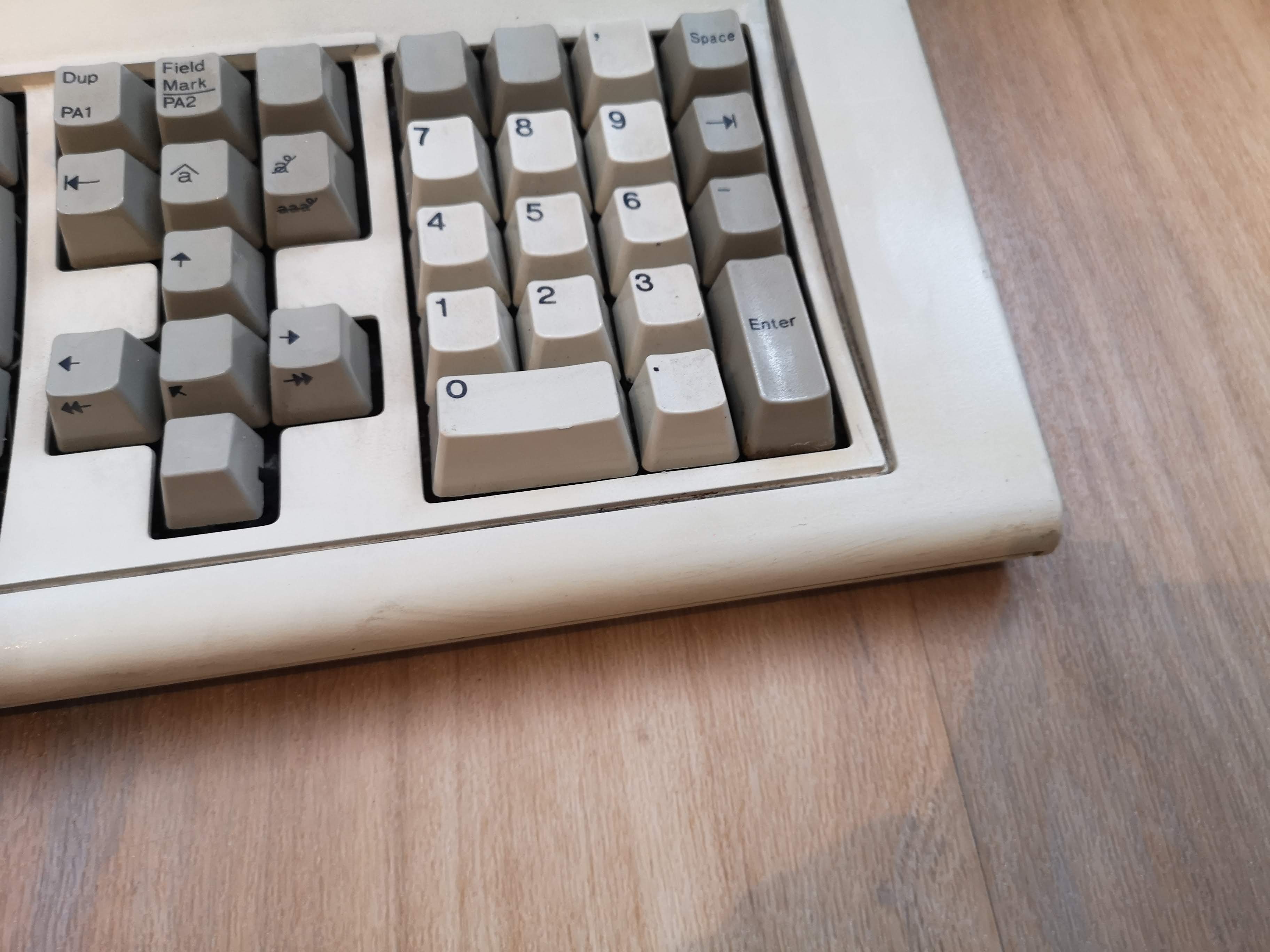

Also what is up with that key in the middle of the arrow keys never seen that before also all my function keys are labbeled PF1 to PF24 where as most of the the other ones I have seen online have CMD1 to CMD24 is that something else of relevance to what terminal this keyboard came from?
Below is an image showing what I am talking about.

Depends on what the terminal was supposed to be used with - some battleship keyboards (be them F122 or M122 or... gasp... off-brand) had Cmd1..24 keys, others had F1..24, or PF1..24; some had blue legends on top, some had pront-frinted legends of differing sets. What we now call EF9 sometimes had a "Setup" legend in blue. Your keyboard has a "space" key on the numpad (while most other battleships and battlecruisers have a "Field -" legend there). Mine didn't have a comma key on the numpad (and I had to buy one from Cindy); yours does.
There's dozens, if not hundreds, of variations on the mod legends on IBM M/F keyboards for terminals (and that's not taking into account non-English versions of them). IBM being IBM, most of those variations had their own part numbers, some of them famous (1393464 comes to mind), and surely, somewhere within IBM's old documentation, there's a guide to which is which.
Now, if I could lay my hands on OG 1U numpad zero keys...

Thanks for all the info never realised there could be so many different keysets. What do you mean by "OG 1U numpad 0 keys is that just a single key 0 key? If you don't mind me asking.

Discounting the F XT, Model F and M keyboards with a numpad have either 17 or 18 keys, with the numpad+ a 2U key in PC models or two 1U place keys in terminal models; the keys Enter and 0 in the numpad are always 2U, but the underlying PCB or membrane supports splitting them as well into two 1U keys, so a numpad can have up to 20 keys. For example, this is how my full-size Model M keyboard looks like after that modification:
I need an OG ("original") 1U 0 key for that one place (and alpha-colored keycaps for +-*/, and a custom-made = key as well, but that's another issue).
By the way, the F122's PCB ALSO supports splitting the right Shift key (on the left side), the Enter key (to use a TIE instead of an ISO Enter) and the Backspace into two 1U keys.
