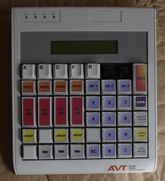

24 Aug 2019, 07:53
katamari wrote: 24 Aug 2019, 00:36 So, if you have heard of anyone having already done so, or could help me doing it, I would really appreciate :D
There's a similar Tipro device:
Tipro LCD-25.jpg (158.24 KiB) Viewed 9087 times
katamari
24 Aug 2019, 11:07
Looks nice!
If I had one of these, I probably wouldn't even have considered building my own keyboard.
Only problem is availability, and also the win 32bit only support for changeme.
When I first had the idea of using tipro MID boards as a split keyboard config, I was looking for 64 keys modules, but couldn't find any.
The option of reshaping a switch plate from one of my 96keys tipro by cutting it to a smaller size is still on the table though. however I don't think I 'll can apply the same resizing process to the PCB :P
