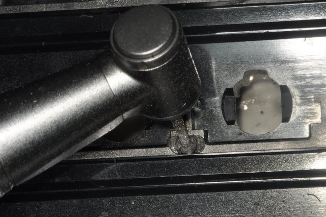

ripster
13 Jun 2012, 17:15
didja wrote:It's a shame skcheng stopped hitting forums before dental bands became the rage. (He was a dentist)
SKCheng used his dental skills to PERFECT the Buckling Spring PING mod with Dental Floss...
http://geekhack.org/showwiki.php?title=Island:9761

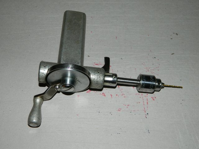

And the Nut/Bolt Mod with A Dental Drill.
When Geekhack was MOAR than putting some colored keys on your keyboard or turning Korean.
Still my favorite Drill used for the Nut/Bolt mod:
http://geekhack.org/showwiki.php?title= ... post522384
