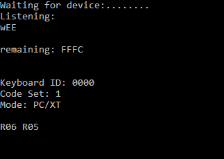

Hi guys, I'm trying to get my 4980 Model F to work with my Orihalcon 240° 5-pin DIN to USB Set 3 converter, as it does not output any scancodes. When I open hid_listen, it says the Keyboard ID is 0000, running code Set 1 and set to PC/XT mode. I get R05 and R06. I have included a picture for reference.
I tried to force change the protocol to Set 3 with "force set3" but it changes it to AT/PS2, unknown protocol and gives me even more error codes. I think this is just a problem with the command itself, because I accidentally flashed my XT/AT Soarer's converter (which I am using with my XT Model F) and could not revert back to Set 1, even with "force set1". I had to run legacy.sc to revert back to default.
What am I doing wrong? I'm convinced this is the solution to the keyboard not working, as it uses the same 240° din plug as other F122s but hid_listen states it's using Set 1. I played around with the two jumpers on the controller, putting them next to each other 8 pins in - just like on a regular F122 I saw. I also tested without jumpers, nothing seems to work.

R05 - timeout - started receiving clock from the board, but didn't receive enough for a full code
R06 - start bit - read a start bit, but it was incorrect
Come to think of it maybe it's a busted cable. Do you have multimeter by any chance?
Checking continuity and pinout may help.

Okay, so it's not the protocol that's the issue. When I plug in just the Set 3 converter and no keyboard, it's set to PC/XT and Set 1 until a keyboard is detected. I get an R05 error when I plug in the Battleship, so I need to try and figure out what the issue is.
Is it possible it's making use of the Reset pin like the Zenith Z-150 and Leading Edge DC-2014? Or is the controller just dead? It looks like the keyboard has been bashed, as some parts of the case at the back have broken off and the two "tube feet" that support the assembly in the metal pan have been badly damaged. There are no scratches anywhere, though.
