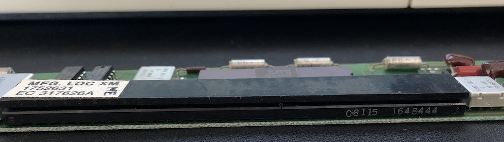

I just can't slide the controller off my beamspring.The condition is pristine Including the foam, but the controller just won't slide off. Any suggestions?

They can be quite stiff. Easy does it, each side in turns. They’ve been mated for decades, remember. Separation is quite the upheaval.

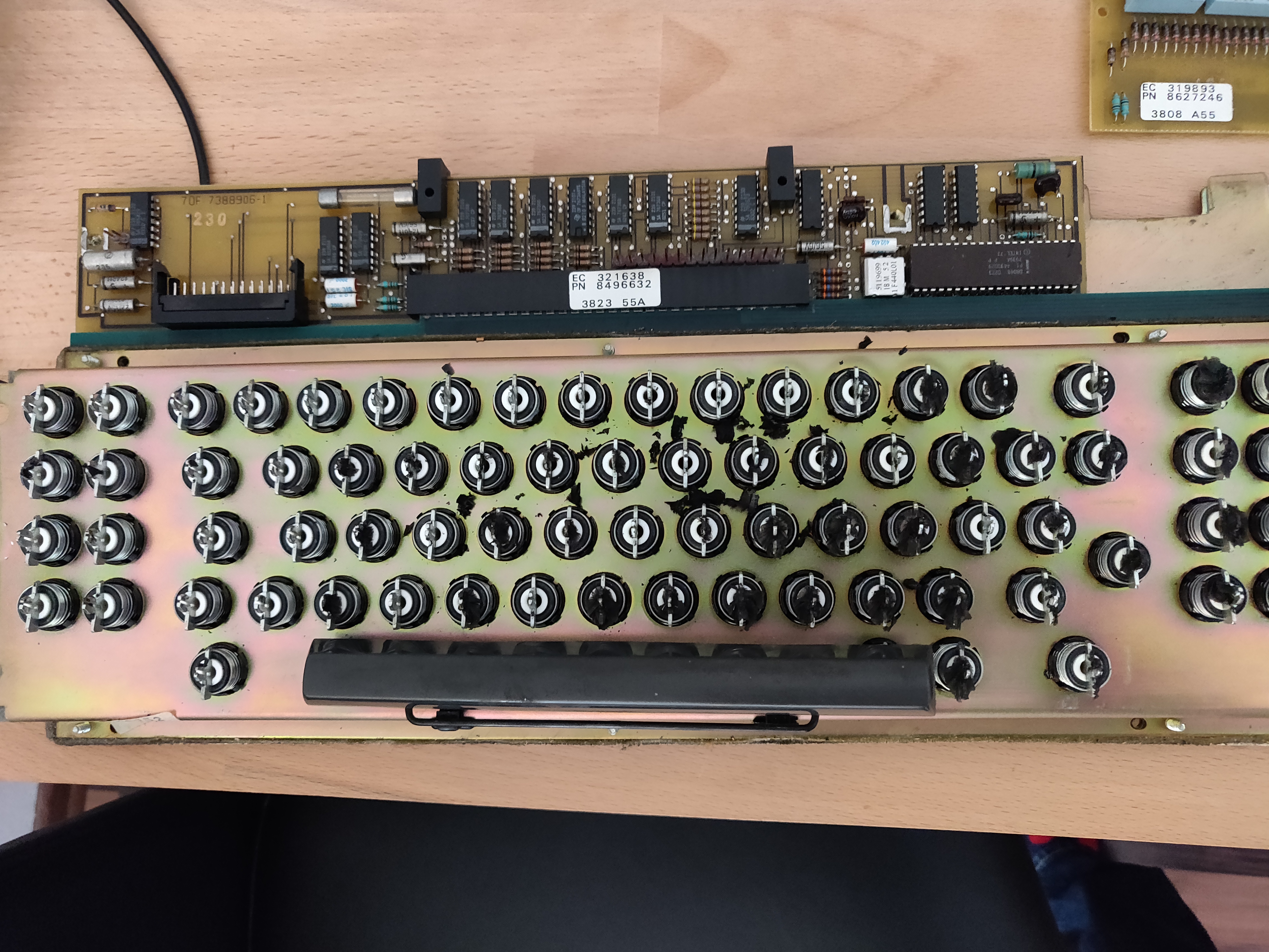

The peculiar thing is that one of the space-bar switches is missing a fly plate.

Muirium wrote: 13 Jul 2019, 20:23 They can be quite stiff. Easy does it, each side in turns. They’ve been mated for decades, remember. Separation is quite the upheaval.
Tried that several times, it wouldn't budge. Any other ideas ?

kmnov2017 wrote: 13 Jul 2019, 20:36 The keyboard has clearly been serviced, but they forgot to fix the flyplate and for whatever reason removed and didn't replace the flyplate...
I think it's supposed to be like that, no? I thought the spacebar had one functional switch and one dummy switch to act as a stabilizer.

That does make sense, I don't see why two switches should trigger the space-bar.

Clamp the pcb down and gently tap the edge of the connector on each side with a soft plastic tool and a hammer maybe?
darkcruix
14 Jul 2019, 10:56
I'd use mineral oil and drip it into the connector of the controller (use a syringe if you have one at hand). Shake it from time to time and let it sit for a few hours. I bet some of the contacts are corroded and it just takes some force to get them off.

Lanrefni wrote: 13 Jul 2019, 23:49 Clamp the pcb down and gently tap the edge of the connector on each side with a soft plastic tool and a hammer maybe?
Tried that. Maybe I am being too fragile, but the edge connector didn't budge even one bit....

darkcruix wrote: 14 Jul 2019, 10:56 I'd use mineral oil and drip it into the connector of the controller (use a syringe if you have one at hand). Shake it from time to time and let it sit for a few hours. I bet some of the contacts are corroded and it just takes some force to get them off.
I have WD40, but I've heard it can disintegrate plastic. Not sure what I should do ?
14 Jul 2019, 13:43
Try spraying a bit of contact cleaner in there , it could be corroded .

kmnov2017 wrote: 13 Jul 2019, 21:02 That does make sense, I don't see why two switches should trigger the space-bar.
Now some help me with more ideas on how to get the controller off please ....
The spacebar uses only one switch but it has 2 sliders. The other slider never had a foot, which means every beamspring keyboard basically comes with 1 completely unused beamspring.
Now I wouldn't really say the beamsprings wear out, but you might consider swapping that slider with the other spacebar one.
andrewjoy wrote: 14 Jul 2019, 13:43 Try spraying a bit of contact cleaner in there , it could be corroded .
I would do this, if its corroded they could be stuck together and when you pull it could rip up the contacts

I checked the connector closely, there doesn't appear to be any corrosion. It's highly unlikely that the connectors will be the only part to have corrosion.
I've been going at it for the past hour with a hammer, still no luck.

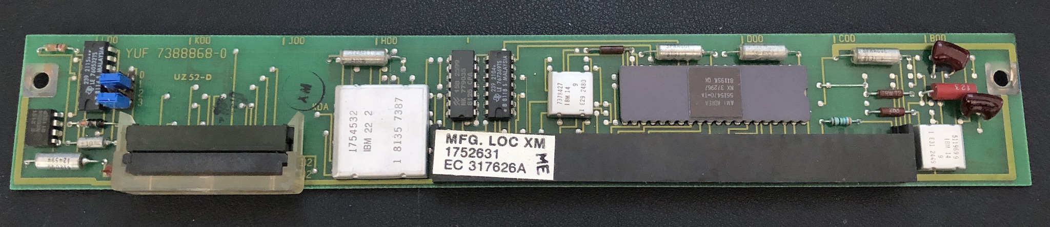

So in the end I just use a long screwdriver to act as a lever between the edge connector and the PCB and pushed it out. It took quite a bit of force but it eventually came loose and I was able to get it off!!!

kmnov2017 wrote: 15 Jul 2019, 16:36 As expected, there's no corrosion....
I guess the parts had just been together so long that they got stuck together. You just broke up a 40 year marriage!

Looks like a 3278 PCB with a notch - looks great. Do you have a Num-Pad as well?

Interesting. I see holes on the pins which does not exist on mine.
