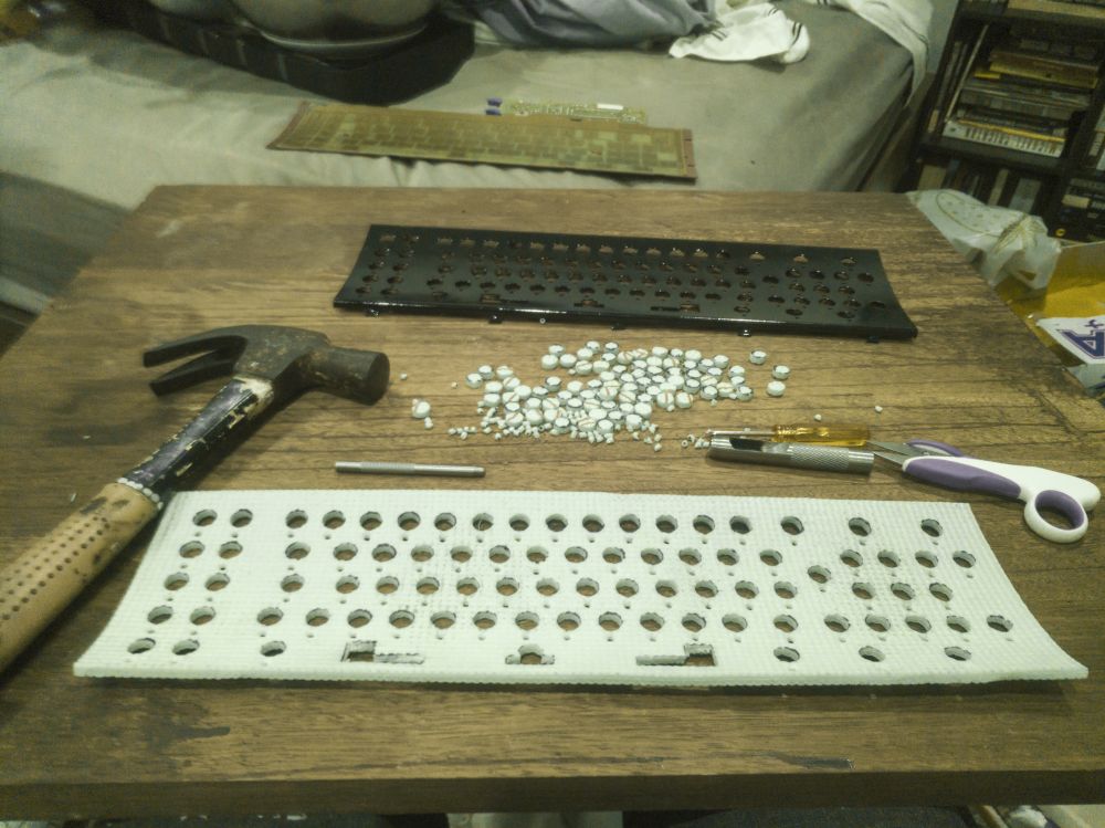

I recently got an IBM XT 5160 to restore and started with the keyboard.
I literally just used a yoga mat.
Measured and cut a rectangle, punched holes in it, it feels great.
I did have to use pliers to 'convince' the tabs to go in their slots though.
