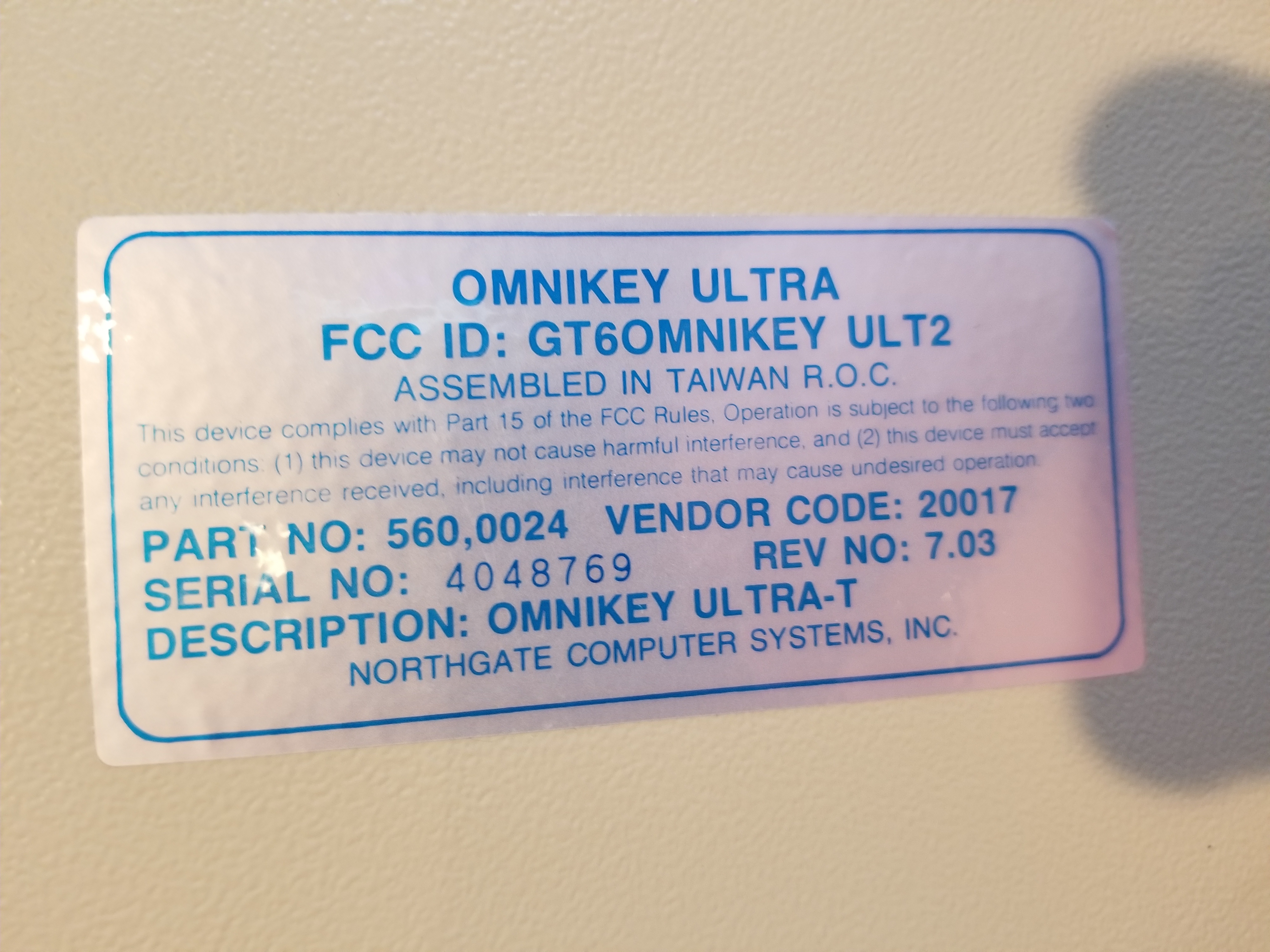

here is the picture with the numbers, at this point I would just like a general time frame of when it was made.Not for sure. If you have the numbers from the bottom label I can tell you approximately when it was built. It's probably a Gen3 Northgate, with dipswitches under the emblem on the upper left corner. Most of those will have complicated white Alps, but very late Gen3 or Gen4 could have simplified Alps instead.
- 20190827_173844.jpg (2.88 MiB) Viewed 2089 times
- Polecat
I have notes on 38 Ultra-T Northgates, all Gen3 with serial numbers beginning with "4". Yours is at the later end of the series, with only two on my list having higher serial numbers. Those run from 4000042 to 4052004. I would guess 1993 for the year it was made. And it should indeed have complicated white Alps switches.consensual-penis wrote: 27 Aug 2019, 23:42 Well I just got the keyboard a few minutes ago, and compared to what it shows on the wiki, It looks like I got the proper complicated switches.
