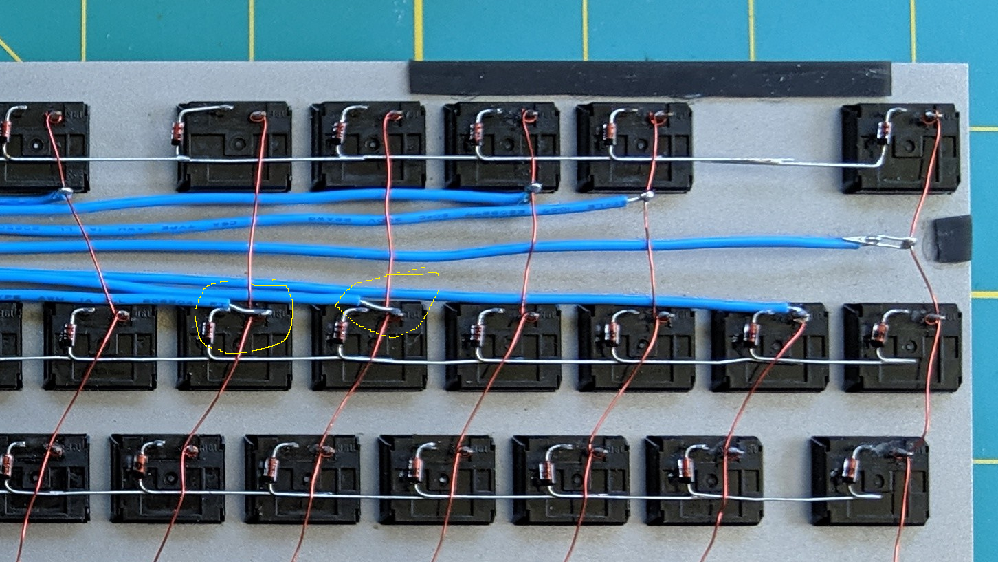

Hi, nice build, I have done 2 handwires myself, firstly with alps and a teensy 2++ secondly with Otemus and the postage board controller and have not had problems with grounding. I did a look through and i have seen two points where there may be a short those i have circled in yellow below. Given the problems seemed to occur after typing it could be that the pressure from hitting the switch would be enough to short.

Anakey wrote: 25 Aug 2019, 10:19I have done 2 handwires myself, firstly with alps and a teensy 2++ secondly with Otemus and the postage board controller and have not had problems with grounding. I did a look through and i have seen two points where there may be a short those i have circled in yellow below. Given the problems seemed to occur after typing it could be that the pressure from hitting the switch would be enough to short.
One of these was just a trick of the angle, but the other was definitely too close for comfort. Appreciated :D
