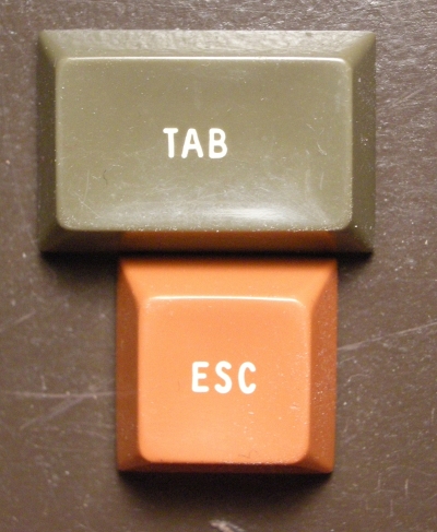

Kurrk wrote: Time has yellowed the grey, thick double shot keys. You can put these caps on modern day Cherry MX switches but they cannot be used because the key mounts are too thick and won't slide into the switch housing. There are also some plastic supports in the way.
I don't know the keyboard, but i like the bicolor look. And you can mod the keys with a lancet (or a xacto knife) to make them fit in the modern cherry switches. I've done that several time and it works fine.

There must be different keycaps so (and if i remember well there is), because mine work fine :
The killer
The victims
here they are :-).

Gilgam wrote: here they are :-).
I'm pretty sure the caps you have there are M7 caps.
Gilgam
24 Mar 2012, 22:57
You must be right, i don't know :-) Thanks
So they are different from Kurrk ?

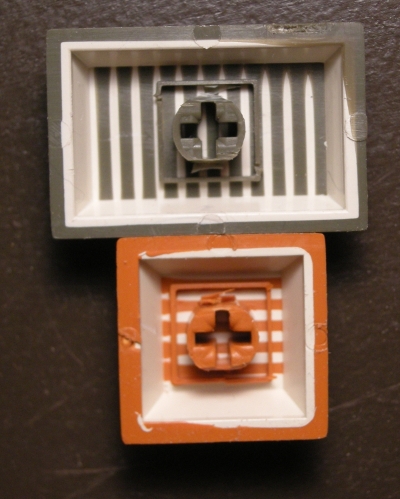

Kurk
25 Mar 2012, 12:09
rodtang, these vintage SMK switches indeed look like the ones in my keyboard. I could desolder one of the switches to check for the SMK logo but I'm in a lazy mood. BTW, which thread are these pictures from? I also see the same key caps in the backgound.
Gilgam, my caps are definitively different from yours. The stem mounts are more massive and there are additional plastic supports. It won't be easy to get them to work with MX switches.
Here's a pic with a Cherry MX (black) stem fitted to one of the caps. Notice how the stem mount is much bigger than the Cherry slider.
A Cherry MX stem fitted to one of the caps.
Yes indeed, they are much more heavy.
Alot of surgery is needed :-)
