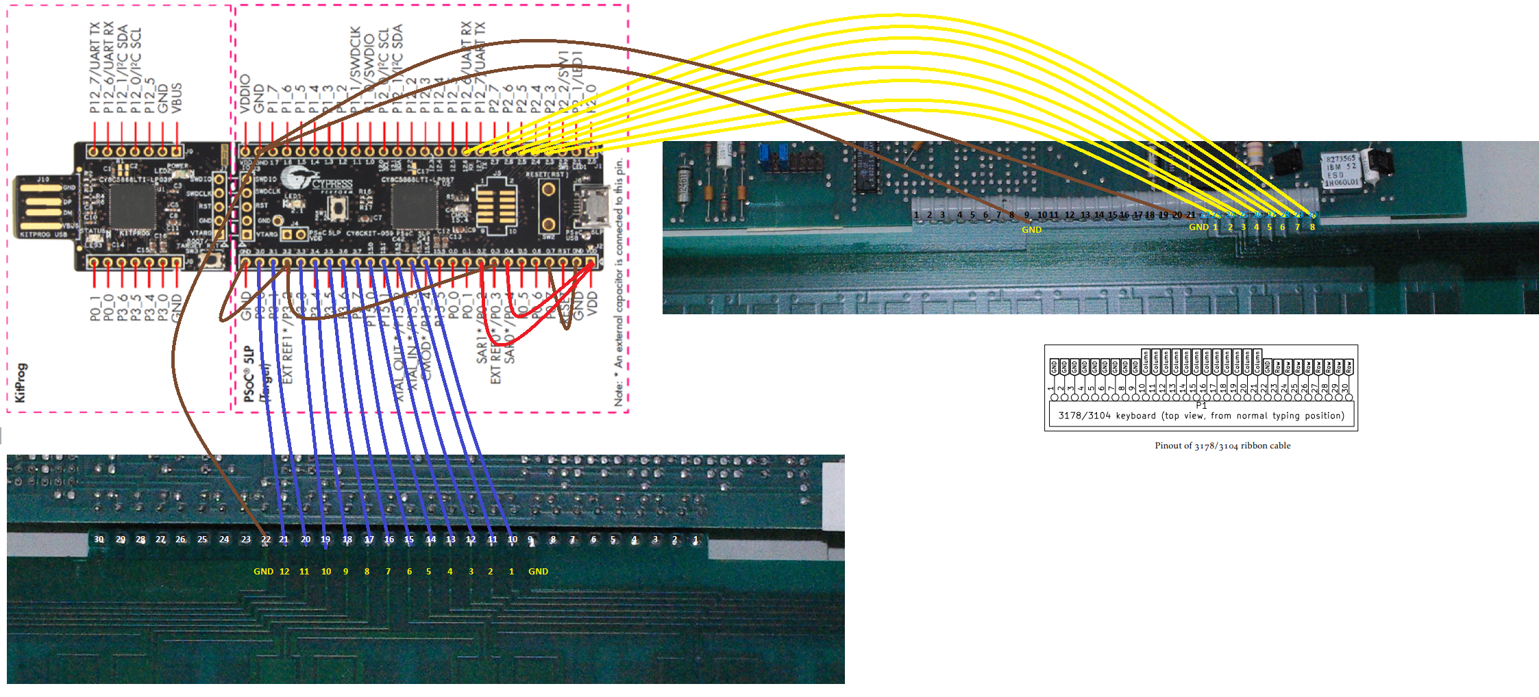

Here you go https://github.com/dmaone/CommonSense
For the pintout, here's the one I went with. However, take note that this pinout is based on a previous version of commonsense than whats on Github. The new version has a different default pin assignment. So use my diagram ONLY for reference.
