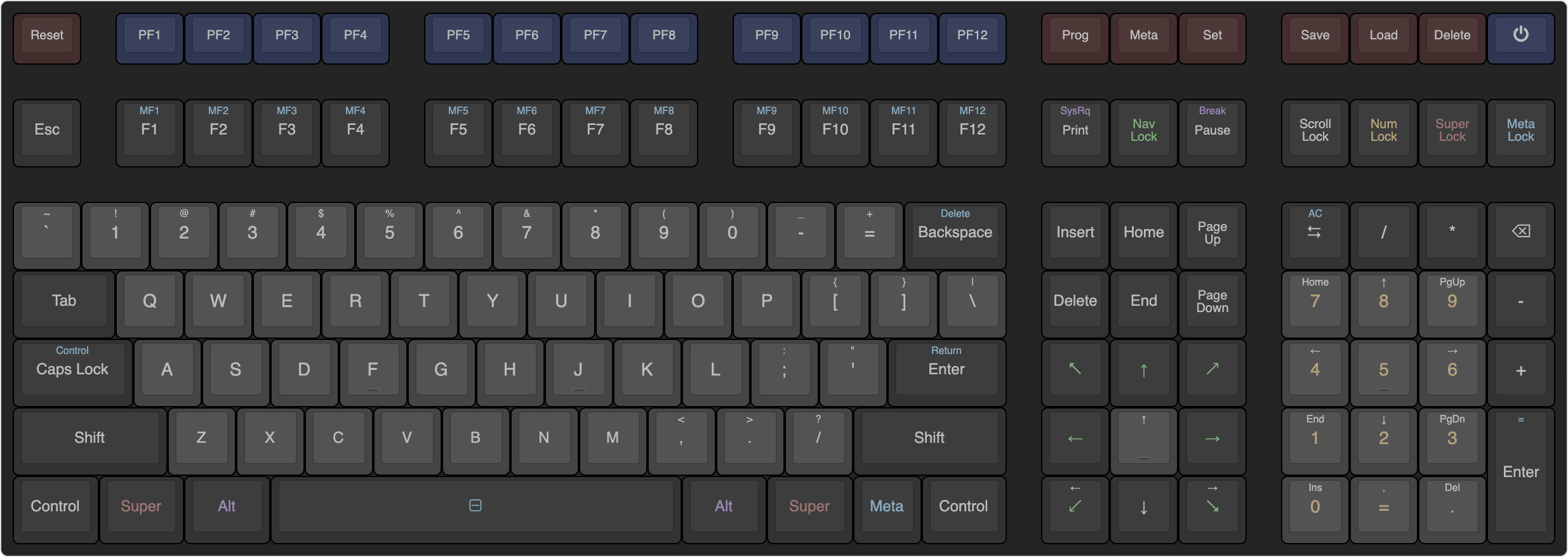

Looking at those vintage LEDs made me want a keyboard that's all LED window keycaps with old-school tri-color LED. Have different LED options when you press a key such as Always-On, On-On-Press, Off-On-Press, Blink-On-Press (1 time, 2 times, 3 times, etc.), Fade-On-Press ... you get the idea. Make sure it's compatible with XT, AT, and USB. Will probably need auxiliary power of some sort when not used with USB.
This is the keyboard layout I came up with. Had fun with the layout designer. It's black & charcoal because my 486 is black & charcoal, but could be any color obviously.
A couple new keys. Nav Lock to toggle between 8-way nav and T-nav. Meta Lock makes the Meta function the default operation for a key. You can program Meta Lock using Prog + Meta Lock (not Meta, that's for something else.) Meta Lock-Reset will clear all saved Meta Locks.
Programmable Function keys in blue. These can be programmed via the Prog key. Hit Prog, hit a PF key, then type on the keyboard. Hit Set to set the key. Repeat for others. The red Meta key lets you program the Meta Fkeys. Prog, Meta, MF key, type away, then Set.
You can Save, Load, and Delete profiles to the keys. Prog, Save, PFkey, Set to save all currently programmed keys. Prog, Load, PFkey, Set to load. Prog, Del, PFkey, Set to delete a saved profile. Up to 24 different profiles can be stored between the PFkeys and MFkeys.
Prog-Reset will reset all programmable keys. Prog-Delete-Reset will clear memory. Alt-Super-Meta-Control-Reset will reset the entire keyboard to default settings and clear memory.
Super Lock is for disabling the Windows key. Not so useful on a Mac that utilizes the Super instead of Control.

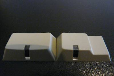

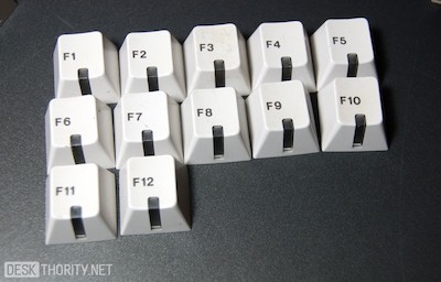

Below are examples of windowed keys, including 0.5u windowed keys.

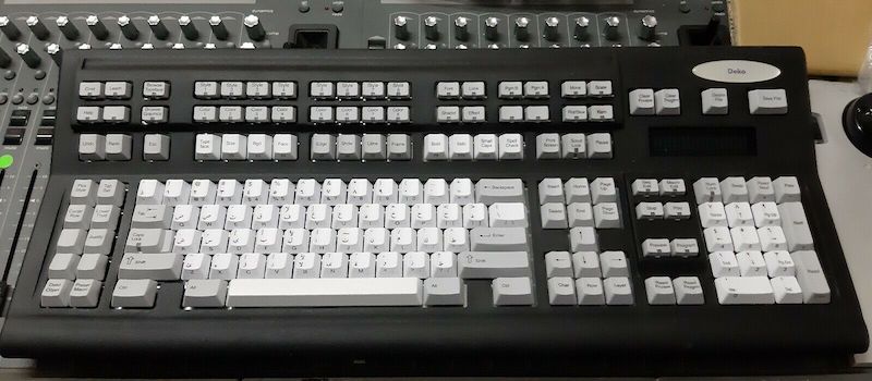

One issue that comes to mind for me is what LED windows actually look like. They shine as a bar on the key. They look like an indicator light—WARNING!—rather than an always-on identifier, like a legend. Yet it is possible to use LED windows in large numbers, and do so with a neat vintage look. Nord does a great job of that with their flashy electric pianos:
But don't mistake LED windows with backlit legends. They are different duties. Turn the room lights down, and that piano and your keyboard will need the same muscle memory as unlit ones.

Muirium wrote: 21 Sep 2019, 14:43One issue that comes to mind for me is what LED windows actually look like. They shine as a bar on the key. They look like an indicator light—WARNING!—rather than an always-on identifier, like a legend. Yet it is possible to use LED windows in large numbers, and do so with a neat vintage look. Nord does a great job of that with their flashy electric pianos:
Oh, I know. Absolutely NOT backlit legends. Yep, just the opaque keycaps with the little windows and a diffused LED. :D Yes, they'd be practically useless as true LED backlighting, but hey, this is about the nostalgia factor and not practicality. They might illuminate the key on the immediate row below it. :lol: However, there is something to be said about visual feedback for when a key is pressed, so it does offer some function.
