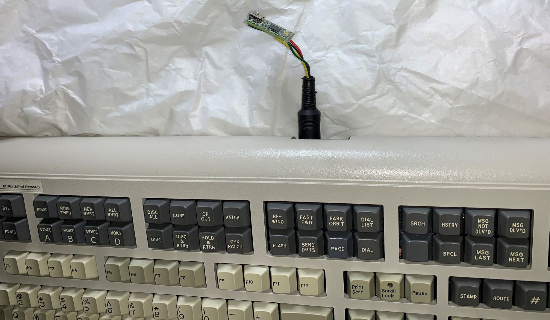

MMcM
20 Oct 2019, 05:46
Okay, I picked up some DIN5 connectors from Jameco and it seems to be working.
For now, it's in an amtelco_kb163 commit in a branch in my working QMK fork.
I didn't put any thought into the key mappings: I just spread F13-F24 around in the various extension blocks. Plus, since this is Winkeyless, it puts GUI on the top-left ON key.
