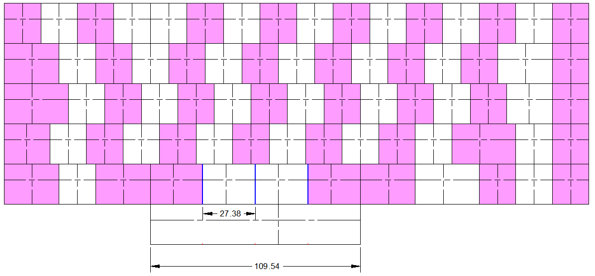

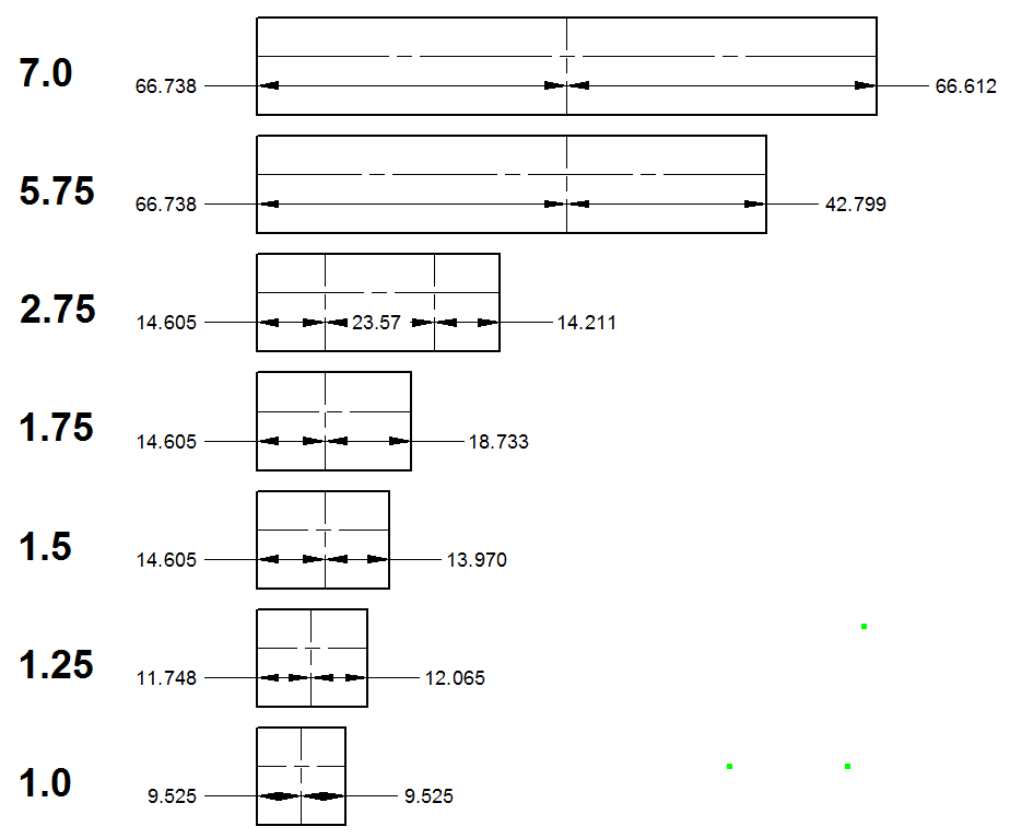

wcass
10 Oct 2019, 20:01
We could make a 3u space bar with posts equivalent to 1.5+1.5 and adjust some things a bit.
Then all of these become available ...

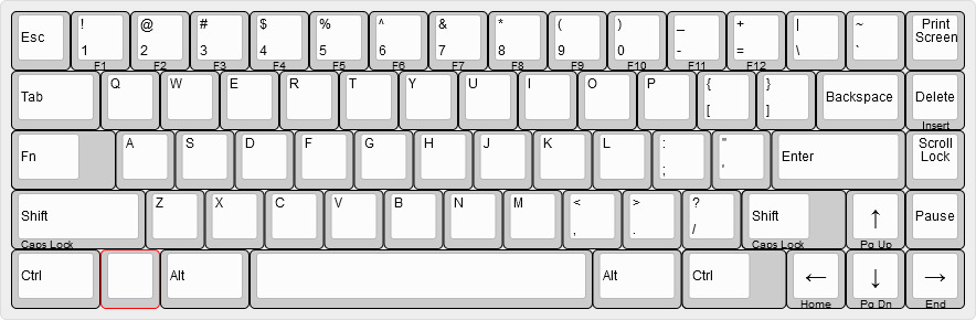

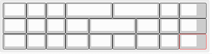

manisteinn
10 Oct 2019, 22:32
Let's compare the options
Your suggestion (2):
- The 5.75u spacebar pad interferes (I personally don't mind)
- AFAIK a 3u key doesn't exist. I could attempt slicing my 9.75u spacebar to create one, but there'd be a visible seam. Ordering a quality 3dprinted one and casting it is an option, that's still added cost and wouldn't precisely match the surface finish of the remaining caps.
My suggestion (1):
- Nonstandard 1.75u l-alt key when using split space, a blank/incorrect legend one could be used instead (caps/ctrl/shift/fn), or a standard 1.5u one with a gap.
- Space can't be replaced with 4 1.5u keys, an ugly gap is inevitable.
- A single 2.75u space (red) requires a separate bottom mold due to stem location, the green one is also possible with a separate mold. Annoying but not a big deal.
KLE layout, please correct if I got something wrong
Edit: Realised yet another option with the green spacebar is possible, added

wcass
15 Oct 2019, 19:55
i think it is worth trying - make the bottom row pads slightly wide to accommodate as many different layouts as we can. We would need one more pin for a new column, though. Any suggestions as to what pin to use? And what pins to use for the TP option - with consideration for routing? Though i suggested it, maybe we should just give up on the pogo pin idea.

manisteinn
16 Oct 2019, 18:17
wcass wrote: 15 Oct 2019, 19:55 i think it is worth trying - make the bottom row pads slightly wide to accommodate as many different layouts as we can. We would need one more pin for a new column, though. Any suggestions as to what pin to use? And what pins to use for the TP option - with consideration for routing? Though i suggested it, maybe we should just give up on the pogo pin idea.
I will be visiting friends in San Francisco the week of November 9 and plan to go to the meetup in San Jose that Saturday. I will bring the CSSK for folks to play with and will talk up this project.
A flexible bottom row would indeed be nice :)
J1 unused pins are 12.0,12.1 (I2C), 12.7, 2.2 (SW1) and 2.1 (LED). P12 can't be used for sensing and I'd like to keep I2C, so I see two options:
- Add a sixth row using 12.7 and split the bottom row. Looking at the current bottom layer that doesn't seem too difficult.
- Add a column using 2.2, the onboard switch can't be used but I don't think that's a problem. 2.1 could also be used by desoldering the LED
The TP option would only use J2 pins so it doesn't affect the pad card. I've already done the pogo pin case design, so unless we're going for a custom controller with a different pinout I can't see that eliminating them makes a difference at this point. In any case I can do another case version where the CS board attaches to the "roof" and wires are used for soldering to the pad card.
wcass
17 Oct 2019, 05:32
I finally found my cheat sheet with post position measurements on it. There is about 1 mm between caps, so the actual caps are about 1 mm smaller than this. It is marked to .001 precision, but don't believe that. If you are off by 0.1, everything will work fine and no one will notice. I would not be surprised if IBM designed in millimeters not mils; 1u = 19.00 not 750
Model F key mm spacing.png (25.28 KiB) Viewed 18099 times
It looks like the "Code" cap posts are not where you would expect them to be. All of the other multi-wide caps are composites of other caps; ISO Enter is 1.5 over 1.25; ANSI Enter is 1 + 1.25; ANSI left Shift is 1.25 + 1; right Shift is 1 + 1.75. I was expecting Code to be 1.5 + 1.25 but it is not. It is closer to 1.5 + 1 + 0.25. With the posts where they are, the space bar is best replaced with a Code plus two 1.5u caps.
As rare as Code caps are, i expect that we would have to make these - and convex 1.5 and 3.0 to complete the row options we want to offer. If we commit to that, It may be more efficient to ignore the Code and just do just two - 1.4375 and 2.875 - like this ...

manisteinn
18 Oct 2019, 20:06
Measuring across 9 1u keys on my 5921 plate it seemed closer to 6" than 152mm
Thanks for the graphic, good to know.
I suspected my red option above might be the actual code key stem placement, isn't that what you're suggesting? L>R: 1.5u key, 1u key and 0.25u gap.
Ignoring the code key doesn't make sense to me as it's the only one that can be cloned practically 1:1 with minimal investment. Convex 1.5u keys occurred to me too, I'd like to experiment with splicing and smoothing casts for new molds and see what results I can get. 3u is also an option using this method.
Do you have another process in mind for these keys?
