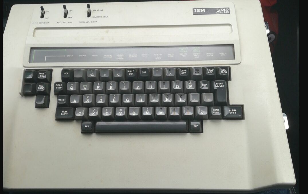

Convert&Restoration project of IBM 3742 beamspring keyboard
Heikkonen
06 Oct 2019, 23:29
I just recently picked up this beamer from being recycled, sadly the other parts of the system it was built for were long gone according the contact i got it from :(
The case itself was in pretty good shape but aluminium parts had some minor damage as seen below
I was surprised how good of a shape it was and it was been clearly kept well considering its age. I proceeded to open it and check the condition inside to figure out what kind of restoration it needed. I saw there was spots of rust but evaporust will take care of them soon.

kmnov2017
06 Oct 2019, 23:34
Now that's a find! Where's the rest of the table?
Heikkonen
06 Oct 2019, 23:37
The lady who i got from said that the rest of the system were recycled years and years ago,what a shame.
