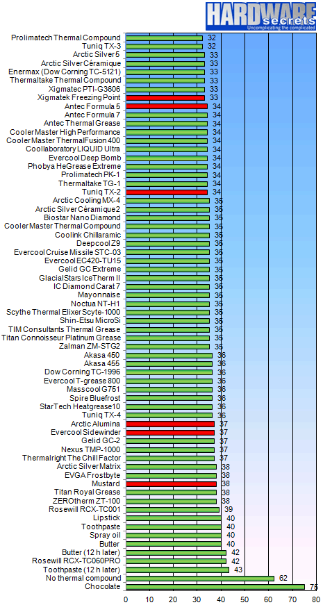

I liked this, but part 4 is incomplete without mayonnaise and toothpaste test data. No internet test is complete without these 2 essential materials.

SneakyRobb wrote: 09 Oct 2019, 16:59 I liked this, but part 4 is incomplete without mayonnaise and toothpaste test data. No internet test is complete without these 2 essential materials.
As contaminants, or as lube?
You're thinking of thermal paste testing.

Exactly! What if mayo really does work for Alps?
Or toothpaste, it could also work to keep it clean.
Just like thermal paste tests

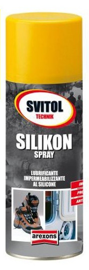

4. And a Silicone Spray: a random silicone spray that I bought 2 years ago (Svitol Silikon Spray). I didn't use it as is, but instead sprayed some in a small cup, and let it dry, and then applied that with my small brush. Here is a picture of it:

4. Spray Silicone: surprisingly this one worked well. Made it very smooth, eliminated any resistance and scratchiness in the off-center presses and generally made it very smooth. BUT that lasts only for about 1-2 days of use and then slightly starts to loose its smoothness and starts to slightly bind in off-center presses and the smoothness fades away.

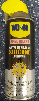

I've had good luck with "WD-40 Specialist with PTFE"
It leave a slightly oily film instead of being completely dry like Dupont PTFE i've tried, it seems to work well.
I put some on the Caps Lock switch of my yellow Alps64 (mapped to fn) to stop it from binding and it hasn't lost it's smoothness.

abrahamstechnology wrote: 22 Mar 2020, 17:28 I've had good luck with "WD-40 Specialist with PTFE"
It leave a slightly oily film instead of being completely dry like Dupont PTFE i've tried, it seems to work well...
I second this one. I've used this on a number of different switch types with good results including complicated Alps and some crazy squeaky Datanetics DC-60s on a Fluke board. It seems to last (at least a couple months so far) and I've actually seen improvement in the switch feel over the first week or so after application. I haven't been spraying the switches directly but have been spraying it in a small cup and then applying to the switches with a cotton swab to avoid over spray. I have also been swabbing the switches with 91% IPA prior to applying the WD-40. Also, I think it is important though to be clear that it's not the regular blue can WD-40 spray, but the plastic safe silicone lube version.

To add to the confusion: Also in europe at least, there's the specialist high performance silicone instead of the Water resistant silicone one.
Anyway regardless I ordered both the silicone and the PTFE ones, along with a FinishLine Dry Teflon (DuPont rebranded supposedly) tube and I will test them and report back soon.

4sStylZ wrote: 30 Mar 2020, 19:37   @abraham speak about "WD-40 Specialist with PTFE" and @Old is new speak about the WD-40 Specialist water resistant silicon lubrifiant.
That's two different product, wich one did you suggest ? PTFE ? Silicon ? Both ?
My bad for being confusing. I've used the WD-40 Silicone spray not the PTFE version. So I too, am very curious to see how you think they compare!
