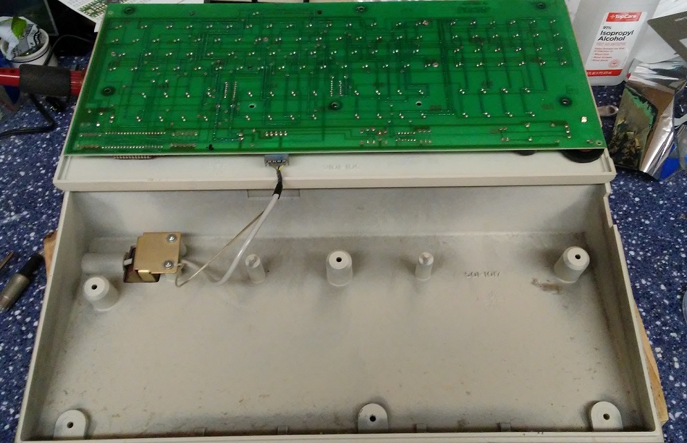

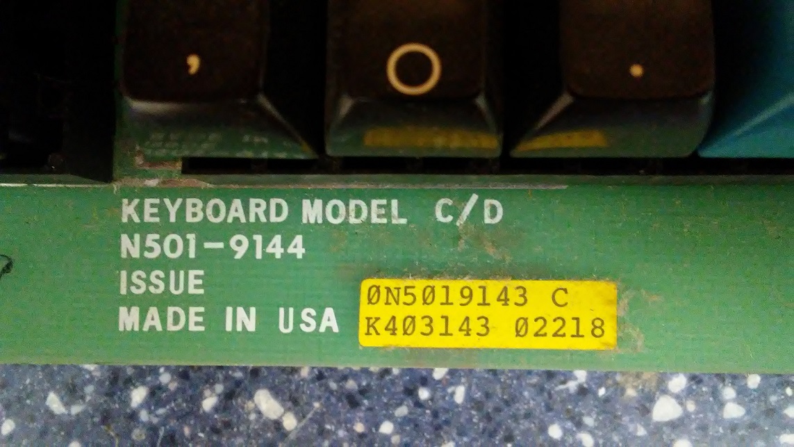

I thought this was an interesting looking board. The switches are Hi-Tek High Profile, but I figured what the heck. Couldn't find any date stamps.

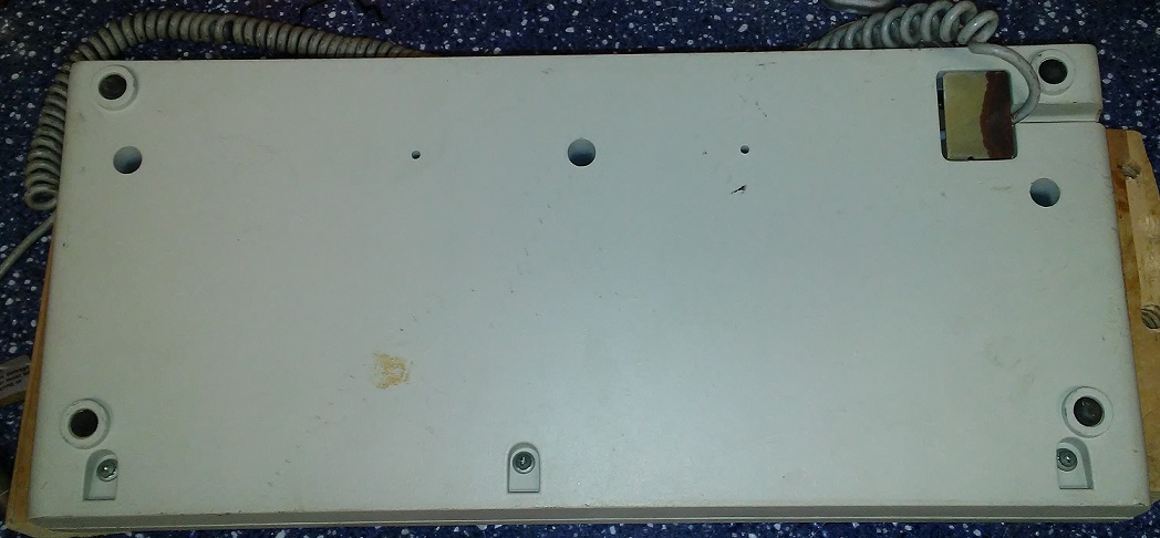

Opened it up. A very roomy, mostly empty case.

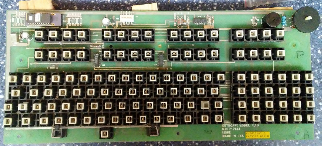

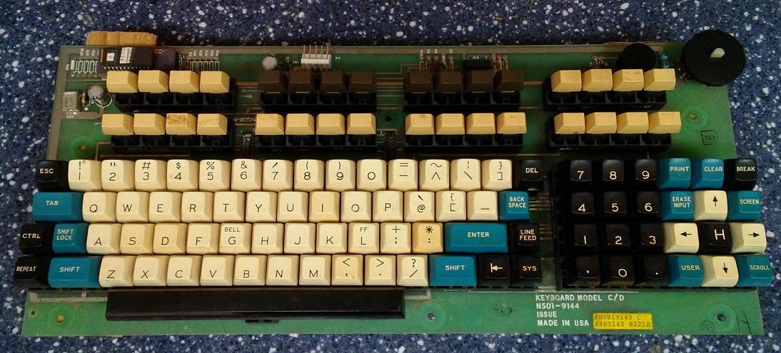

PCB:
PCB_back (2)_SM.jpg (302.98 KiB) Viewed 3504 times

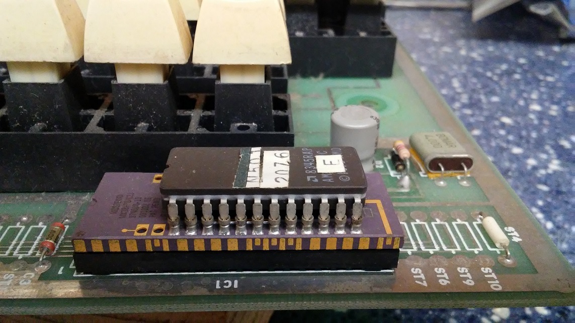

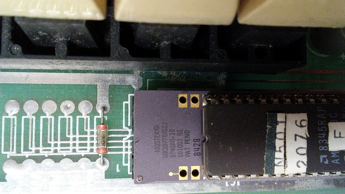

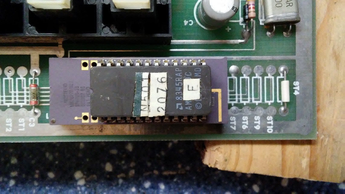

The Main IC was unusual:

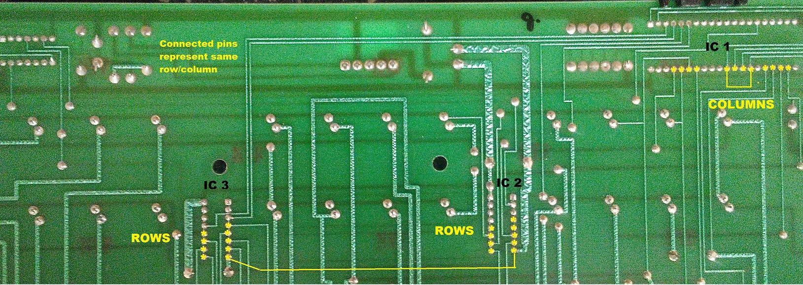

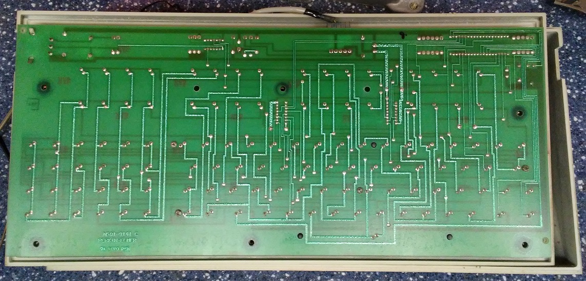

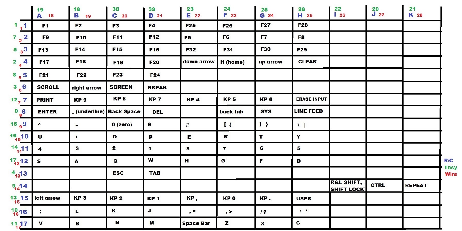

Traced out the rows and columns:
This is the matrix I came up with:

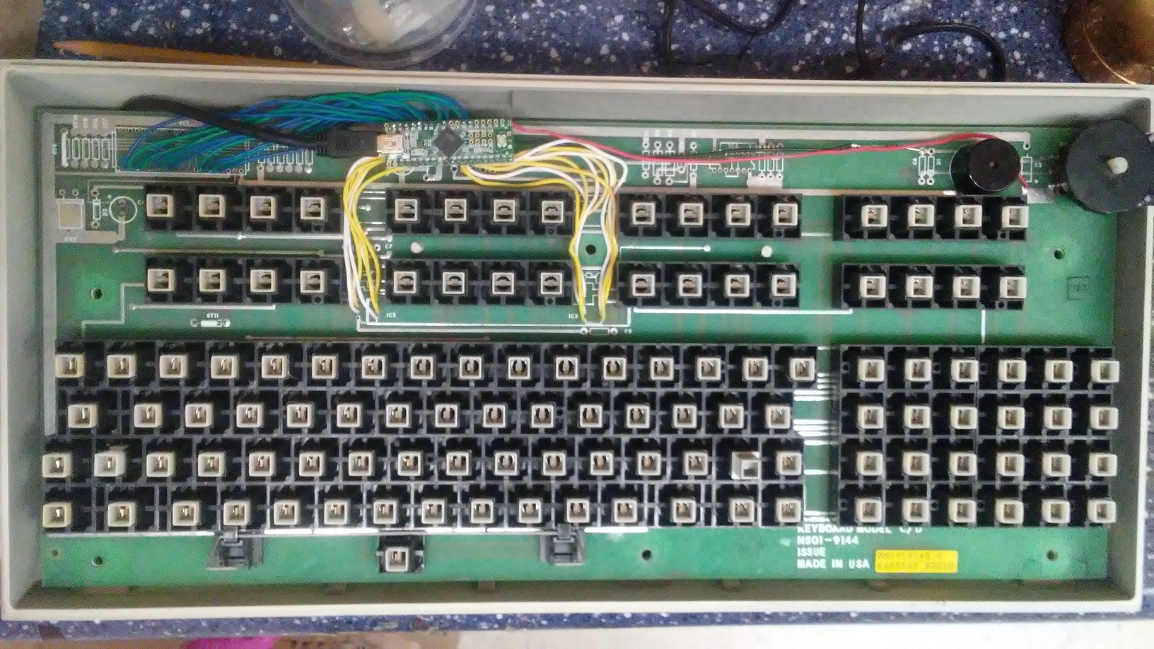

Wired up the Teensy. I put it on the front because of the room and just personal preference, but PLENTY of empty space for it on the back too.
I hooked up the buzzer for key clicks. There is a potentiometer dial on the board that controls the volume, so can turn it off!

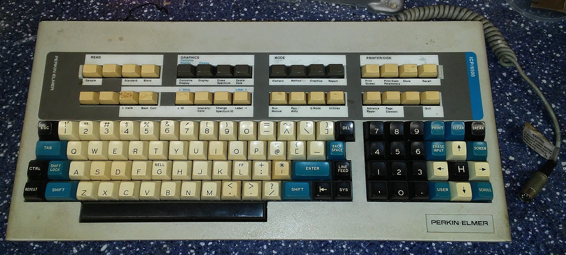

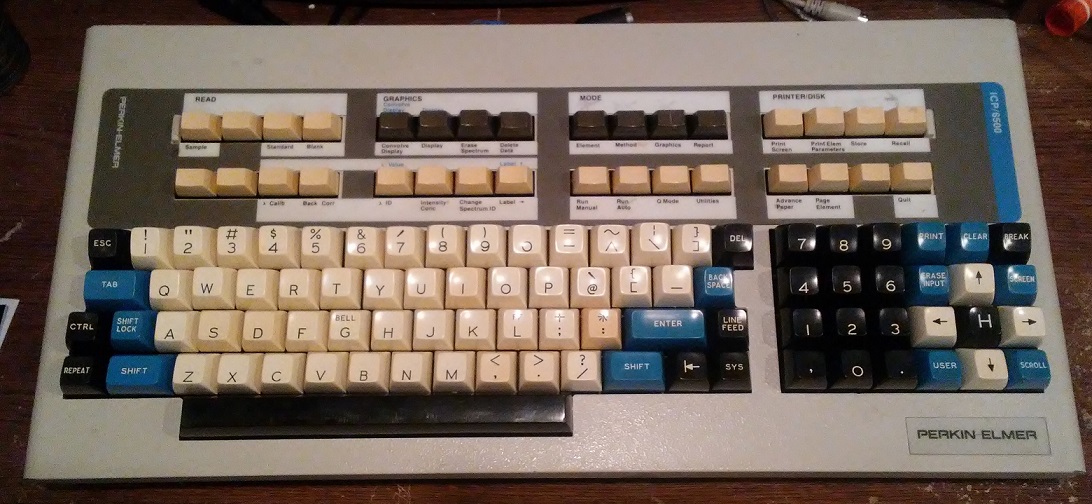

Finished (I may retrobright the keys, but haven't decided for sure yet). I'm not a big fan of the Hi-Tek High Profile switches, but did brush on some plastic safe silicone spray lube and that helped!
