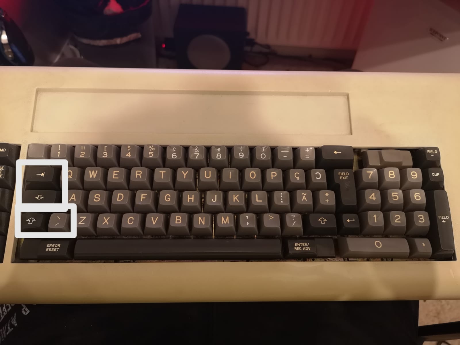

Hello everyone I had finally finnished restoring my IBM 5251 Beamspring keyboard. I actually made a thread about the full restoration process here: viewtopic.php?f=7&t=22586. I seem to be having a problem where some keys are registering as the same keys. What I mean by that is that some keys output the same scan codes. Below is an image showing the specific keys that seem to be linked. If you guys could help me resolve this problem it would be much appreciated.
Thanks.

Have you checked to see that the keys don't trigger each other's thresholds and that one doesn't override the other?
Fkazim
16 Oct 2019, 19:48
They do trigger eachother as they register as the same key. I just don't know why. I tried changing the thresholds but it's either I go low on the threshold and none of those keys I outlined register or I go higher on the threshold (141) and those keys In each square I outlined activate eachother. For now I have set left shift's pad to be ignored so my backslash works and I set the caps lock pad to also be ignored so that my tab key on top functions correctly.

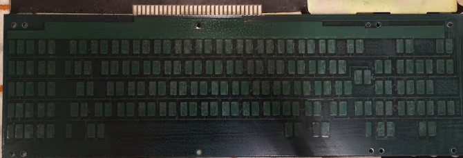

OK so I have taken the keyboard completely apart again. I sanded the edge connector making sure that all the contacts are nice and shiny and not oxidised. Also I cleaned the capacitive pads on the PCB. I am pretty sure it is some sort of bug in the Xwhatsit firmware. As when checking all the traces on the PCB all looks to be good. Please let me know your opinions on if you think the PCB is at fault below I have posted a picture of the PCB.
Thanks.
