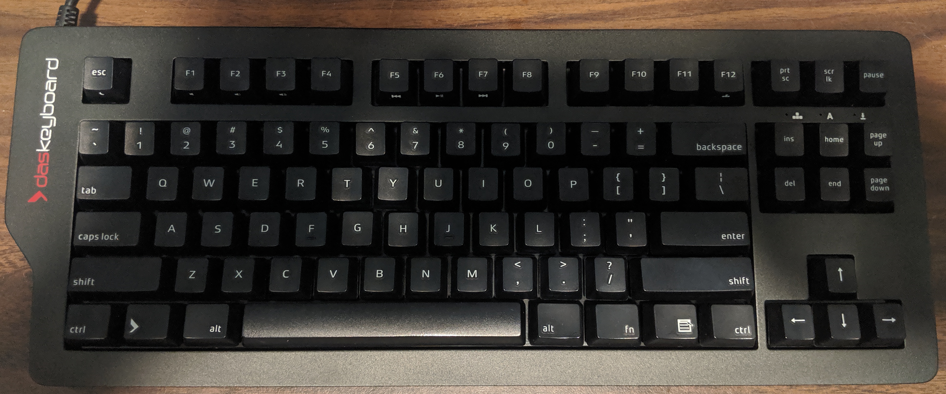

Hello,
I recently acquired a known defective Das Keyboard 4C in ANSI layout through classifieds; looked in pretty good shape but it was described as having two defective switches, B and N, which indeed did not register.
Das Keyboard 4C
Das Keyboard 4C
2019-10-29 01.12.51.jpg (1.84 MiB) Viewed 2392 times

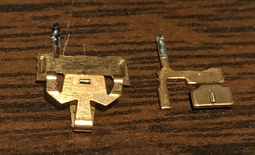

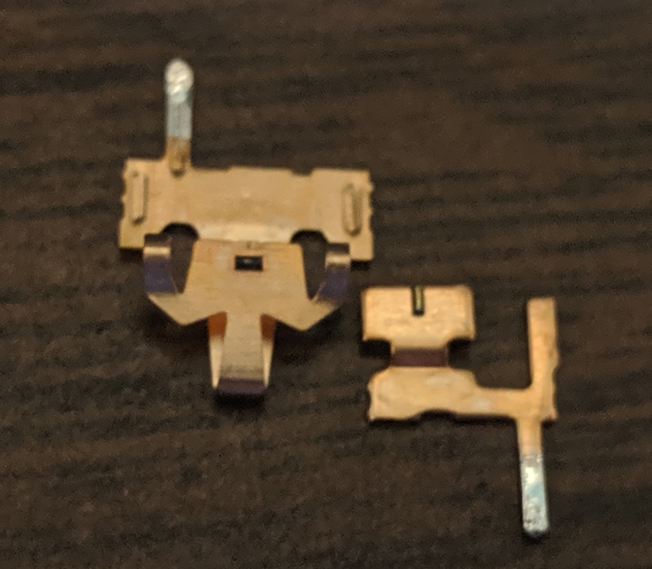

This particular unit has Greetech Brown switches; I'm not sure how they rank in terms of reliability, but the six or so switches I've opened all had contacts looking like this, not impressed:
Corrosion...
Corrosion...
2019-10-29 01.42.30.jpg (230.52 KiB) Viewed 2392 times

The fix is simple but tedious: clean the contacts with a pencil eraser:
Nice and shiny
