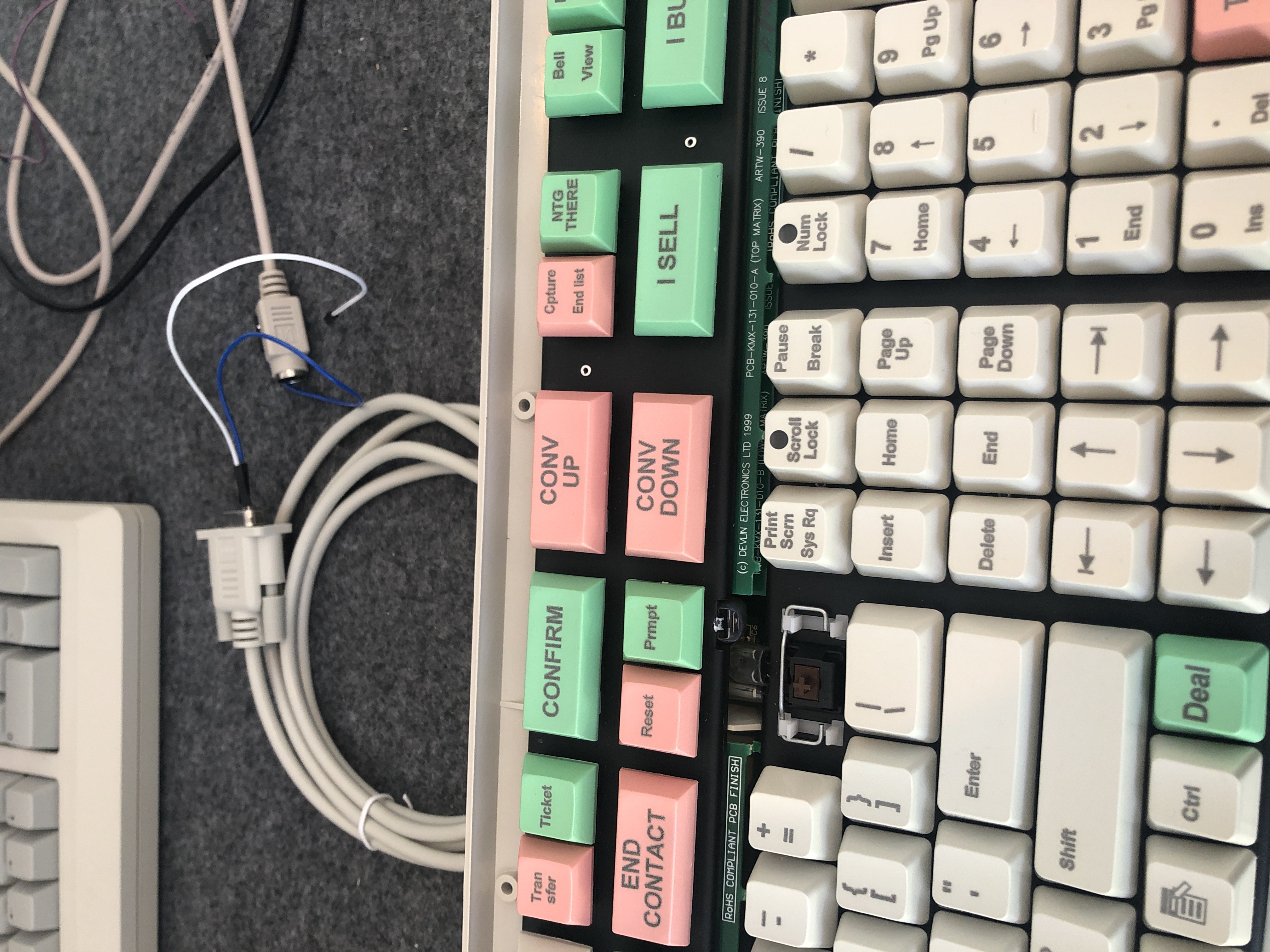

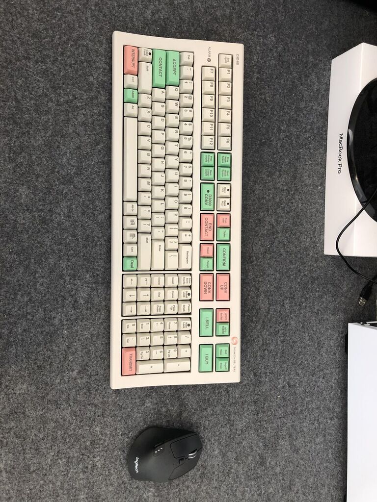

I have aquired a Reuters D3D trading keyboard, I got it brand new and unopened. I would love to convert it but I'm not sure how to go about it.

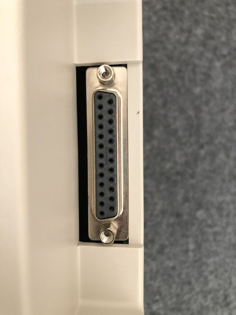

It uses a DB25 (25 pin) connection, but it looks like it only uses 6 of the 25. I would like to either get it working straight to USB or get it connected to my pro micro.
I believe it can be done, as this thread https://github.com/babarrett/g80-9009/b ... -cables.md
highlights the process of wiring up a G80-9009 without the Reuters converter box.
Would anyone be able to shed some light on how I may replicate this using a 25 pin plug? Thankyou!
Here are some photos ;)

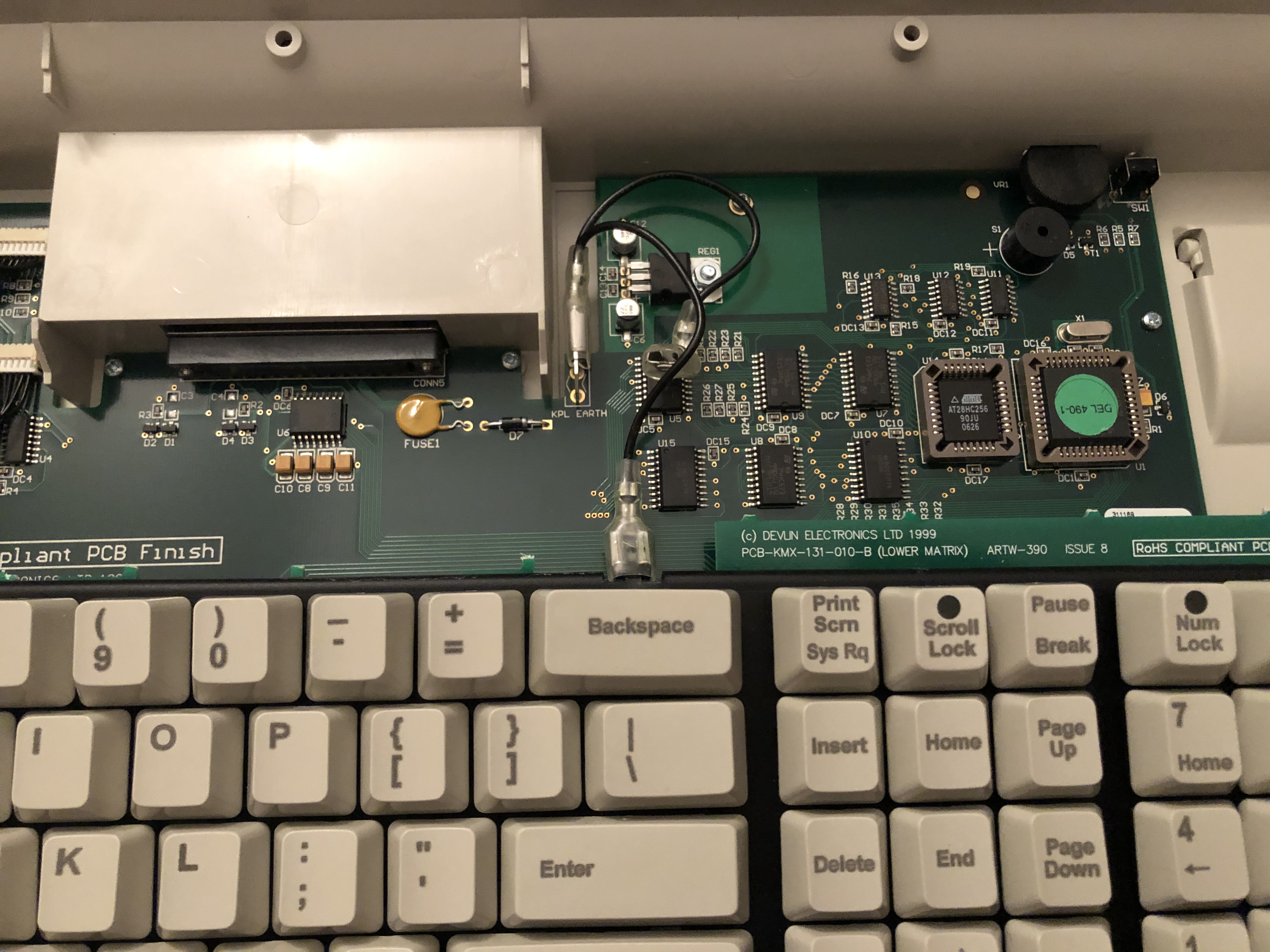

You can start by opening the case and photographing the pcb.
Jesseg
30 Oct 2019, 12:41

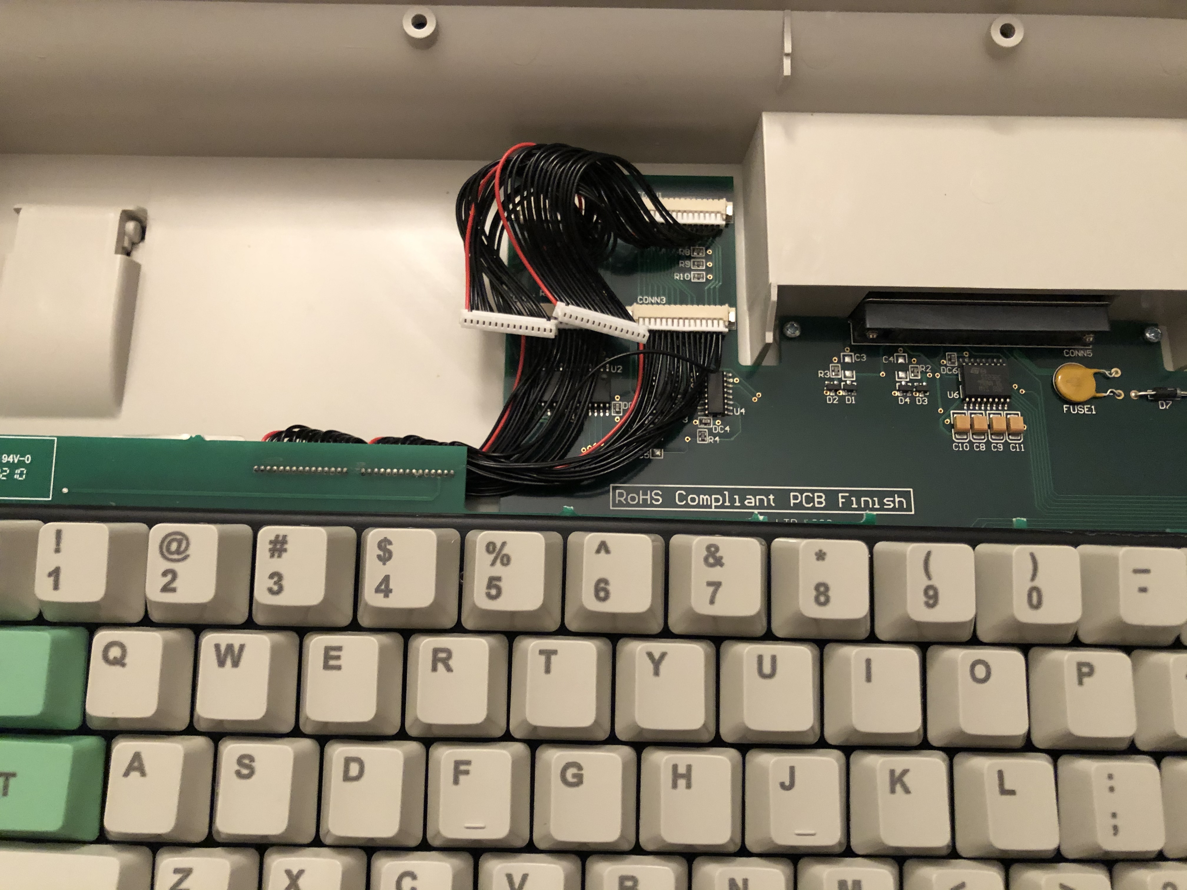

I have removed the top section so it’s easier to view, it’s just attached by the 2 ribbon cables and the ground.
gipetto
30 Oct 2019, 15:40
Those ribbon cables are encouraging. it looks like an easy controller replacement. assuming you don't want to keep the db-25 port you will have to examine the pcb traces to identify which pins are rows and which are columns. see if there are diodes for each switch present. if there's not then you will have no n-key rollover. if that is a problem you will have to make a custom pcb.

So I’ve acquired a db25 to db9 connector and was trying to connect 5v and gnd from the PC side PS/2 cable. But no luck..

For external power, REG1, visible in the third photo, is connected to pin 23. Give it 9-12V DC, like from a wall wart. Ground is on pins 3, 8-13, and 25. (15 and 16 are also ground, for reasons guessed at below.) With that, the Desk PC2 and D3000 CONV keys work to change the mode of the keyboard.
When in PC2 mode, there is a PS/2 keyboard with pin 1 data and pin 2 clock. So it ought to work with an active converter, or TMK / QMK, or even Soarer's, if anyone still does that. As usual, a 3V MCU will need level shifting.
In PC mode, it acts as just a regular PC keyboard. None of the trading keys (green and orange dyesubs) send anything, with the exception of TRANSMIT, which is just keypad enter. Moreover, the I SELL, I BUY, ACCEPT, and CONTACT keys automatically switch to D3000 mode.
All the keys are available in D3000 mode. There is an RS-232 serial port with pin 14 RXD and pin 17 TXD. It runs at 9600 baud. So a converter will need something like a MAX3232 to convert to TTL serial, which the MCU's UART can then handle. U6 in the third and fourth photos above, right beside the DB-25 connector, is an ST232C, a more or less equivalent chip. Pins 15 and 16 are ground, which suggests to me that 14,16 and 15,17 are meant to be RS-422 differential pairs and this is an engineering shortcut, giving 0V and ±7V. (The TTL-only shortcut is an inverter, so 0,5V or 5,0V. This is even worse over longer distances.)
