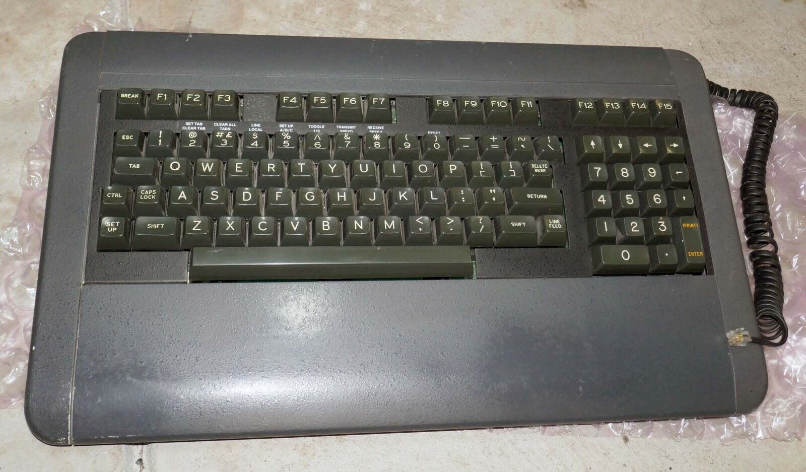

A quick weekend project is an unknown keyboard with Hi-Tek flat-top switch modules.
This is rather similar to one that JP! has, with some notable differences:
  • No branding.
  • No LEDs.
  • More function keys.
  • SET UP key at the bottom.

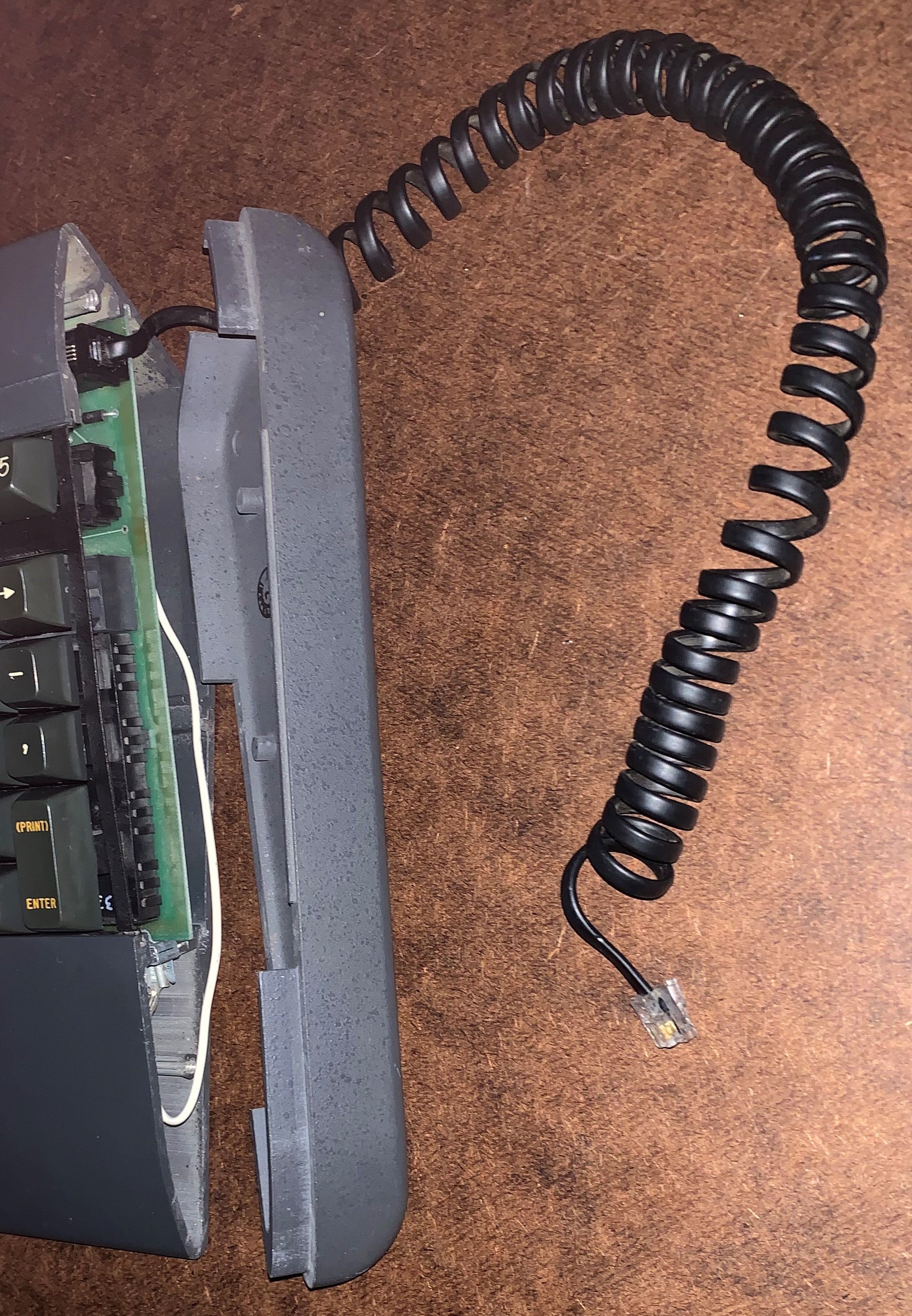

  • Modular connector.
I imagine these are from the same line of OEM boards at different times. So I have no reason to suppose the equipment it was for is in any way related.
The anodizing coating is worn down where users have rested their wrists. Even though it has a numpad, the main module number keys all had nicotine stains that required a little extra scrubbing.

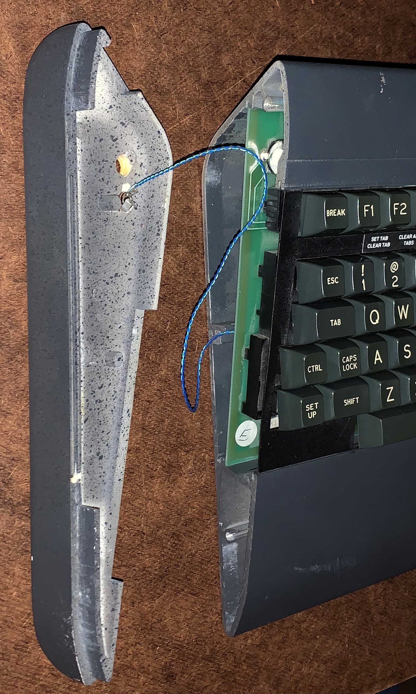

The main case is a single piece of aluminum. The end caps are molded fiberglass.
The right cap reveals a speaker and a big chassis grounding strap from the PCB. Feel free to wear polyester to the office.
The left has a phono jack attached with blue wire-wrap wire. I certainly didn't guess what it's for correctly.

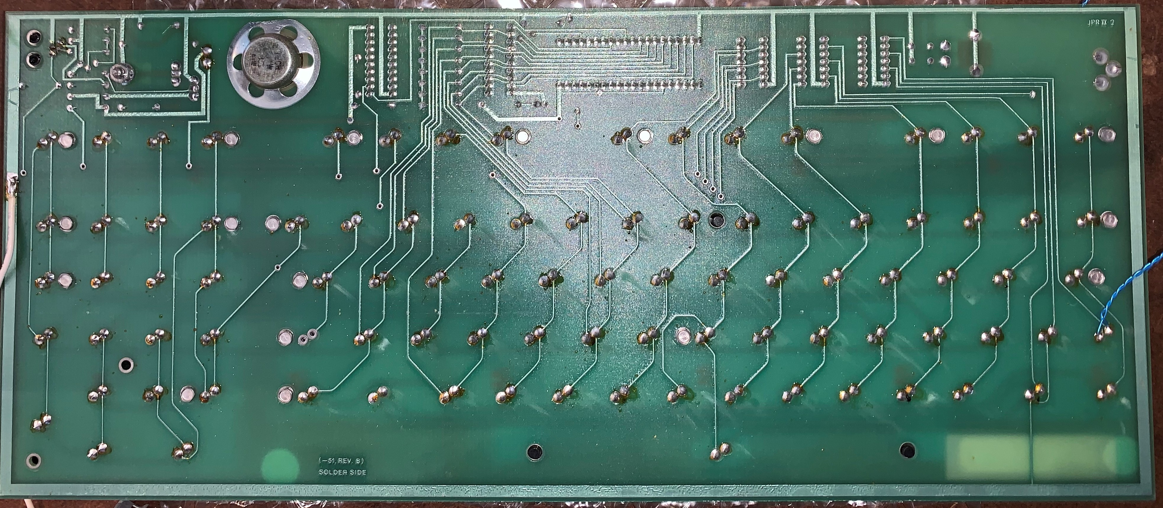

There is no branding on the PCB, either.

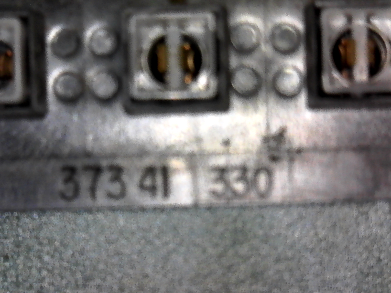

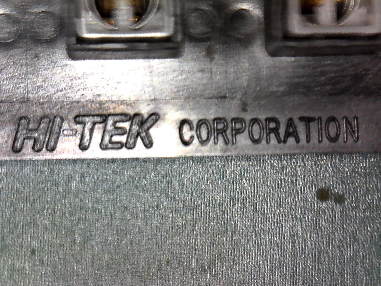

The Hi-Tek identification is, as usual, under the spacebar.

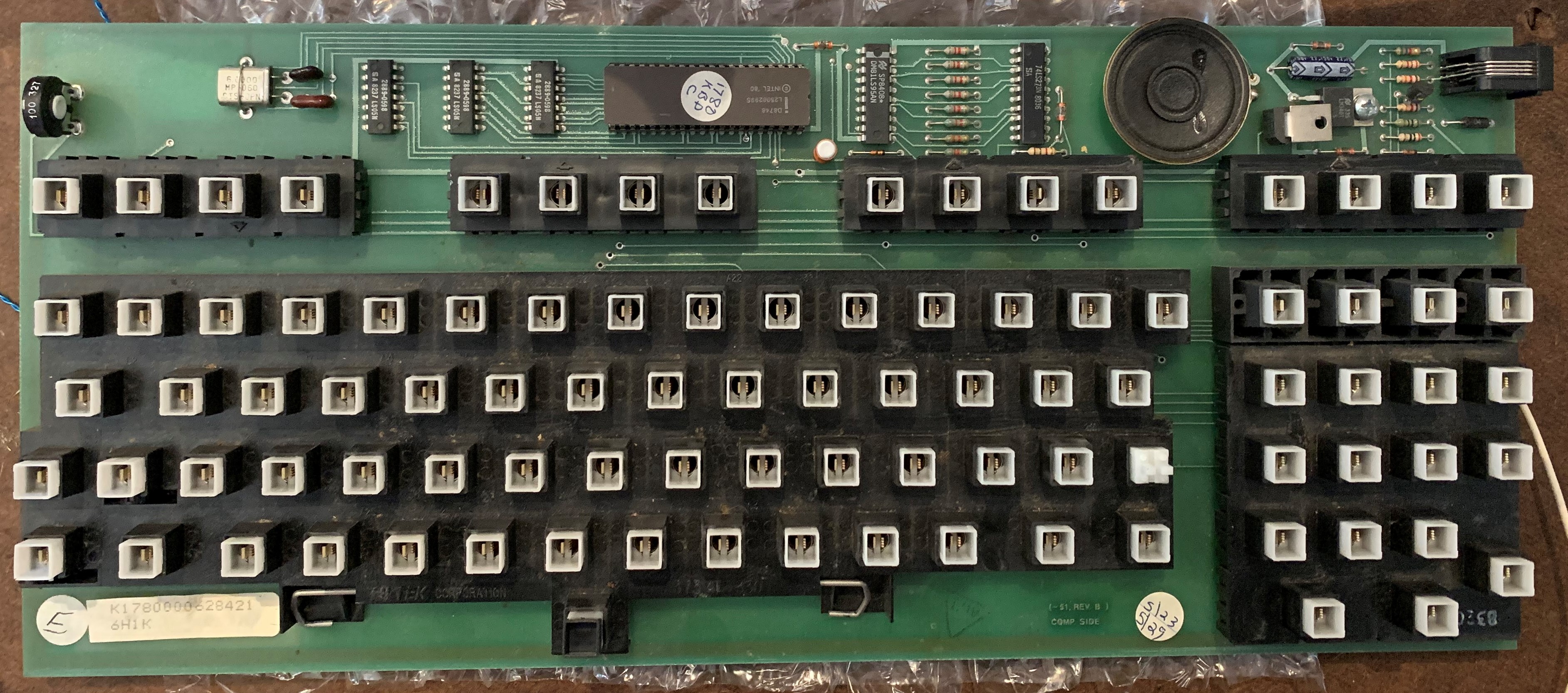

Highlights of the circuit:
  • Power from the modular jack goes to an LM340T-5.
  • The speaker is connected to a simple power amp and has a volume pot that lines up with another hole in the left end cap.
  • Output to the modular jack is from the right-most output of a octal flip-flop chained up with a buffer as a shift register.
  • The switch matrix rows come from the buffer and columns go to inverters, which also act as buffers.
  • The controller is an 8748, which is actually a lot of processor for a keyboard.
Left to right: volume potentiometer, clock crystal, inverters, 8748, buffer, pull-ups, flip-flop, speaker, power amp, voltage regulator, more pull-ups, modular jack.
Now it turns out the phono jack is wired to the CTRL key. I actually don't have any idea why an external CTRL key would be useful.

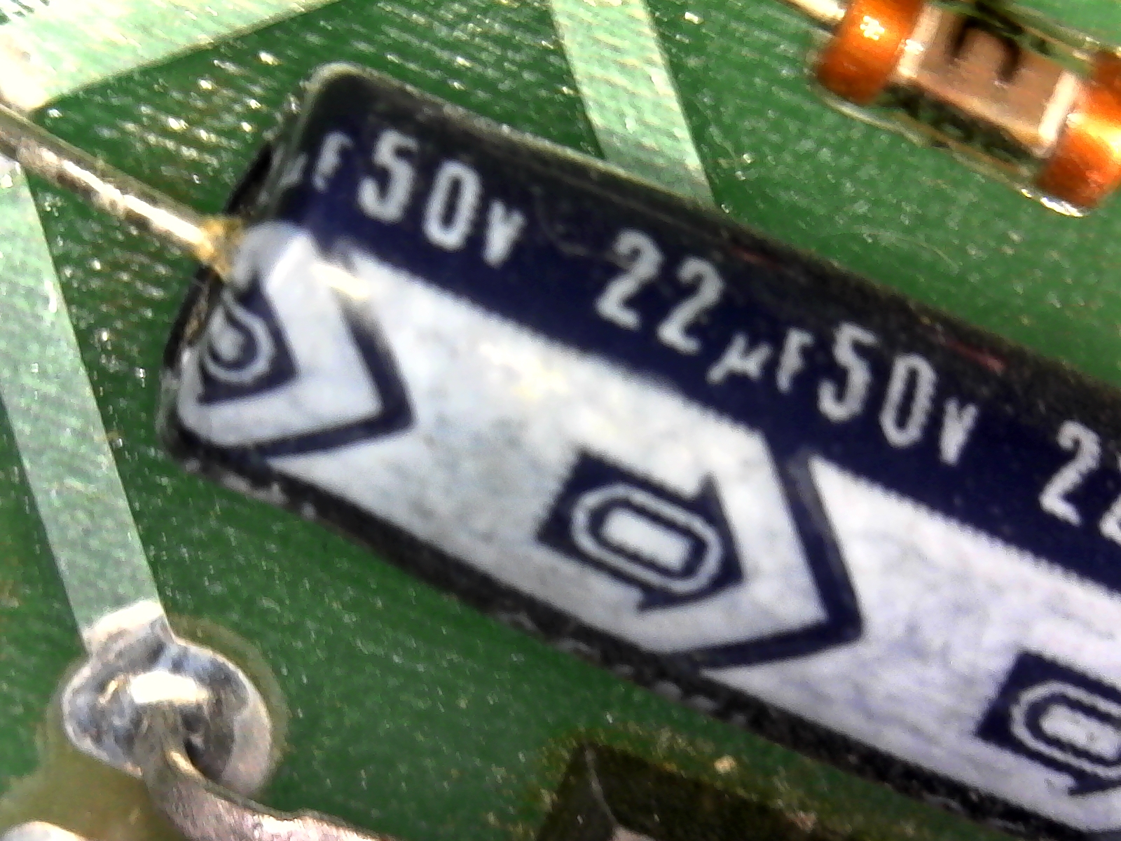

It would be straightforward to rewire this to take 5V in directly from USB, bypassing the voltage regulator. But after replacing the input capacitor, which looked a little wonky, I decided to just keep it as is and will be powering with a 12V wall wart.

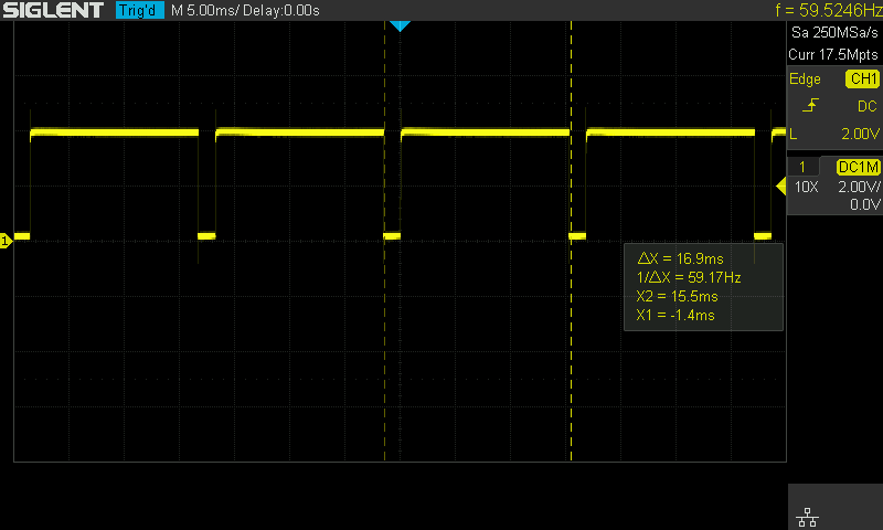

Power it up and this is what it outputs.
Banging on the keys doesn't make any difference.
Connecting a logic analyzer to the RD/ and WR/ pins of the 8748 shows stuff being loaded into the shift register, but the key matrix is never being scanned.
There are no LEDs, so there is no control for that. But there is a speaker and the fourth connection doesn't just go straight to its amplifier. So what's missing must be an input initialization command.
If the roughly 60Hz pulses shown above were TTL serial, they would be a stream of FF's at 600-odd baud.

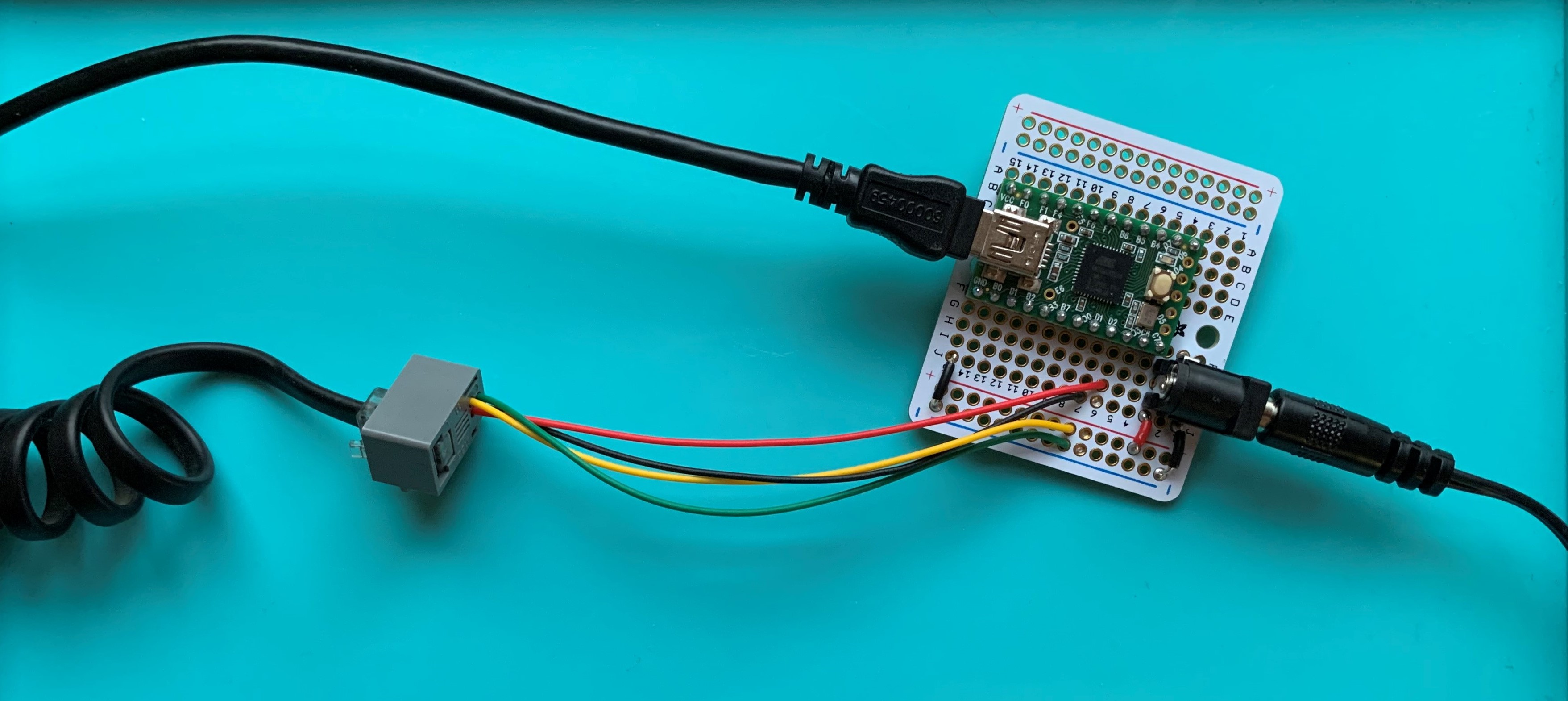

Just initializing the input line from the Teensy's TXD pin, that is holding it high, isn't enough. So, try the simplest thing possible, send a 00 byte. Yep, that is enough to get things going. The RD/ line starts going low and key presses cause serial output.
