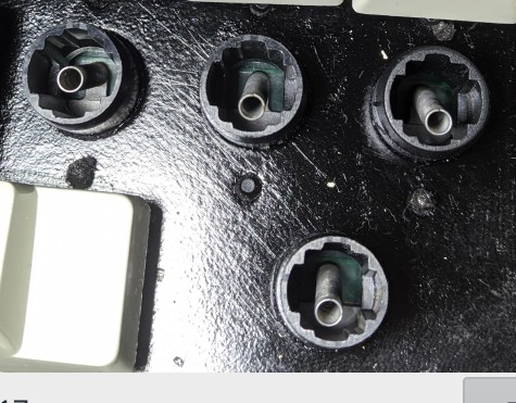

Hello everyone, I have a small issue with my IBM Model F XT that I restored not long ago.
I did a full restoration, took it apart completely, removed all dust and rust, repainetd, new foam and put it back together again and it was perfectly fine, but then after a month or so this key started behaving abnormally. Key feels ok when pressed down but pretty bad when released. It registers ok and it doesn't get stuck but feels like the spring got hooked to the keycap or something. It sounds weird and is not as smooth as the other keys are. I tried swapping keycaps and works ok, both of them, so it seems like the issue is that switch with that keycap, but of course I want to keep the correct layout. Any suggestion? I know I could open it up and swap the switch but... That's gonna cost, so I would prefer something easier if possible. If not, I'll disassemble it again.
Thanks in advance!
Thanks in advance!

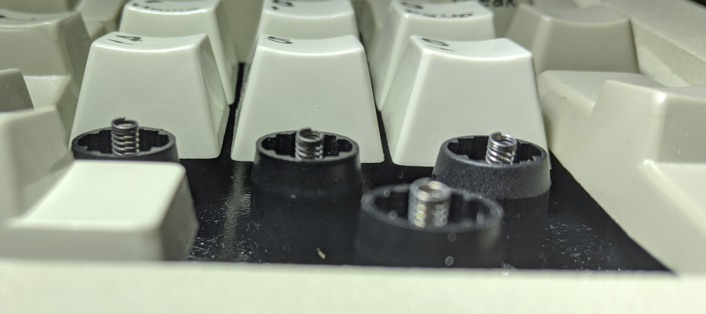

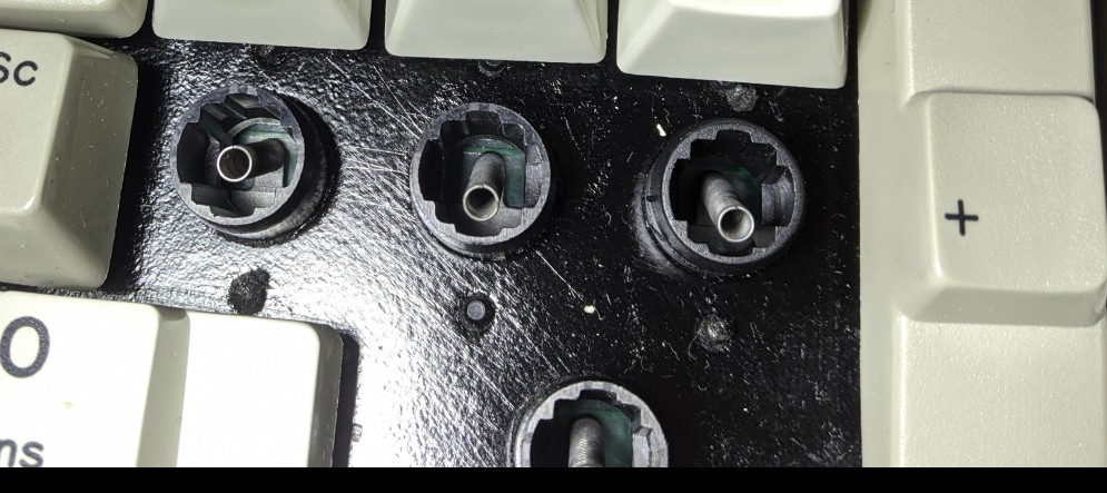

Here the photos in high resolution of the switch.
The faulty one is the corresponding to the 2 on the numpad, that is, the one in the middle of the top three.

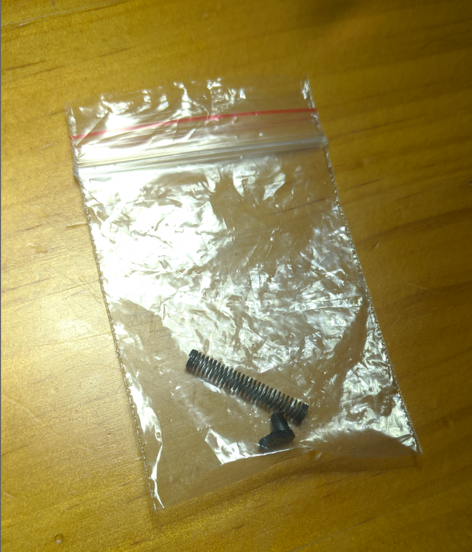

Ok, I tried to push the spring and the switch broke in 2 parts. I think this has been my fault. This stinks. Found a local seller that sells switches from a model F, I'll get one an... that's it. I just want to forget this happened. Stupid switch
24 euros is this going to cost me.

Ouch!
Any idea what happened there? Might the flipper have been fractured before or was the flipper stuck in some way that you broke it when you pressed rather hard?
I've never seen a flipper break like that...

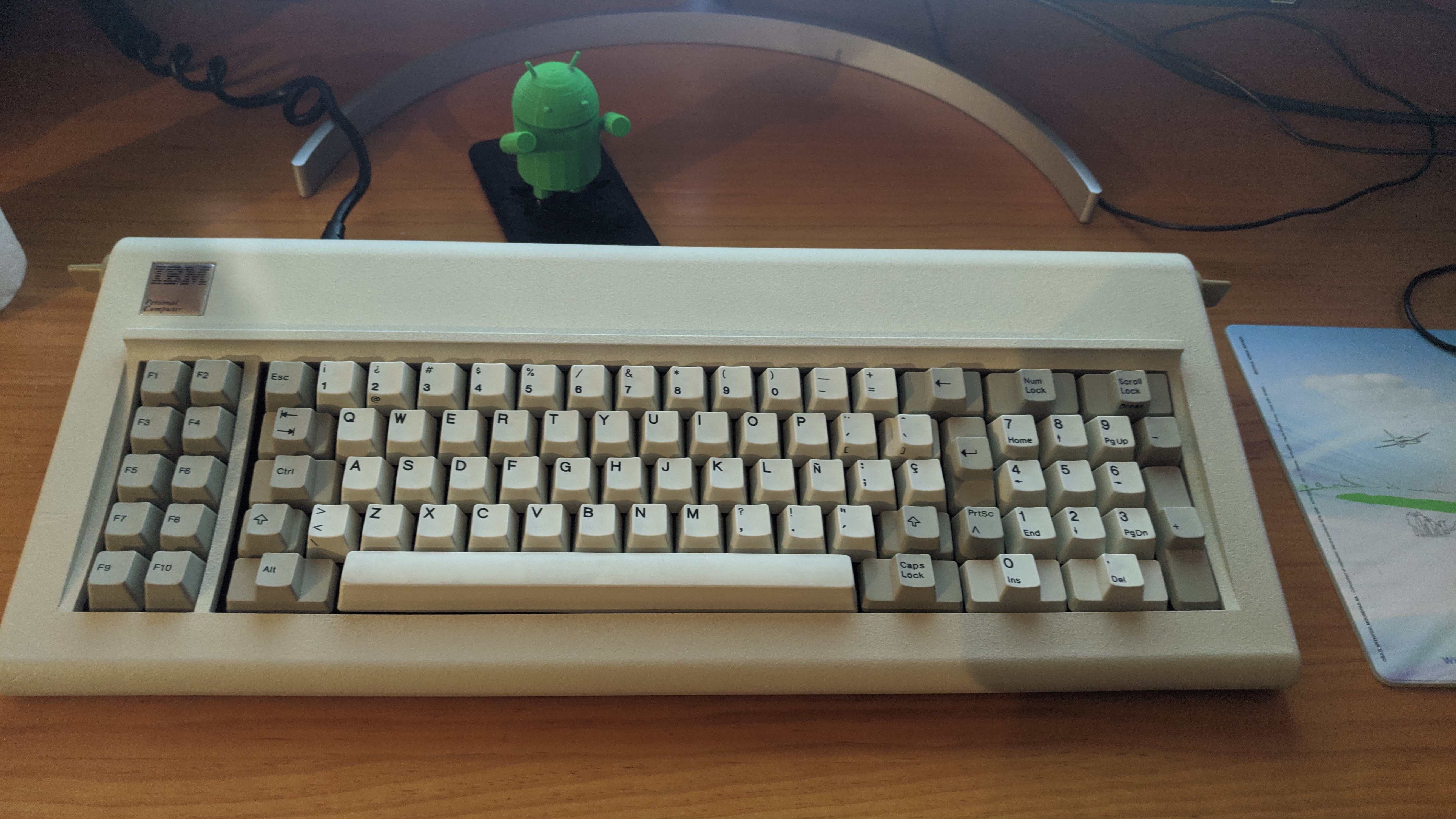

Today finally I got a moment of pace and excitement to change my broken flipper on the Model F. It's working beautifully now, all keys feel and sound as they should, just awesome. Thanks for the help again Mr, SneakyRobb for sending those spare switches for the F and the other "fun" switches you included. Many many thanks.
I can't leve this without mentioning that once I had mounted the keyboard and tested everything, when I came back to do some work on the computer, the spacebar decided stop functioning. How anoying can it get to open it up again? Thankfully it wasn't needed as just adding some preassure on the back panel and forcing the metal clamps a bit did the trick. Anyway, its all nice and working like a charm now! Thanks you all for the help and again to Robb for everything!
