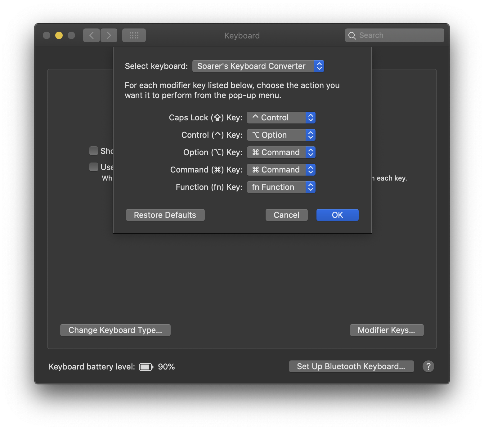

It doesn't make sense since the iMac is seeing the keyboard. If I go into System Preferences and try to change the modifier keys, the keyboard shows up.

If you select "change keyboard type" does it take you through the prompts to detect an unrecognized keyboard?

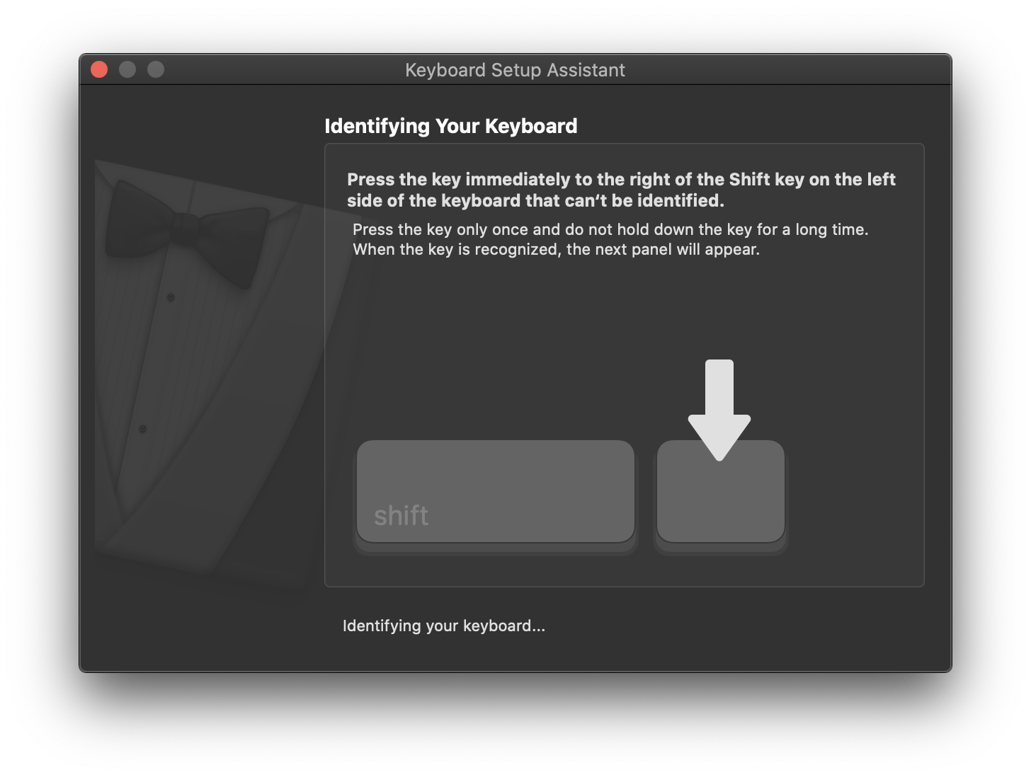

swampangel wrote: 12 Jan 2020, 21:24 If you select "change keyboard type" does it take you through the prompts to detect an unrecognized keyboard?
I try to do that but it does not move onto the next screen after hitting the key.

Does it work when you plug a different keyboard into the Soarer's and then connect it to the mac? Does it even recognise the Soarer's as a new device at all?

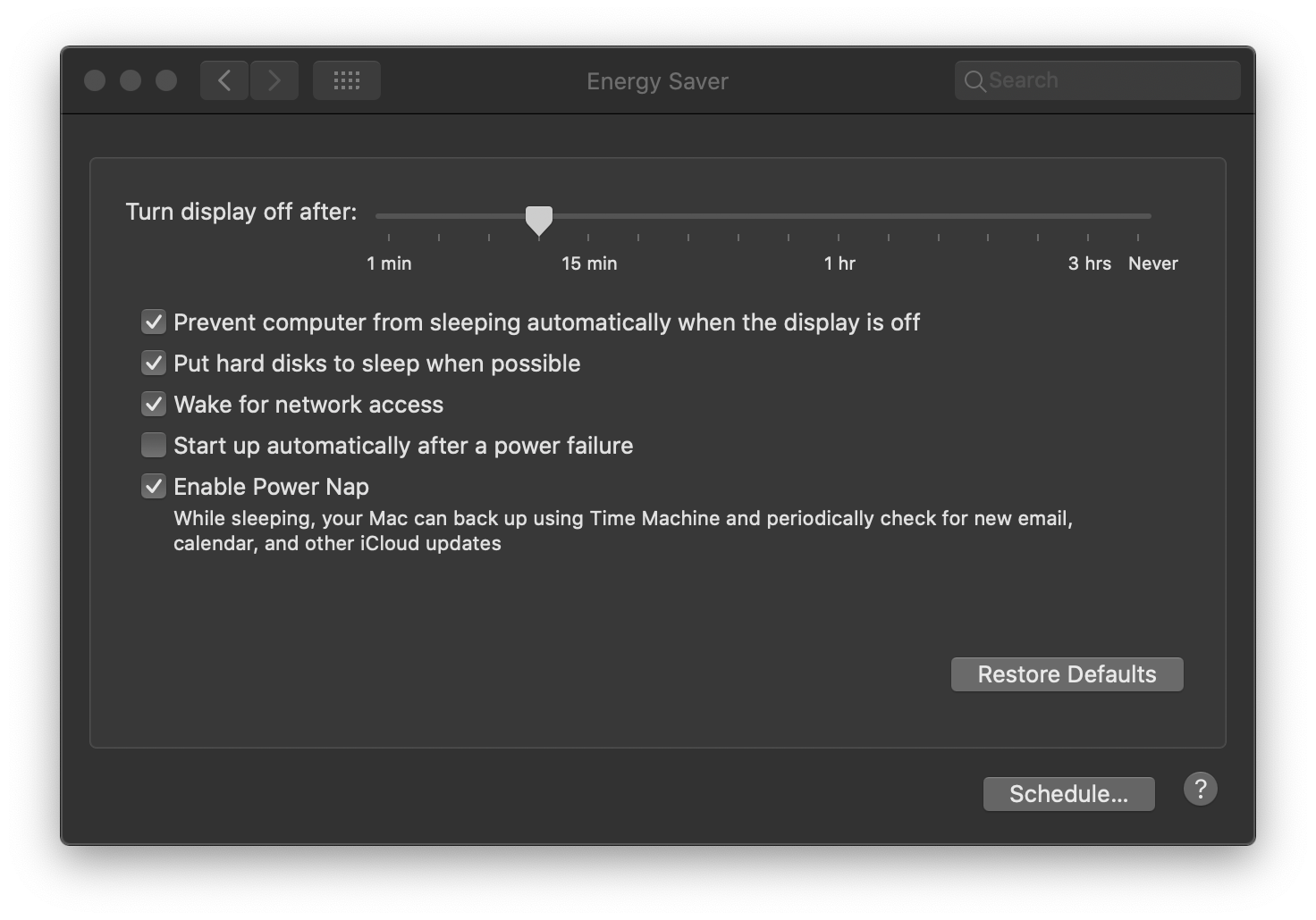

What should I check for in Energy Saver?

Well, after reading your posts again, sleep isn’t the issue. MacOS doesn’t have a setting for preventing the USB ports from sleeping like Windows does. Here are a few more things to try:

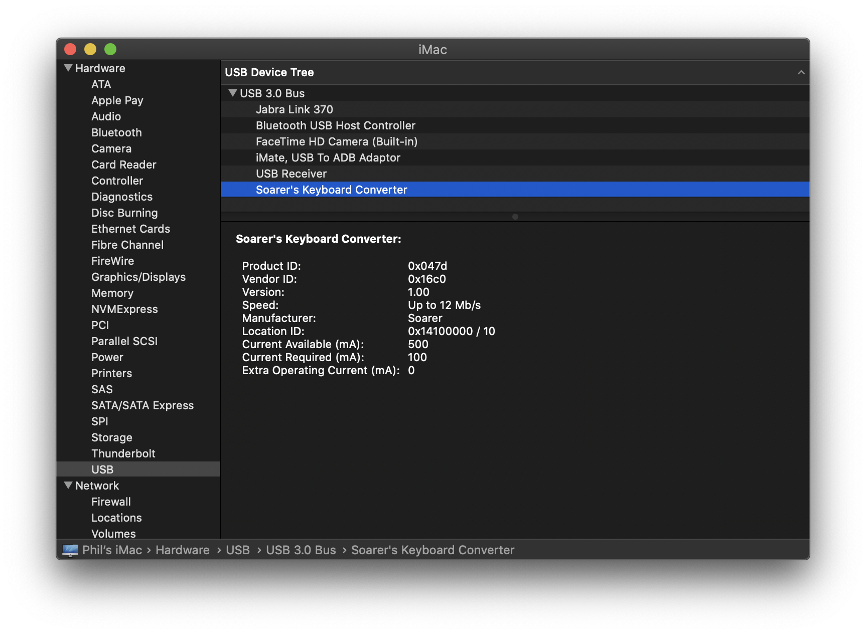

The keyboard does show up in System Report (this is when I plugged it directly into my iMac):
Screen Shot 2020-01-14 at 8.15.17 PM.png (687.29 KiB) Viewed 9432 times
I plugged the keyboard into a USB 2.0 hub and it still didn't work.
