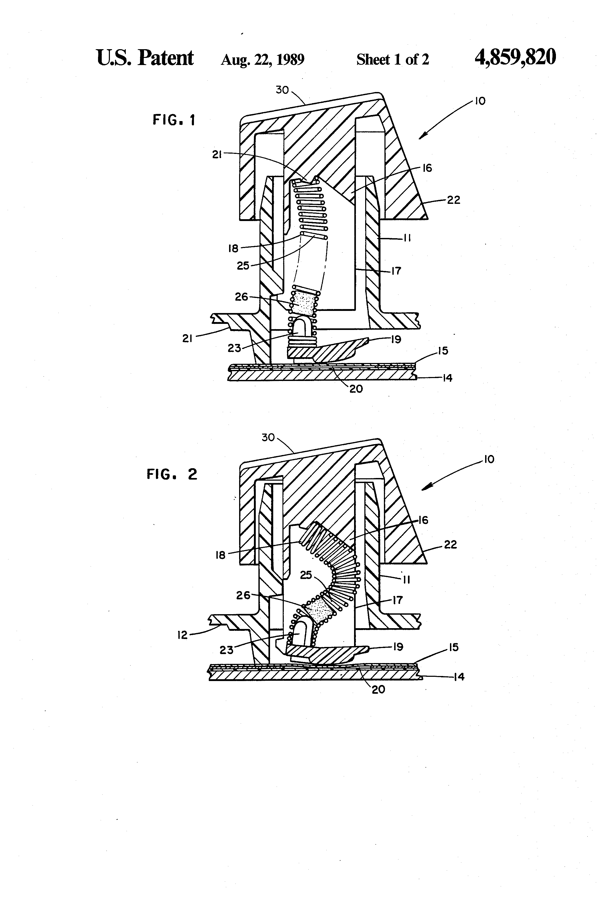

So I remember reading some posts that mentioned a patent AT&T had about some kind of rubber silencer for buckling spring switches. More information here wiki/Buckling_spring#AT.26T. I've also seen this old post in Geekhack https://geekhack.org/index.php?topic=7405.0 but It seems no one tried to elaborate the idea further (please, correct me if I'm wrong). So I thought it would be nice to experiment and share some results here.

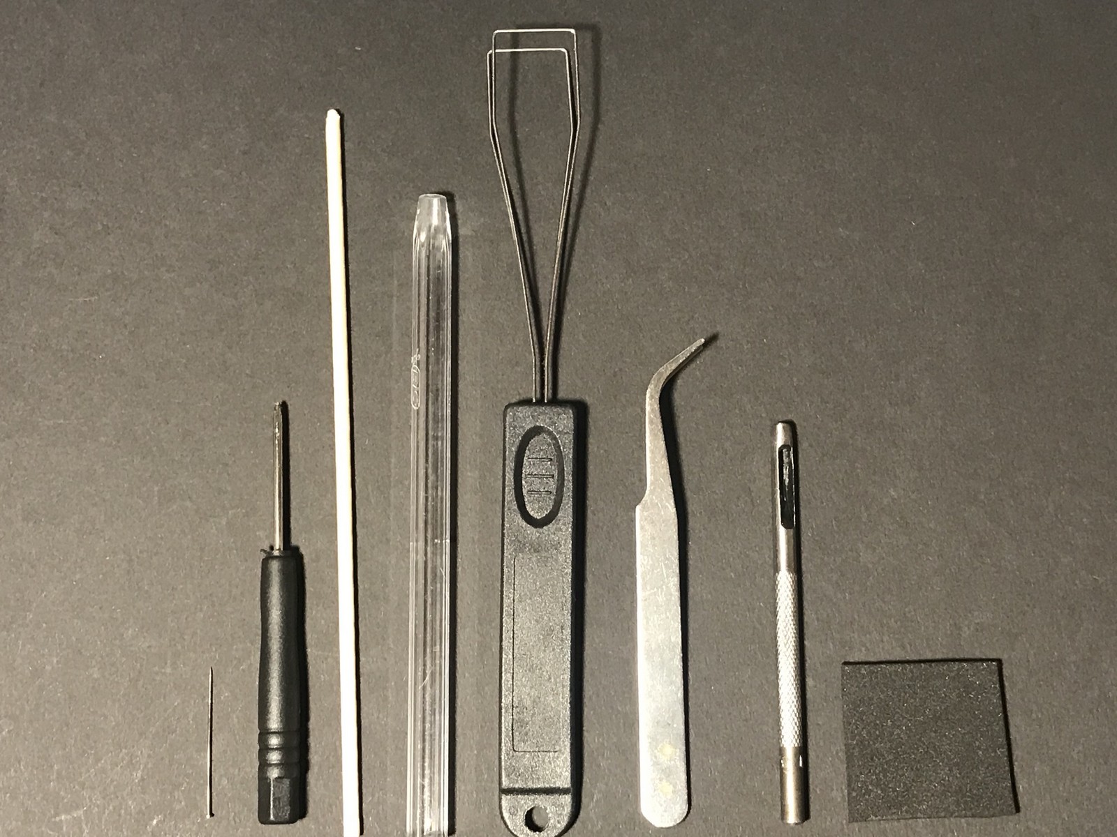

To test this mod you need the following tools:
  • 3mm thick foam. I used EVA foam but I think anything with the right thickness will do the job.
  • 3mm diameter leather punch
  • Keycap puller
  • Tweezers
  • Needle
  • Some tools needed in case you can to remove and reattach springs, like chopsticks and ballpoint pen assembly
For convenience I'll show this using a Model F switch tester by orihalcon, but will work the same for a real keyboard.

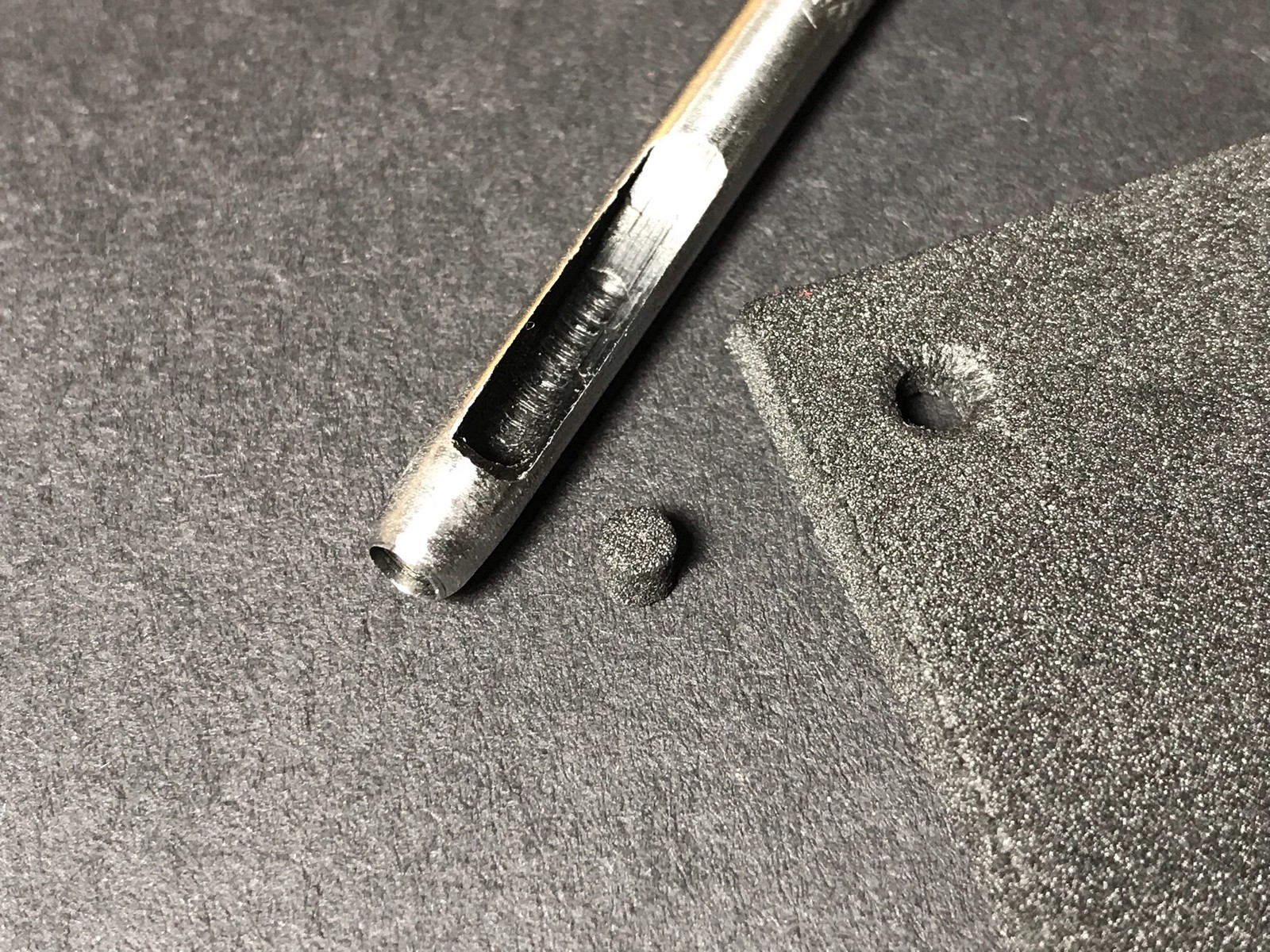

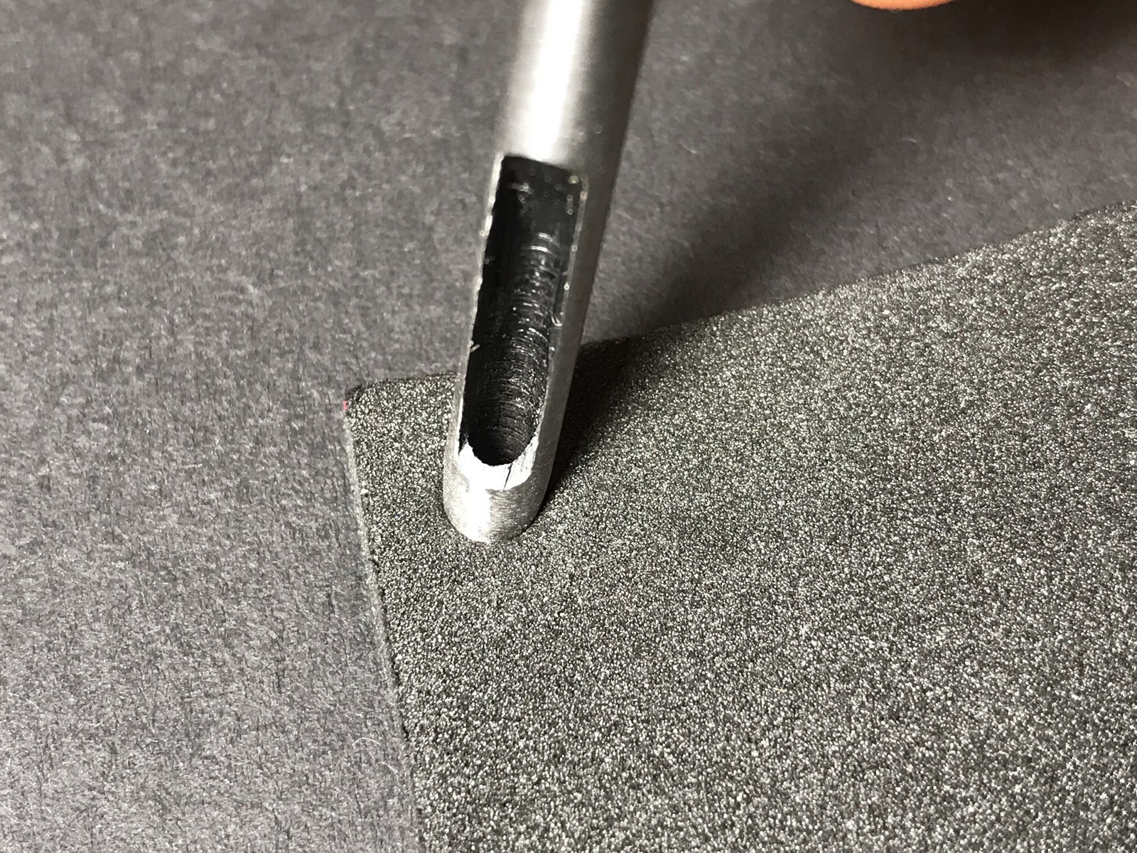

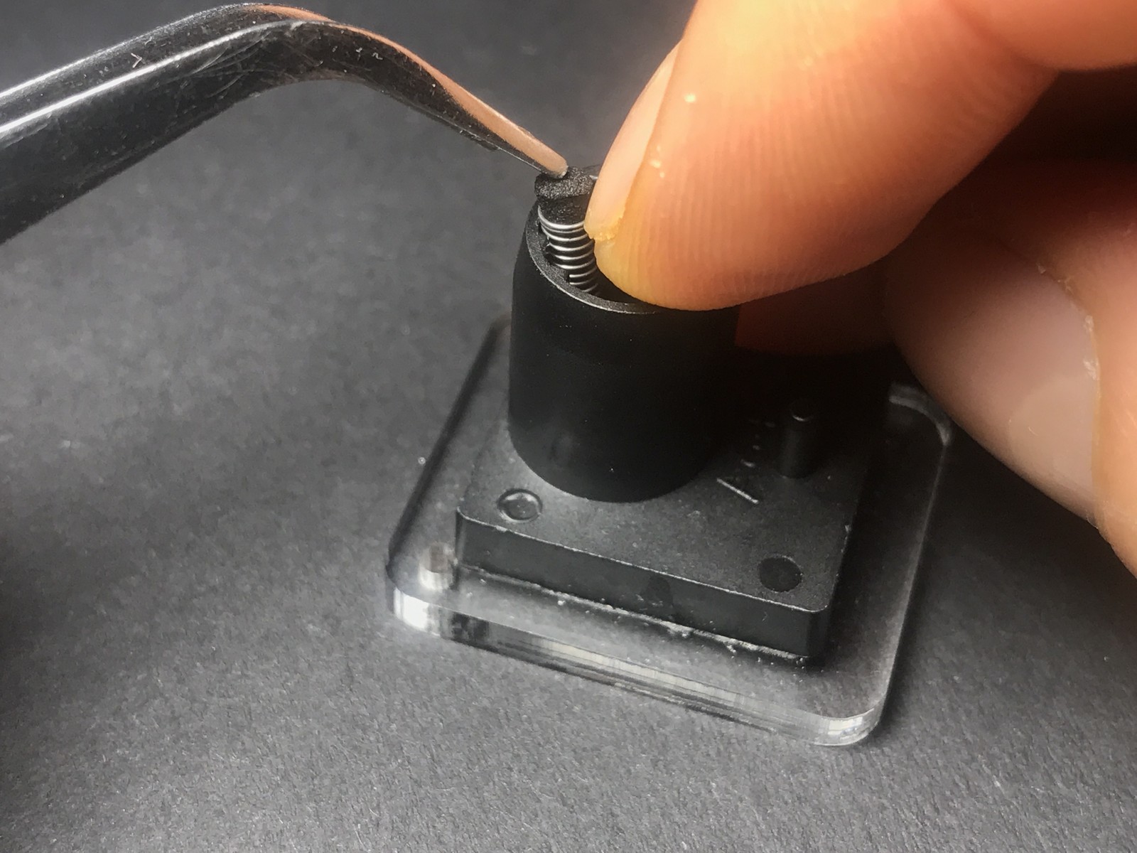

First, punch some foam plugs with the leather punch

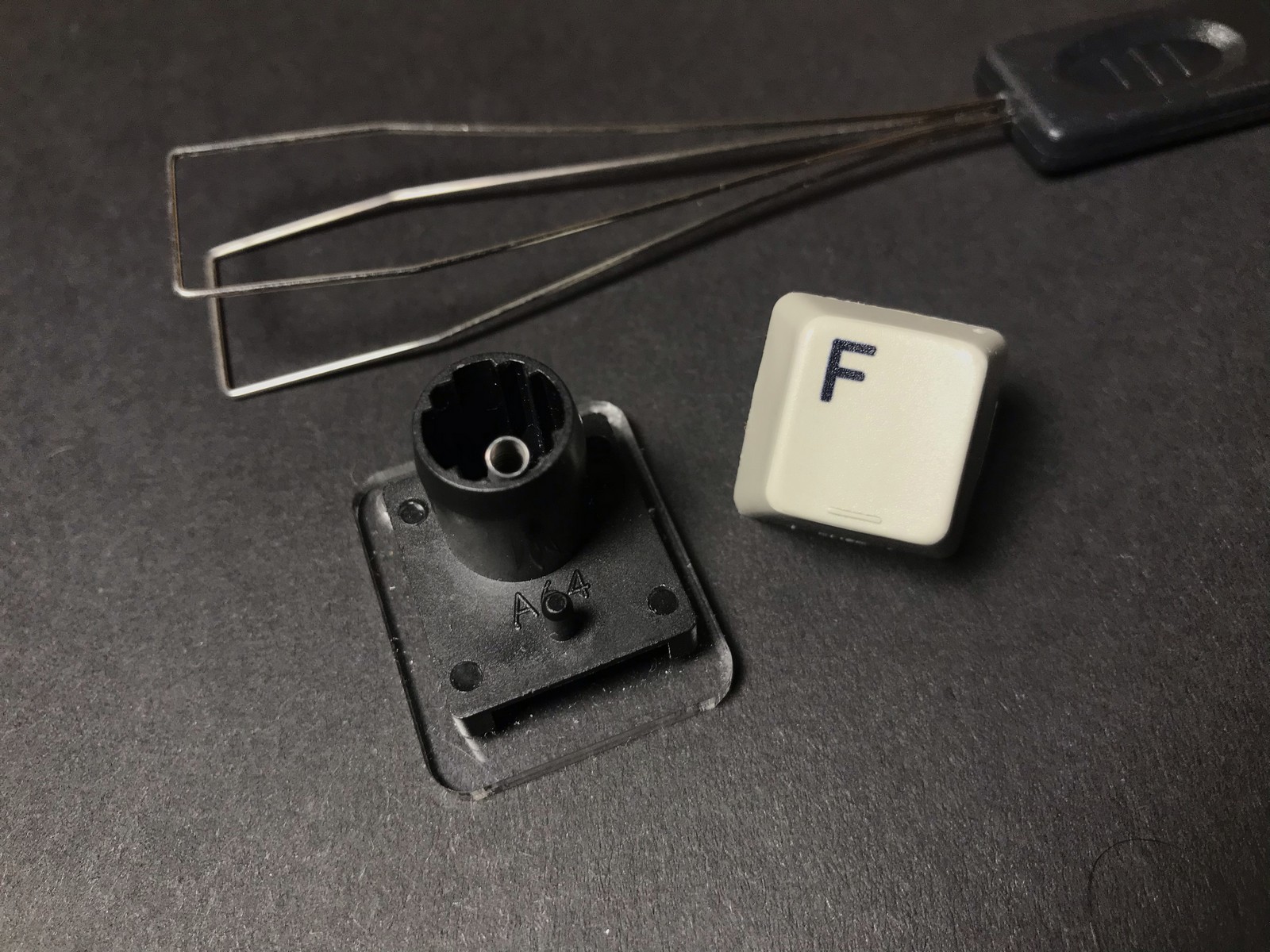

Remove the key

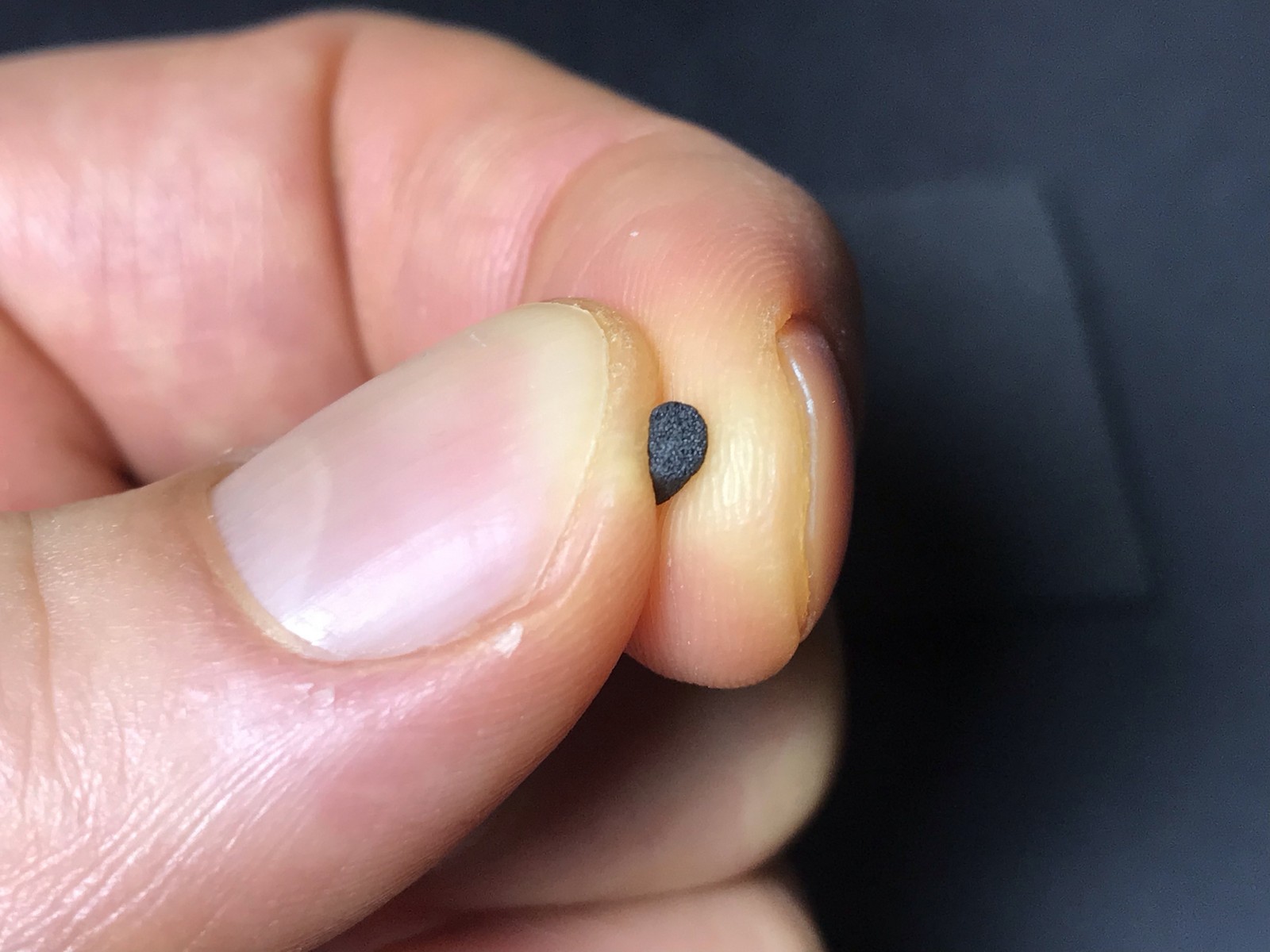

Compress slightly the foam plug rolling it between your fingers

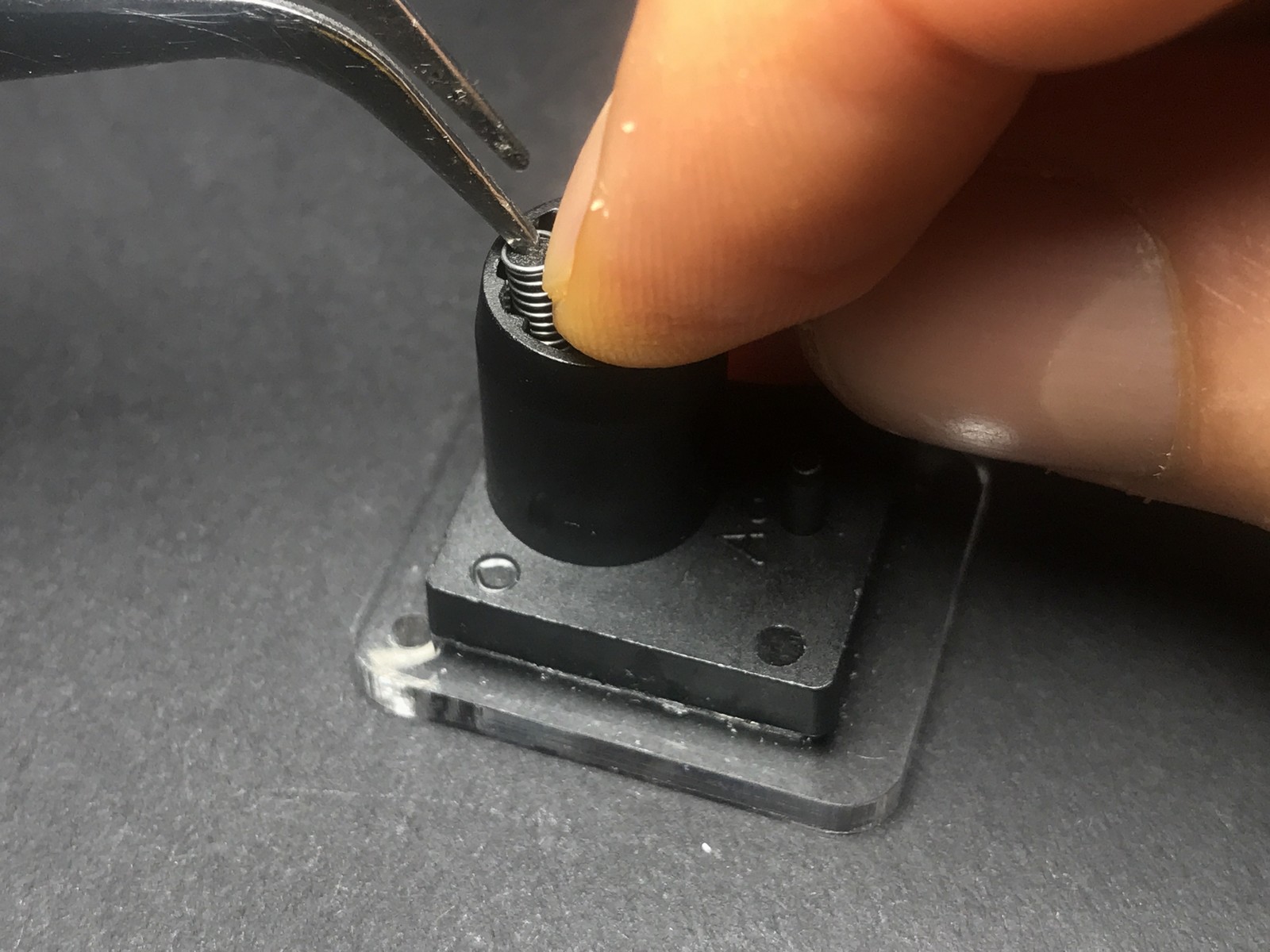

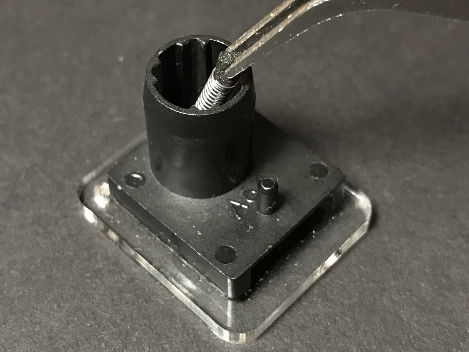

Then take the plug with the tweezers to insert it into the spring. Just insert, don't push it yet.
Change the tweezers to your left hand and using the right hand hold the spring with your index finger nail like this.

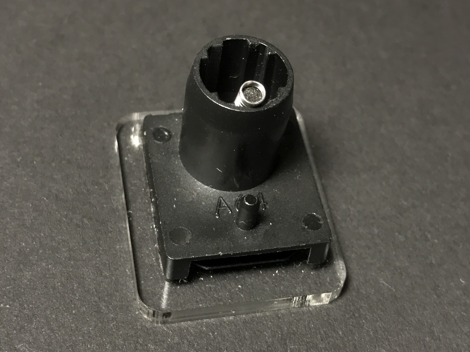

Now while still holding the spring push VERY CAREFULLY the plug into the spring, so that you leave its top approx. 1mm inside the spring. This is the most delicate part, if it's not deep enough it will affect the key action over the spring. If you press too much it will interfere with the buckling action, and this is worse because if it's too deep it is impossible to remove the plug without removing the spring. If it's not so deep you can remove the plug easily pulling it off with a needle.
So this mod is only recommended if you are comfortable removing and reattaching springs, because it's the only way to remove a plug inserted too deep. In case you need, search for the "Sandy's chopstick o' death method". Of course a floss mod is more convenient in the sense that it is easier to remove, but I think the foam plug is more durable and gives a more uniform keyfeel.

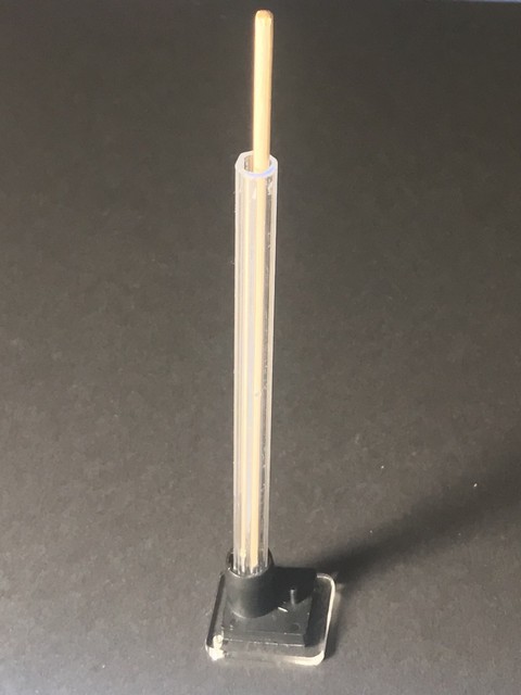

Example reattaching the spring inside the tester

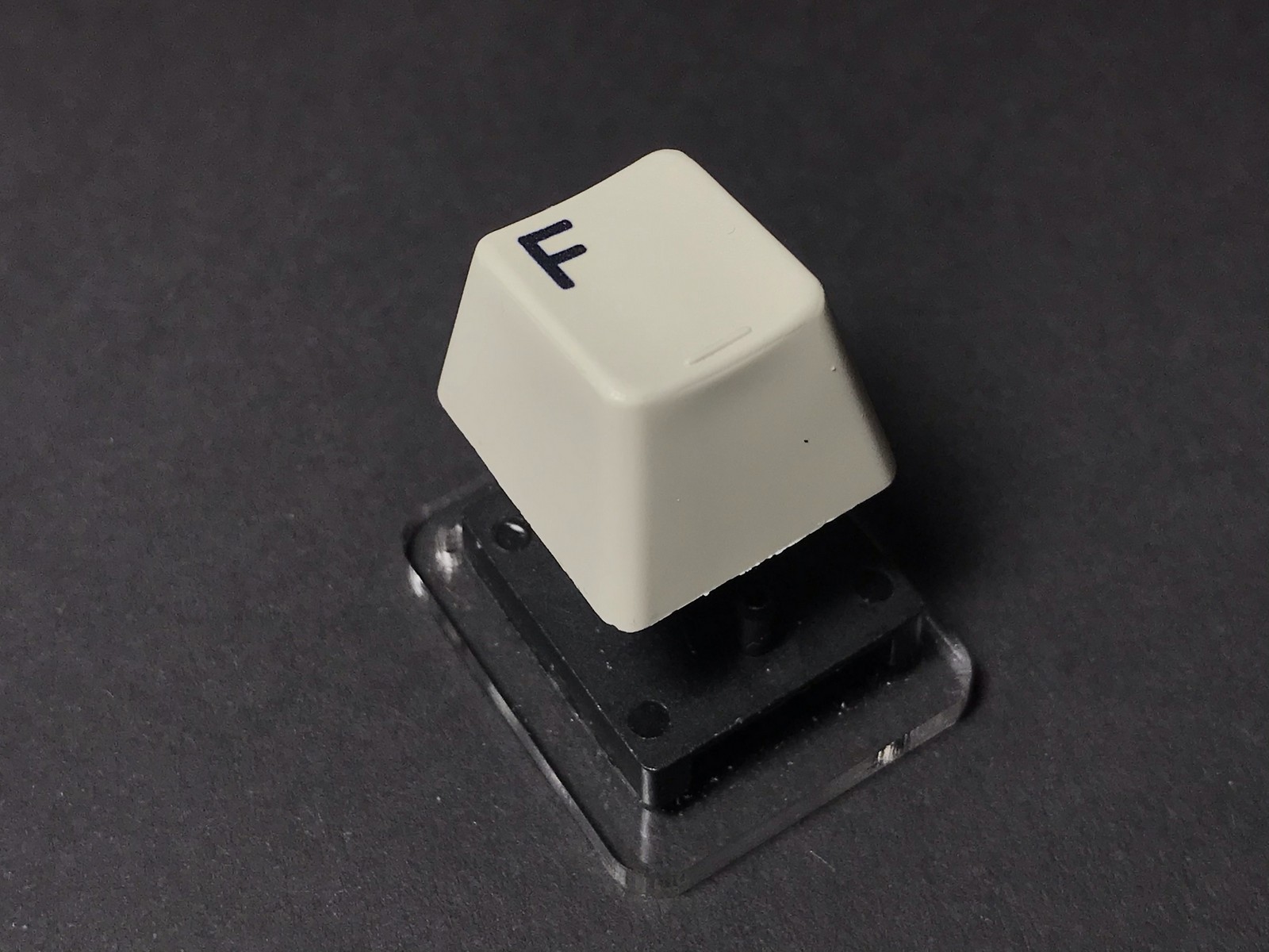

And that's it, just install your key again and test that it still works fine.

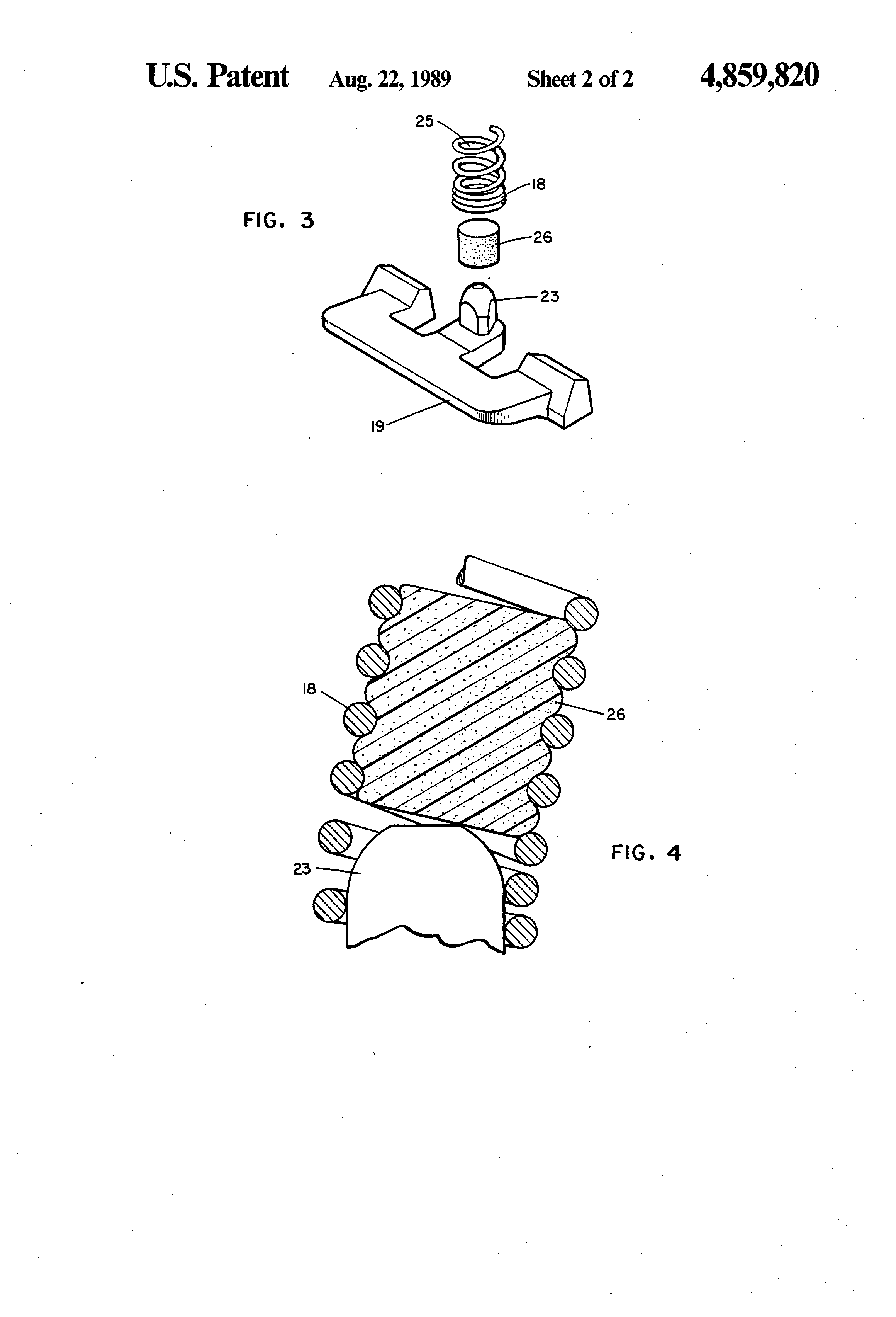

This is an interesting and novel approach. I wonder if you have tried this with the foam plug at the bottom of the spring? I say this because the patent has the plug located there.
If I recall correctly, a lot of the ringing/buzz noise is from the spring bottom sort of vibrating around the post of the flipper. As well now that I think about it, the top would vibrate as well.
I wonder if you could test it with a small plug at both the top and the bottom?
Regardless, good work and very clever!
https://patents.google.com/patent/US4859820
No, I didn't try that... but that was because I made all the testing after the keyboard was fully assembled and the last thing I wanted to do was disassemble and reassemble it again. The first time I tried it was a total failure and I ruined the barrel plate paint job. Then I had to wait for two weeks to get a new paint job done and this time let it dry properly...

inmbolmie wrote: 04 Feb 2020, 16:59
SneakyRobb wrote: 04 Feb 2020, 16:16
I will try tonight your proposals with the switch tester and compare the results.
I've tried using the switch tester the effect of "foam on bottom" and "foam on both sides".

  • Foam on bottom is like halfway between no foam and foam on top: The ping is still there but with less reverberation, definitely less metallic. But I have to say that it's difficult to notice the difference in the audio sample. Tactility is good
  • Foam on both sides feels and sounds for me exactly like foam on top
I still prefer foam on top, but it can be a matter of personal preference

Hey thats alright. It was designed for the AT&T keyboard, as well as a smaller model M style flipper after all. So it makes sense that it could sound different for the model F. Regardless I will try this when I rebuild my F AT eventually.
