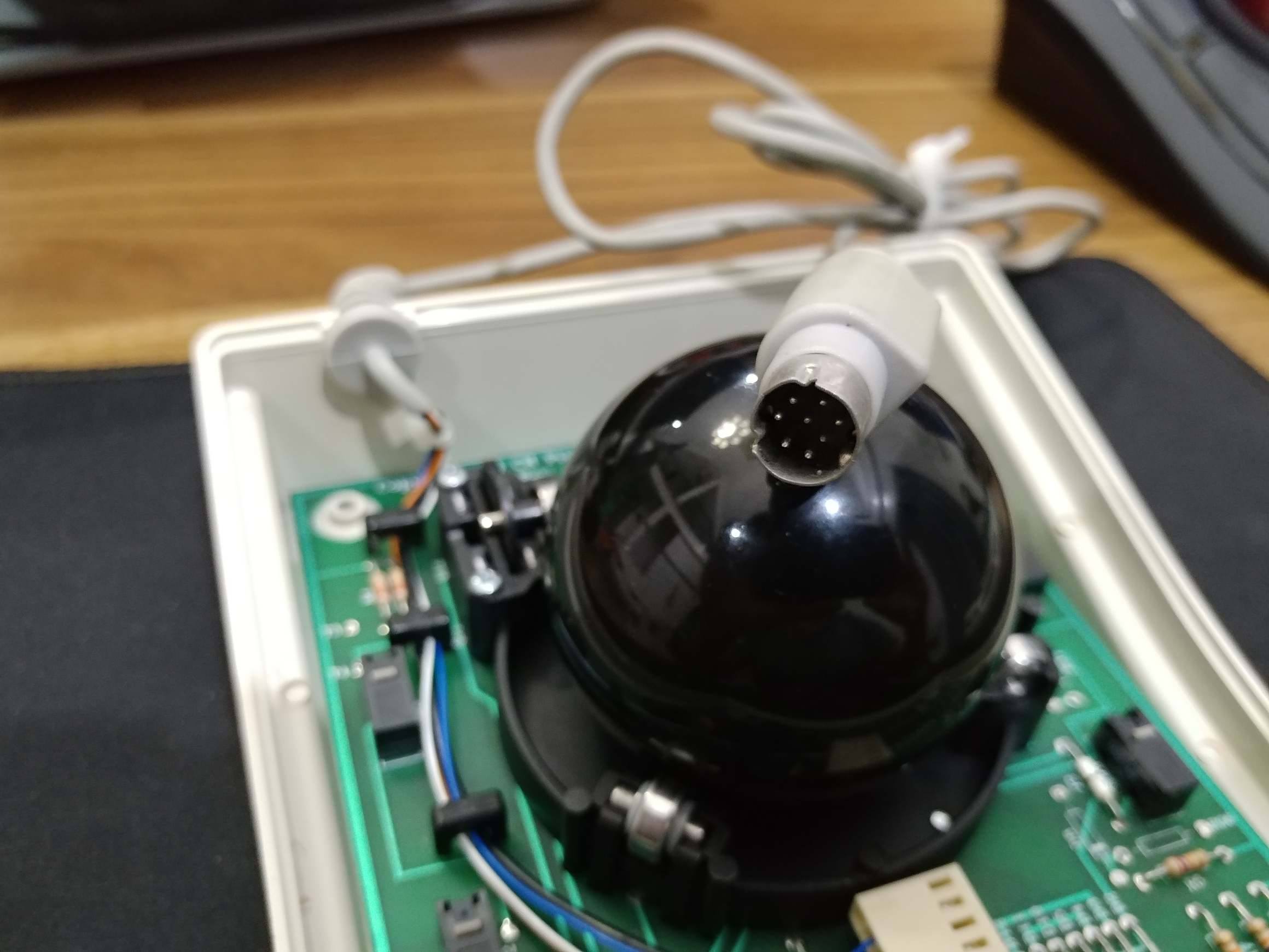

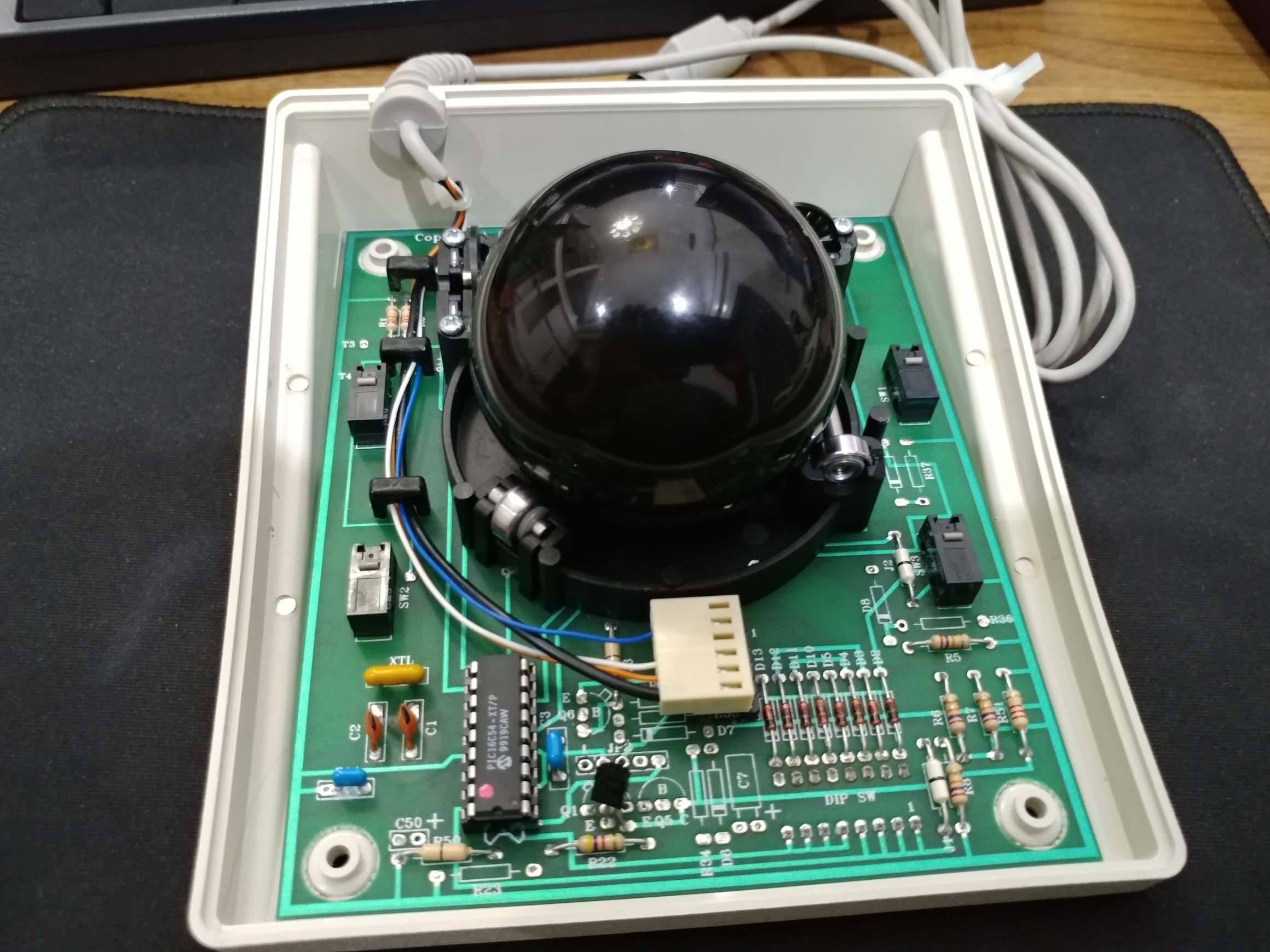

Got today another DT225 variant. At first I thought it's a PS2 as the outer shell of the socket has the same cutout, only to realize it has different pins. I searched everywhere and I can't find the same variant of this DT225. Does anyone information on this variant? The only thing I know that the socket is mini din 8-pin but I'm not sure what protocol it handles. Also the socket is connected to the board thru 4wires.
05 Mar 2020, 15:57
Maybe it is for Sun Keyboard/mouse. Like Apple keyboards, Sun keyboards had a port for a mouse, but unlike Apple's ADB which used an addressable protocol, keyboard and mouse signals used different pins.
If you have a multimeter, you could check continuity to see if Sun's pin assignment for mouse matches the four wires that go to the PCB.
The thickest lines on the PCB are probably Ground, and each switch is probably activated by shorting it to Ground. On a switch's other side there may be a pull-up resistor to +5V. The other two wires should be Mouse In and Mouse Out.

Findecanor wrote: 05 Mar 2020, 15:57 Maybe it is for Sun Keyboard/mouse. Like Apple keyboards, Sun keyboards had a port for a mouse, but unlike Apple's ADB which used an addressable protocol, keyboard and mouse signals used different pins.
(There is a Interface recognition guide in the Wiki ... but it lacks a link from the front page. :oops: )
Thanks, I'll check out the wiki. Never knew there was that resource here, been searching for hours for any 8pin mini din interface.
Initial checking on Sun's pin assignment turns negative as the orange wire is connected to #2 on Sun' pin assignment which is ground on their specs.

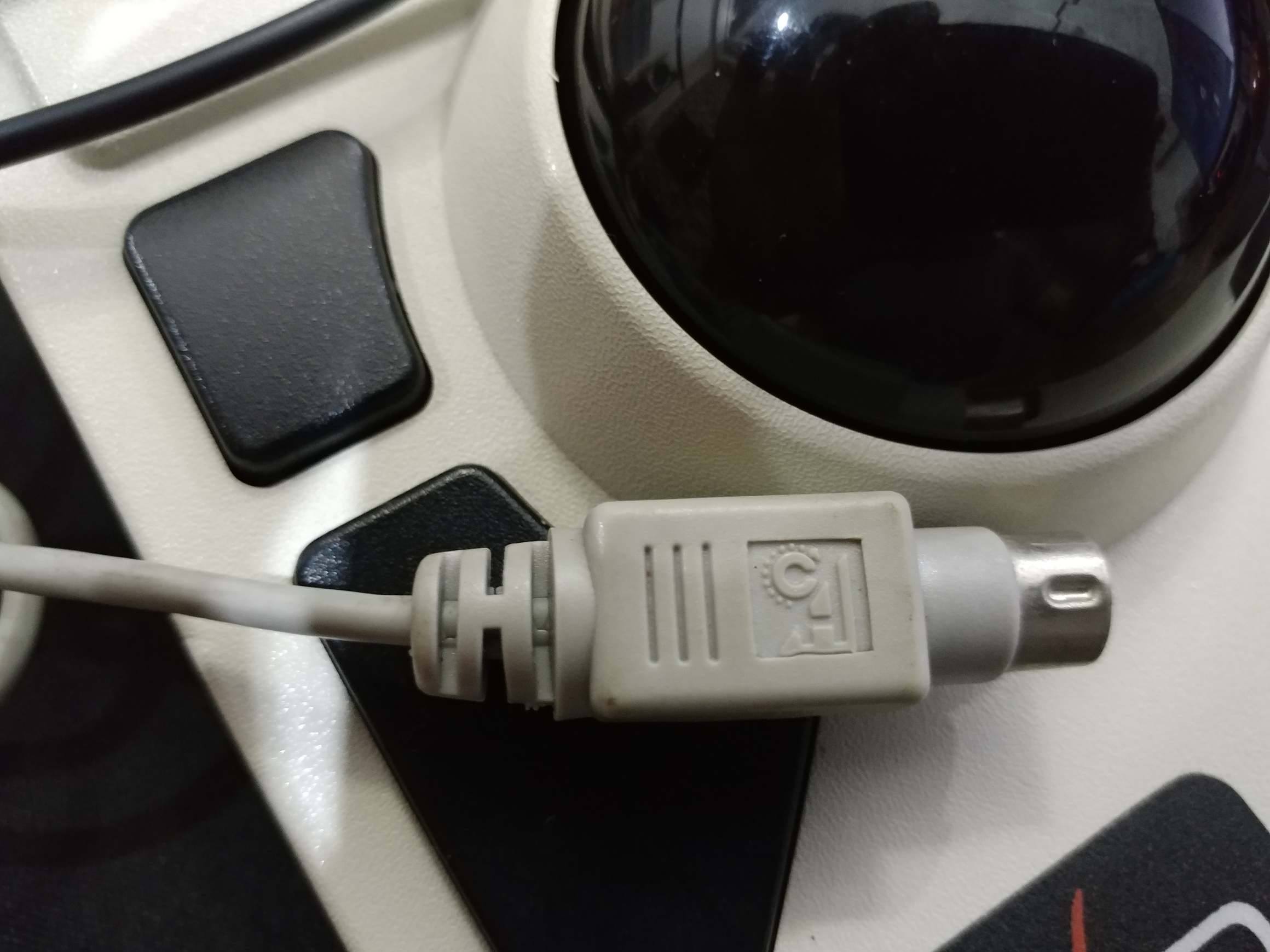

BTW, does the connector have text or a symbol embossed in the flat on the side?

Findecanor wrote: 05 Mar 2020, 16:53 BTW, does the connector have text or a symbol embossed in the flat on the side?
Yeah, though I'm not familiar with the symbol. Kindly see below.
Checked the wiki and I think it does not match any of them. I was thinking of NeXT bus mouse but there are many pins for it to be a matched.

jorgenslee wrote: 05 Mar 2020, 17:08Yeah, though I'm not familiar with the symbol. Kindly see below.
It's just manufacturer's logo: stylized "CH" letters.

jorgenslee wrote: 05 Mar 2020, 17:08Since there are only four wires, do you think it's just ps2 protocol?
I've never seen PS/2 or ADB devices with non-standard connectors. AFAIK MiniDIN-4 and MiniDIN-6 were integral part of these standards.
As for yours, it looks to me like CD-i pointing device connector (kind of serial):

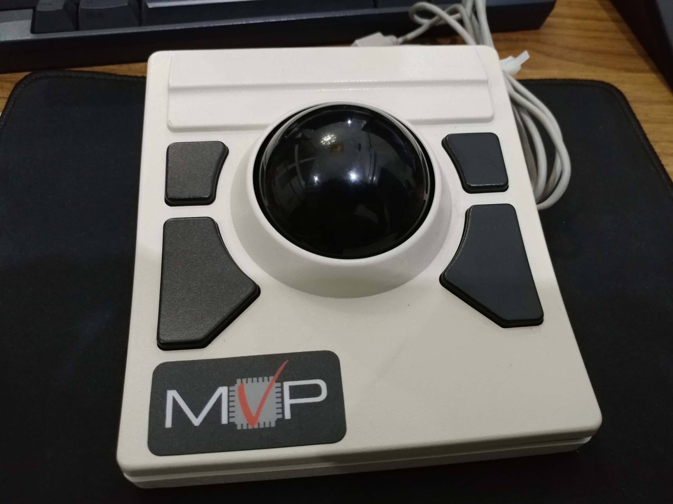

By the way, what does "MVP" mean? On your trackball it seems like abbreviation of company name: do you have any information about it? The reason I'm asking is, I have "Curtis MVP Mouse" trackball - but never was able to find meaning of MVP letters...

Archie wrote: 06 Mar 2020, 18:53 By the way, what does "MVP" mean? On your trackball it seems like abbreviation of company name: do you have any information about it? The reason I'm asking is, I have "Curtis MVP Mouse" trackball - but never was able to find meaning of MVP letters...
https://forum.trackballs.eu/viewtopic.php?f=17&t=15
I also don't know that MVP means as I only bought it without a box on ebay.

I doubt you'll be able to find a converter: Sun always was a "niche market", and prior to your CH it was only ITAC known to me who made compatible trackballs...
I'm pretty sure your best bet is to replace the controller. Not a big deal BTW, and if you don't want to deal with Arduino and similar things - you can just buy old PS/2 ball mouse and cheap USB converter, to transplant the controller into your DT225.

Regular plain vanilla ball mouse. Dirt-cheap or free nowadays. It uses the same quadrature detectors and slotted shutter discs as your trackball: you'll just need to re-wire things.
P.S. Avoid Logitech mice, as many of them use proprietary detectors, not discrete quadrature ones.

Meanwhile, out of curiosity I've finally discovered who is that MVP your trackball was OEMed for:
