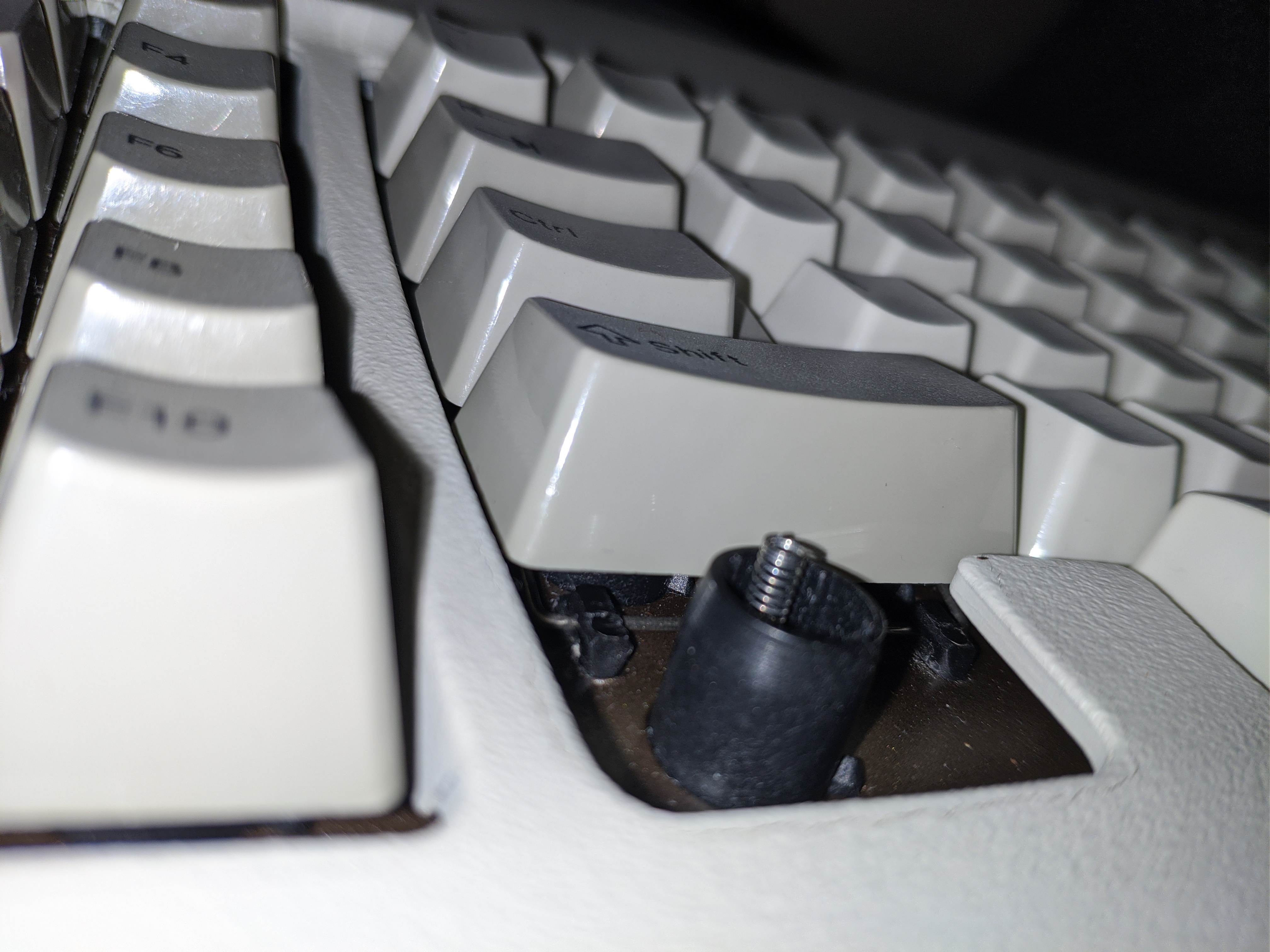

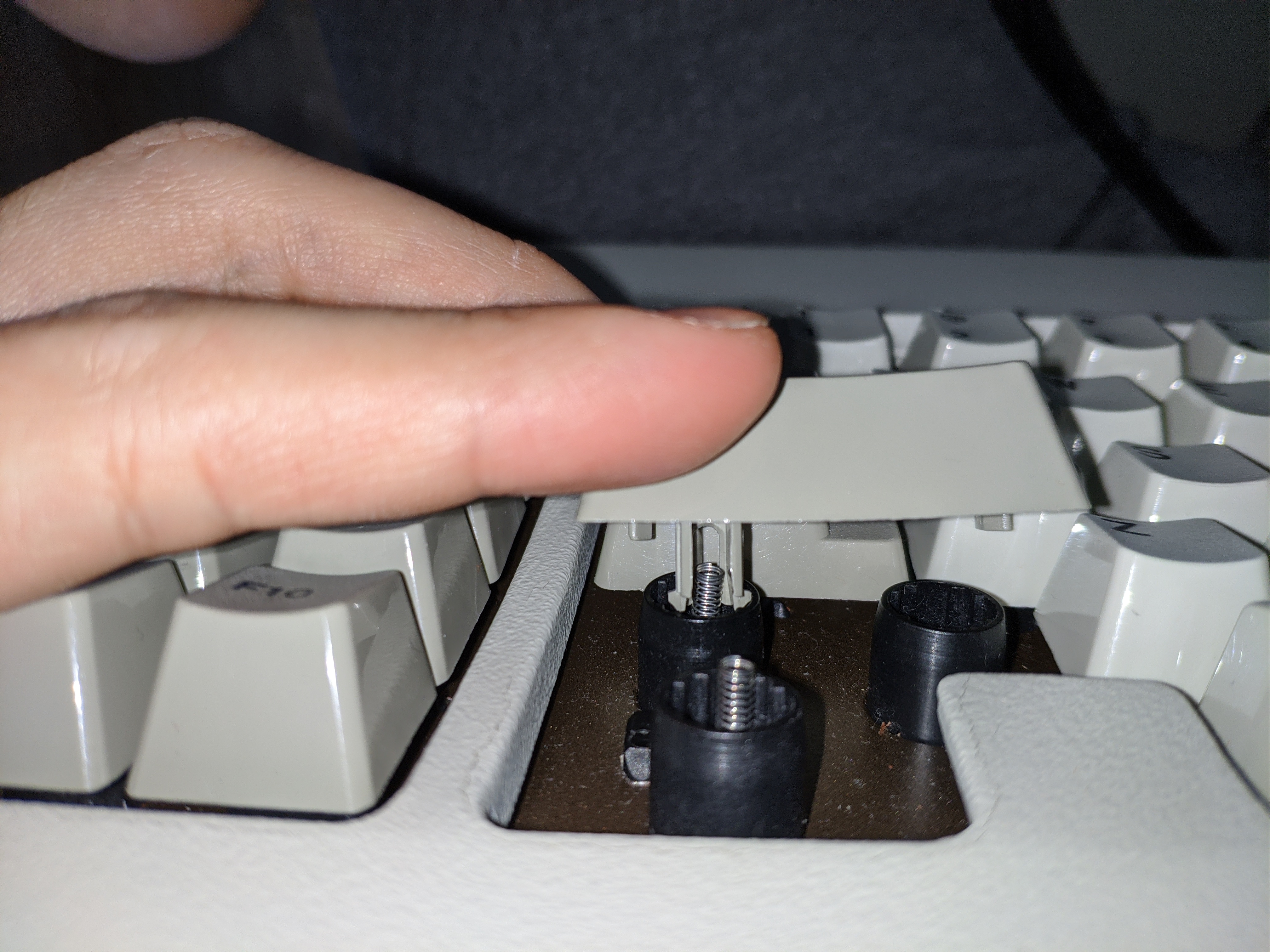

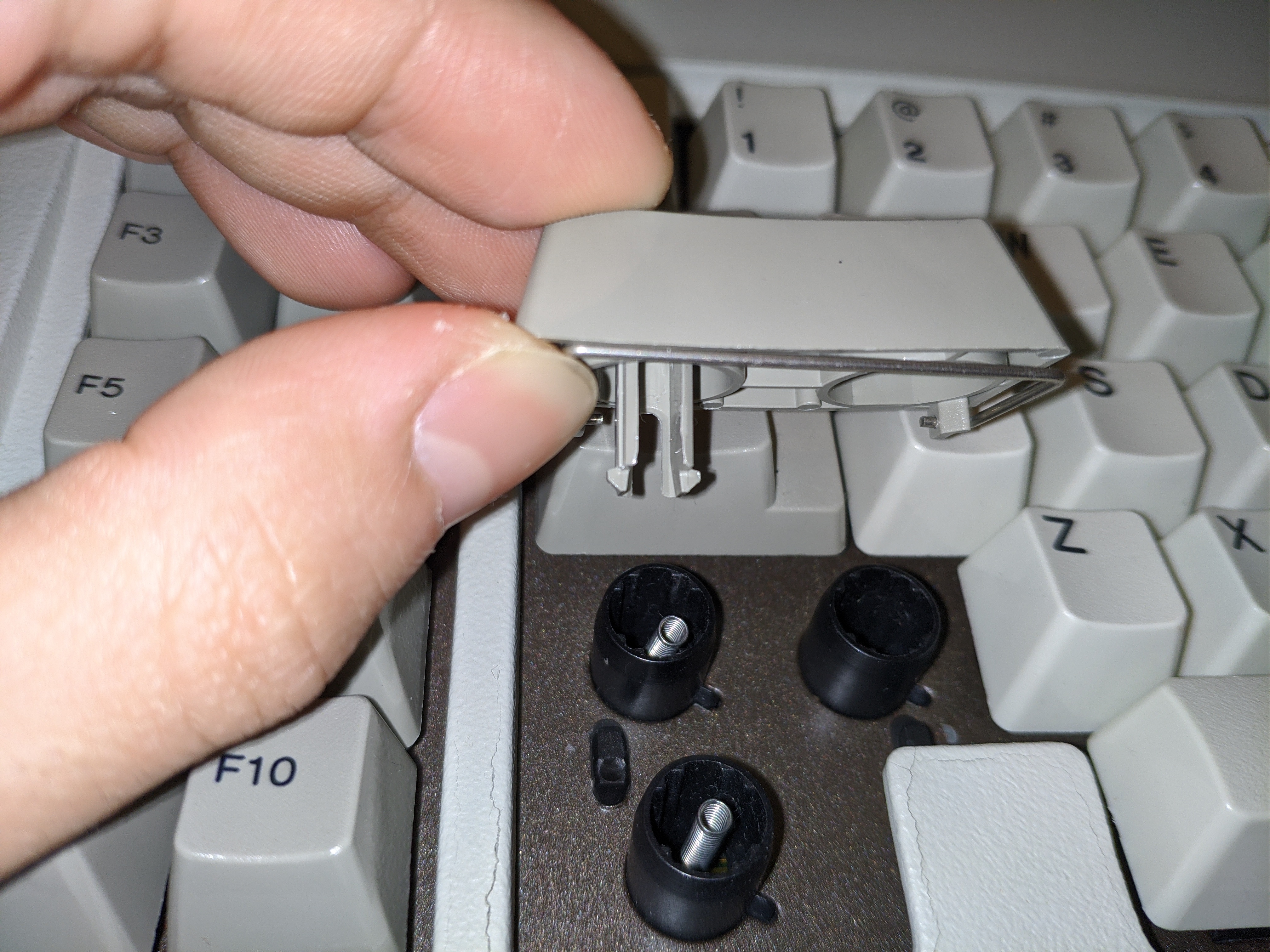

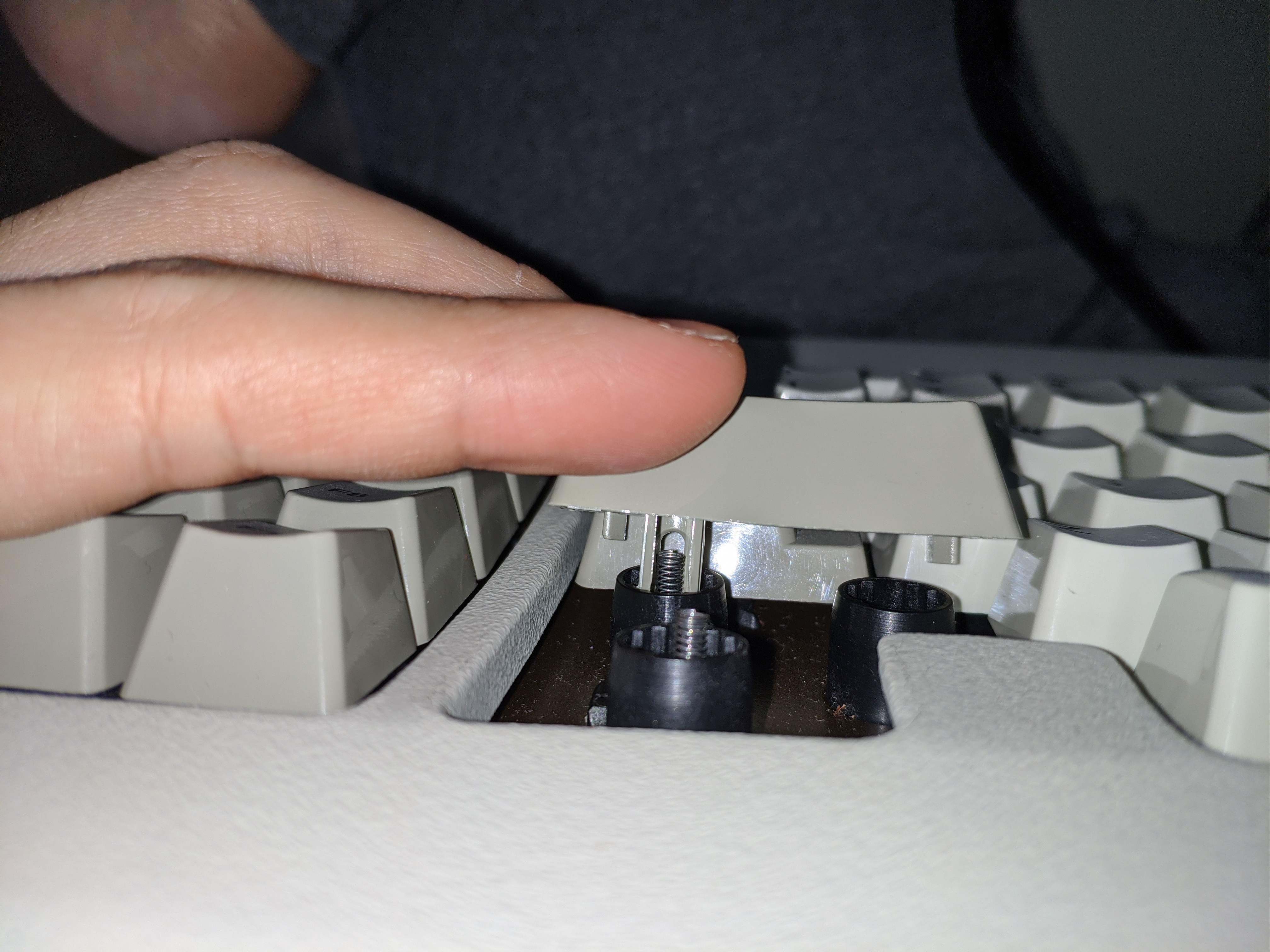

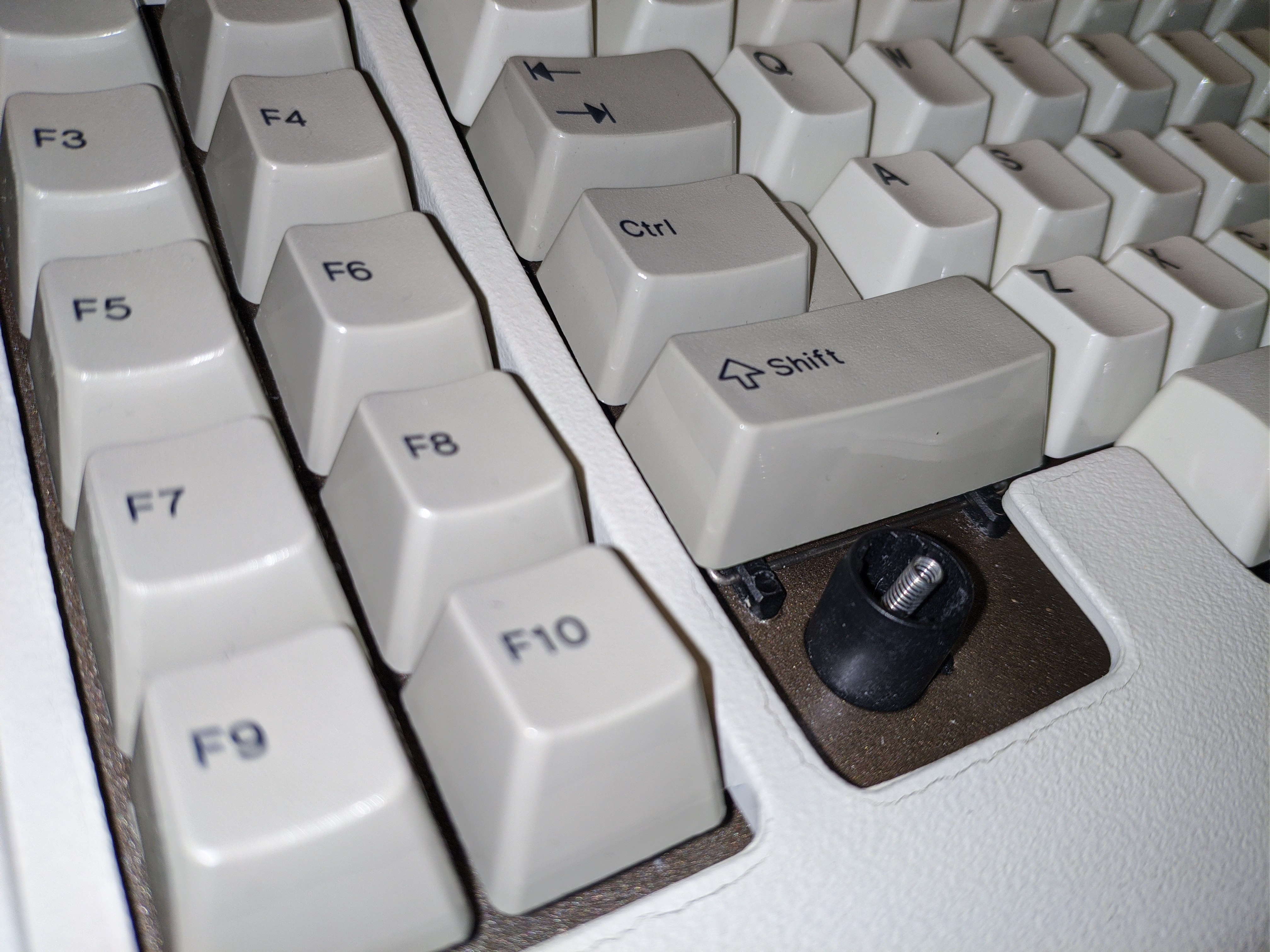

As for the left shift, it's still not clicking as it should be. I tried tipping the keyboard and reinserting, but the same results. Here are a few pictures of my left shift key:
First of all, when the shift key isn't pressed:
Left shift key when not pressed
I think the wires are in the appropriate clips. It might be easier to see when the shift key is pressed:
Left shift key when pressed

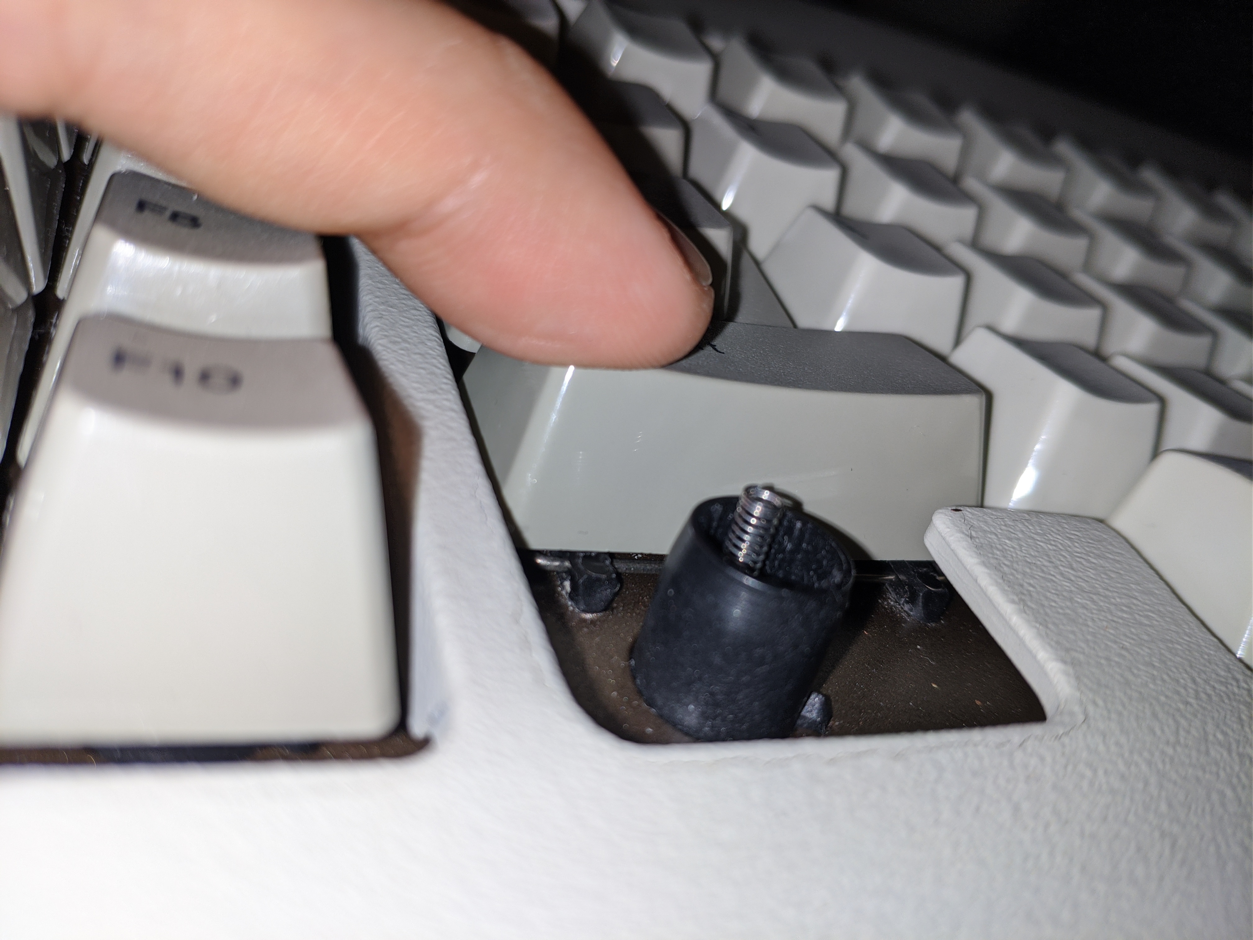

As for the spring/hammer location, I think this is the right barrel?
Spring location for left key
Finally, when I do this, it clicks/registers fine:
Putting 1U key (which works fine)
I know the pictures aren't the best quality, but they were my best attempt using a bad phone camera. Please let me know if I'm overlooking something very obvious :)
I'll try to get hold of a insert stabilizer left shift keycap from model M, but I guess until then I'll be using it with that 1U key inserted!
Weezer
19 Mar 2020, 07:46
Thanks for the pics :)
In the picture "lshift_spring.jpg" is the keyboard tilted backwards fully? It looks like the spring is still facing forward. If the spring moves freely in an identical way to the spring for caps lock, but isn't centered in the barrel when you tilt the keyboard back, use a toothpick to push the spring towards the back of the barrel as you're inserting the key. The idea is to get the spring to seat properly in the little notch on the bottom of the key cap which is what happened with the 0 key.
If that doesn't yield any results, the next easiest option that I can think of might be to take the keyboard apart and SWAP the spring from the a 1U key to the left shift as you have the stabilizer inserted correctly and the 1U keys and the left shift are the same height.

Agree, spring is in correct barrel, tilting keyboard back as far as possible while you put the cap on often is needed for certain keys. I’m talking very tilted back like perpendicular to the ground. You might also want to examine the inside of your shift keycaps as well. I’ve seen a few instances where the little nub that orients the spring is gone and in that case would be a problem with the cap itself and would just need to be replaced.

It's been a busy couple of days so I couldn't really mess with my keyboard, but I've tried tilting the keyboard upright and then put in the shift key. Unfortunately no luck :(

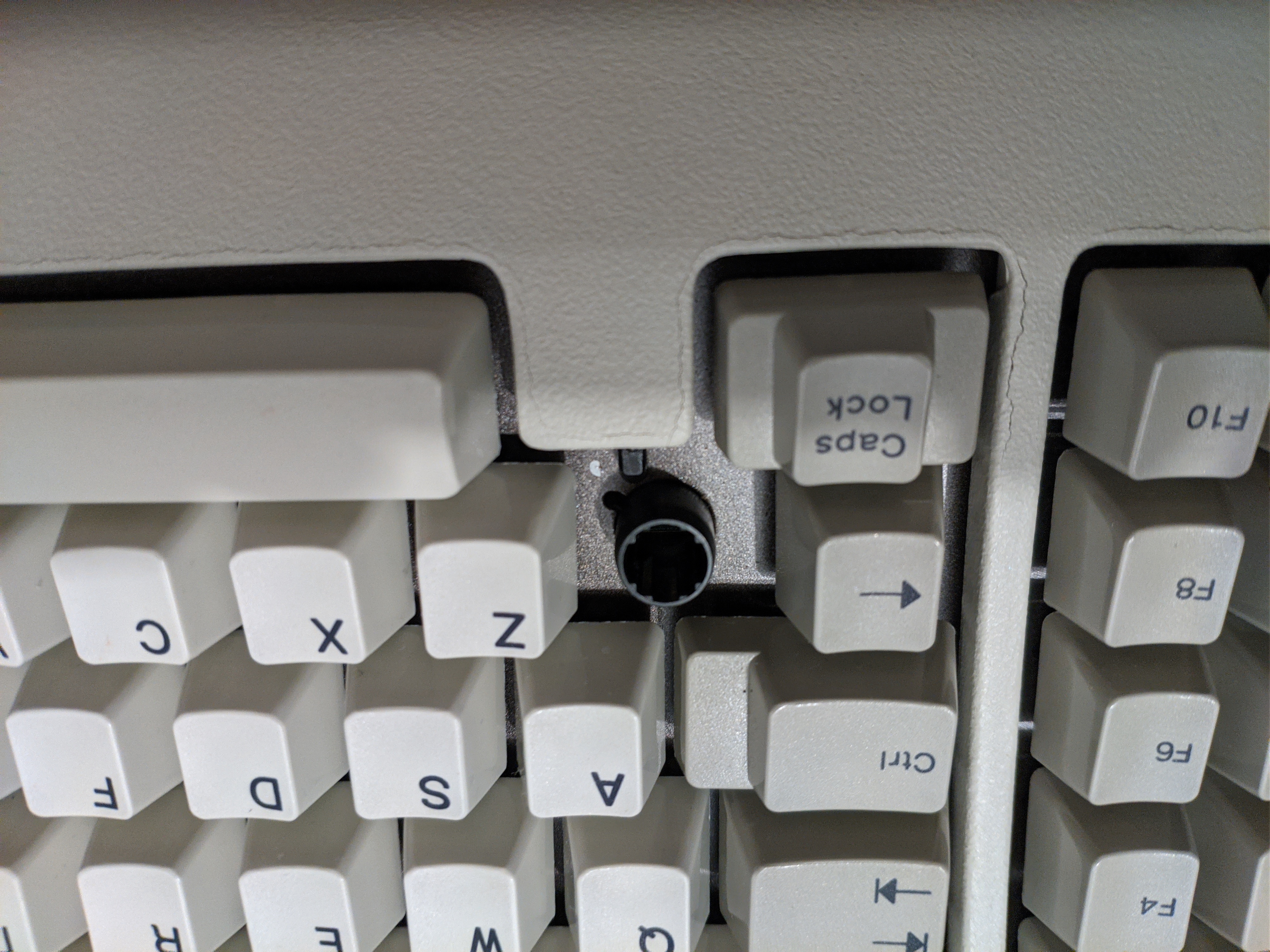

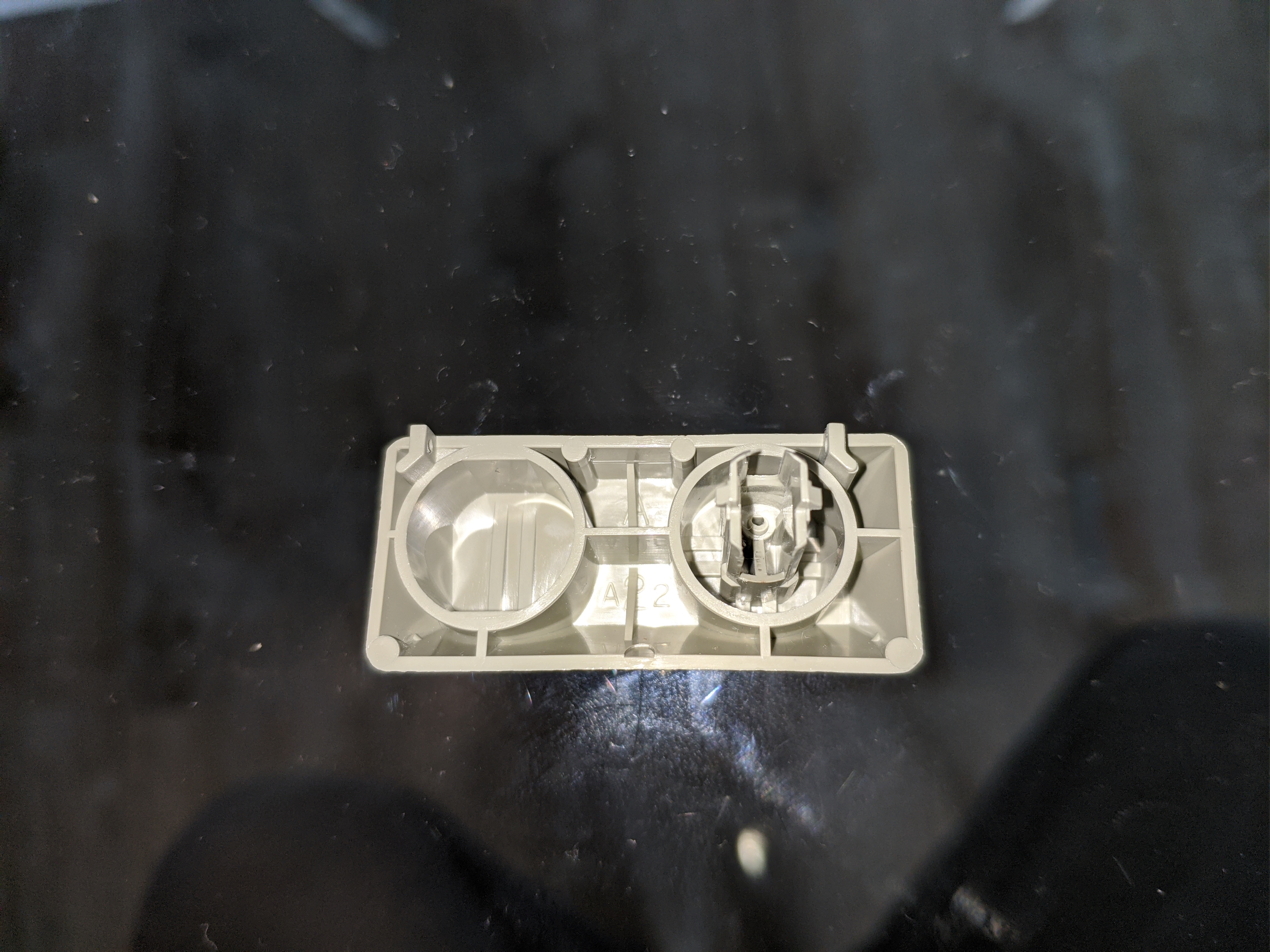

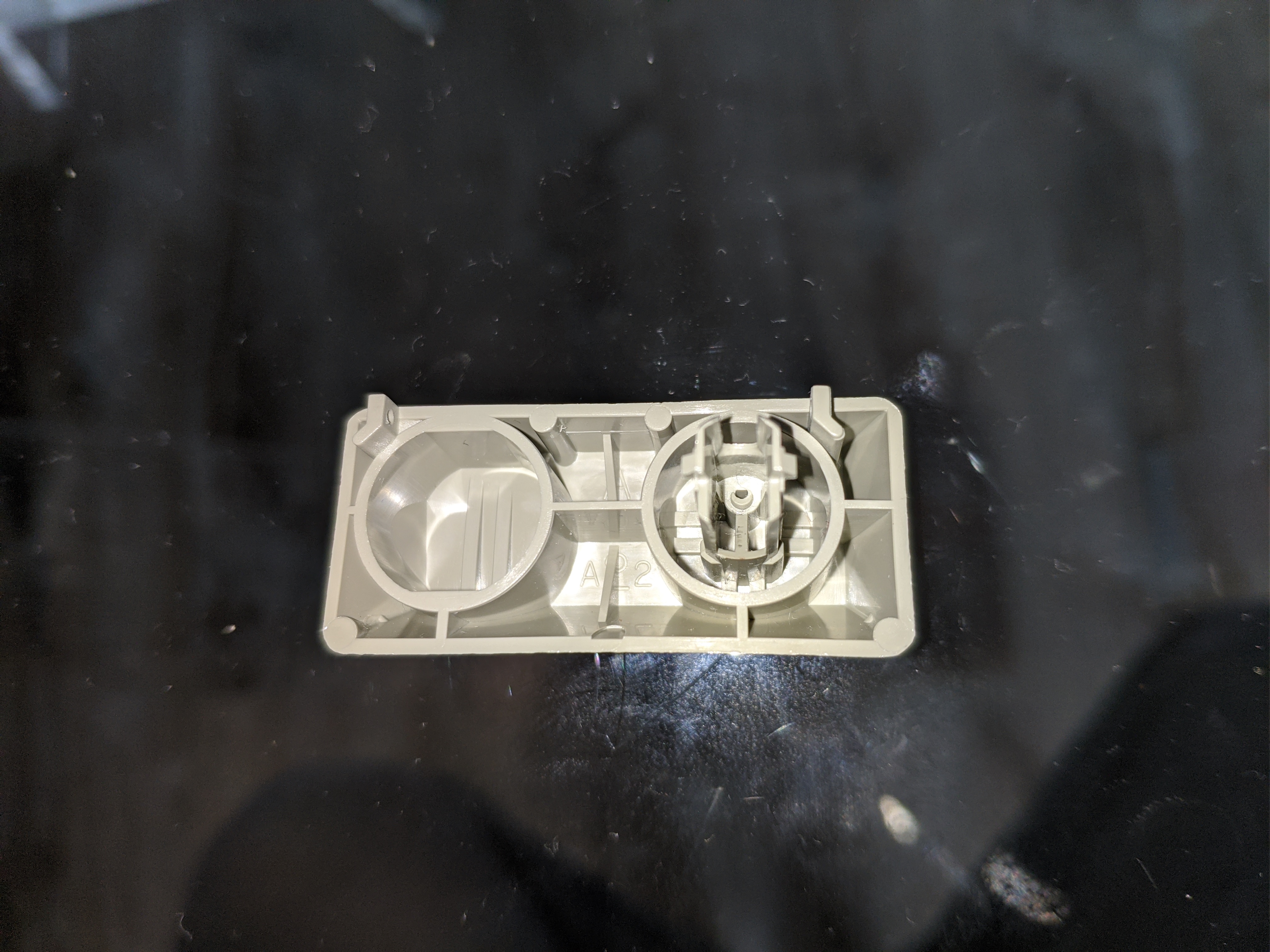

Here are the pictures that I've taken to illustrate my attempt. I try to put the springs in the stem of the keycaps:
I think the keycap is okay, but here are a few pictures of what they look like:
I've tried pulling out and and putting back the keys a lot of times so I'm not sure if that could solve this problem at this point. I'll try to replace the keycaps and post an update if I can solve this issue! I still have no clue what is causing this issue; I'm not sure if it is the foam change or just mistakes in assembly that is causing this.
