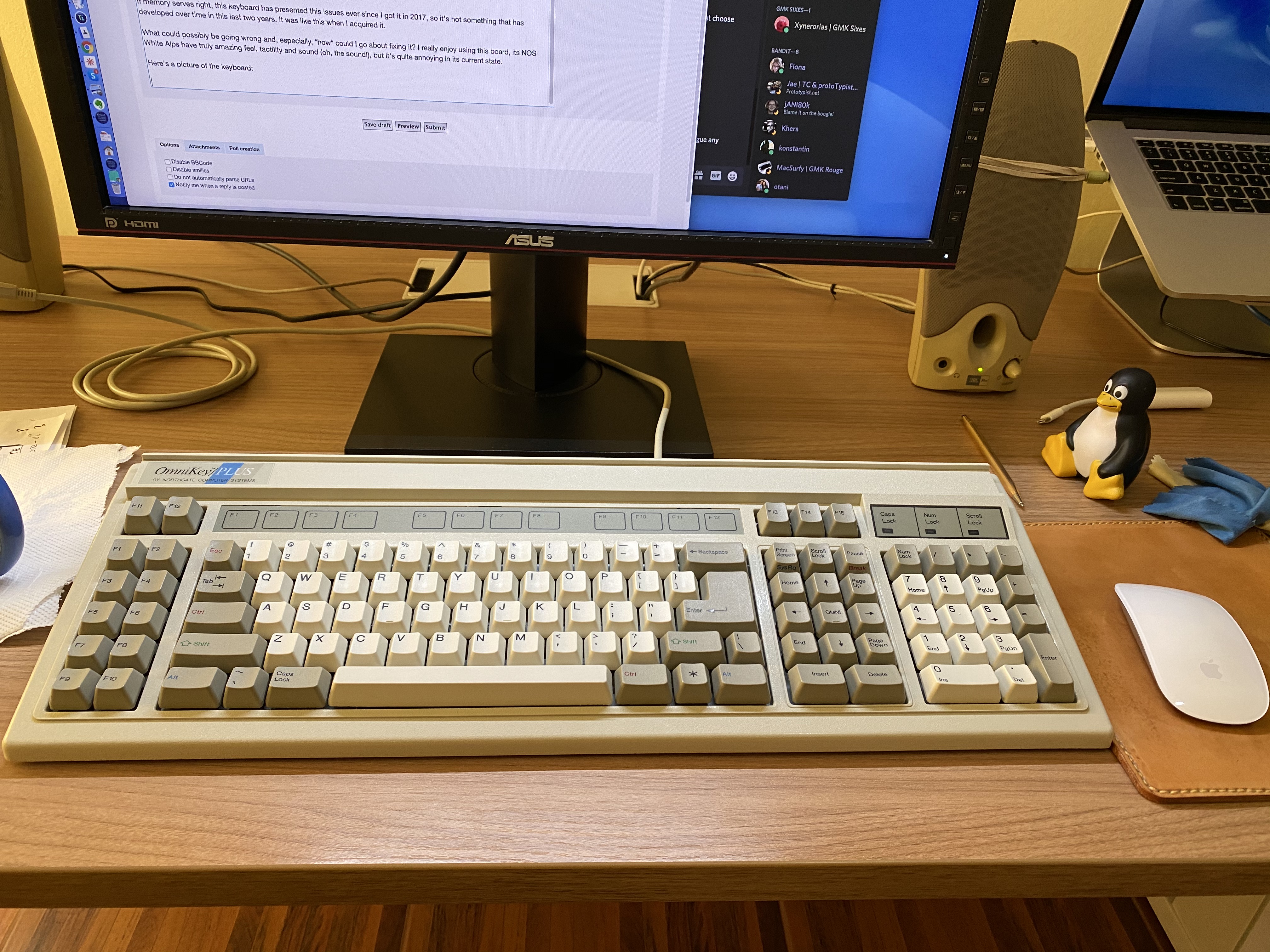

Here's a picture of the keyboard, for what it's worth:

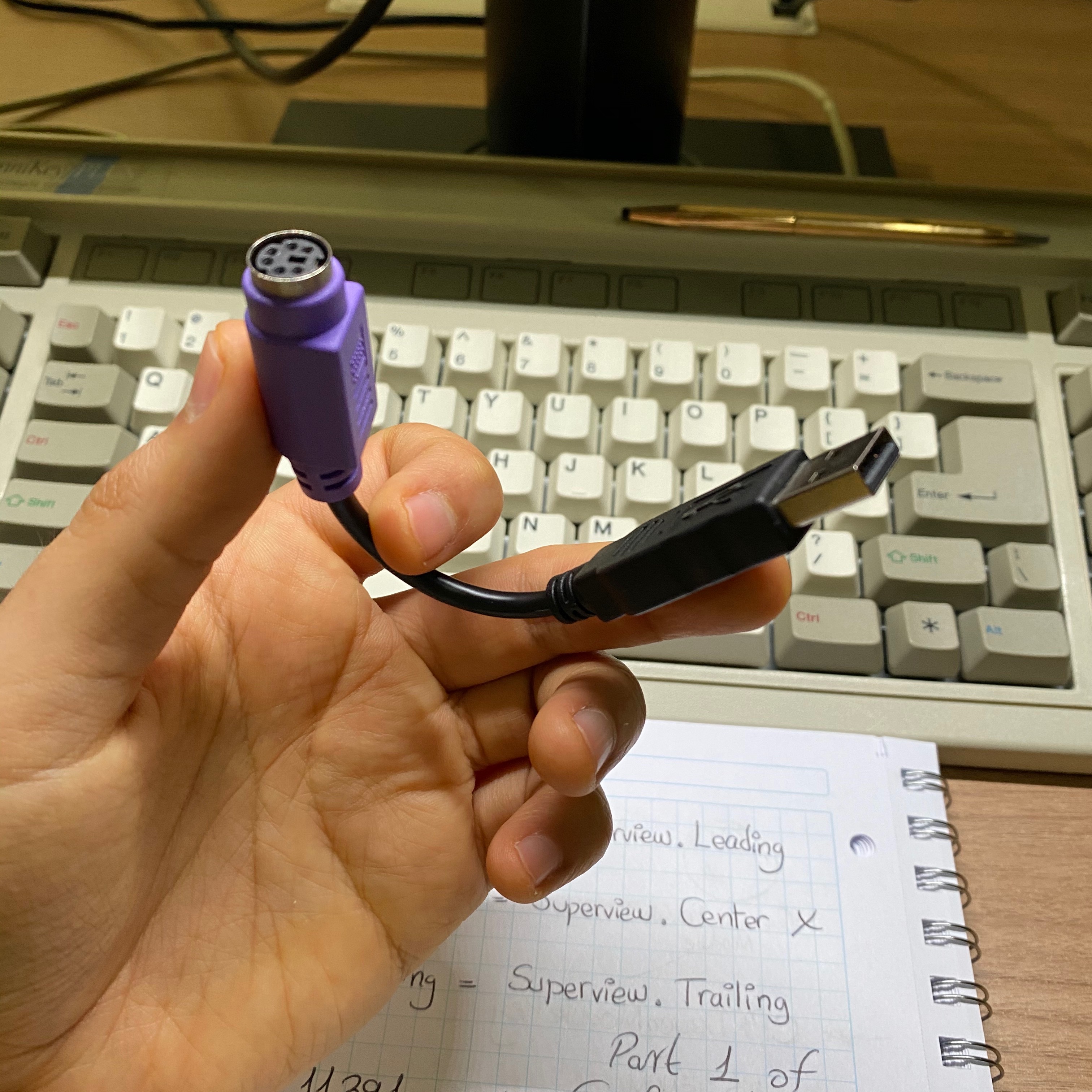

No, it's not a blue cube. It's an active PS/2 to USB converter that I got alongside an IBM Model M that I bought from eBay. Here is a picture of the converter:

Something about the blue cubes and other "cheap" converters causes them to miss scan codes on some keyboards. I had a Radio Shack dongle type that did the same thing, on the same subset of keyboards. You'll get a "typematic" stuck key effect if the converter misses the release code. That's a converter problem, not a keyboard problem. I never figured out why it happened, but I bought a Soarers converter from Orihalcon on ebay a few years back, and it has worked flawlessly on every keyboard I've tried it on, including all of my Northgates. Money well spent in my estimation.

Ah, yes, those are also a common commercial converter, which are probably around the same level as the blue cubes, but could be better. Given how finnicky some keyboards can be with converters even using the same protocol, I still reckon that's your issue.
