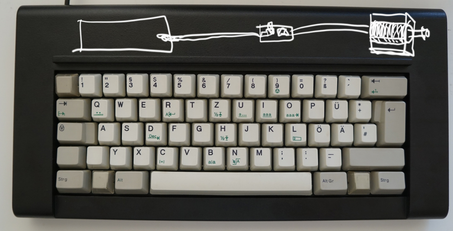

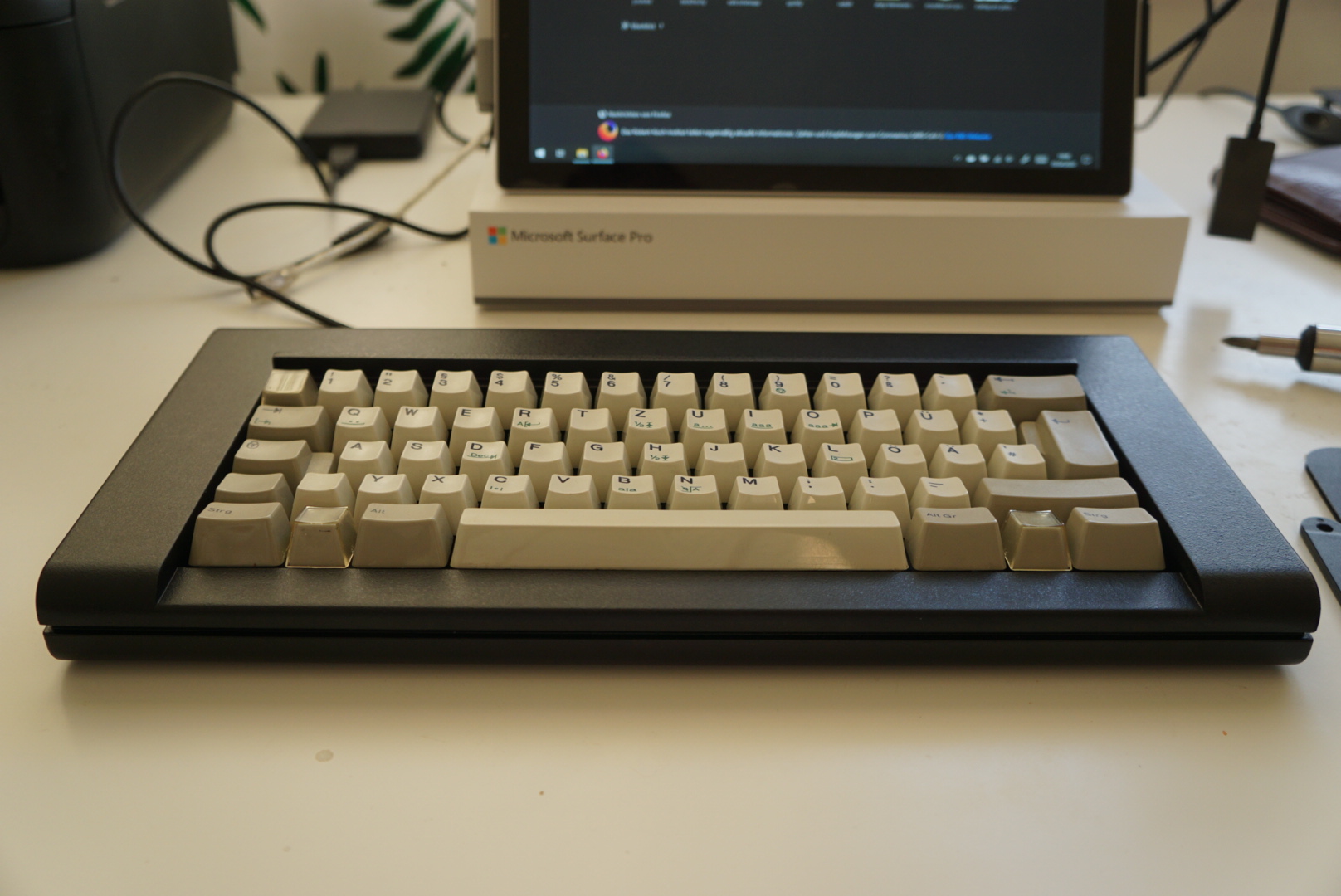

I was in a rush (because I was so excited to use it) so dont have any pictures from the inside :| , but the build is really simple. It was hard for me to find a fitting solenoid on ebay, so used a old one I had laying around.
The one on the left.
This kind of solenoid was for a limited time available on ebay.
I removed the metal piece around it, because the foot piece was to big for fitting in the case. I think all original ibm solenoids will fit without chopping in the case (right side). Of course now the hammer will have no "cage", so I placed the solenoid directly infront of the right side of the keyboard case. The solenoid will now hammer direct at case (damped with a piece of foam tape).
Here a drawing :lol:
The case has a really tight fit, the solenoid is taped down to the top and down with double-sided tape. The driver board is in a plastic bag stuffed inside the case.
Typing example:

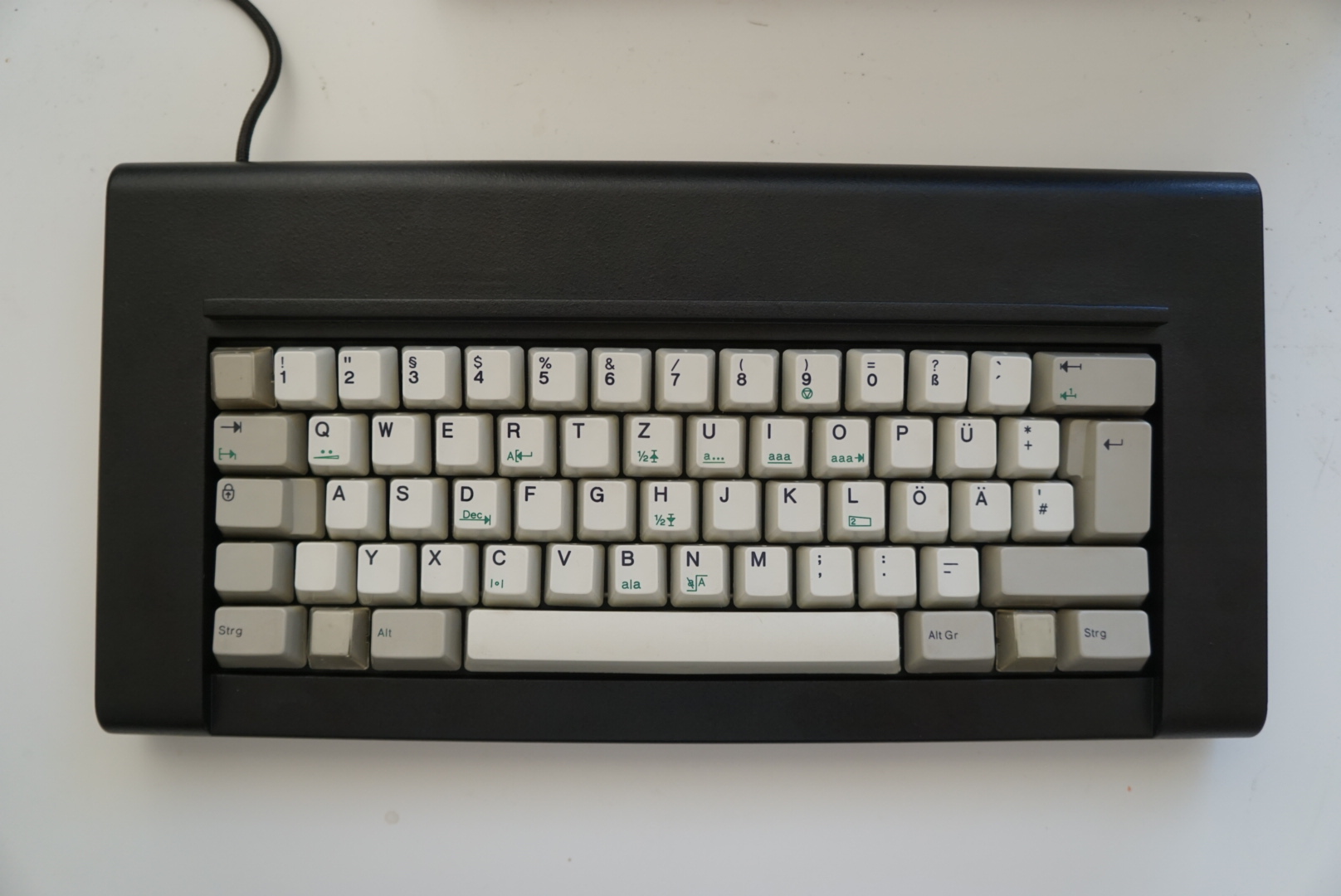

More pictures from the keyboard in general. The keycaps are from an typewriter and a model M, also some relegendables.

You need a solenoid driver board and a solenoid, the additional pins on the f62 xwhatsit controller are already there.
