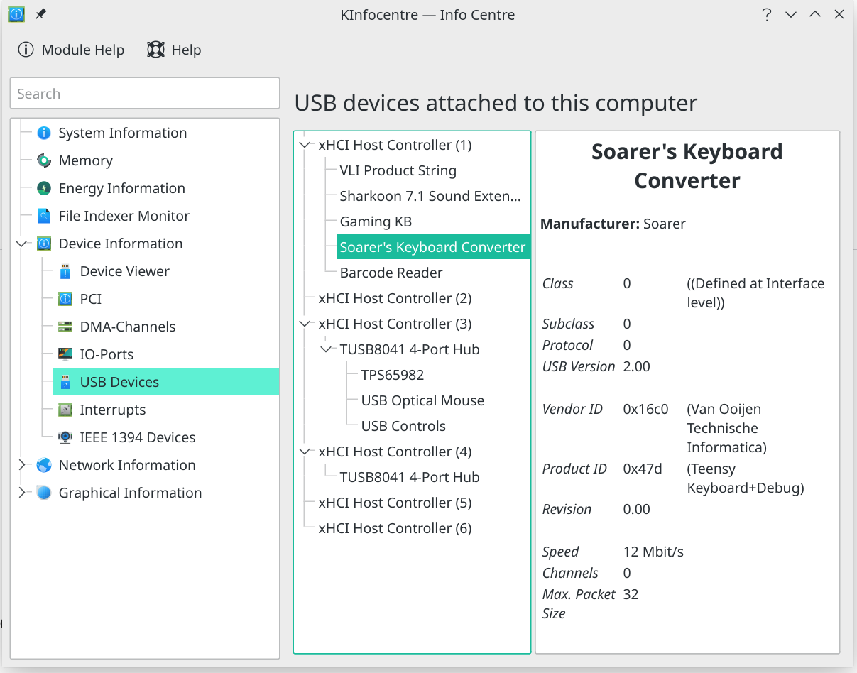

It doesn't appear when running lsusb, but it does appear on the emergent notification on Win10 and in certain commands / tools on Linux, like Kinfocenter (I use KDE), as you can see in the screenshot attached.kelvinhall05 wrote: 07 Apr 2020, 00:01I might be wrong but I don't recall it showing up as "Soarer's converter". Does it show up when you run lsusb?Jaki1122 wrote: 06 Apr 2020, 23:40If you plug a Pro Micro with either the controller or converter firmwares running, the PC should detect it as "Soarer's converter", it doesn't matter if you have no cables on it (and I checked with my working converter this is the case). With my problematic Pro Micros, this doesn't happen, the computer can't recognise them. However, if I flash something like the famous "blink" example code from Arduino, it flashes and works fine, so it can only be either the MCU not being exactly what is says it is or its partially defective.kelvinhall05 wrote: 06 Apr 2020, 22:29

That of course, is with my working one, the others don't appear or are not recognised.
PD: don't think less of me, I'm not using a "gaming keyboard"! seems to be the name of one the cheap AT to USB adapters I got, I'm actually typing on a Northgate Omnikey 101!!

Hm, maybe something is wrong with your specific Pro Micro. Sadly, I don't know if I can diagnose it more. I would still just try connecting it to a keyboard and seeing if it works...it's worth a shot.Jaki1122 wrote: 07 Apr 2020, 01:52It doesn't appear when running lsusb, but it does appear on the emergent notification on Win10 and in certain commands / tools on Linux, like Kinfocenter (I use KDE), as you can see in the screenshot attached.kelvinhall05 wrote: 07 Apr 2020, 00:01I might be wrong but I don't recall it showing up as "Soarer's converter". Does it show up when you run lsusb?Jaki1122 wrote: 06 Apr 2020, 23:40
Try connecting a keyboard to it and seeing if it works. I think it will.
