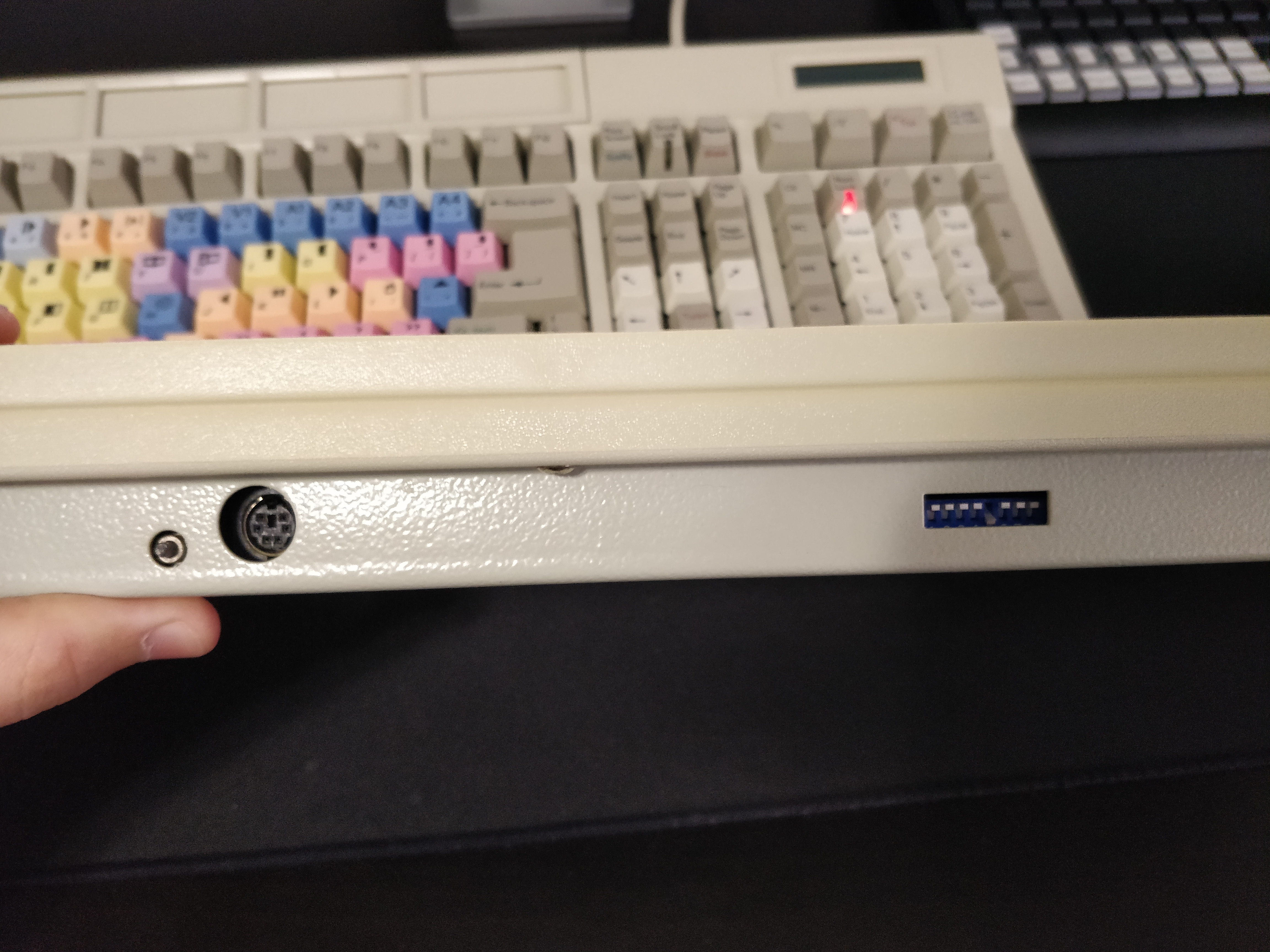

Hi guys, I just noticed recently that what I thought was a normal Omnikey Ultra (the model with the SF keys at the top) seems to be fairly uncommon. Mine only has one port at the back, whereas literally every other Omnikey I have seen has had two ports. Is this normal or something? Thanks!

Very weird...my Ultra has just one PS/2 port on the back, and the dipswitches are also on the back, right next to the port. There is also this mysterious button...no idea what it does

kelvinhall05 wrote: 29 Apr 2020, 14:22 Very weird...my Ultra has just one PS/2 port on the back, and the dipswitches are also on the back, right next to the port. There is also this mysterious button...no idea what it does

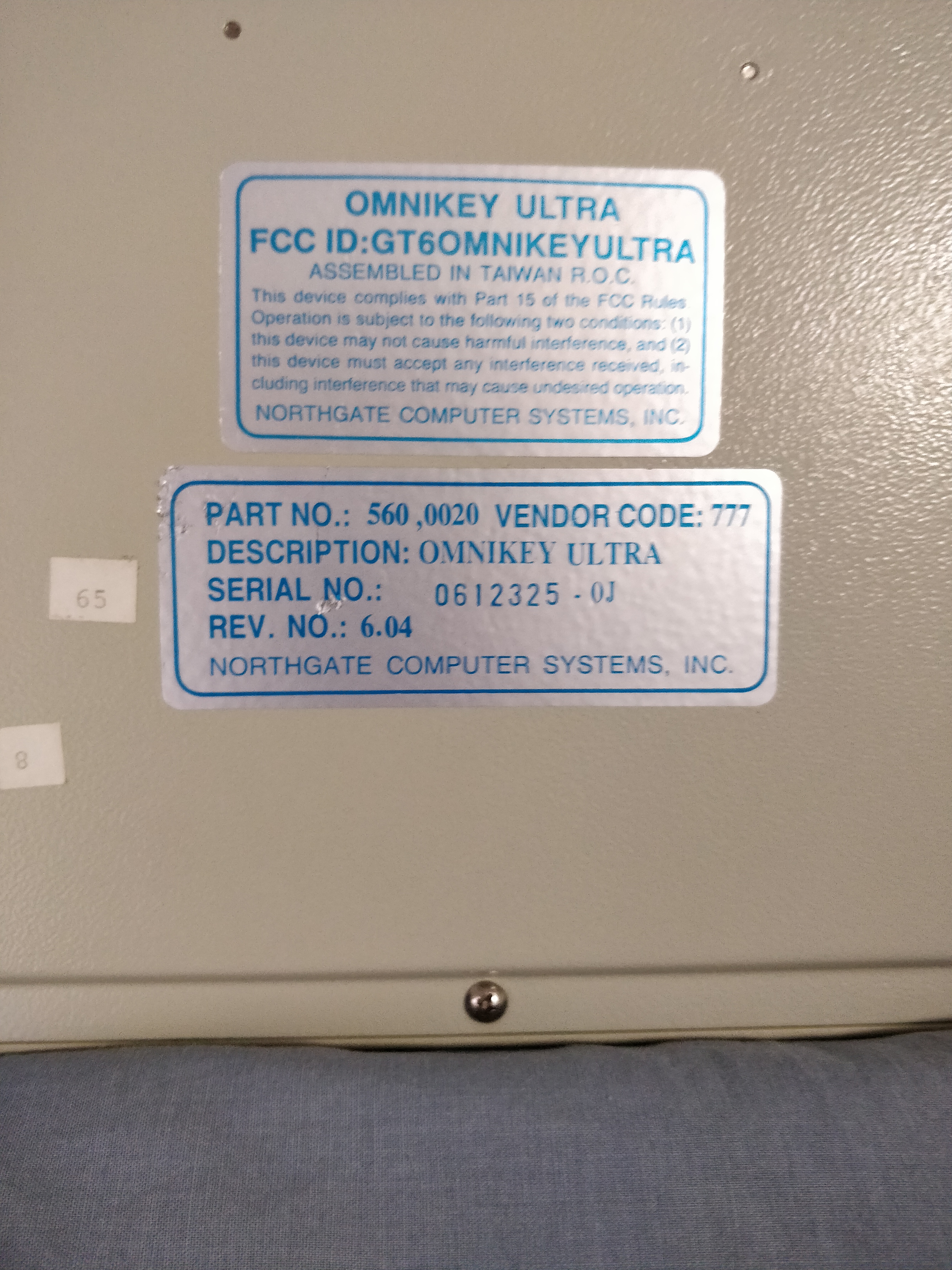

Can you post a photo of the label? I keep a database of Northgates and I can tell you more from that. There were some oddballs made, mostly from the period when Gen1 and Gen2 apparently overlapped.
edit - the pushbutton is a reset switch, I've seen that before on some Gen2 Northgates.

Thanks, I believe the "0J" is a date code, probably October 1990. The Model 560,0020 Ultras first appeared around "0H" (August 1990). Those had a version code 6.03 and then 6.04 like yours, so you've got a relatively early one. Later Ultras had a version code of 6.05F and I'm thinking those were the ones with the ADB connectors. I have far more of those on record than I do the early ones. I'll keep gathering numbers and notes with these features in mind. Thanks for sharing this. There were a *lot* more variations on the Northgates than I ever imagined when I started gathering data a few years back. I have almost 400 on the list now and still learning!

It resets the computer. The Northgate User's Manual calls it a "system warm boot" switch. I quote, "The small button on the back of the keyboard can be used to reboot your computer. Depressing the button performs a Ctrl + Alt + Delete keystroke."
