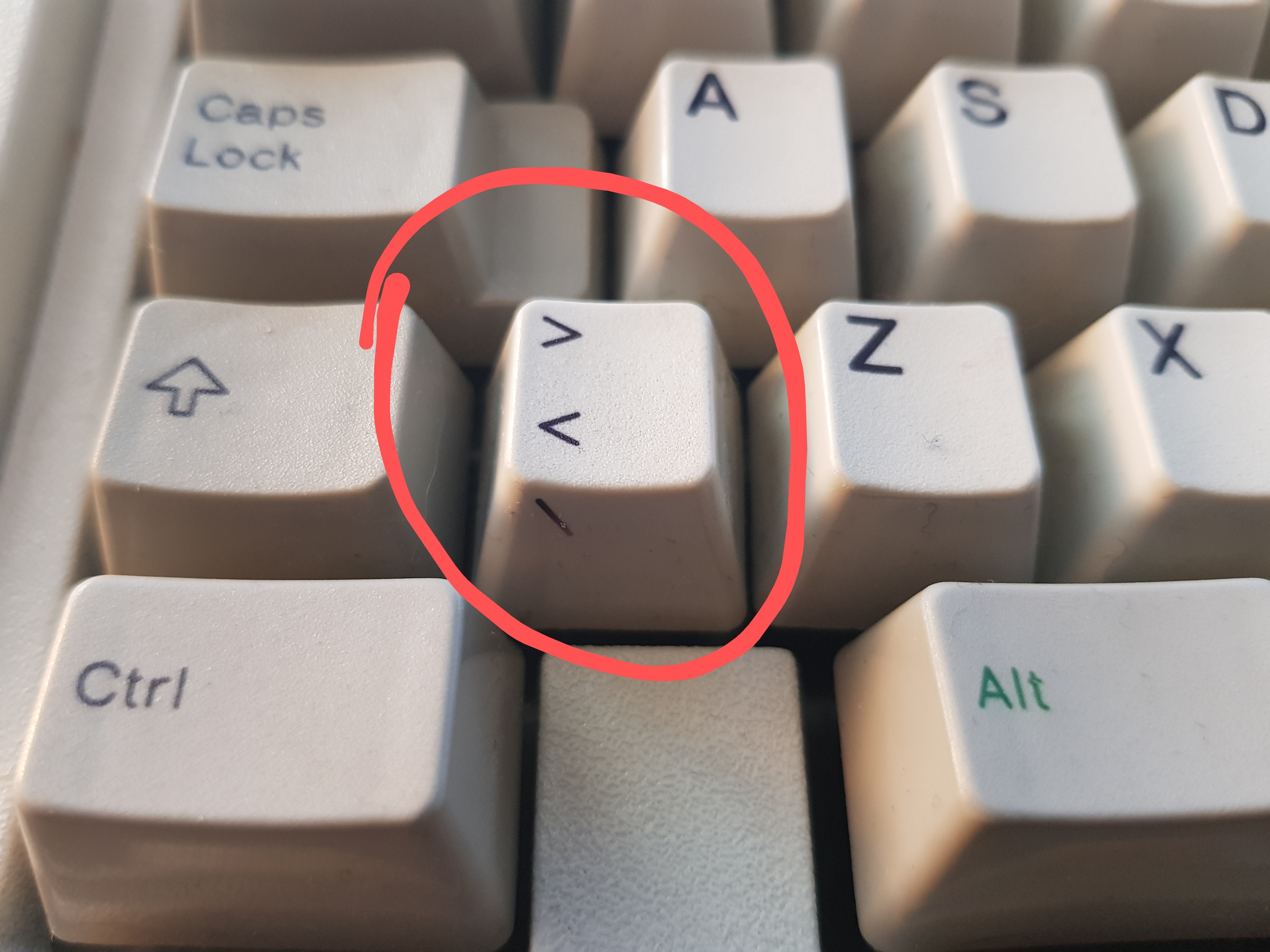

I own a Model M, Danish layout (1391407)
where the "<>" key is dead.
Is there a way to fix it without taking the entire keyboard apart and bolt-modding the whole thing?
All the keys feel as they should, including the one not working.
In case the location of the key matters, here's the key that does not register:
Fkazim
02 May 2020, 13:15
Try blasting some compressed air down the key barrel it could be there's dirt stopping the flipper making contact to the membrane.
Make sure the keys notch engages with the buckling spring. This is done by tilting the keyboard back as you install the key.
If that still doesn't solve the problem than a full disassembly and screw/bolt mod will be the only option. This way you can fully clean the inner assembly.

Did it work before?
If you are using one of those 1 euro PS2 to USB converters, some of those didn't have support for 102 keys and only support 101 keys. And that's exactly the key that wouldn't work if the converter doesn't support it. I had the exact problem with one of my converters, changing the converter solved the problem.
02 May 2020, 13:20
First try to reseat the keycap, but you probably already tried that. It's a bit suspect that the key is entirely dead but feels ok. In my experience that in the majority of cases means there's another key stuck somewhere, confusing the matrix, maybe one you don't use and therefore didn't notice, like Scroll Lock, and then it could be just a matter of reseating the keycap of that other key.
If that's not it, I would change the spring. Like you said it feels ok so that might not be it, but it's an option you can try if you have spare springs without having to take the keyboard apart. E.g. search for Sandy's chopstick method. Basically you take the keycap off, insert a stick (I use a toothpick) that has just enough friction to remove the spring and insert a new one, but isn't too tight or it could damage the new spring. This may take a little practice though, I burned through a couple of springs the first time I tried it before I got the feel for it.
