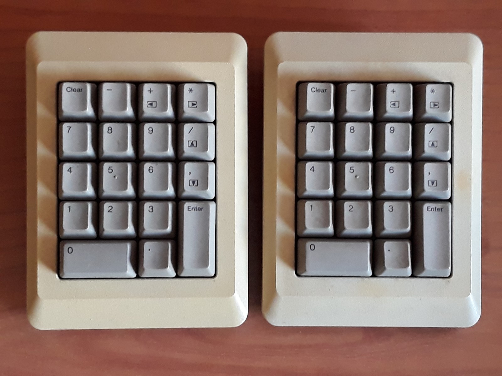

Several months ago, I bought two Apple M0120 numpads in different eBay auctions (I also got a third one, but somehow it still doesn't reach my hands).
M120 and M0120.
M120 and M0120.
Today, I finally got off my lazy ass and tested them; plugged a Hasu TMK converter, programmed to a layout of my liking, pressed each key and... the numpad on the left did its thing perfectly, but the one on the right is completely unresponsive. Switch action is fine, so it's safe to assume some electronic component inside is to be blamed.
I haven't opened the faulty numpad (I don't have the proprietary screw driver yet), but I have to wonder what should I be looking out for when I do, and what venues are available to get this numpad back into service.

Indeed, those certainly look like Torx screws. And, as it turns out, my son's screwdriver set includes a couple of those... both too small for these screws. ARGH! :evil:

Well, let's hope this is the case; I bought a couple controllers last year, thinking of handwiring projects, but if one can be used for this numpad, it'll be a good thing.
As to "Why?": lustalgia. Back in the day, when we had to work with common Macintoshes, getting to use a second floppy drive was a rare luxury (even if it highly improved productivity), and getting to use an actual numpad was even more so — and I never got to use one or even see it in person. Oh, and the fun of getting to press these snappy, pingy keys without having to actually suffer using an M0110 keyboard as a main driver.
